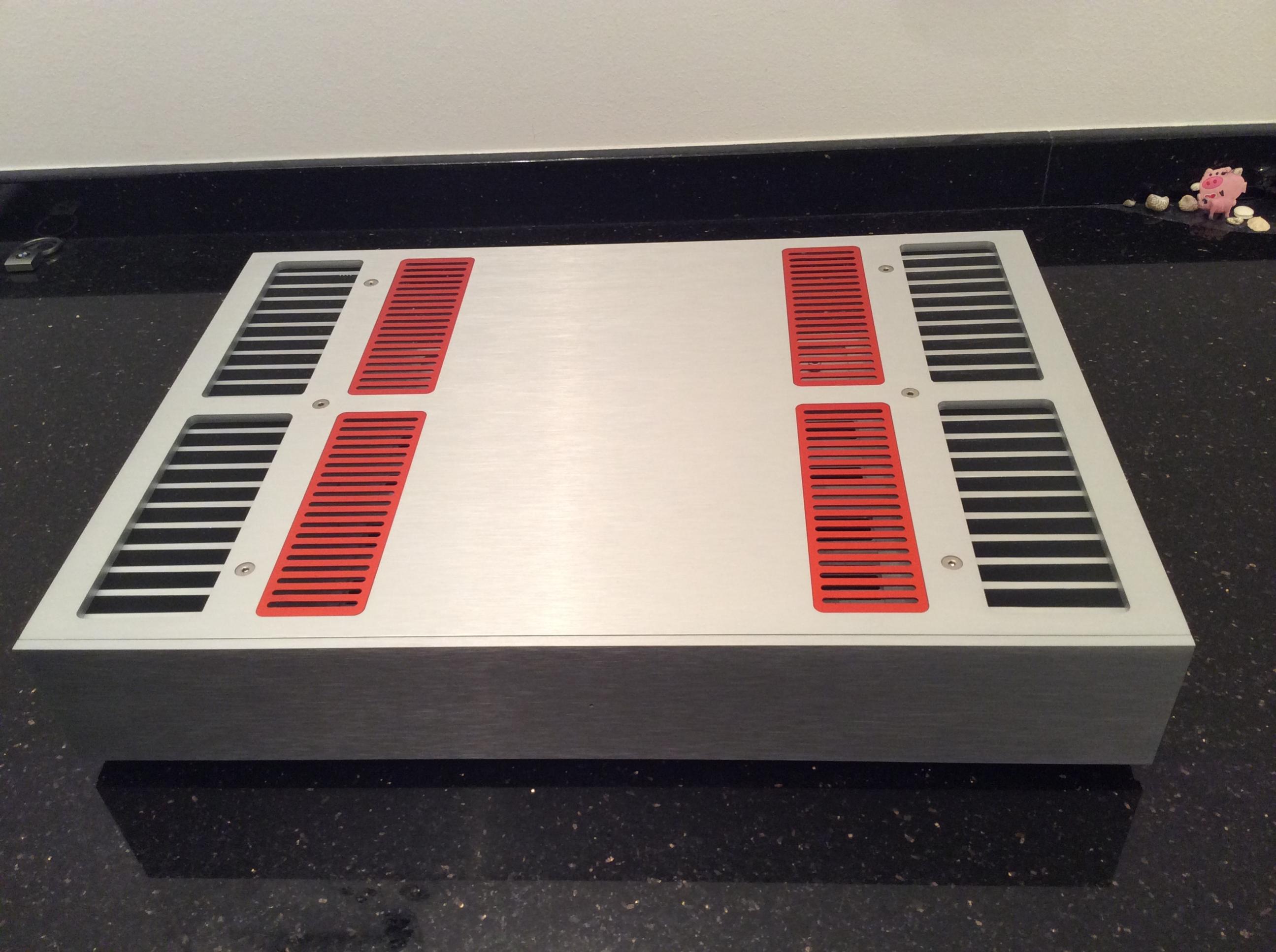

At the moment, all GB members already received the modules, please slowly prepare all the mechanics, chassis, heatsinks, terminal connectors, etc., but please don't do any wiring yet. On daily basis testing of the First One in the chassis is taking place, the aim is to find out the best possible grounding scheme and I can tell you all that we already have it. Final touch in day or two and then new detailed chassis wiring scheme will be published in this thread or maybe just sending it to PM of GM members, we'll see.
Regards, L.C. :cheers:
