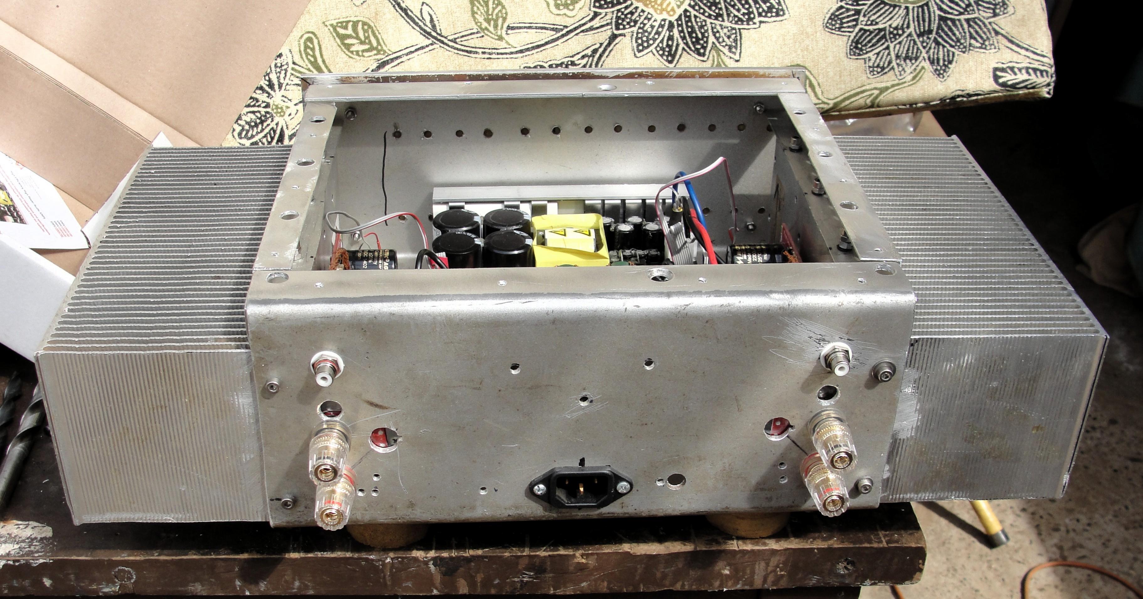

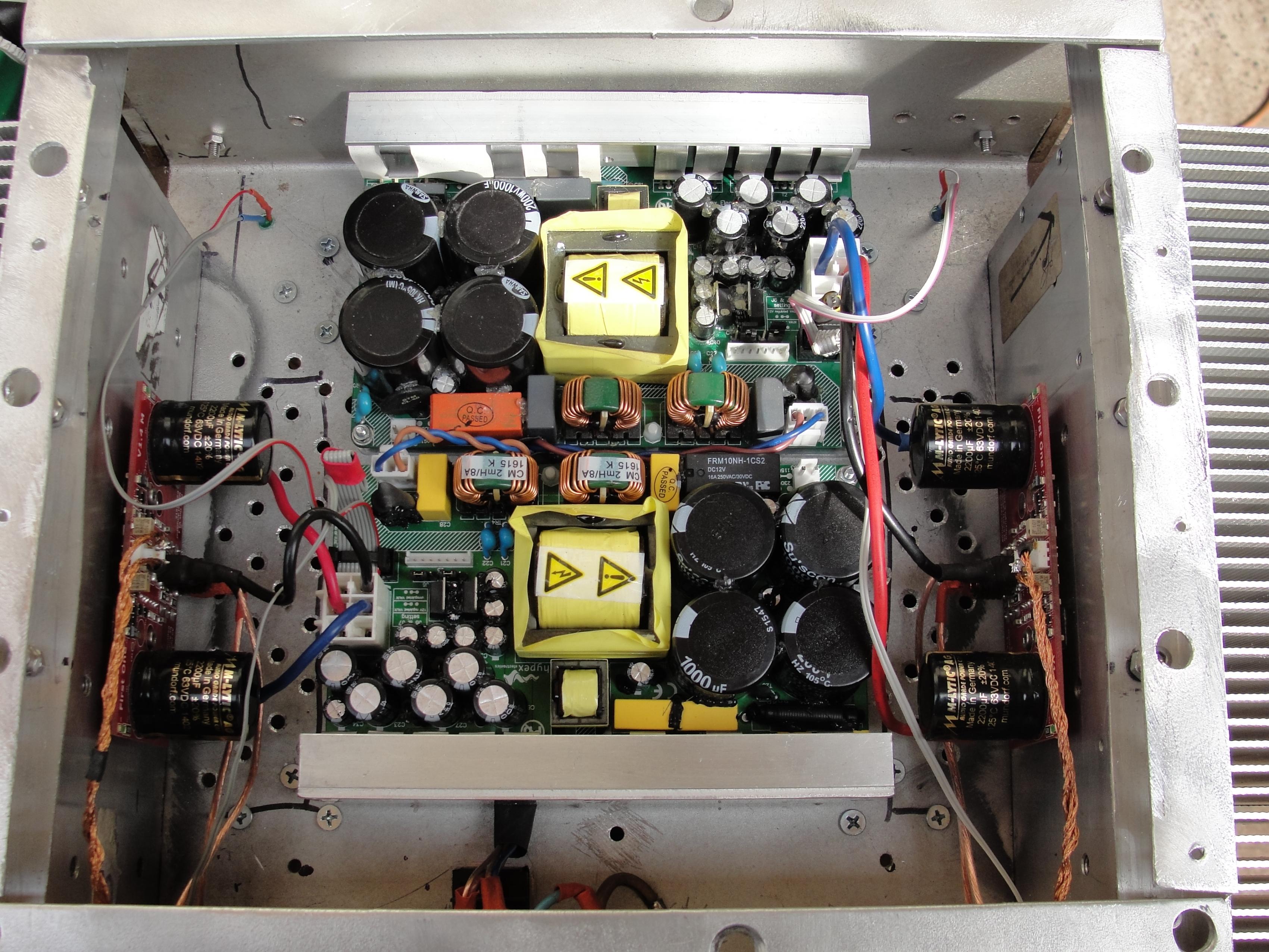

I finally completed the transformation of my ugly amp to dual-mono, as LC recommends, and I just forgot how much the SMPS costed me, so better it sounds. Now I will have to wait for complete burn-in and then add even more capacitance. I plan to experiment with big cans parallel with Russian polystyrene caps. 😎
Thanks LC. 🙂

I also have a tendency to make my amps ugly (and cheap in the chassis department), but you just motivated me to make more of an effort this time 'round. 😀
Congrats on the build - hope it sounds great!
Thanks.
I prefer that it gets evident that it is DIY. 😀
At least it is very robust.

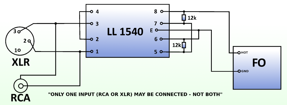

As regards using LL1540 as input transformer input, would it be OK to connect the single ended RCA input via the transformer as well, given the strict rule that only RCA or XLR may be connected, and not both?
Please see the attached diagram - I borrowed mackiew's original for connecting the LL1540 from an earlier post - thanks!

Thanks for the reply - that's true, and completely fine. I was more worried about the grounding scheme, as the FO will now be floating with no ground connection outside itself.
Hello!
I realize I ve mixed up something, the smaller signal (RCA) should be connected to the smaller winding , so at pin 2-4 , and not the xlr pin 3 as I mentioned ..
About floating, well, unless one of the element in your system has its gnd connected to earth somewhere, then you are always floating 🙂
but if you question this, then you might question why using a transformer 😀

The transformer provides proper balanced to unbalanced conversion, that's why. 🙂 The single-ended RCA input is there because several friends are interested in the FO M, and unlike me, they don't have a nice, properly balanced front-end - so I need the RCA to let them hear the amp in their own systems. + 6 dB on the XLR is completely fine... it's easy to mess up with these Lundahls as the pin numbering doesn't correspond to the sequence of taps on the windings.
I was just asking to be on the safe side, with the recent stories of burnt zobel networks, improper grounding etc.
I guess as long as the FO has its GND referenced to the power supply, it'll be fine. I also prefer to isolate ground when possible, which is the main reason why I changed the scheme for the LL1540 in the first place.
