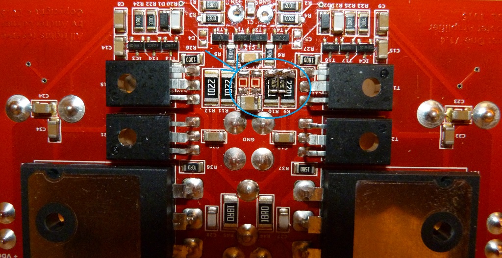

Ok after doing some magic got 30mv output offset on the output and 175mv across the test point and power input.
Still to figure out the algortihm of adjistment 🙂

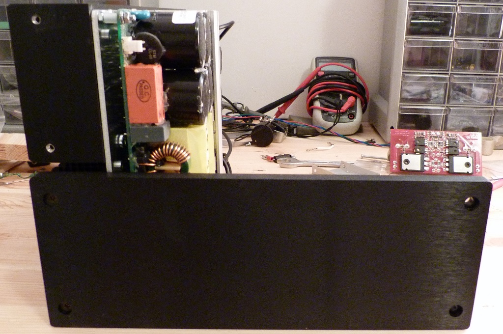

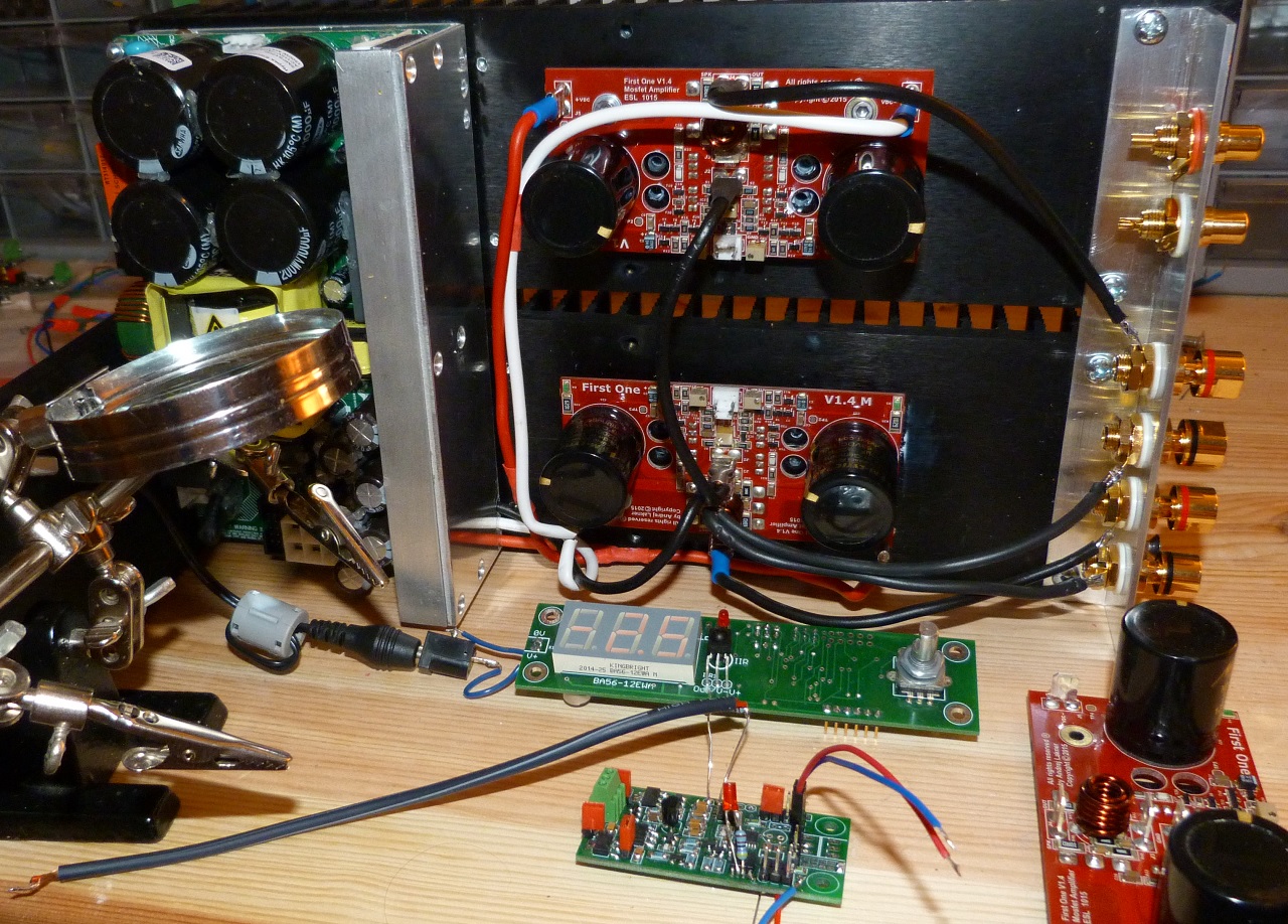

well guys, I thought I could share more about a special version I m doing around quad FO 1.4M modules 🙂 this is not finished but the FO is also a very nice toy and kind of swiss knife for me and sharing this is also a way to push me on going faster..
So the project is a compact and ultimate quad amplifier in order to bi-amp a pair of loudspeaker, and it integrates a "lossless"volume control inside the amp.
As I have passive filters, I could choose between bridge or biamp. At the moment this will be configured as biamp as my plan is to quickly move to active biamping. But I m sure a bridge configuration would be awesome and I may try that sooner or later.
So we have a 240mm wide front panel with on each left and right side a dual bloc of 2 heat sink (80mm x 300mm each) containing 1 (vertical) hypex smps1200a400 and 2 FO1.4M.
The 2 FO are one above the other and the wiring is organized so that the input connectors are facing each other. I ve manager to directly solder the wire on the hypex PCB and then the wires exit from 3 holes drilled in the L aluminium plate... (not really industrial but fully compatible with DIY approach).
you can see the 4 output and 2 RCA on the right side of the picture.

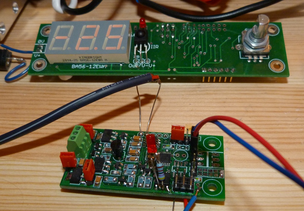

For the volume controle, I ve design a small PCB using the DAC8812 and an Attiny85. the PCB is organised so that it fits in between the 2 FO so that the output of the R2R MDAC can reach the input connectors with the shortest length possible.
there is a controle panel with an encoder, an IR and 3 digits display, which comunicates with up to 2 R2R board in serial (4800 baud) optocoupled) so that there are no comon GND in between the Rigth and Left chanel.
when the hypex is loaded with 2 FO1.4M, it becomes quite hot and the connection to the heatsink is welcome here. Now comes the problem of the comon ground between the 2 modules , and you know I have designed a differential input module to solve that. but here this would be overkill as we have already a PCB for the R2R volume. So, after many hours of simulations, I decided to modifiy one of the 2 FO so that the Feedback divider network goes to the ground of the first / botom module. You can see the mod on the 3rd picture : the 2 small 47ohm resistor have been unsoldered and moved over the 2 x 2200 ohm (see blue circle). Then I can connect a silver wire from these 47R down to the botom module GND. same stuff needed on the In- connection to be perfect. And then the 2 GND Speaker connection must be taken at the same point on the botom module.
Here we go, this is all in progress and I hope I can finish and listen that say next week. if all is OK I will order all the parts for the other side of the amp in order to complete a fantastic biamp bridegeable unit.

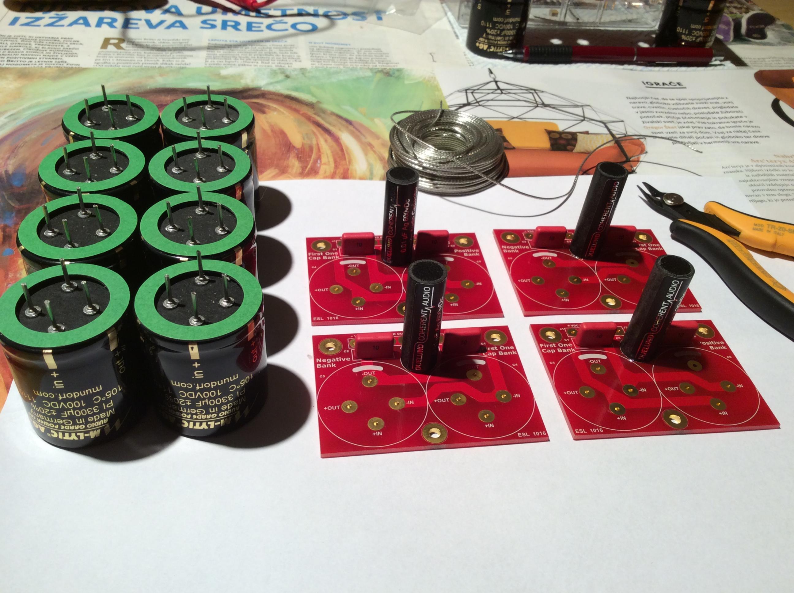

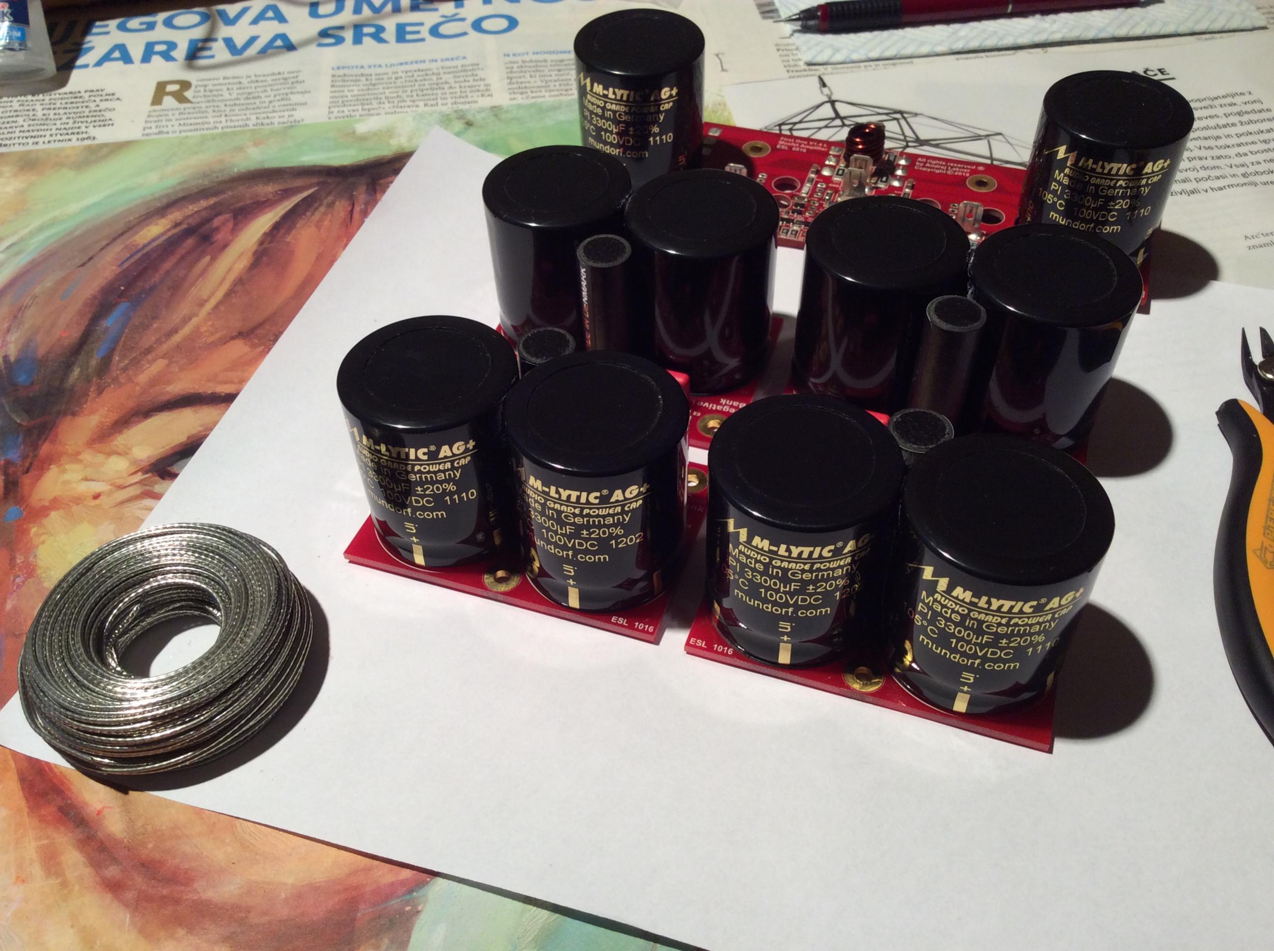

Looks good LC...

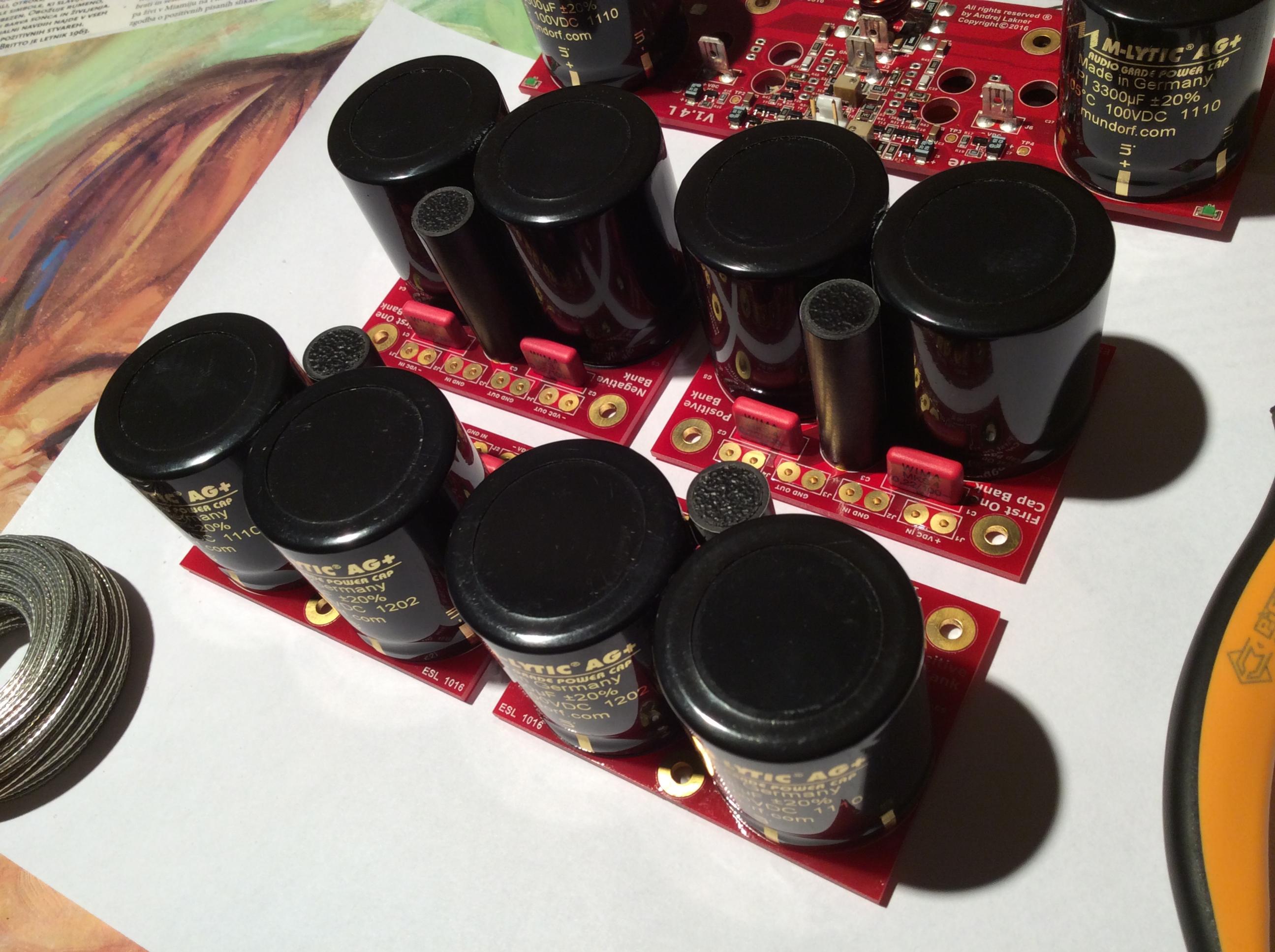

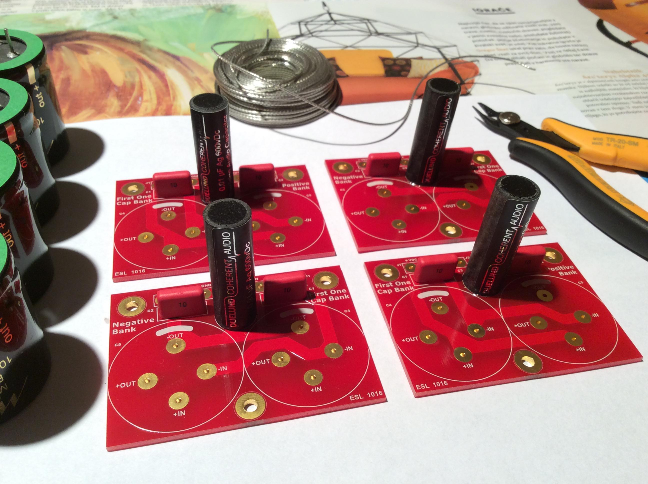

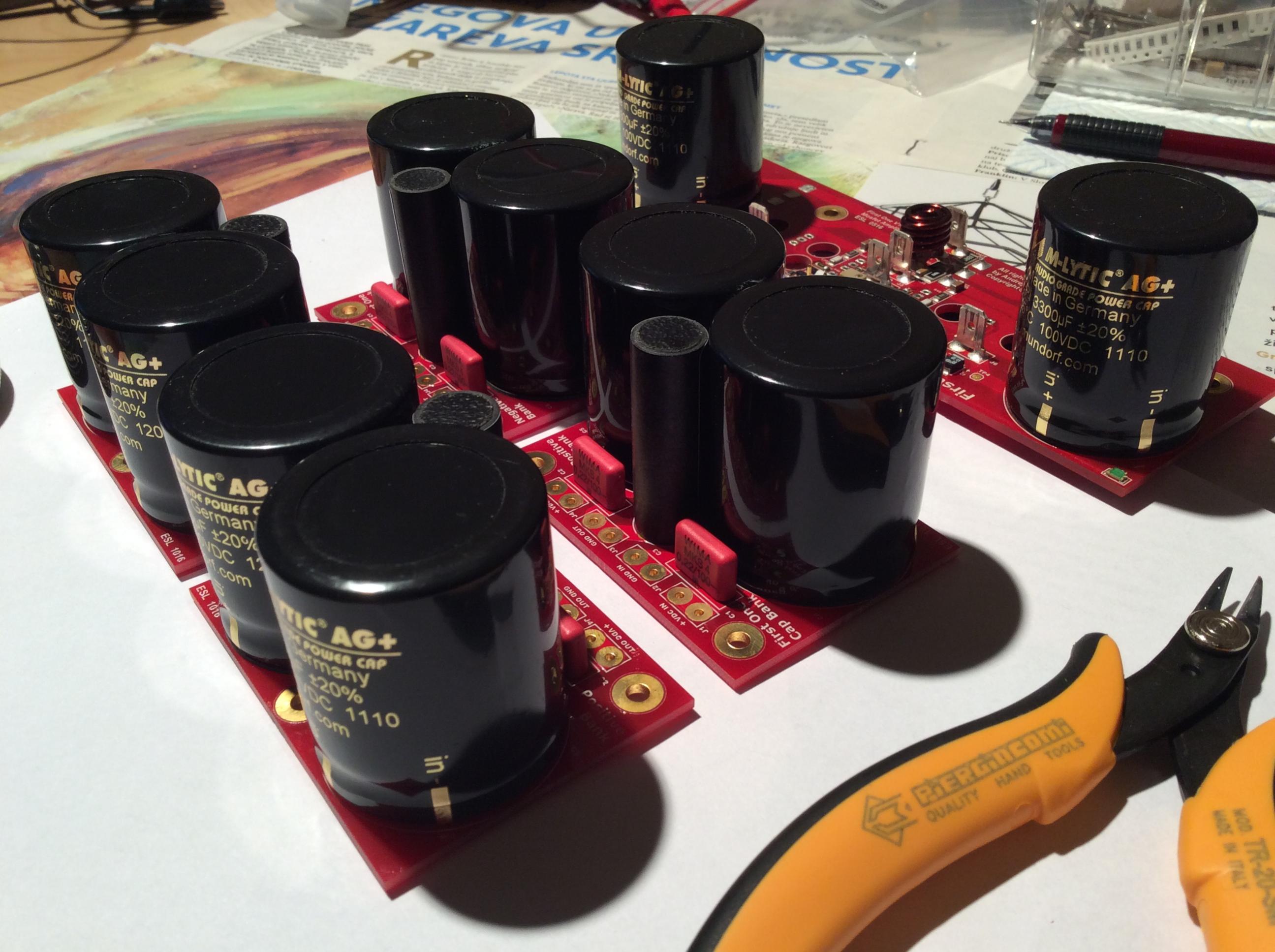

And thanks for answering my question from previous post "why not decoupling the electrolytics with smaller ones ending with pp ones - one decoupling would be enough for the entire banks and mimic even better caps"...
VERY interesting, hope only the duelund doesn't bust the budget...

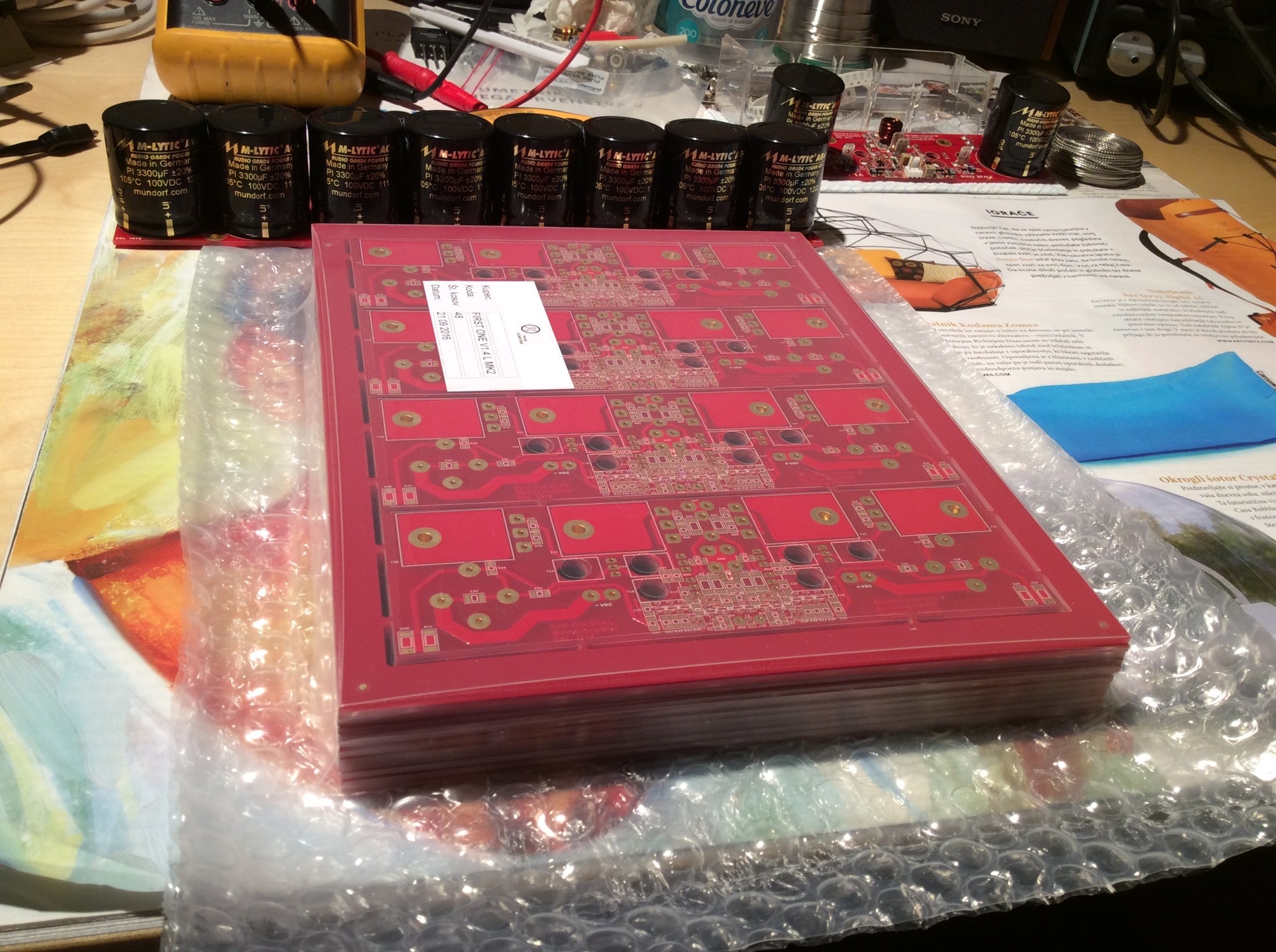

This week 48 PCB-s going into SMD/THT production. 😉
