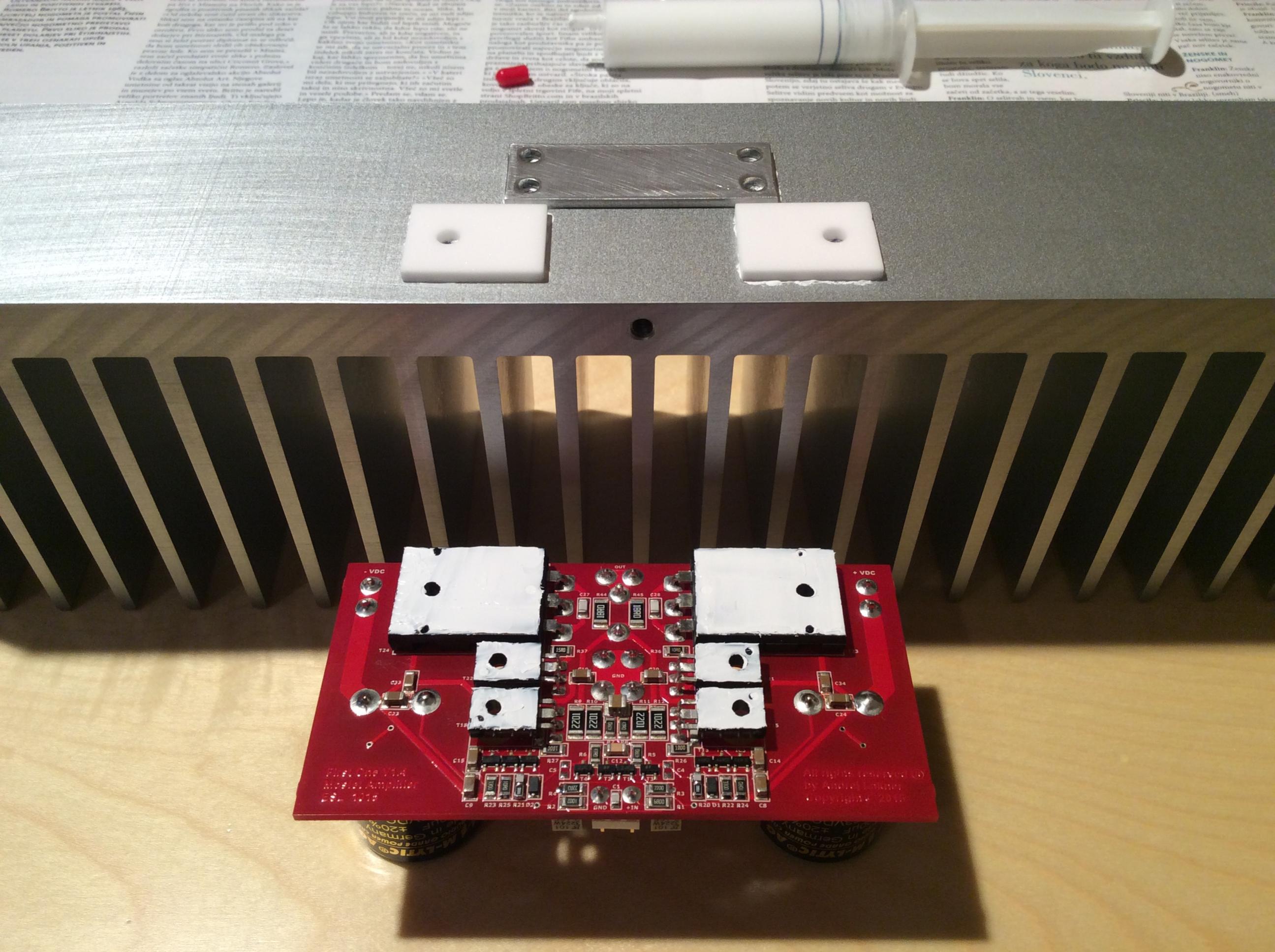

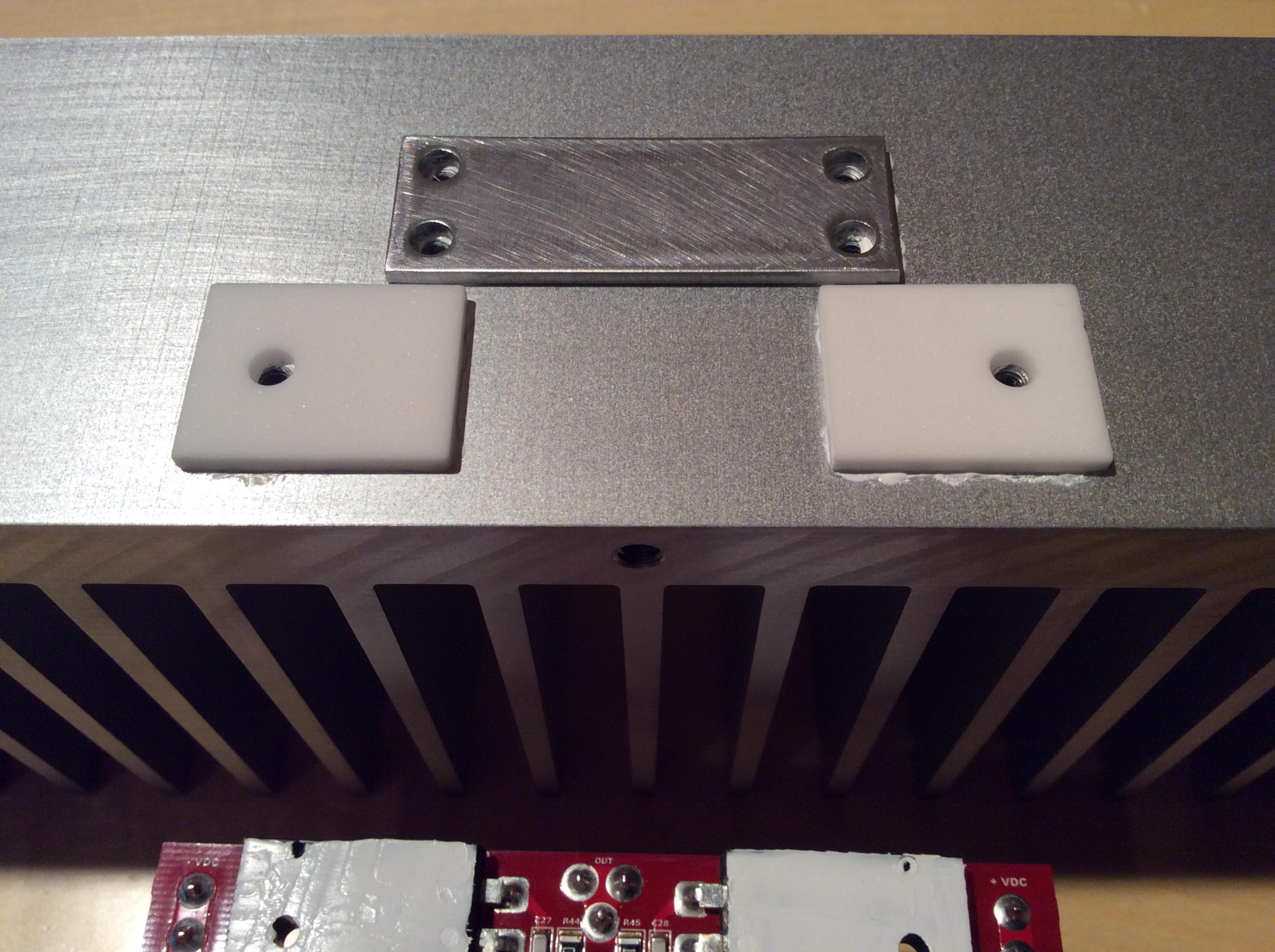

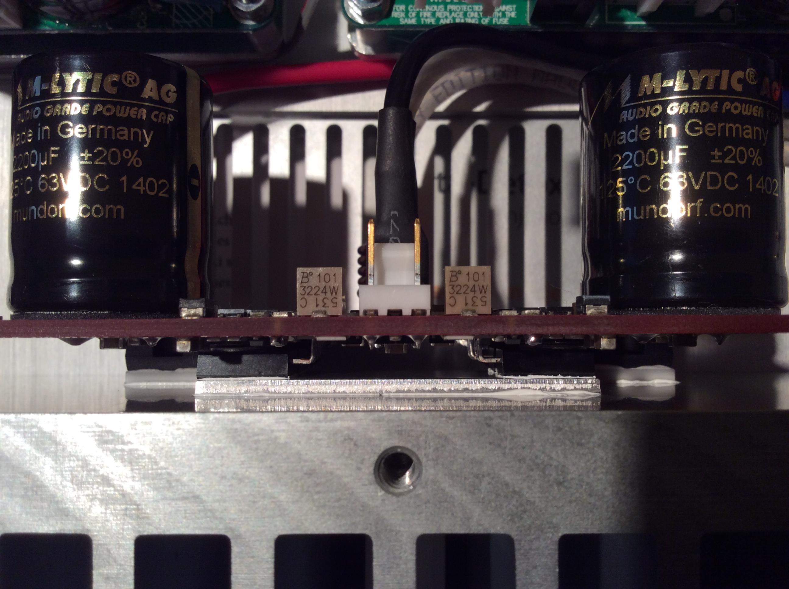

What is the case size of the Mosfets? TO-264?
The Manuel suggests Mica Insulators (size and thickness not specified), but I have also heard Kapton is good, but not necessary the longest lasting...
I know some testing was being done using Aluminium Oxide also, what was the outcome, in terms of Thermal transfer? The answer got lost in options.
Finally, I noticed in the photos posted on post #2545, that Lazy used relatively thick Insulators. I have read elsewhere that the thinnest possible is preferable. Is that the case with the FO modules?
Thanks,

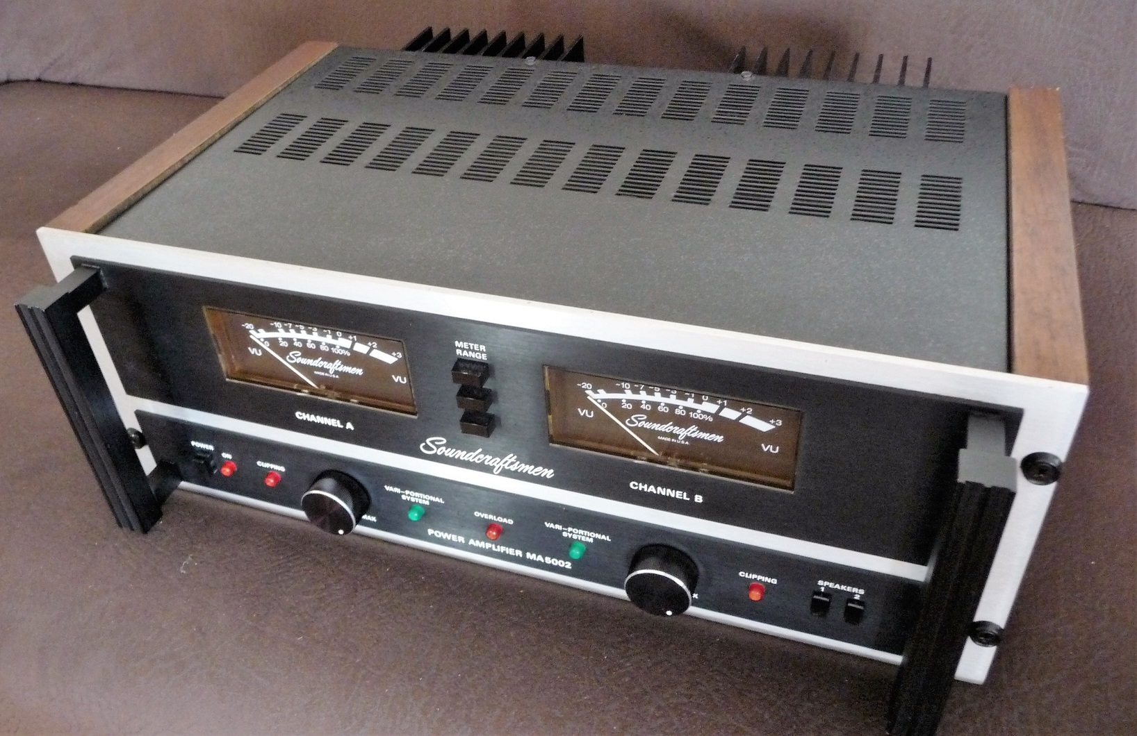

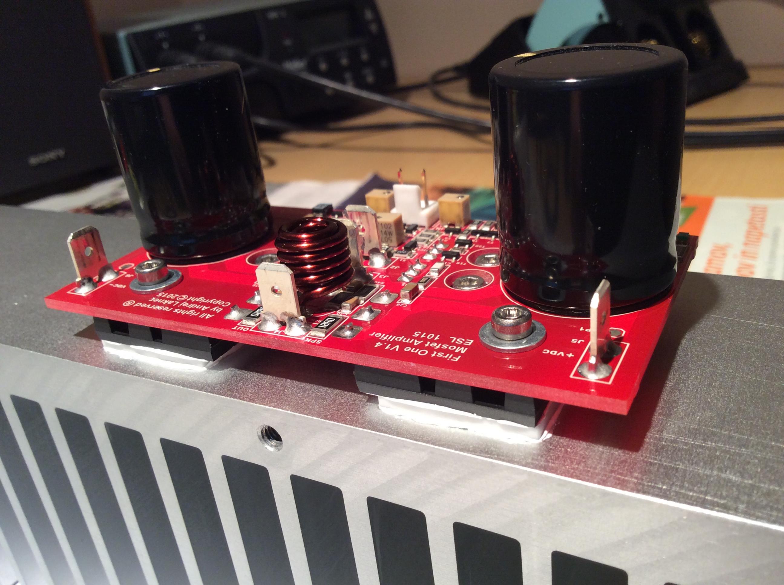

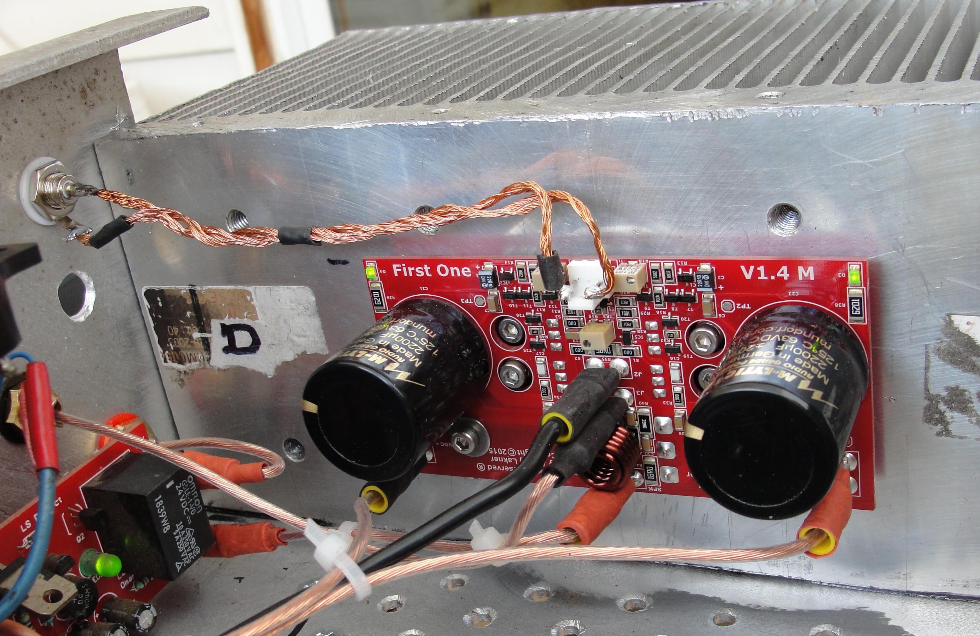

New heart in old body
Hello all,
here is example how to put new heart into old body (sorry for bad picture quality). I know, it can make better, but this is good enough for me. Important is sound. Now I have true natural sound. All what is on compact disc come thru TA-E9000ES, FO 1.4 and Altec Lansing fiften into my ears. No more need to go to the opera or another concert. Thanks Andrej.

Alumina (aluminium oxide) is much better than mica and kapton in conducting heat, see page 25 in EUVL's article for a comparison with 1mm thick alumina
I bought some Alumina on AliExpress.

You're welcome dd16. That's exactly what I had on my mind designing First One, revive old amps with fresh heart and soul, congratulations. :worship:
Thanks for the info about aloxide thermal considerations Danny. Actually what I had on my mind speaking about sound quality by using AAVID 4180G is to have even more isolation from surrounding environment, meaning less capacitive coupling, less unwanted interference feedback, resulting in greater details precision, better soundstage and relaxed presentation. The cost of aloxide isolators compared to gained benefits is negligible.

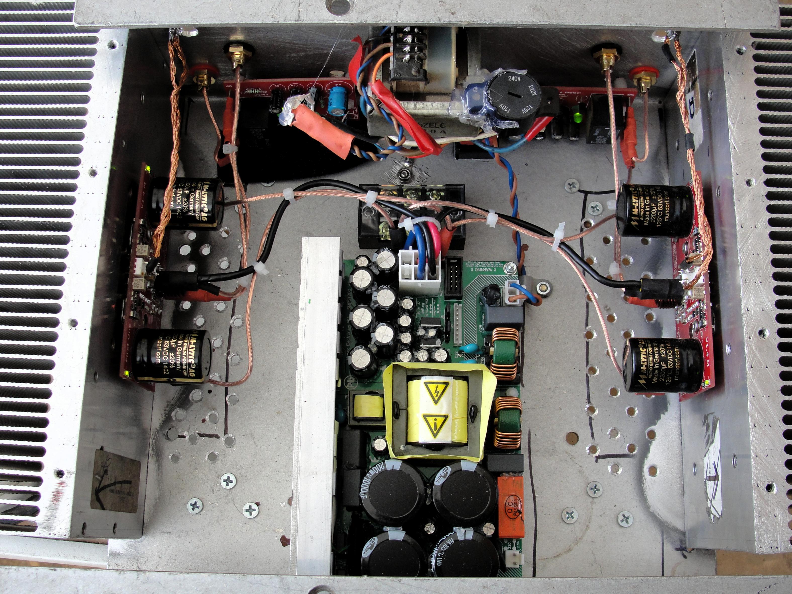

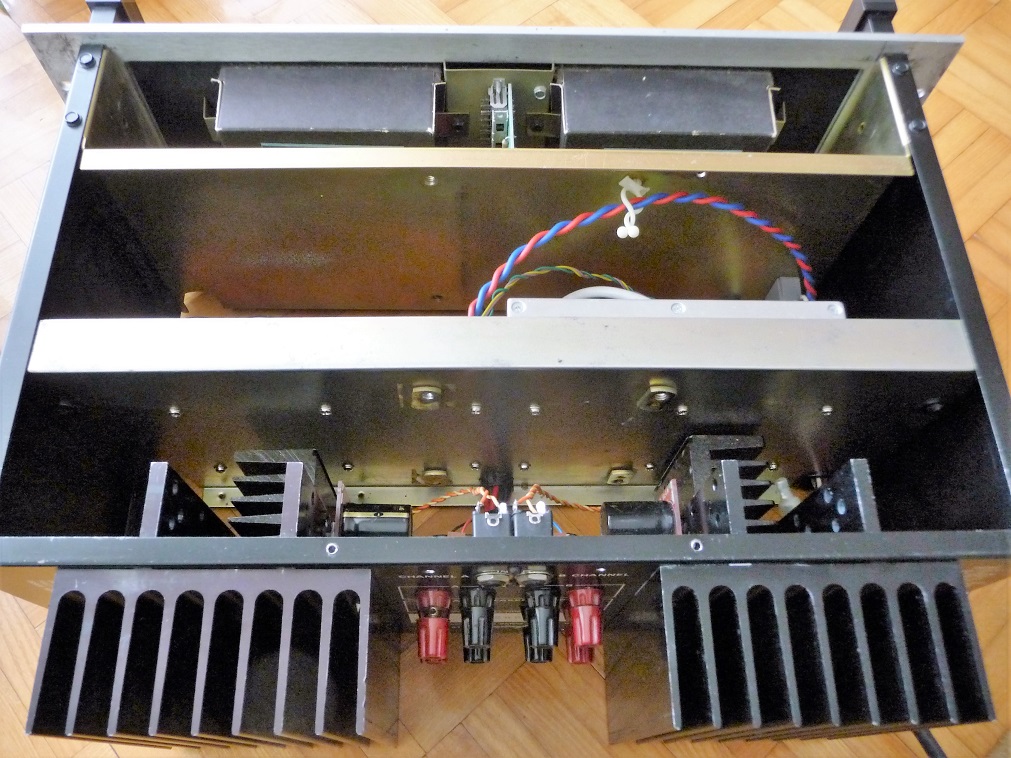

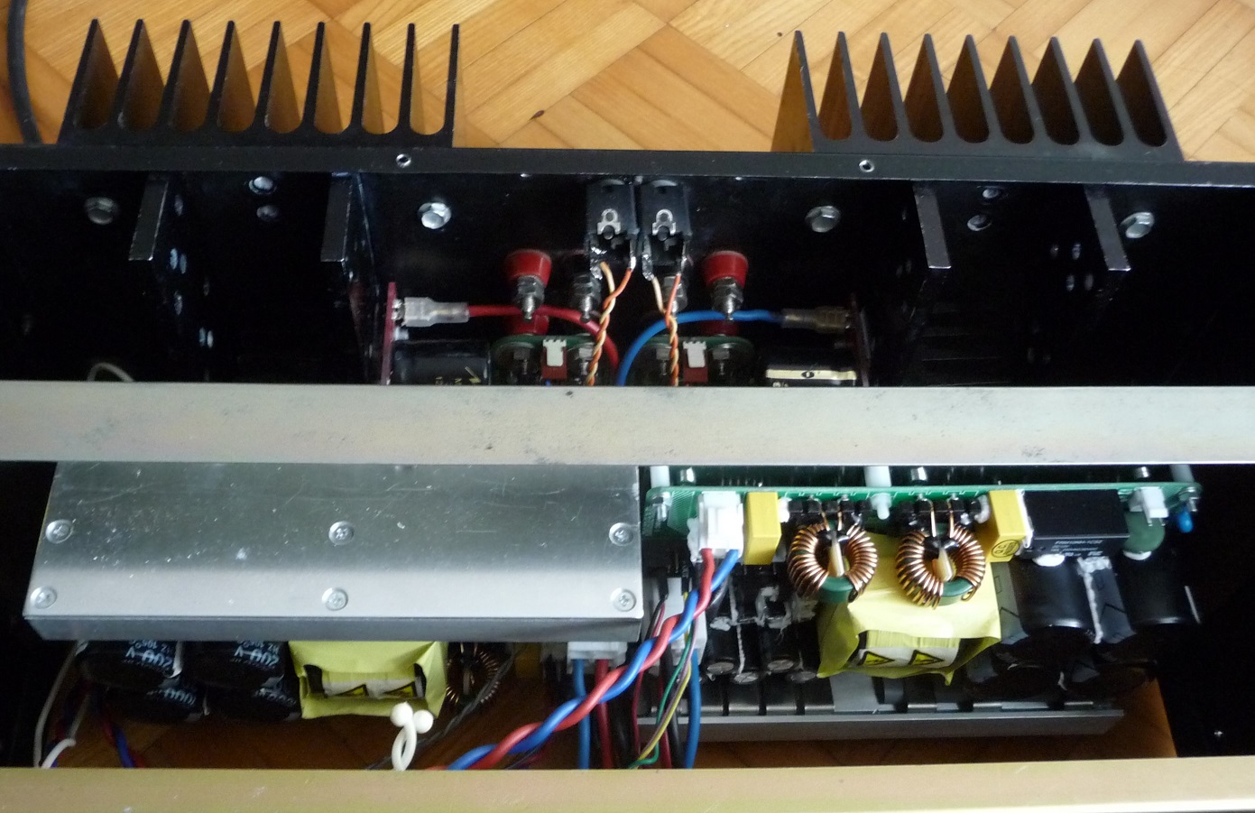

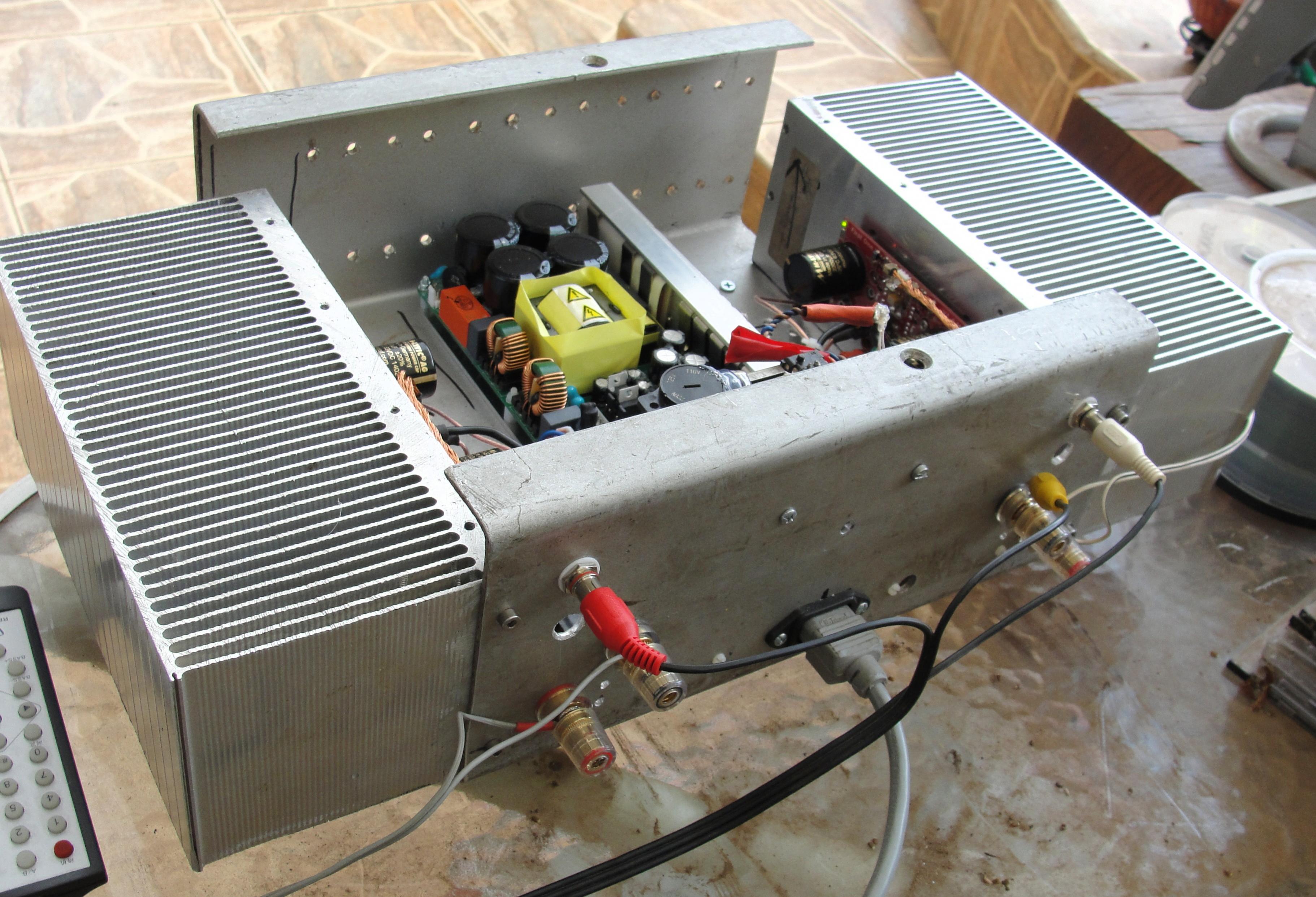

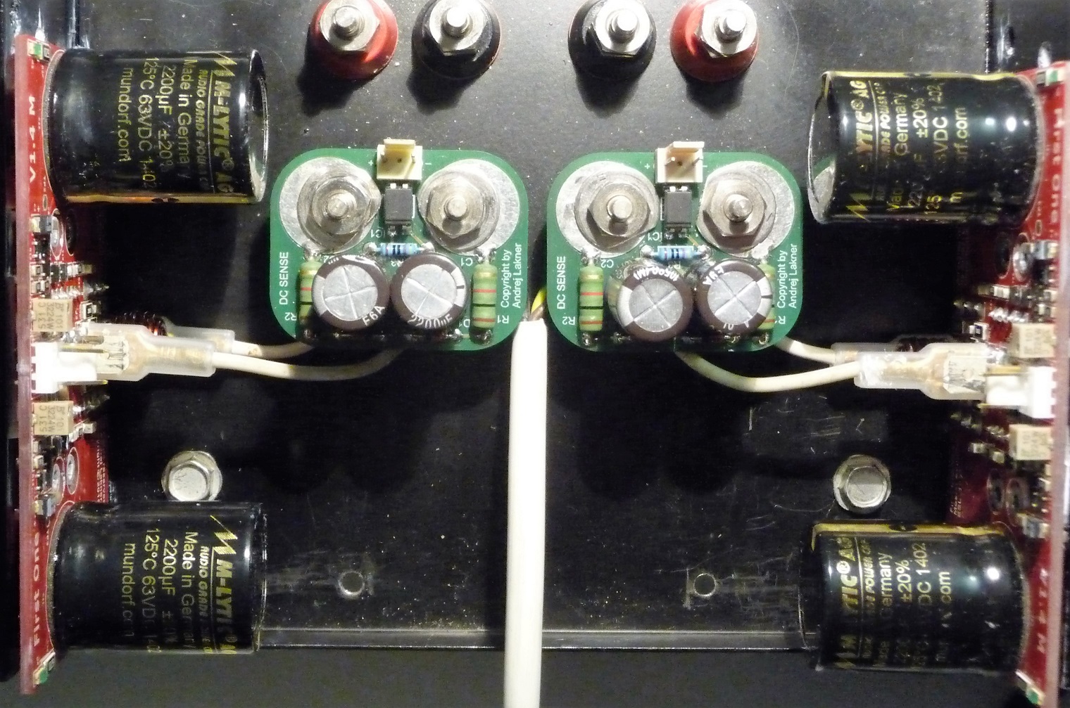

Another First One is born.
After some delay while visiting the lakes (we are in summer here) I completed my F.O. in three days, of which half were only DIY (ugly) case work...
Everything went OK, safe for my tiny accessory Tx which couldn't cope with the task of powering the speaker protection modules (from another project), so I had to use a bulky EI Tx, which deprived some of the beauty of the amp... 🙁
Now in use in the "patio" system for braking-in and eventual re-calibration, so no comments yet about sound.
Heatsink warm to the touch. 🙂
Some ugly pictures...

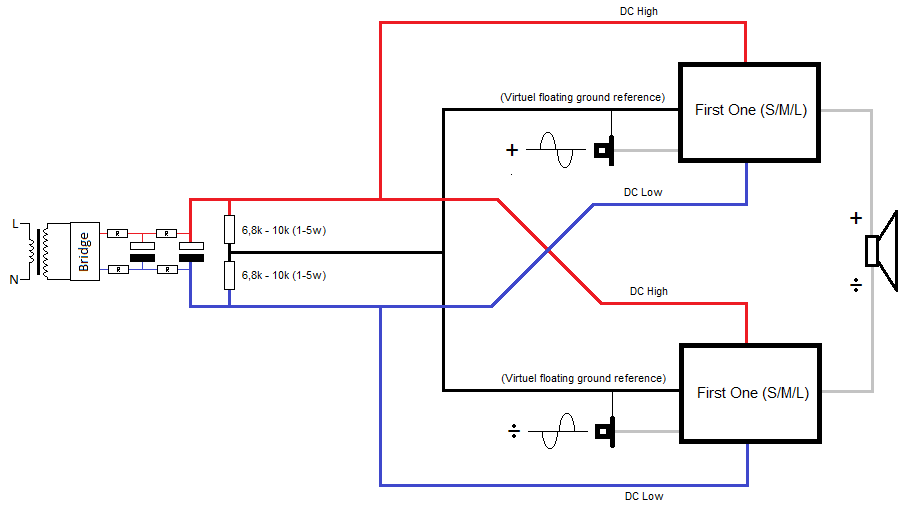

Leikis & ani101,
If you have fully balanced pre signal and know from start that you want to setup FO build as bridged there is benefits in below wire ring schematic setup. Special is PSU is not balanced so all the normal mess of common ground points is the force here and can be seen that signal ground is fully floating. Personal have not equipment to measure and document benefits but have amp that is setup as below verse single ended and subjective it is very hifi setup that also think should be logic when thinking over benefits in schematic. Member metallicus69 did a build as this over at Lacy Cat's VSSA thread which can be searched at, and only drawback spec told us by member Esperado that me miss very much seems to be speaker damping factor that will double.
Because bridging is normal a 4x power sum with same PSU and impedance load then PSU voltage and load needs attention. Lets take a FO example where at 8 ohm spec is 160W so bridged will output 640W. That would kill output devices and reason is each FO in bridged mode see only half of the load 4 ohm, so bridged mode needs lowered supply voltage probably to half, and you will have to ask Lacy Cat if 4 ohm load is allowed at all in bridged mode and supply voltage needs decreased further because FO bridged at 4 ohm will look into 2 ohm only.
A guess is FO modules bridged with 8 ohm loads and half supply voltage for M version will output 460W and S version will output 240W (numbers is FO modules output power to 4 ohm x2).
Link good info for bridging at Wikipedia https://en.wikipedia.org/wiki/Bridged_and_paralleled_amplifiers
