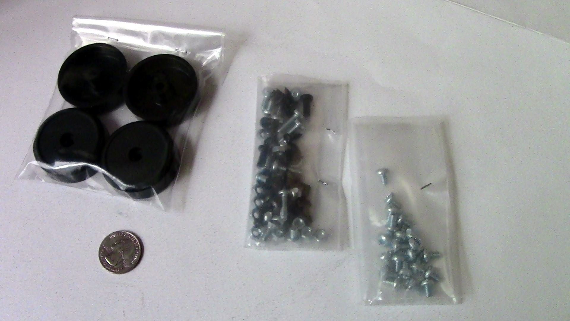

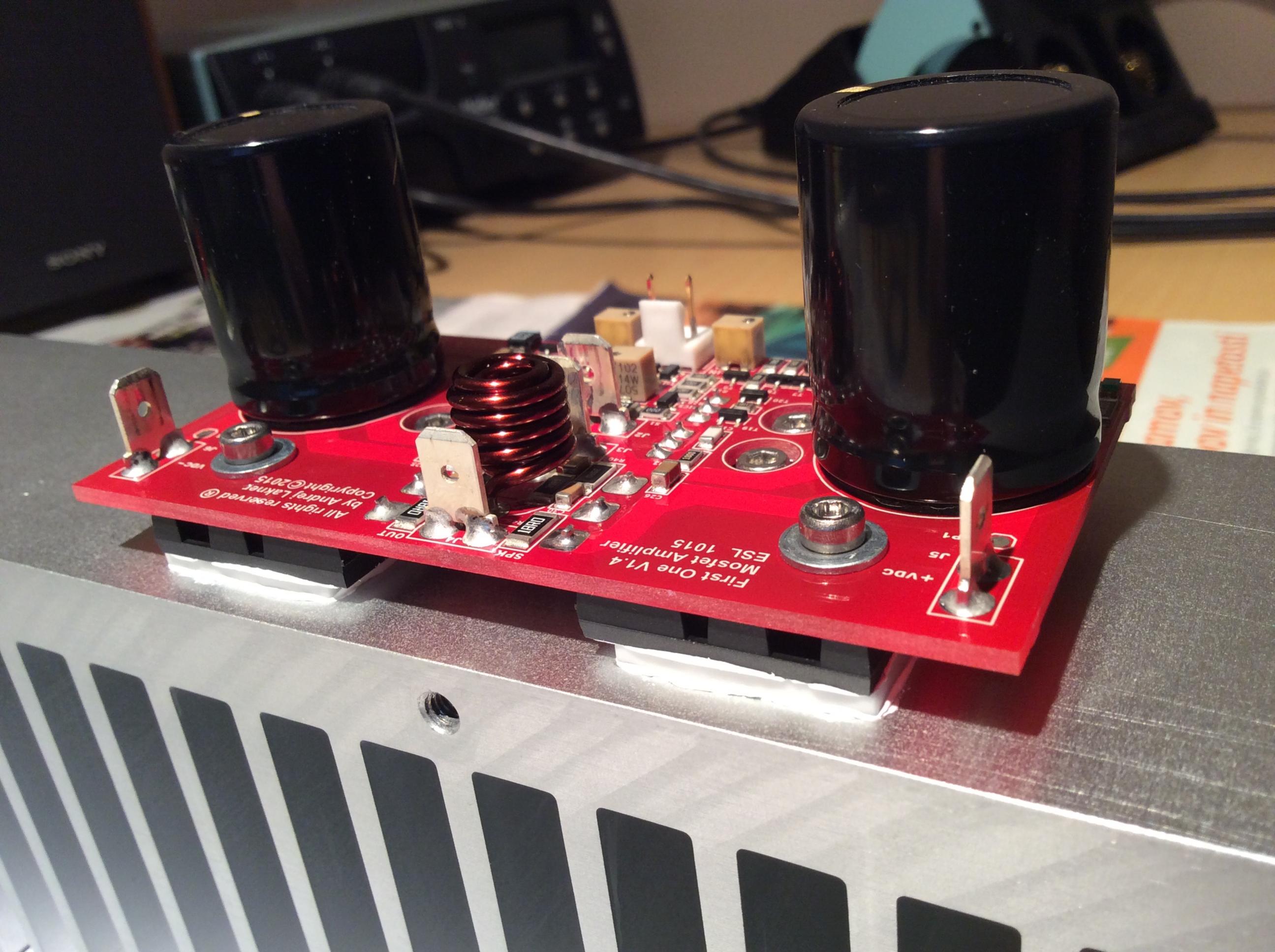

Got Chassis today...
Boy, that was fast!

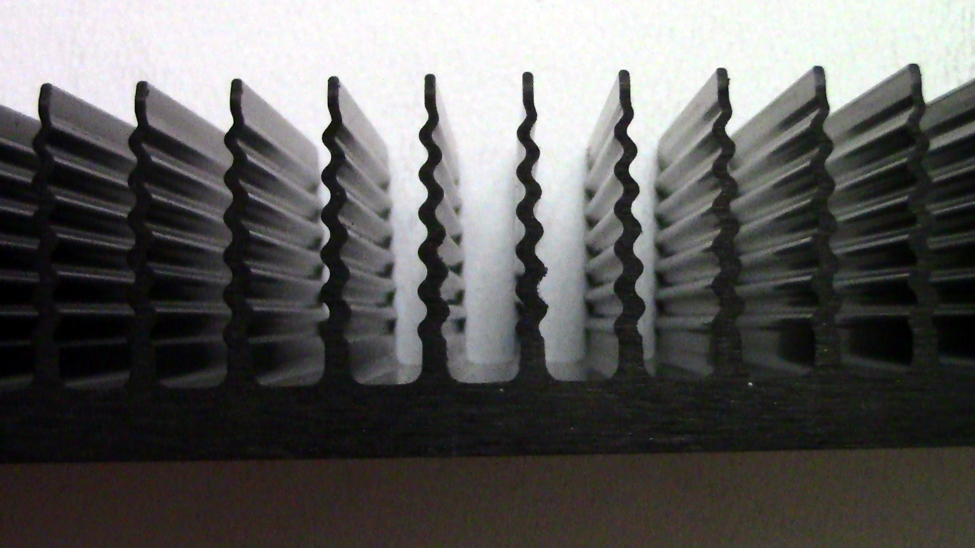

This is a very nice Chassis, better then I expected as there is a lot one does not see in the on-line photos:
The "Standard" feet are large. 🙂

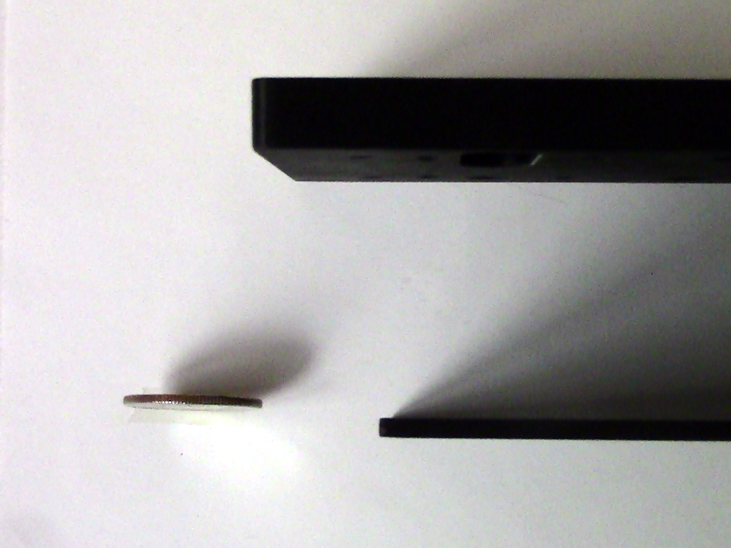

The 10 mm Aluminum Face Plate is substantial.
The 3 mm Aluminum panels are plenty rigid enough for the Hypex SMPS.
(I scaled the above with an American quarter. 😱 Sorry, I do not have any Euros.)
And last, but not least, the heatsinks that comes with these chassis are premium with ridged fins. 😀 ... I have no doubt now, this will be sufficient for this amp.
These chassis do ship un-assembled, which works good for this First One build, as I will be drilling and cutting holes (for the Hardware I still need to source 😱).

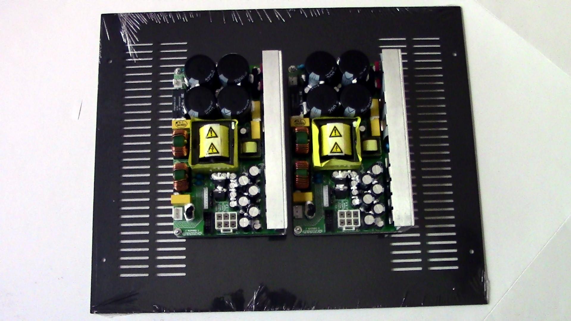

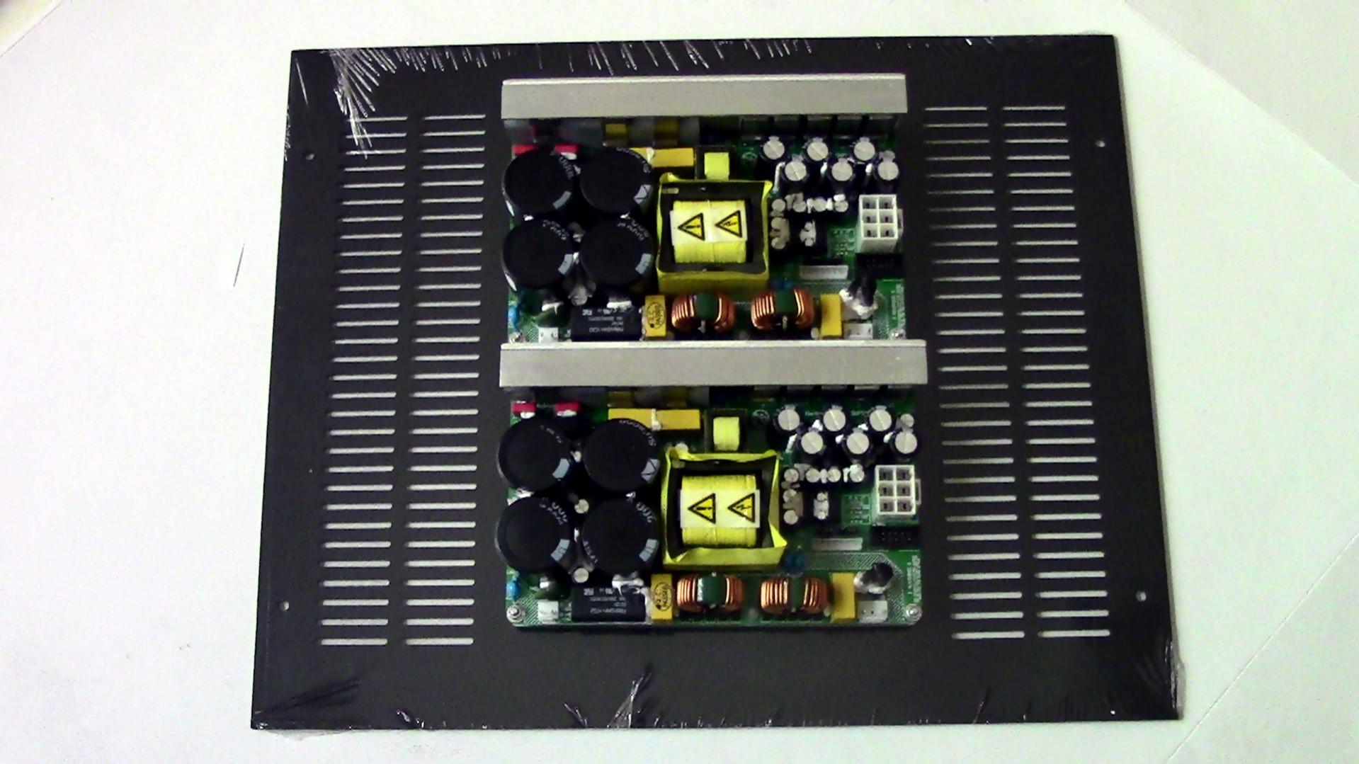

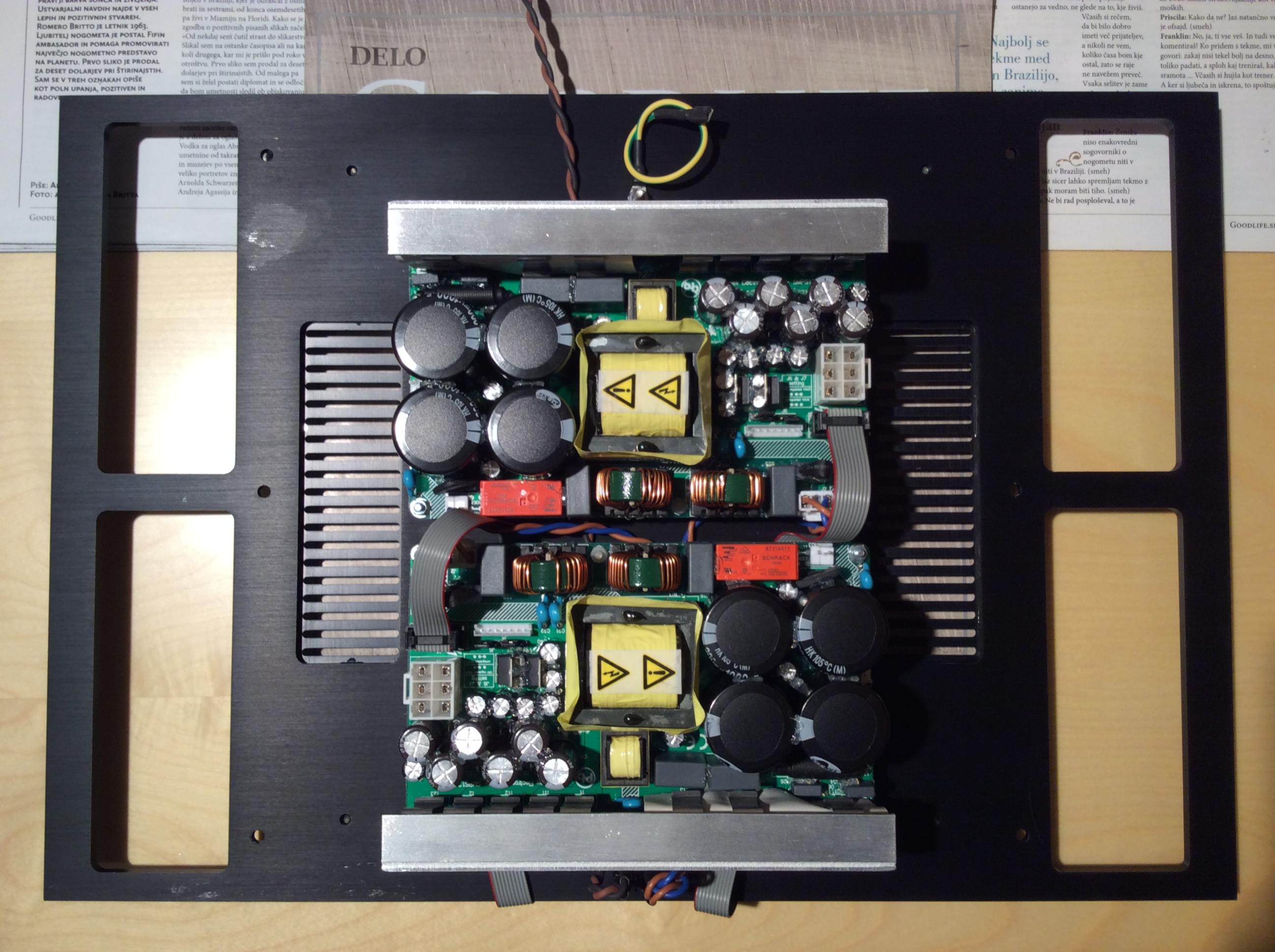

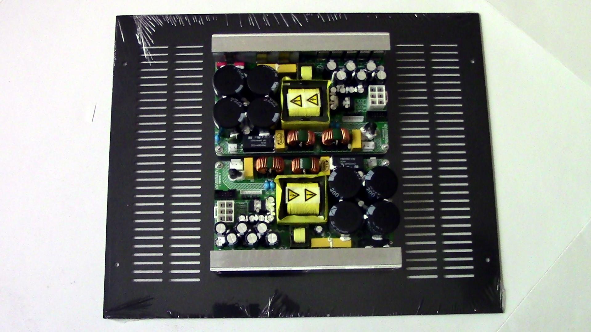

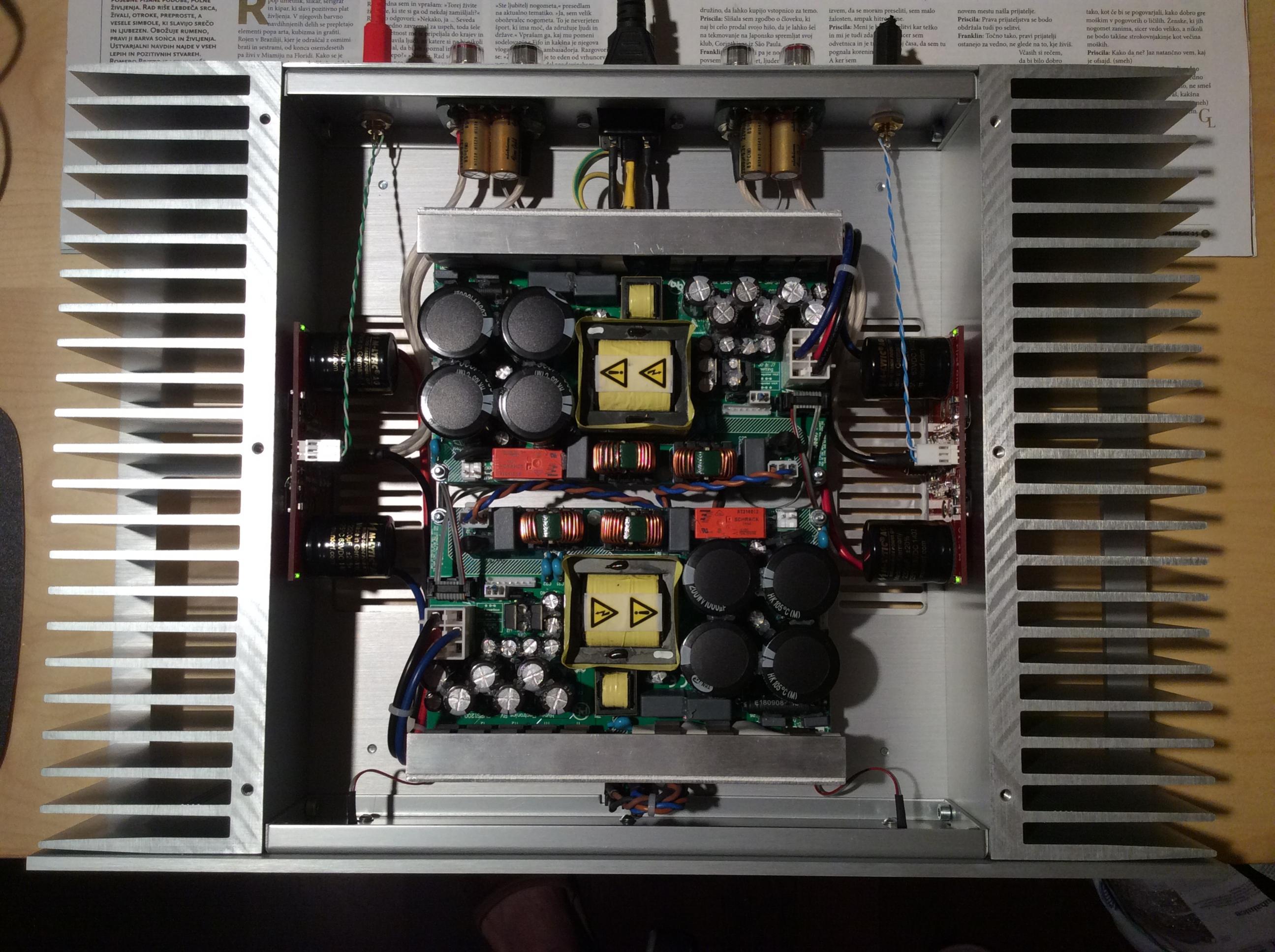

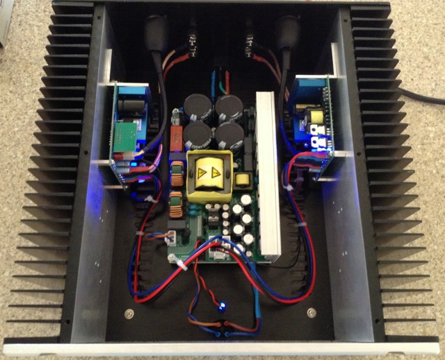

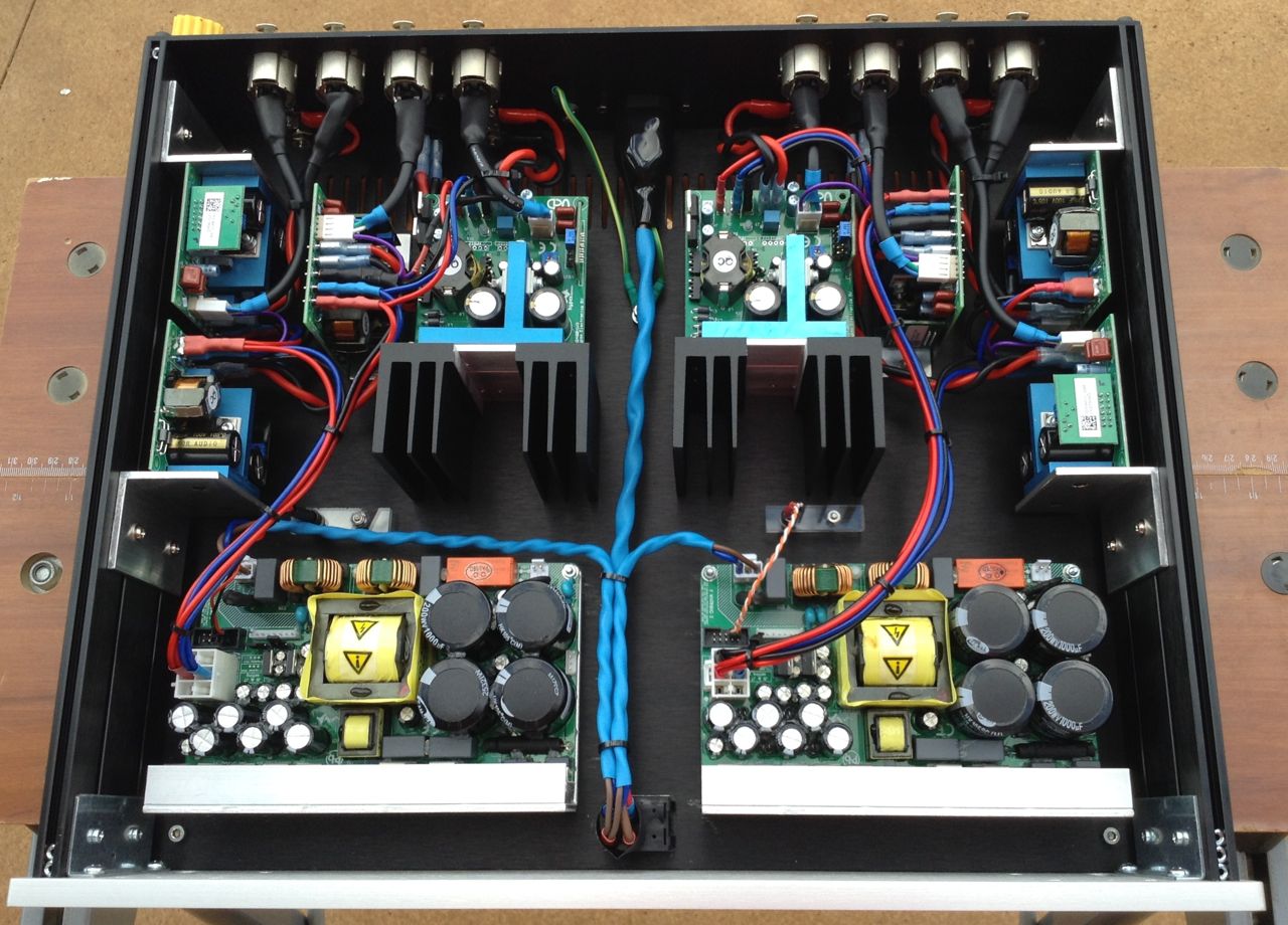

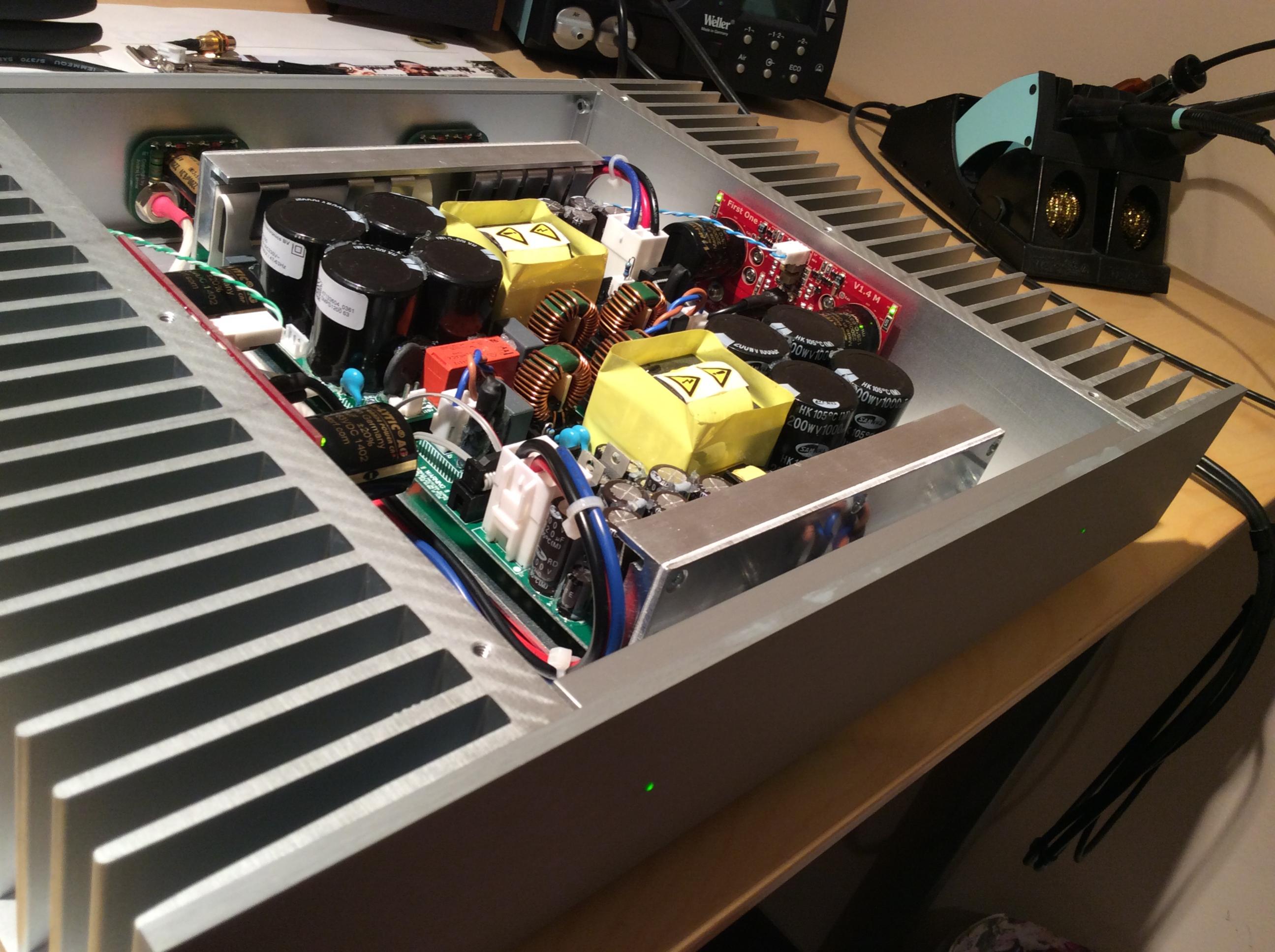

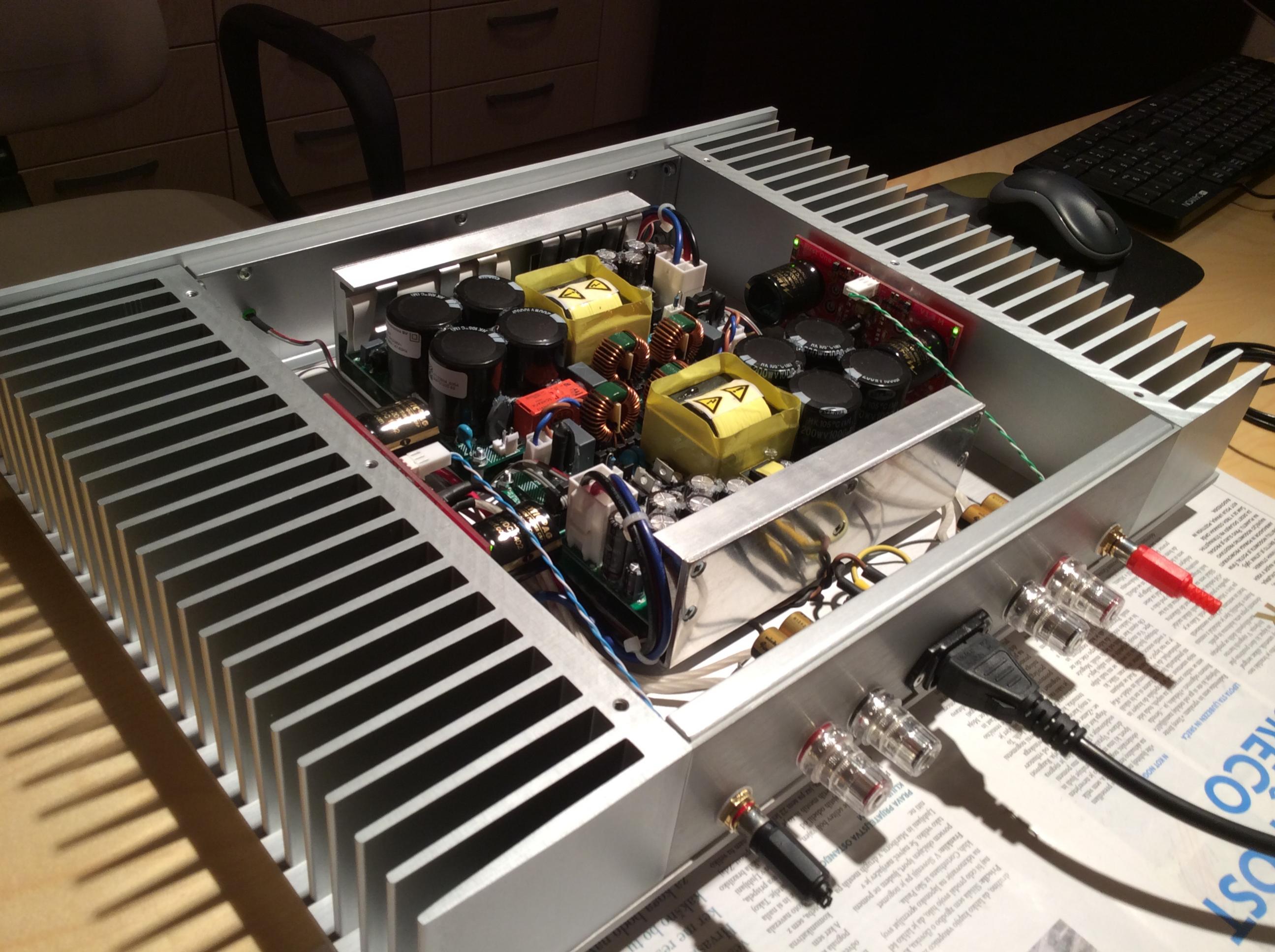

SMPS orientation?
If I recall, Lazy done a study on the best layout of the SMPS.
From what I can see, he lays his dual mono SMPS out horizontally, with the steel shields facing out, like in the first photo.
I have seen others do it vertically, like the third and forth photo.
What are the pros and cons of each arrangement, if any?
The first photo works best for the layout of the vents on the bottom panel of my Chassis.
Again, if this has already been discussed in great detail, a link is always welcome. 😉

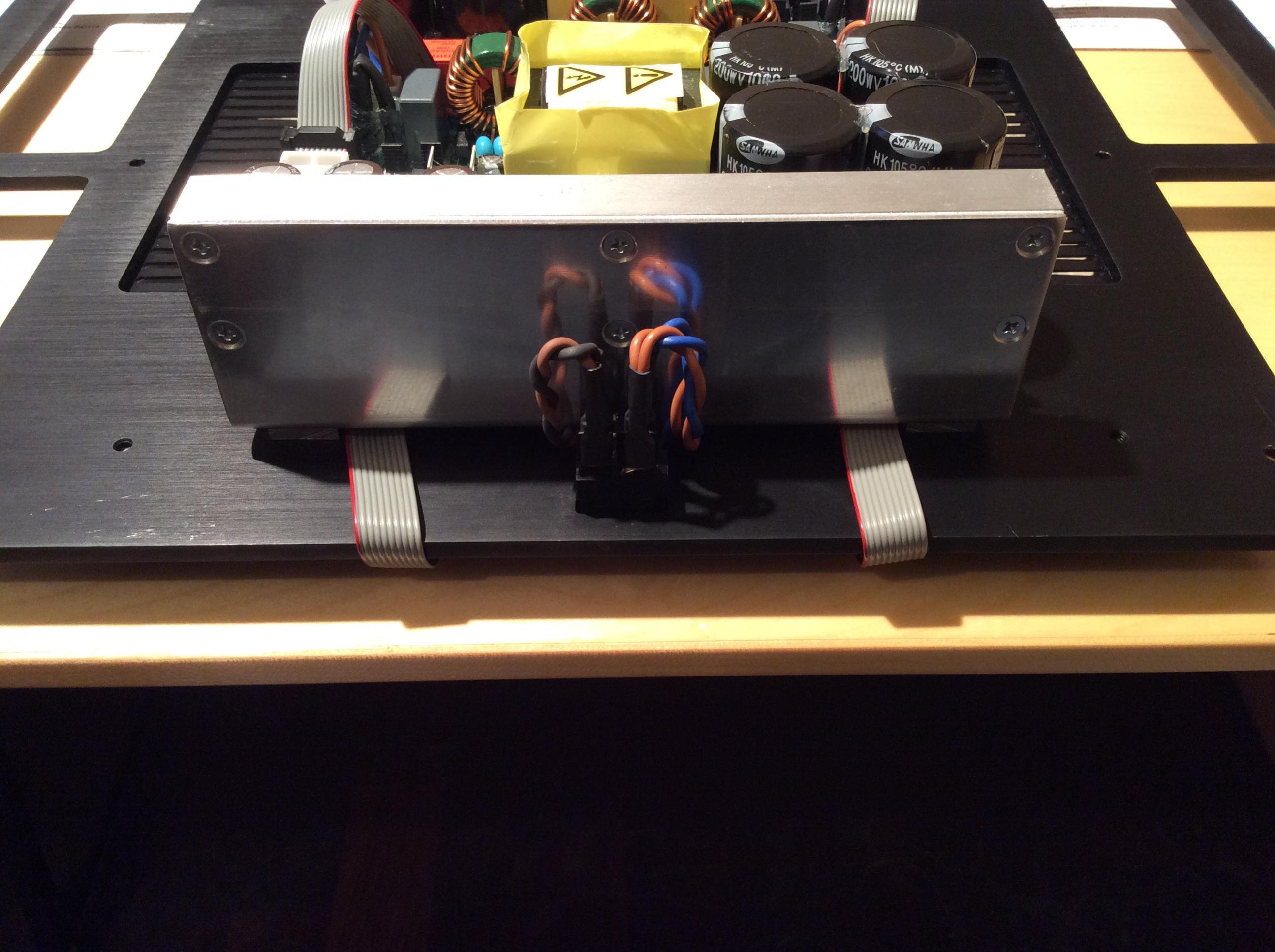

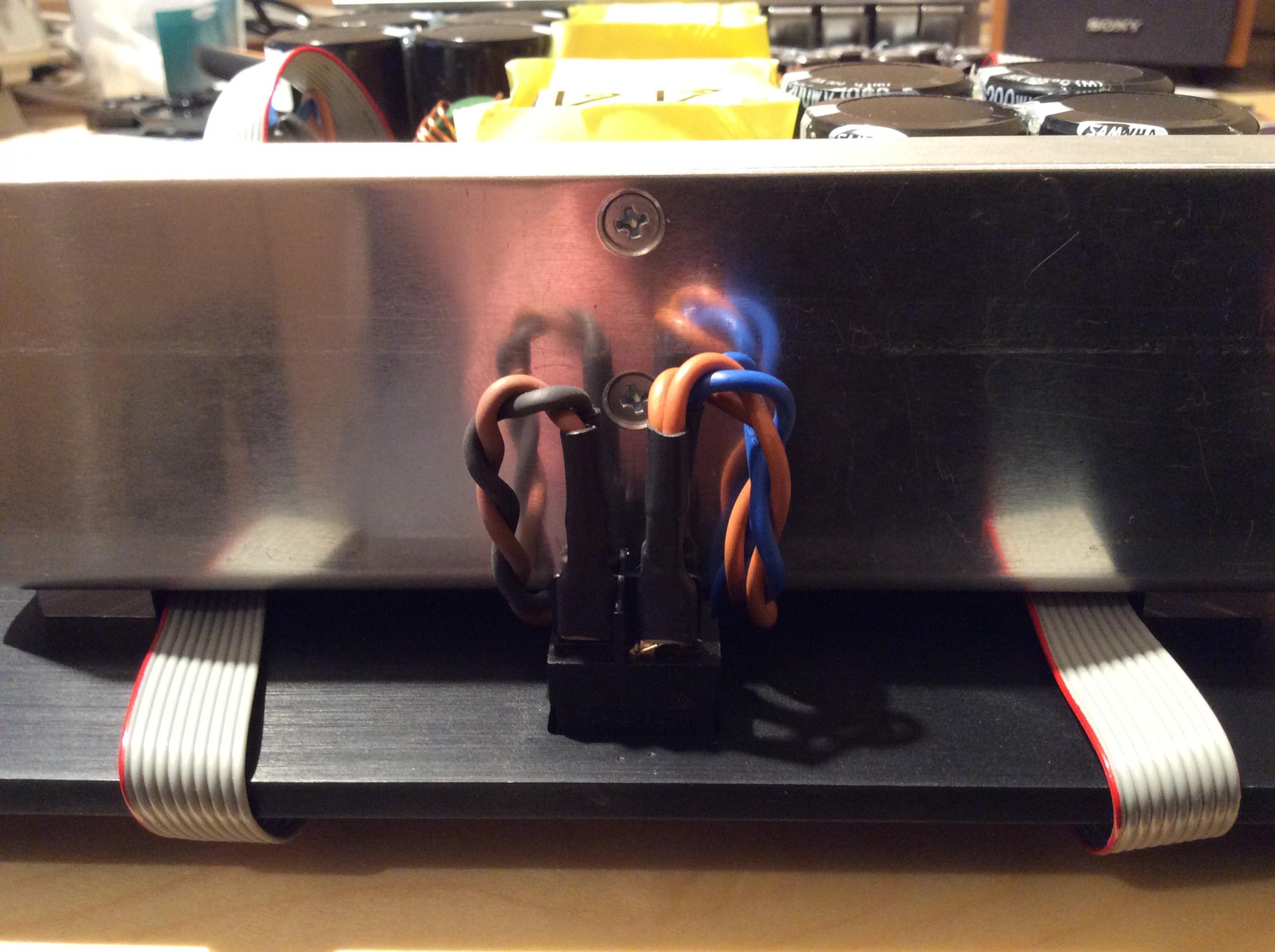

Hi Allen,
I think that this picture is the best layout
This allows the neatest wiring from the power supply to the modules on either side as the output DC wiring is already closest to the modules and will result in the shortest cables.

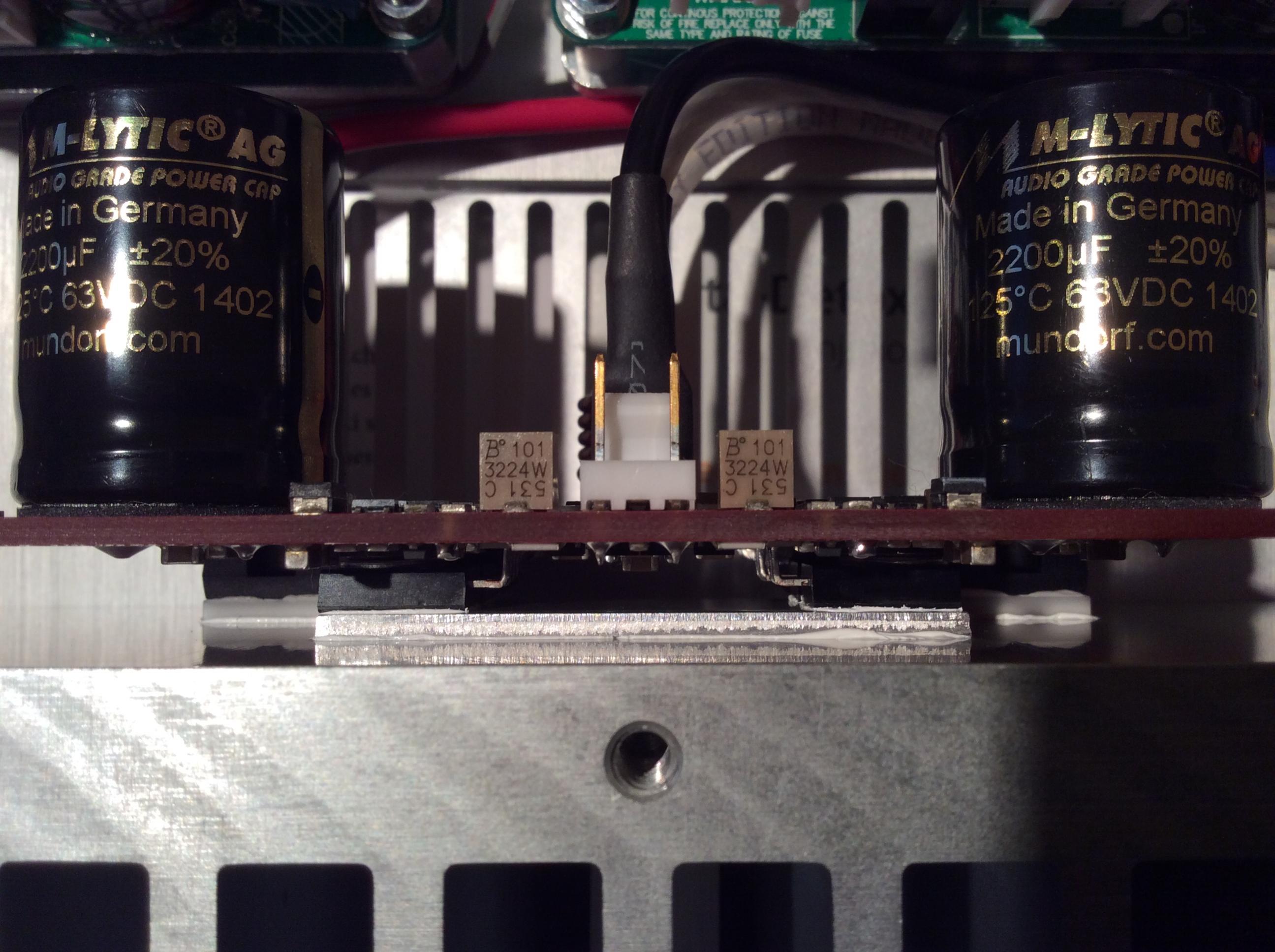

My advice is to use some 10mm male threaded hex standoff's to raise the SMPS off the chassis as this will allow you to pass the power wiring underneath the SMPS from the back to the front via a power switch and under to the mains input connectors on the power supplies which are in the centre in this arrangement.

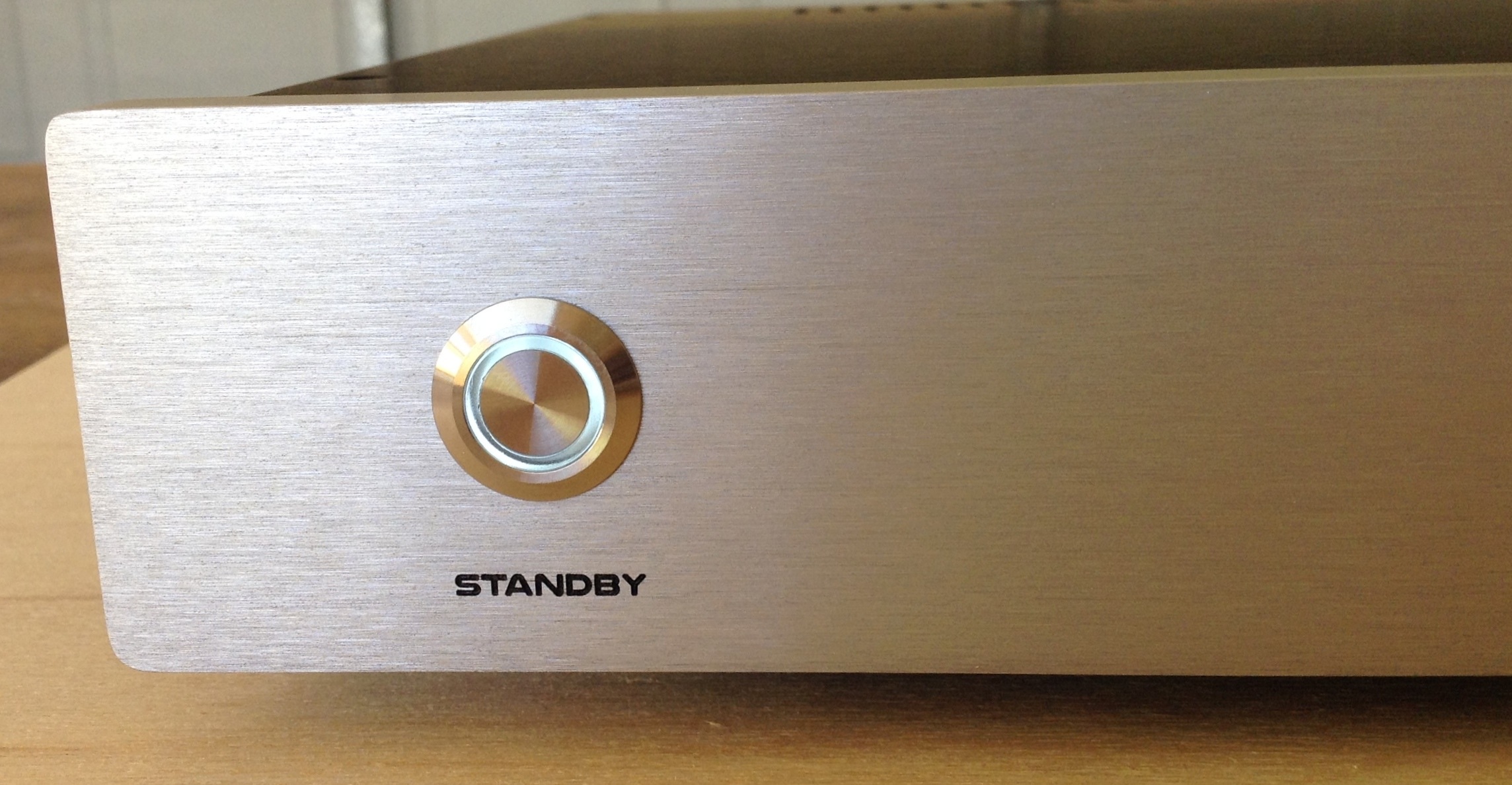

Please do not cut a hole in the faceplate unless you intend to use a vandal proof push switch!

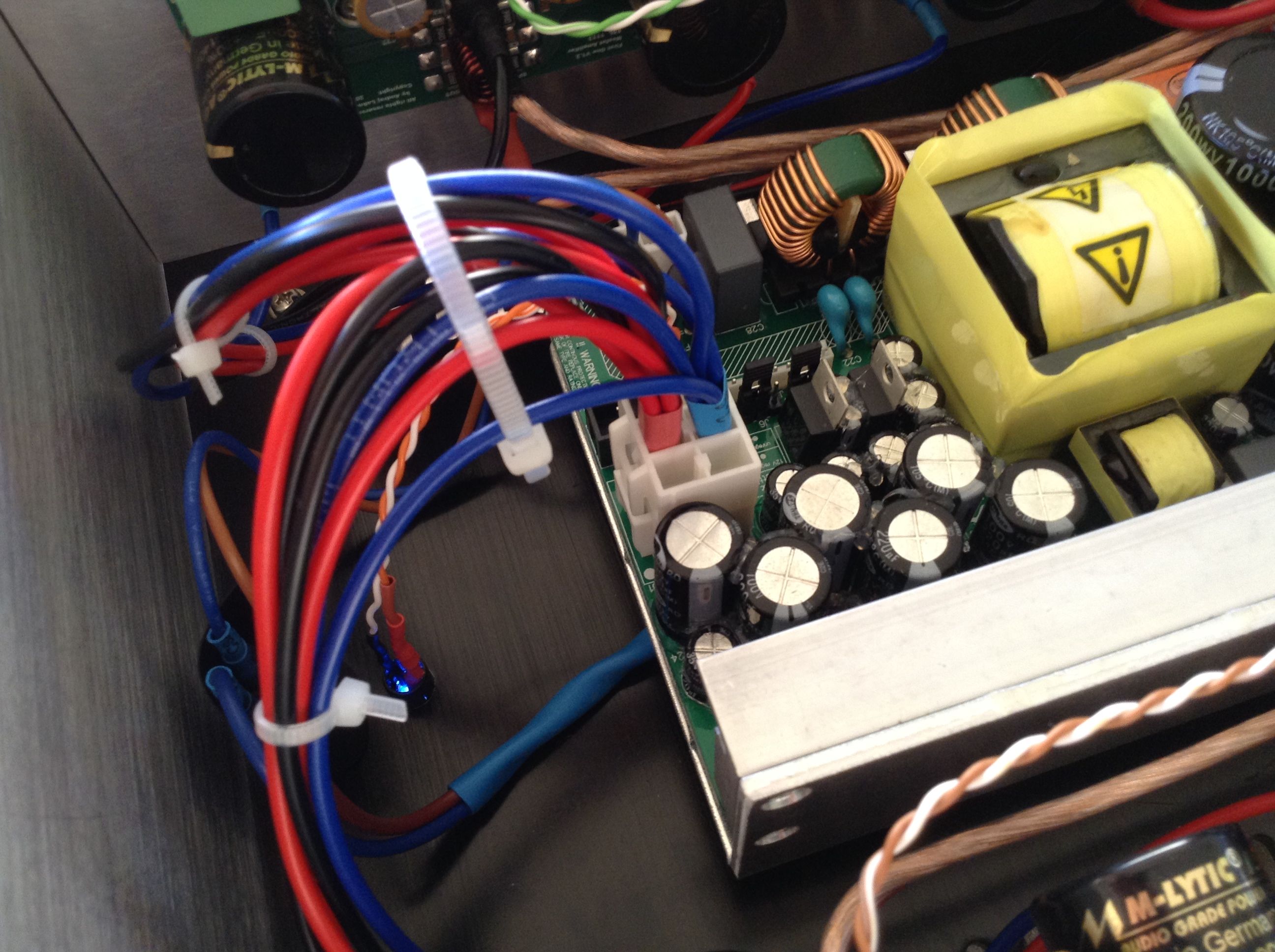

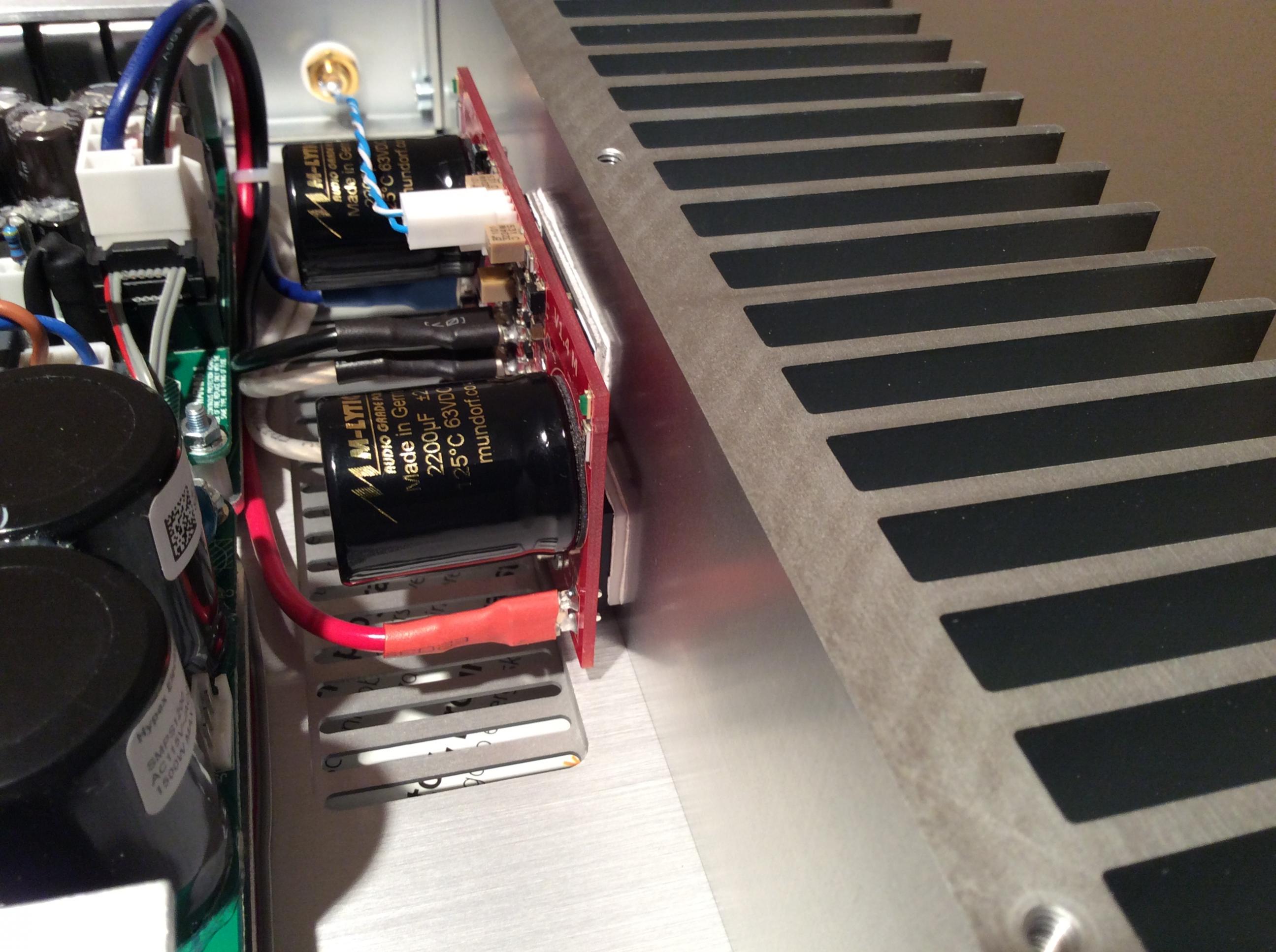

I copied LC's power switch and added a twist of my own. I mount the power switch on the bottom of the enclosure at the front ( same as LC) I then mount an LED behind in a panel mount to the bottom so the on indication is a blue glow underneath the amp. This stops the LED from boring a hole through your head when used in the dark!
As long as you use tall enough feet all you have to do is slip your finger under the front of the amp and turn it on. You can get small switches witch 4.7mm connectors that would work with the thin wires from for the Hypex mains power connectors.
Here are some examples of my amps where I have used this sort of wiring scheme.
First One Switch is a bit hidden behind the wiring but you can see the LED mounted
Stereo Hypex amp with the same wiring viewed from the top
8 Channel Hypex amp with exposed wiring for more clarity
Hope this helps.

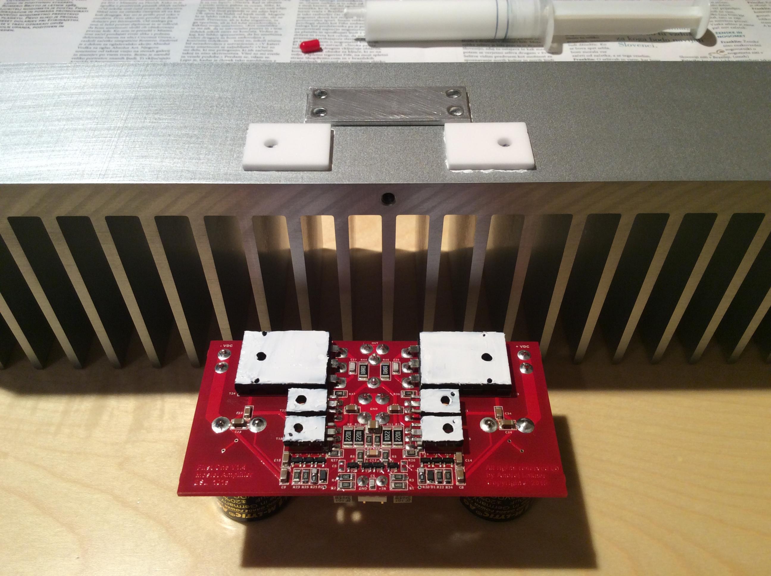

Allen, few details to observe. 😉

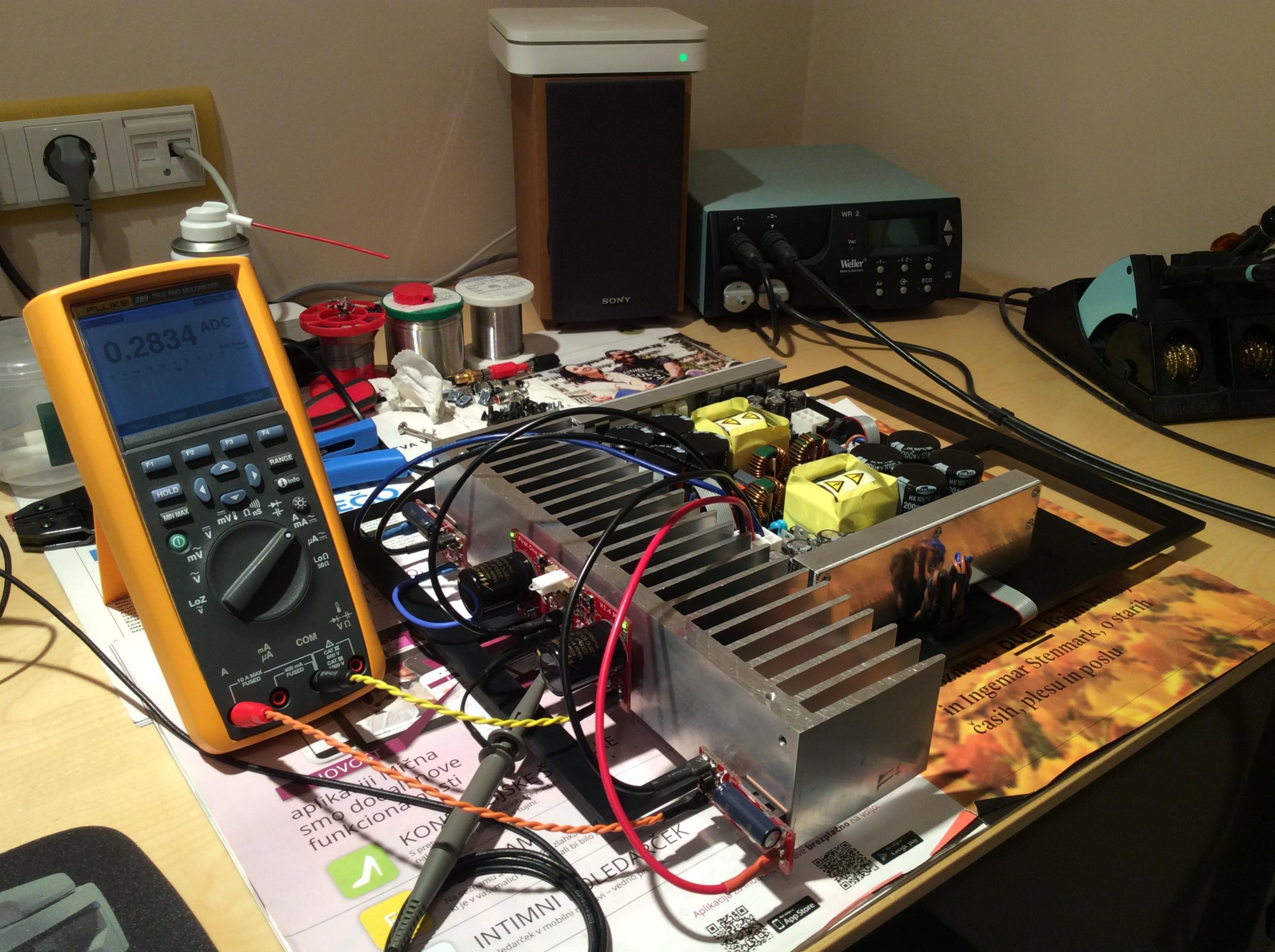

+/-48 V calibrations done
Sometimes I do custom jobs, like today's calibrations for special customer. 😎
P.S. Note 48 V serial regulators on each side of the heatsink, made according to sch above. Both 48 V rails clean as baby's booty. 😀
First One S, M and L having exactly the same voltage gain +27,5 dBWill both FO1.4M and 1.4S have identical voltage gain of a +27dB?
The reason to have an equal gain lies in compatibility with system integration to bi-amping or active powered speakers.
Did-you made measurements you could share on:P.S. Note 48 V serial regulators on each side of the heatsink, made according to sch above. Both 48 V rails clean as baby's booty. 😀
The Hypex voltage drops with curents... Noise curves with charge... and the difference after extra stage ? Why 48V ? A typo, or the necessary margin to compensate Hypex 63V drop at full load (15A) ?
High-End customers have special requirements. There will be First One amplifiers running on 48 V LiPo batteries, I just saved some time so the modules could be installed in no time. Now imagine the sound when amp's PSU are fully charged LiPo batteries. 😱Why 48V ? A typo, or the necessary margin to compensate Hypex 63V drop at full load (15A) ?

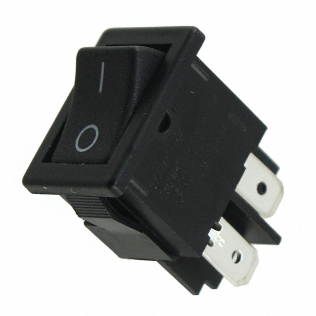

I really like the vandal proof switch. They seem to have weird configurations: Off - (On) - (maybe the anti vandal part?), but I will keep looking. Basic (with these aesthetics) DPST Off - On or On - Off is what I want...
Not sure on what ratings to buy.
Each SMPS is 1200 watts, so at 125 volts, that is 9.6 amps/SMPS, so with two SMPS I need a 20 amp switch. But it does not appear the switches everyone is using is rated this high, so I have something wrong with my calculations, or I am getting something mixed up. It looks like Lazy used a DPST, which is what I was wanting to use...

The switches do not need a huge current rating as the SMPS is soft started
I really like these smaller switches from arcolectric 15A rating and only a couple of dollars, switch on transient current is something like 150A rating so they will last for a long time
H8550VBBBEN551W Arcolectric | Switches | DigiKey
The vandal proof switches are expensive for nice ones with 3A or more current rating. If you use the separate Hypex soft start board then you can use almost any momentary switch to turn the amp on or off, but that works out to be even more expensive. i.e go with the $3 hidden rocker switch!

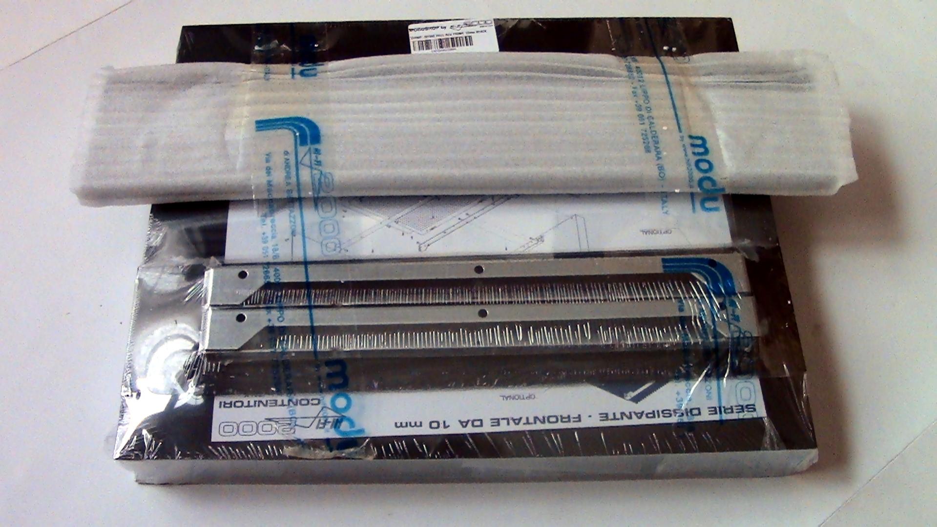

The 2U 300mm Dissipante is the right choice to keep the modules at 45 degrees, you can have the whole case made will aluminium panels as an option and this will transfer some of the heat from the sinks to those panels as well and the 10mm thick front panel is also a pretty big chunk of aluminium.
You can get bigger sinks if you want but you will be moving further away from LC's recommendations by doing so. If you plan to beat the life out the amp with low ohm loads bigger heatsinks make more sense. Do you actually know how much power you will need?

Applying an external 5V DC voltage to pin J5.1 will put the SMPS1200 in standby.
Of course you must use a small switch or a remote control or a remote trigger to provide this 5V to pin J5.1
