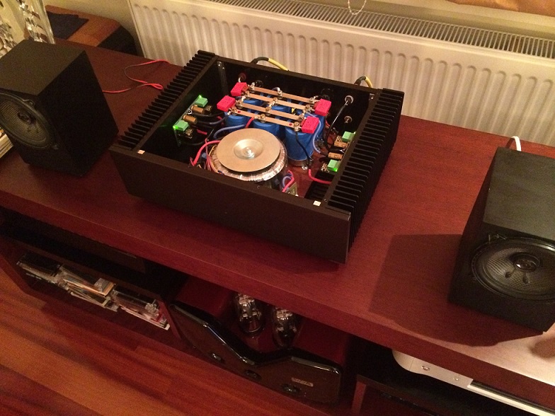

When I was thinking what PSU to use for FO 1.4M I was deciding between linear PSU and SMPS from Cresnet. Finaly I decided to build the linear PSU (2x 500VA toroids) because I found some indications from other people, that linear PSU may perform better in bass and also because I was able to build this linear PSU for the similar price as the SMPS from Cresnet. But of course more effort was needed to implement the linear PSU compared to all-in-one SMPS solution. But my second choice was the SMPS from Cresnet, also because Cresnet is comunicative and he provided some measurements on request.

Have tested both PS and must say that the diference is huge.
I don't know if you build a linear with 2KVA trafo and 12 caps Mundorf Mlytic HC+ :)

For example my 500VA toroid is providing ~6% of voltage drop at full (500W) power. + Capacitors are able to deliver 6A reservoir (2x 10mF) at 60V. It means ((+-60V * 6) + 500) == ~1200W peak per channel and 500W permanent. Is not it enough for AB amp of 250W? My speakers are 200W RMS and 300W peak.
