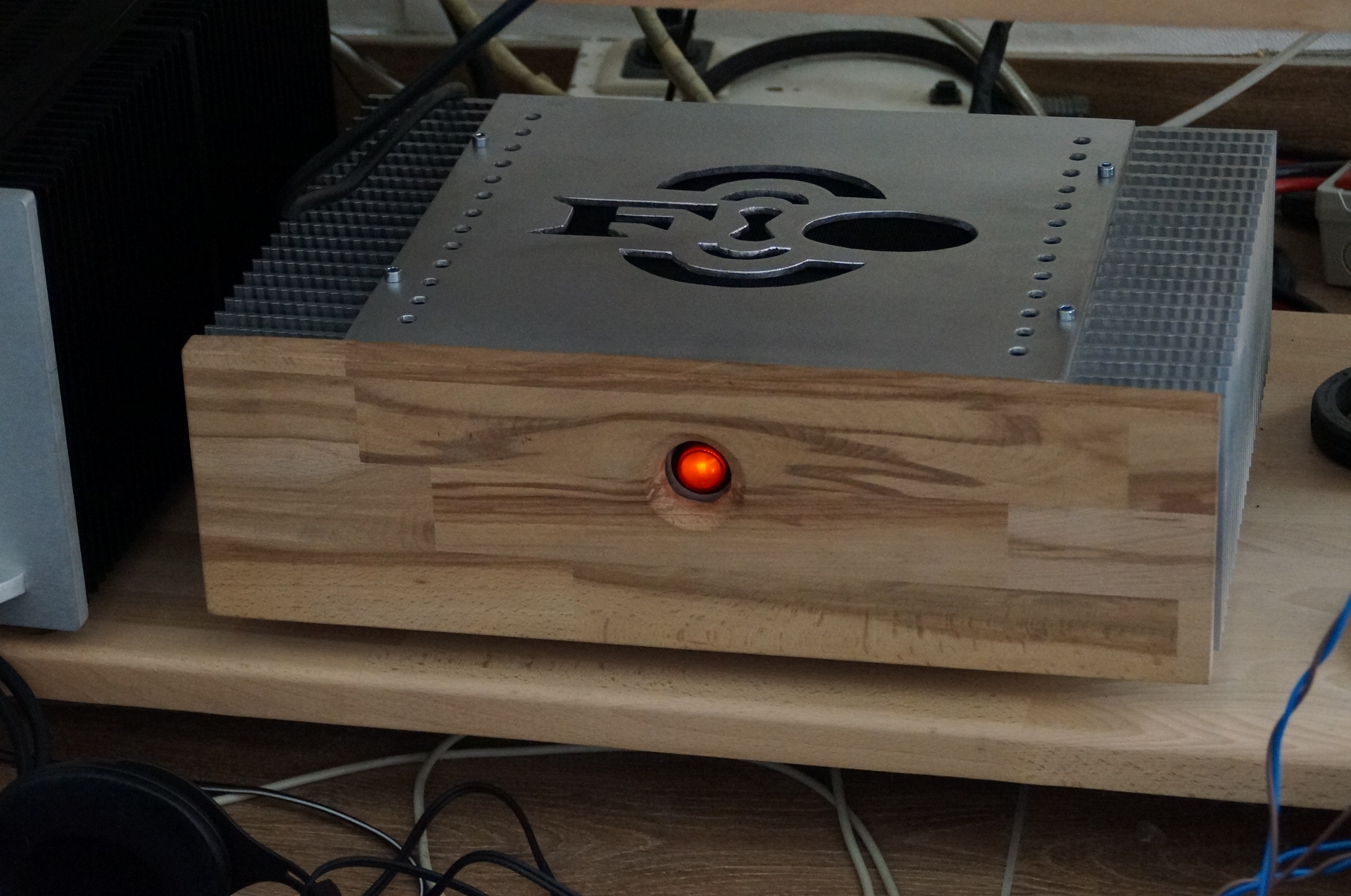

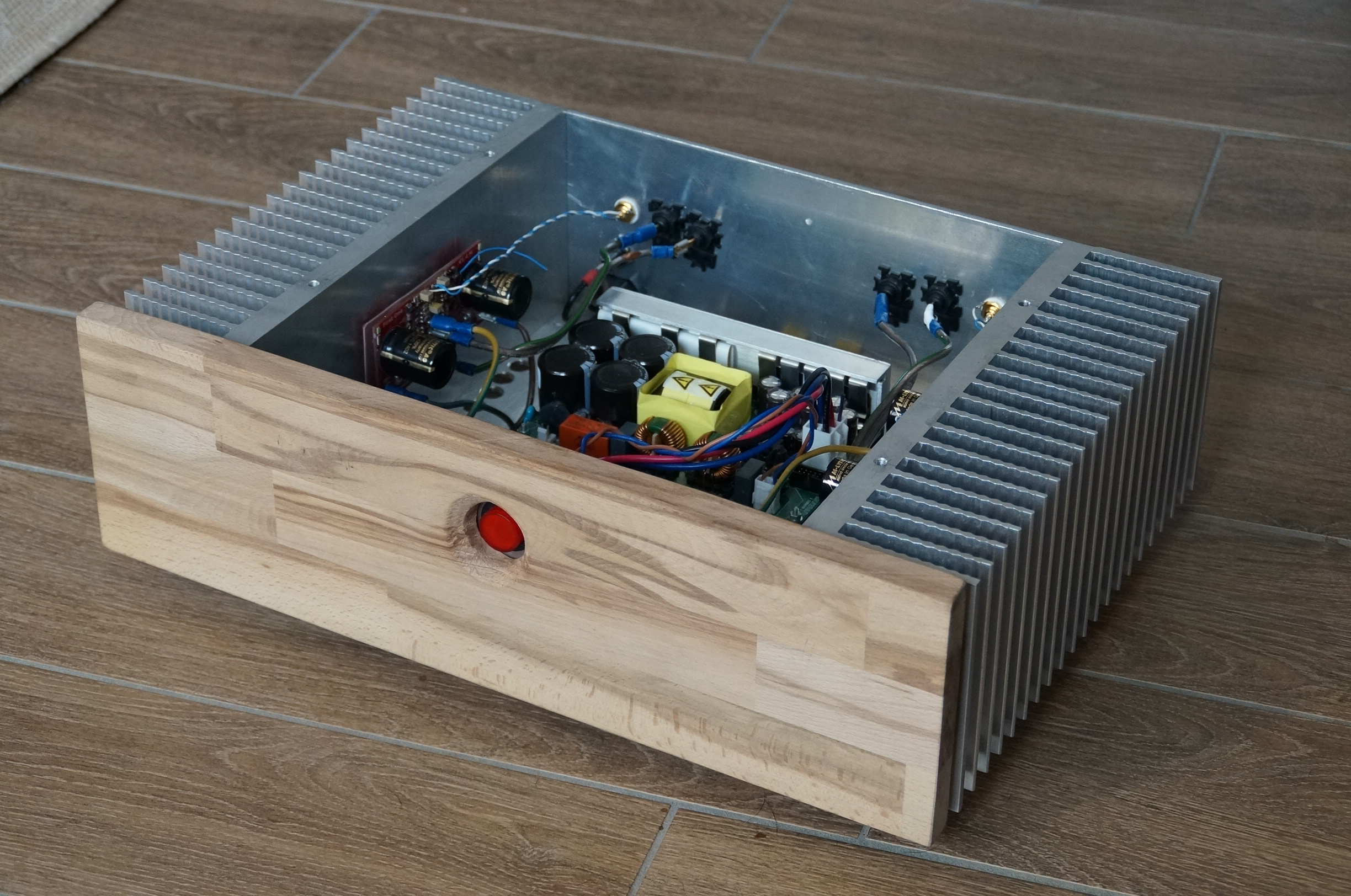

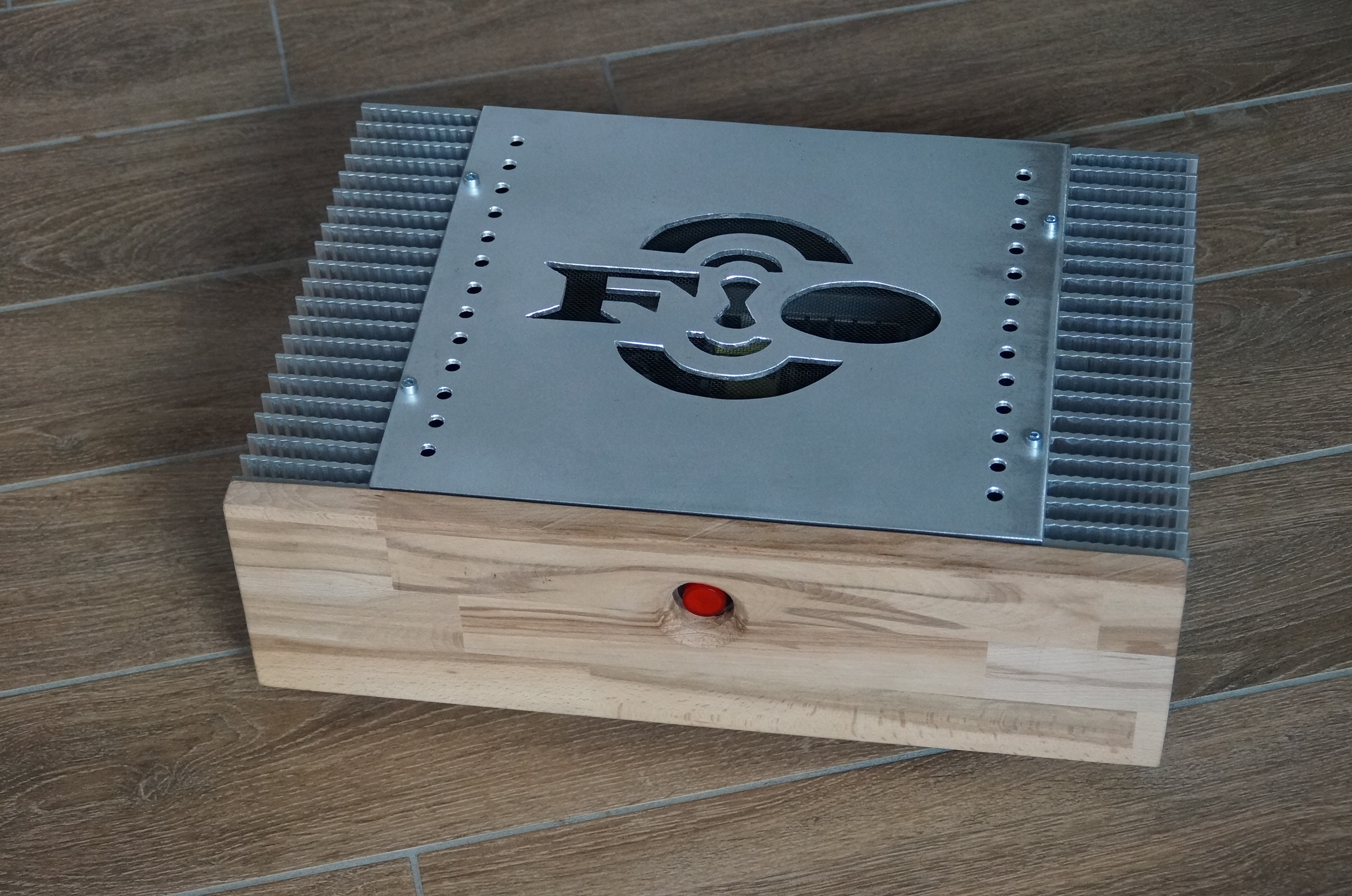

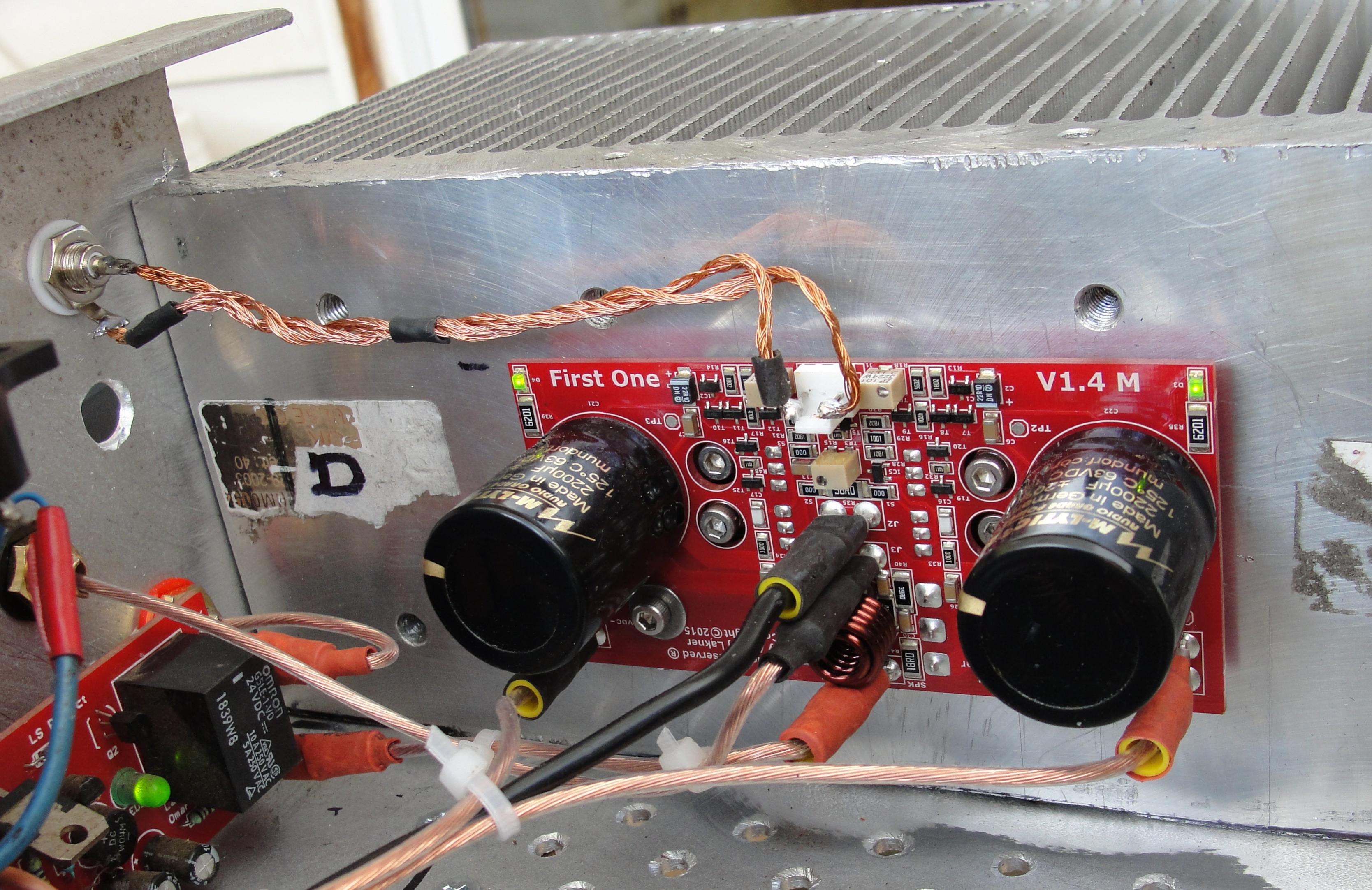

Great built Max, new home for FO.Now in use in the "patio" system for braking-in and eventual re-calibration, so no comments yet about sound.
Heatsink warm to the touch. 🙂
Some ugly pictures...
Thanks LC.
They like warm places, which makes them give out best. 🙂
P.S. Input wires makes me think .. also two bolts for the drivers not tighten (two more inside)?
Thank you, dear LC, for your concern.
I ordered too long M3 bolts (16mm) and even after cutting them (very hard to do), some were still long so I added a nut on some and they appear to be loose. I double checked for "proper" torque.
The wires are my own braided (Litz) OCC copper enameled wire recipe. I decided to use them as hook-up internal wiring to keep the same flavor over the whole system...and they cost me almost nothing, safe a day to braid the cable. 😎 Very relaxing, he, he.
Today, more listening with alternative speakers, humble Paradigm M3 re-capped, if my son lends them to me. 🙂
What a joy to build amps! 😀
Thank you again for the opportunity.
Best wishes,
M.

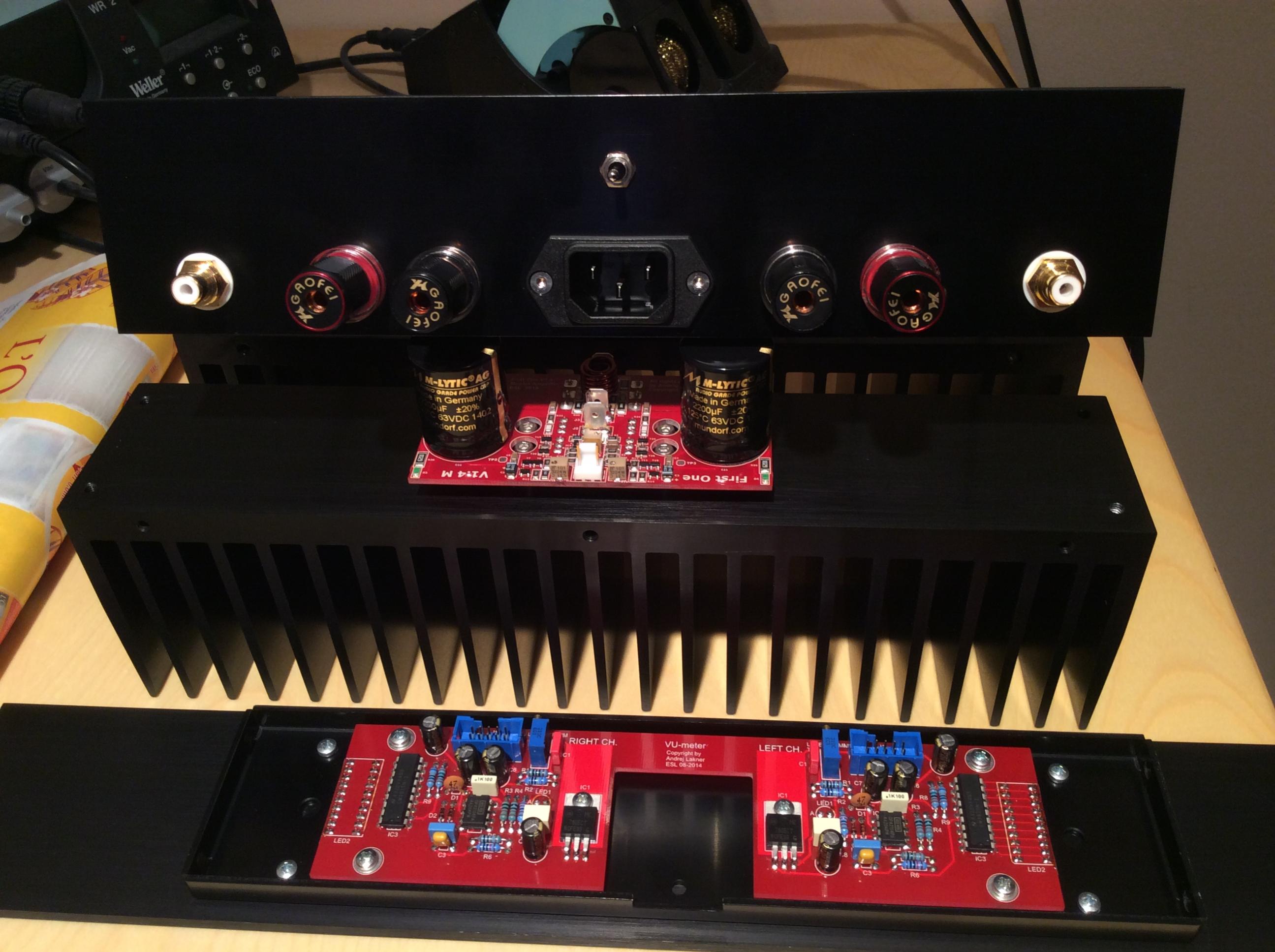

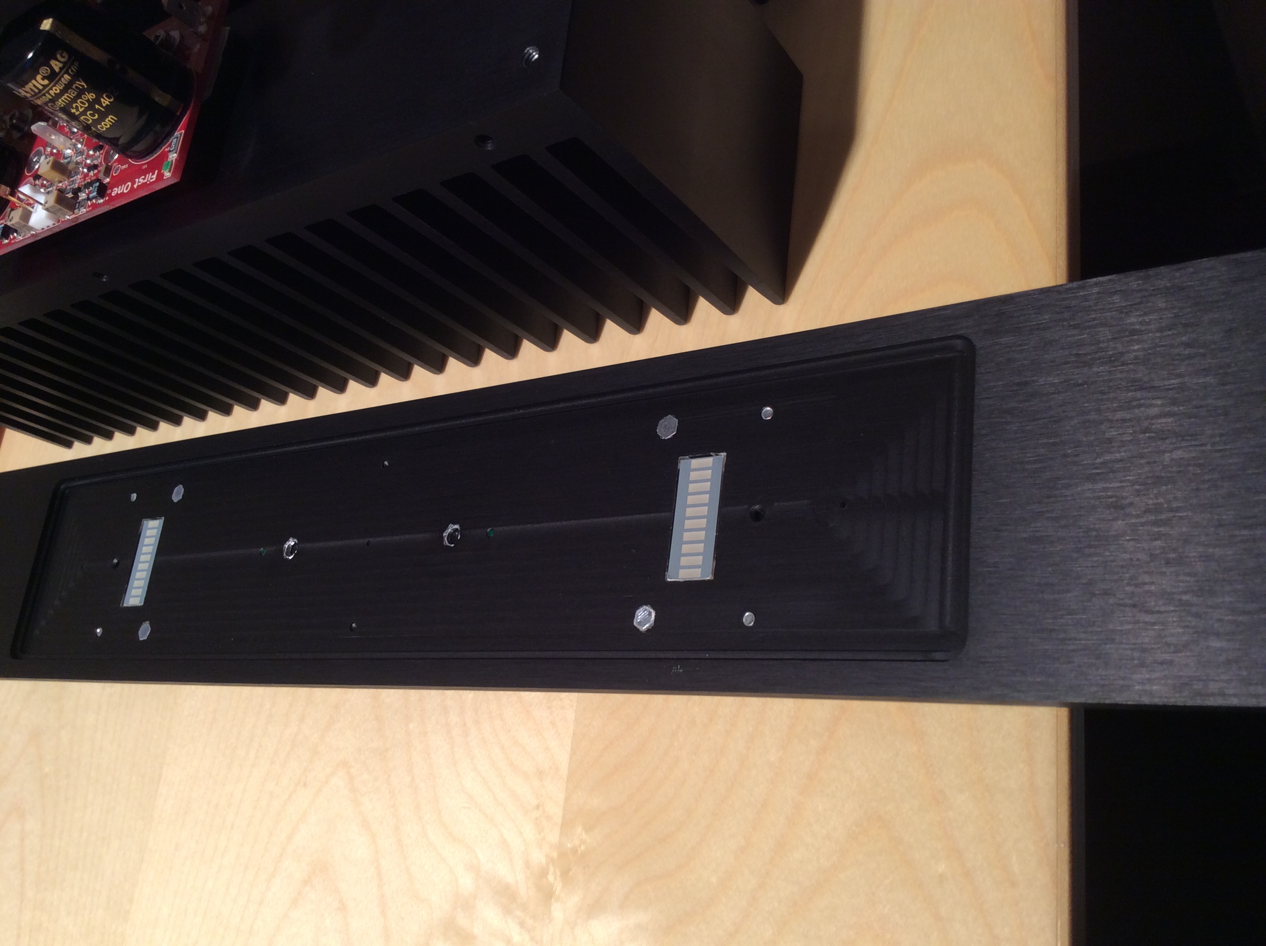

Black Mamba on the way!

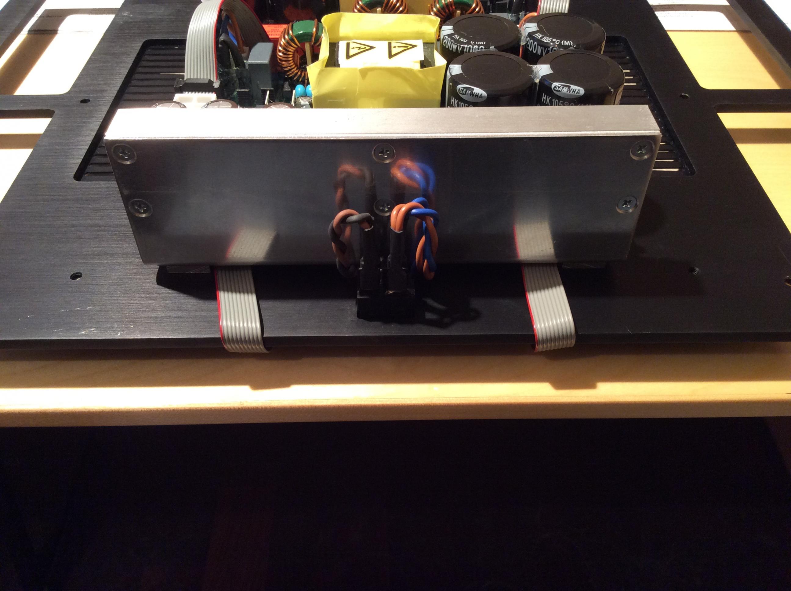

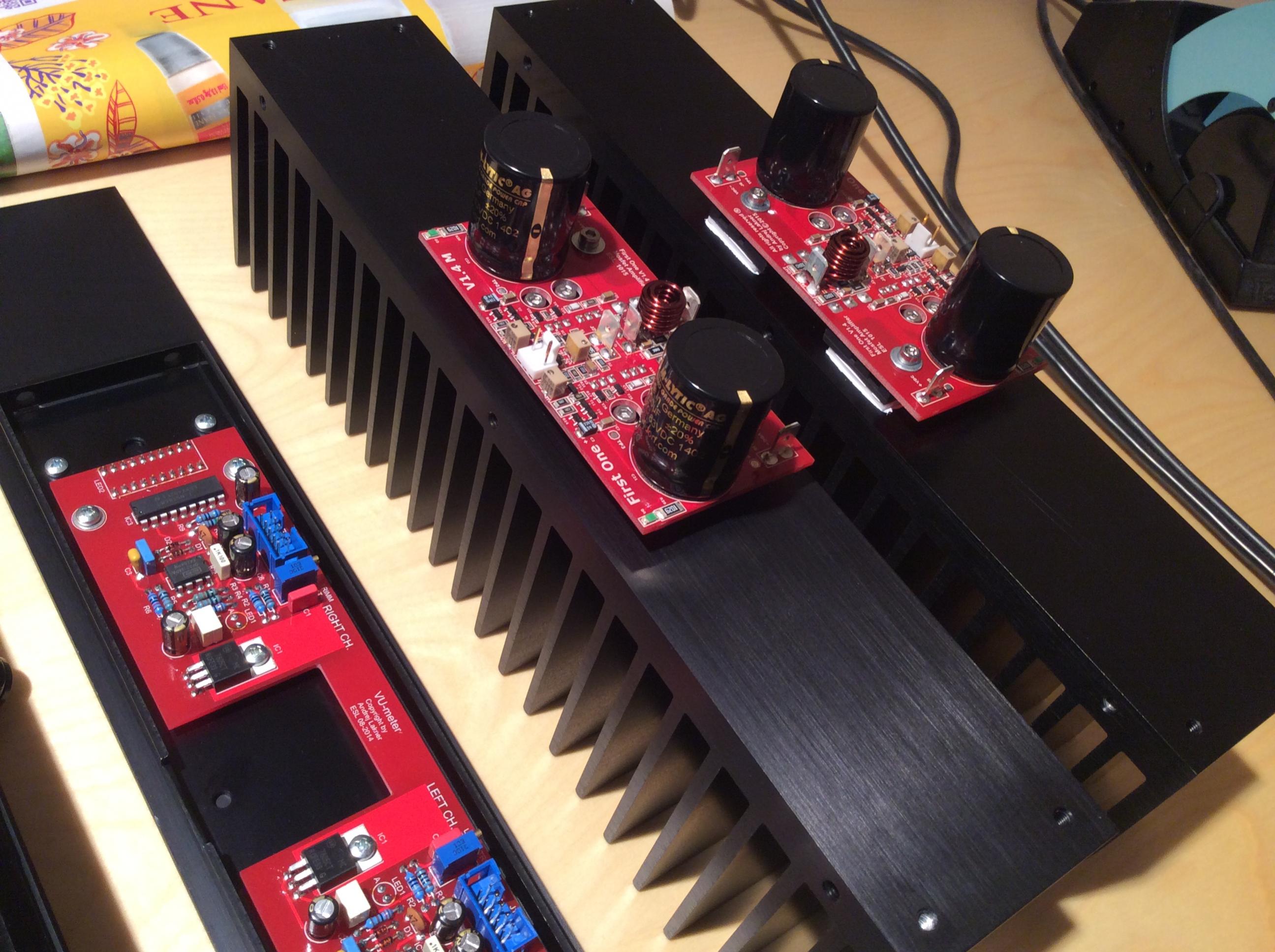

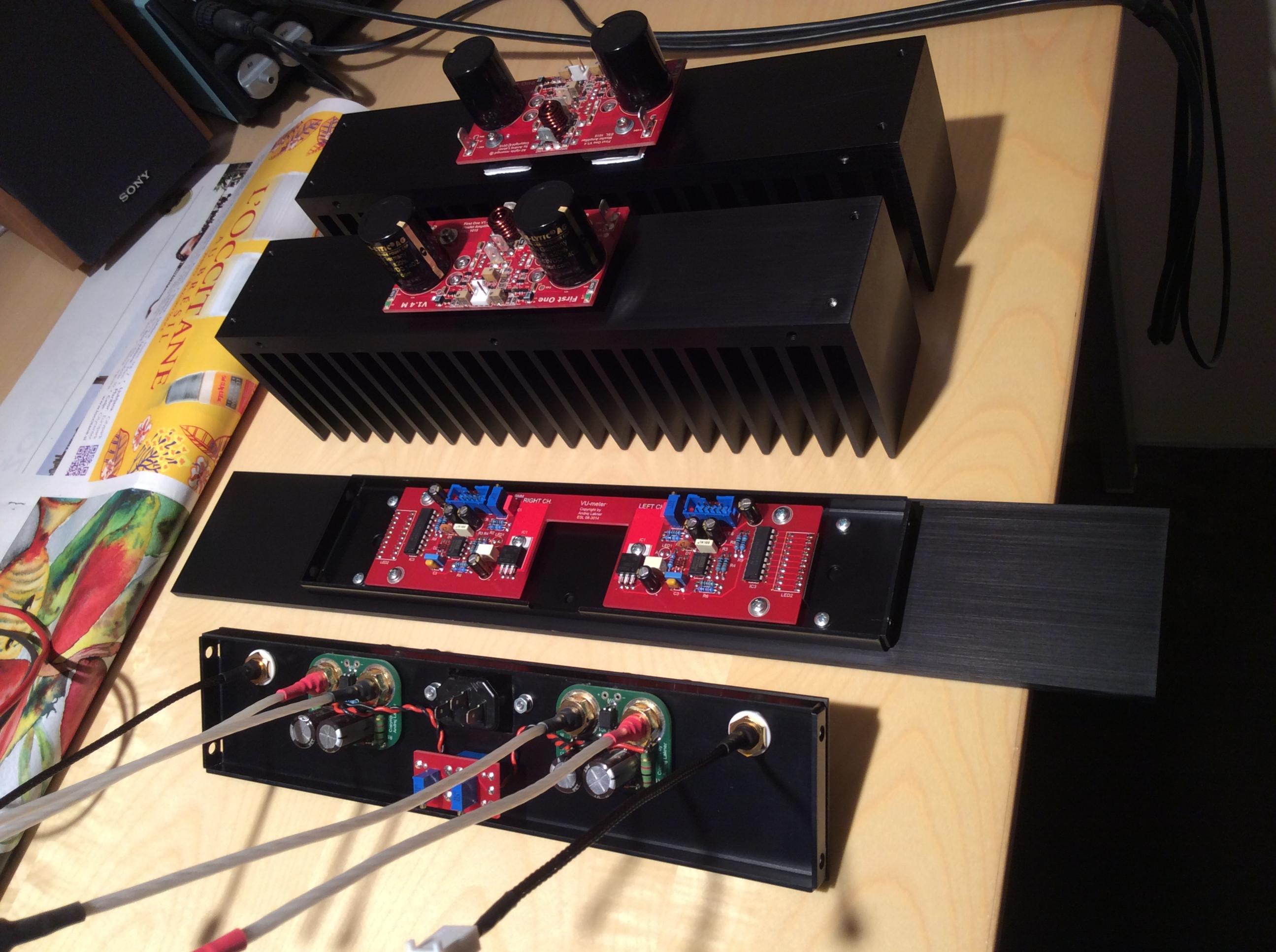

Building blocks prepared to be assembled into black Mamba chassis. 😎

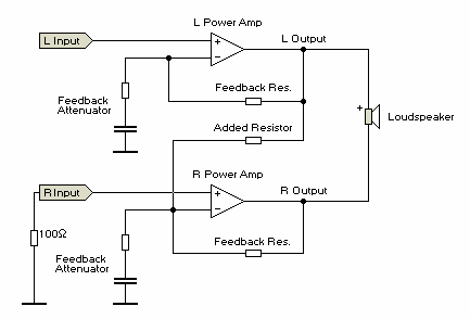

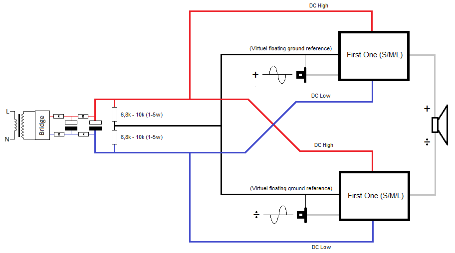

THAT models linked by nycavsr2000 looks good, but wonder if below Rod Elliott circuit from ESP site Simplest Ever Bridging Adapter for Amplifiers can be build as the before suggested one with floating signal ground and floating non balanced power supply rails.
Thing with Rod Elliott circuit is it takes single ended input and few passive components to make it work and maybe more transparent than adding active converters. Lazy Cat will have to confirm if he thinks the add resistors to feedback network hack will work in his speedy FO amps.
To sum up if balanced pre signal is available build as the lower one with a non balanced smps or linear PSU and if only single ended pre signal is available still do the lower one but wire inputs as Rod Elliott's schematic.
From ESP site Simplest Ever Bridging Adapter for Amplifiers:
Hi BYRTT
Thanks for the tip. I'll test this simplest ever bridging adapter with two First One modules, maybe next weekend.
Theoretically it is correct and it should work. I agree that this would be the most clear and transparent bridging adapter ever, without need of any messy electronic circuit in front of First One.
L.C.
L.C.
Dear LC,
Do you offer complete kits also?
That would help a lot...I am still trying to complete my case with dignity... 😱
I never really understood the way your speaker protection works. It would be great if you can re-explain or link the explanation.
Thank you very much.
M.
Black Mamba chassis in preparation to be offered to anyone interested, will make announcement when kits are ready to be shipped.
