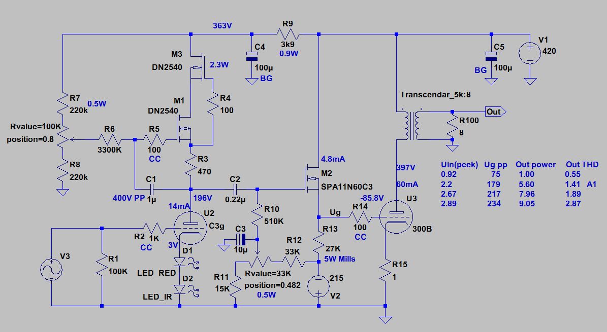

The only "listening" I've done is through one speaker hooked up during testing to make sure nothing was oscillating out of control. If I were to go with a MOSFET source-follower such as the IRFBC20, do you have any example schematics I could use as reference?
Ok, so first of all I hope the other channel is also connected to a speaker. I personally don't like to run tube/valve amps without a load on the OPT secondary. Its just one of those things... 🙂
Check out R.G. Keen's Mosfet follies here:
http://www.geofex.com/Article_Folders/mosfet_folly/mosfetfolly.htm
Your C3M plate is at around 220V, so if you direct couple it to the gate of the IRFBC20 you could use something around 18-20k resistor drain to ground to get 11-12mA. This resistor will need to dissipate a few watts, and from my experience, it also helps if this resistor is not inductive...
Then you simply Cap couple the drain to the grid of the 300b just like in your schematic. A heatsink on the MOSFET is a good idea since it will need to dissipate a couple of Watts.
The MOSFET will obviously will drop your B+ some more, but I think it will be quite alright for testing purposes.
I'm currently at work and can't do too much perusing. I'm a little trepidatious about putting semiconductors in my amp, but I understand what you're saying about the source impedance. Could you describe in words any sonic difference, if any, one can expect by better matching the impedance?
I would suggest this: Build your 300b like in your schematic, then build a small test board with the heatsinked MOSFET on it for 'testing' purposes. I would be surprised if you did not hear a significant improvement in fidelity.

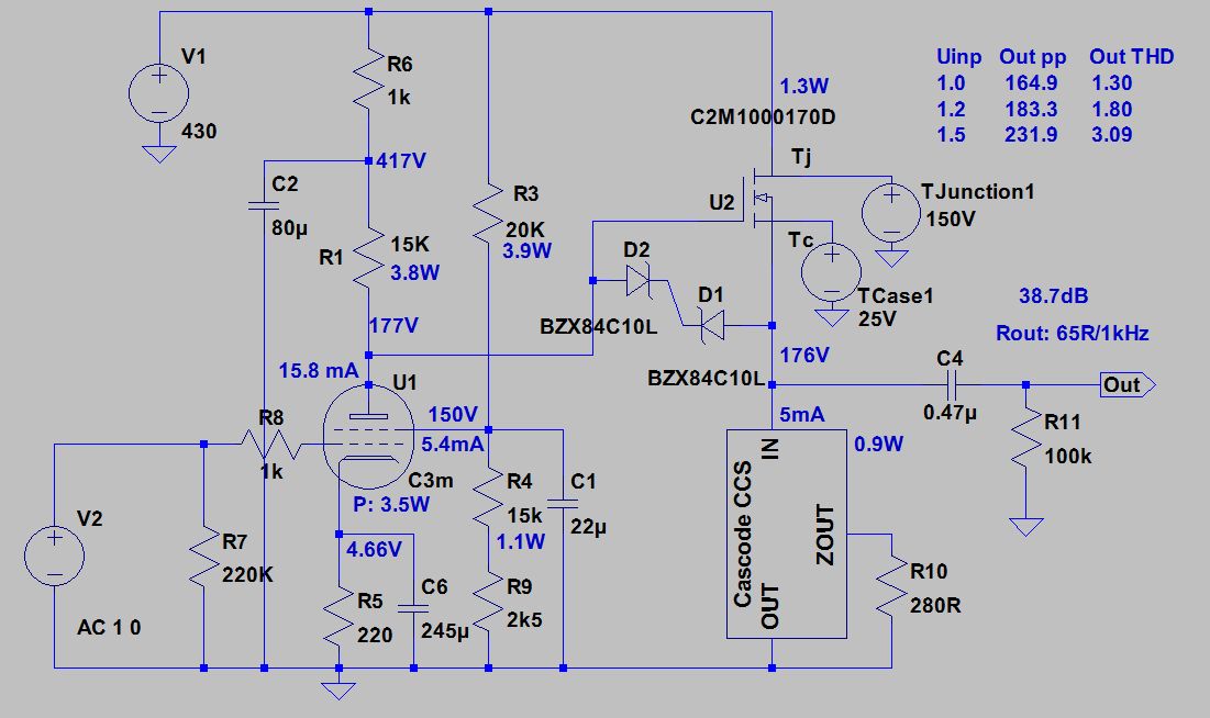

As I wrote in the #22 post:
"Some years ago I build (actually rebuild, only chassis and 300B tubes remained) trioded C3g -gyrator loaded-, source follower, 300B SE amp to my friend."
I actually used 2SK2700 as source follower. Other high voltage FETs (with low Crss) -for example 2SK3564..66, AOT1N60, C2..C3 type SiC MOSFETs- also usable.

In my post #42 above I see a mistake that is quite obvious - you should of course cap couple the MOSFET source to the grid of the 300b...It's morning here and I still needed coffee. 😉

Also, from your earlier posts, I get the impression that your c3m comes up rather slowly. If this is the case, then you might need to use something to protect the MOSFET gate.
Euro21's solution is to cap couple the anode of the input/driver tube to the MOSFET and use a separate bias circuit. This allows to gate to be isolated and should protect it.
In this case (VAS direct coupled to CF) opposite protecting zeners are always required. I also use CCS as CF load to limiting FET current.
This last post is very similar to something I have done before. I was too nervous to use 250mW zeners though, and had some bigger ones on hand anyway.
