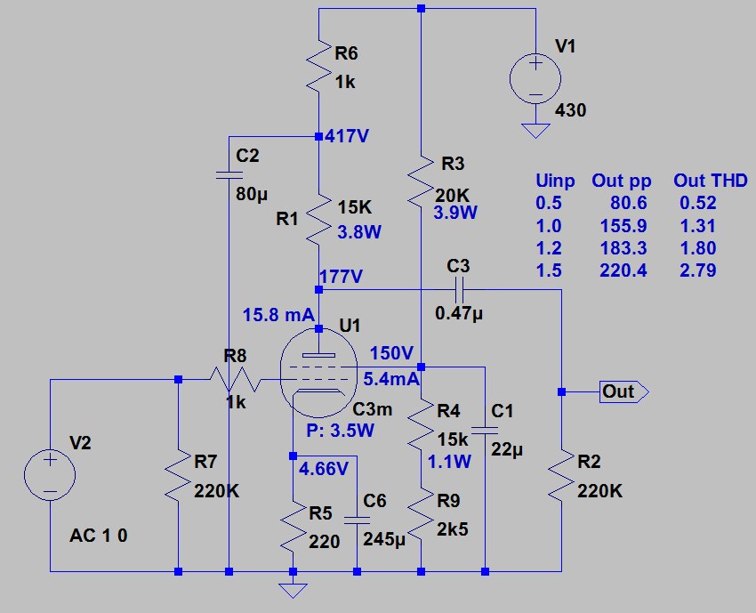

Soulmerchant: The 80uF smoothing caps are already in the amplifier chassis. How about the following arrangement:
IMHO this is the most worse case.
80uF is part of the first stage, so I already grounding it to the stage's virtual grounding point (cathode resistor ground leg).
Your C3M operating point is a bit "hot", near to the 4W limit, thus distortion at high levels is over 4-5%!
My op. point is enough safe (3.5W), and THD is acceptable.
BTW I hate tetrode operation of high Gm tubes (D3a, C3g, C3m etc. -I prefer trioded tubes-). Even at moderated output level the 3th /odd/ harmonics is equal, or greater than 2nd, therefore the sound is "sonorous".

Could you explain the principle behind this idea? Is it for the sake of grounding, ripple reduction, or something inherent to using the umbilical?add a additional 50uf smooting cap in the amp or move the last cap from the ps to the amp
Euro21: Thanks for the schematic and virtual testing. Along with VTR's concern, now I'm not so sure about the operating point. Otherwise, you would recommend grounding the 80uF smoothing caps to their respective C3M cathode, then making a star ground for the driver stages and take that to the umbilical?
Only considering the grounding pattern, is this roughly what you're talking about euro21:
Kind of opinion, but ok. My builds don't hum and I assume yours don't either.
This whole talk of different star ground points in general disagrees with me to be honest and the whole talk about where the "star ground point" should be sounds a bit ridiculous.
I would just use a single ground bus in the power supply and be done with it. I really doubt it matters in which chassis the 80uF cap goes, but he already drilled holes for it in the "amplification" chassis. In this case he can simply try it out and see if it is OK or not.
I would not advise him to re-drill his chassis without simply trying it out first.
From my experience, C3M is a stellar performer in pentode, but triode strapped with cascoded CCS has at best an amplification factor of only 18. So is your advise to use triode strapped D3a instead? I have used both and see no problem in using C3M in pentode - many others have used it in the past this way too.
If we start the distortion argument, we will have to scrap single-ended topology for PP, and bring in some judiciously applied global feedback. Please don't push the thread down that route!
