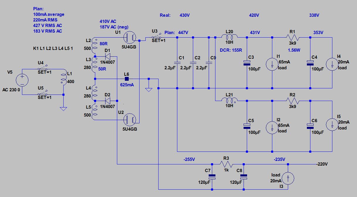

Not sure why the B+ is dipping by ~36% under load.
IMHO your HT transformer is undersized.
Some years ago I build (actually rebuild, only chassis and 300B tubes remained) trioded C3g -gyrator loaded-, source follower, 300B SE amp to my friend.
This is the PSU.
The static power requirement is about 128VA, so the custom wound power transformer must capable about 250VA.

Figured out the problem: on one of the 6AX4s I had accidentally soldered to pin 2 (internal connection) instead of pin 3 (cathode). Now my voltages are in the range of expected but need some tweaking.
300B Plate: 447 VDC
300B Cathode: 72.1 VDC
C3M Plate: 255 VDC
C3M Screen: 151 VDC
C3M Cathode: 4.6 VDC

Another option would be to step the secondary tap down from 575 to 550. On my original PSUII simulation with all the transformer info plugged in (578V, 12.3R) I got 439V for the B+ at C2. This is approximately 1% lower from my measured value of 447V. Dropping the secondary to 553V (578-25=553) in PSUII with 12.3R source resistance, I get 416V at C2. Factoring the 1% increase, that brings me almost exactly to 420V at C2. Furthermore, if I'm doing my math right, with the existing 13K total resistance between C2 and the C3M plate (assuming 16mA current draw for the C3M), I should get about 211V on the C3M plate.

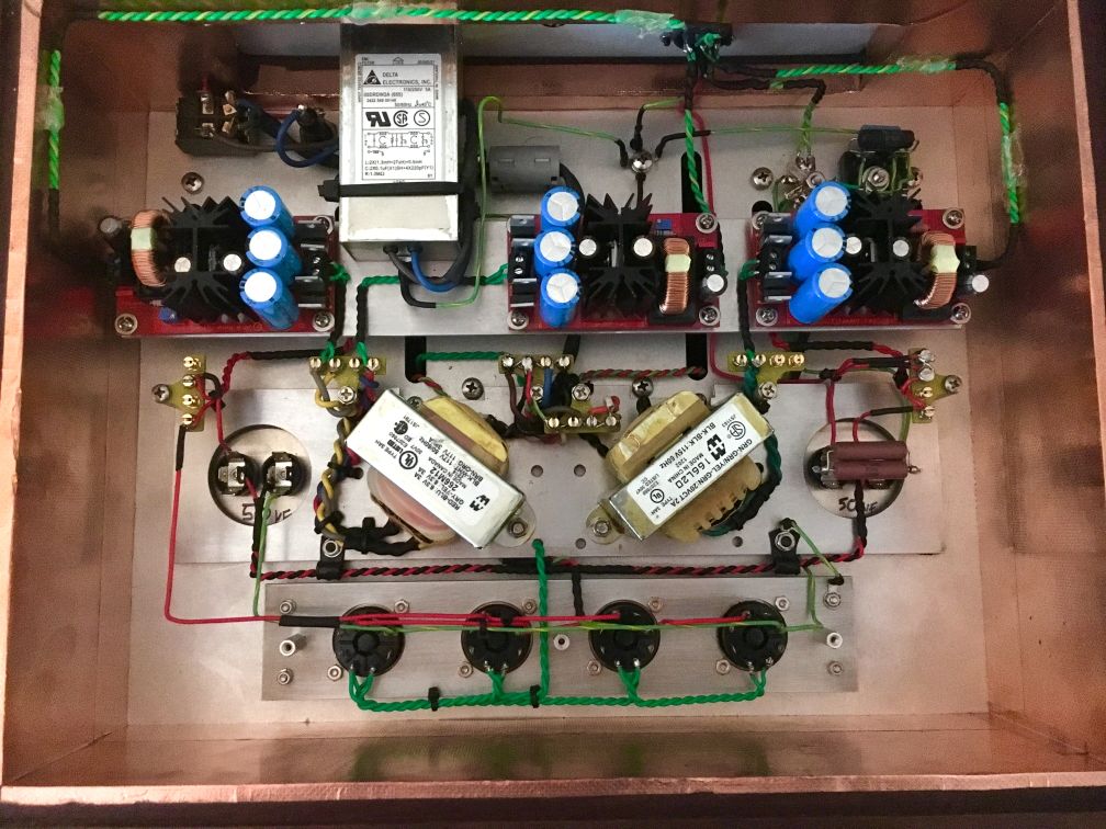

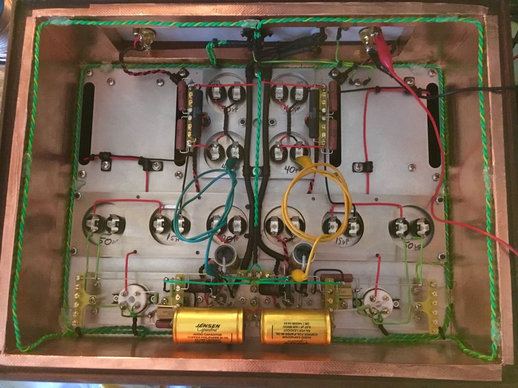

Here are a couple internal pics:
PSU
Amplifier:
Don't mind the jumpers off the 40uF caps in parallel—they're there until I decide exactly where I want to ground them. Right now only the right channel (screen left) is hooked up to a speaker; the left (screen right) is hooked up to a dummy load.

Very tidy build! I see that there are also 5W zeners at mouser and digitec that would be ok too. But for now, adjusting the divider to get the correct screen voltage will be fine too.
