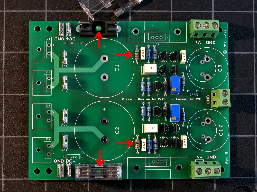

LED and LED Series Resistor
I have been reminded to post a note on the series resistor value...
As it is now, on the schematic and in the BOM, the LED series resistor (R13-R14) value and 1/4 watt rating are a bit small for a typical supply voltage over 30V. At the time I thought that adjusting the value (or power) for the desired supply voltage was sort-of obvious, but better safe than sorry, so...:
The LED is rated at 20ma, but it typically needs much less than that current to get more than sufficient brightness for a power-on indication. However, the LED and its series resistor are also used to drain the large reservoir caps when no load is connected to the power supply. This can take several minutes, during which time the LED will dim gradually as the capacitor voltage drops. So, the resistor should not be arbitrarily large, either. Also, if the LED is omitted completely, the pads should be shorted on the bottom side of the board, to maintain a closed path to the bleed resistor.
Most modern resistors can take a slightly larger than rated load, but to be on the safe side, here is a small table of power supply voltages and 1/4 watt resistor values:
<30V 3.3K~4.7K
<40V 6.8K~10K
<50V 10K~15K

Pete,
I shorted one LED resistor pads but not the other which I intend to use in the future for power on indication. Is it wrong that only one rail cap has bleeder resistor connected?
Although you could do that, by grounding the negative rail instead of the normal ground, I would definitely not recommend it. It would be setting someone up for a tragic Magic Smoke Release Event™ due to all the bits on the PCB marked "GND" that aren't actually connected to ground.
It would seem to me if you were building it solely for this purpose, you would leave off any "ground" lugs and just treat the - rail as ground. Am I missing something?
Will that LED stand its own dissipation in the long term when constrained under the fuse socket? Makes a nice diffused illumination effect nonetheless.
Yes. To the best of my knowledge, at 1/2 rated current, a 3-mm LED will do fine even hermetically sealed in a piece of plastic.
Pete,
Not sure, but this is not ideal, because the two rails will not drop to zero at the same rate. So, for some time after you turn off power, you may have different rail voltages on the amp boards. In case of VSSA, this is not a big factor, because the bias current is much higher than the ~10mA LED current, but it might be an issue with other circuits.

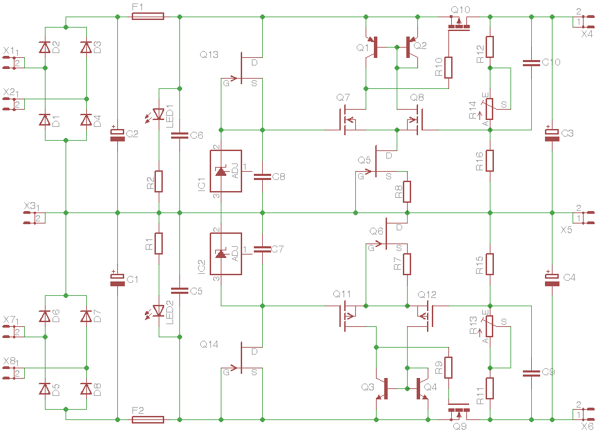

I prefer the two bridge rectifiers and voltage divider instead of a reference voltage source, according to this scheme.
It looks like a nice circuit, but do you still intend to use it as a filtered supply, whose output rises and falls with line an load variations, or something closer to a supply with an adjustable output?
With the original circuit, the trim pot adjusts the voltage drop across the pass transistor to whatever value is desired to filter the amount of mains ripple and power supply noise. The Vdrop stays the same over normal line and load variations, and for class AB amplifiers, it can be adjusted to a fairly small value (a little over 1/2 idle ripple voltage at intended load).
Using a voltage reference or a zener diode makes the circuit into something close to an adjustable regulated linear supply. To keep the output clean, Vdrop has to be set much higher to cover not just the power supply noise and ripple, but the full range of the expected line and load variation. This can easily double or tripple the power dissipation in the pass transistor, and its heatsink has to be proportionally bigger.
It is still a nice circuit, but it gives up some of the original benefits, which was a fairly high efficiency relative to the amount of noise filtering achieved, low voltage loss, and low heat.
