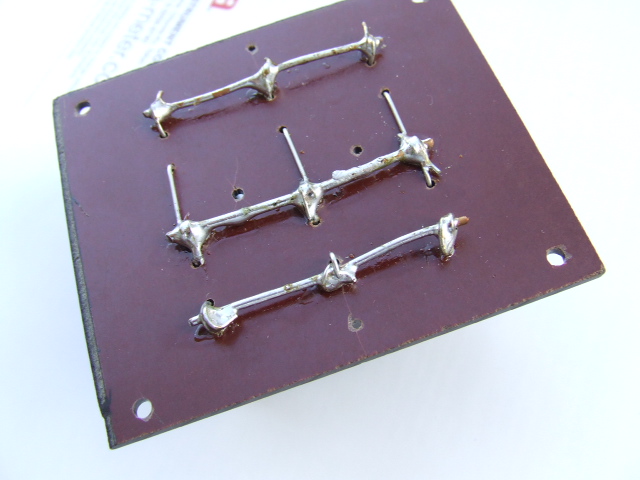

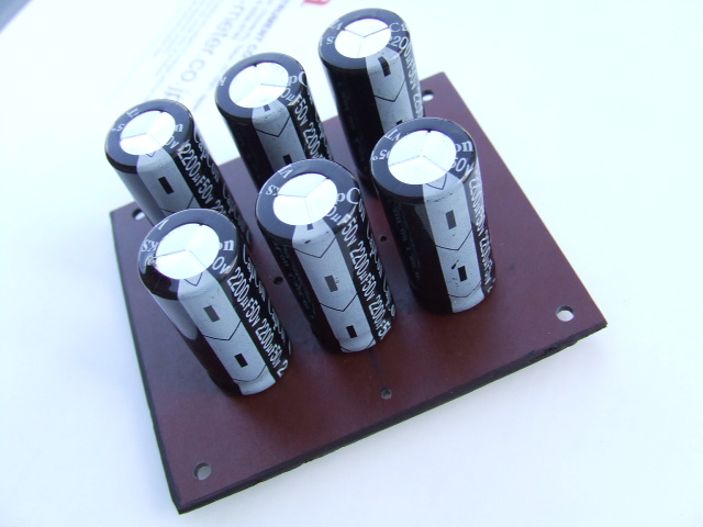

I usually use blank board (without copper) and drill the necessary holes. With wired caps I use tinned solid core copper wire for connection between caps. With the bank on the pic ground wire should ideally be exactly in the middle between negative and positive, but I wanted space around caps for better cooling inside completely closed chassis, so there was not enough cap wire for that.

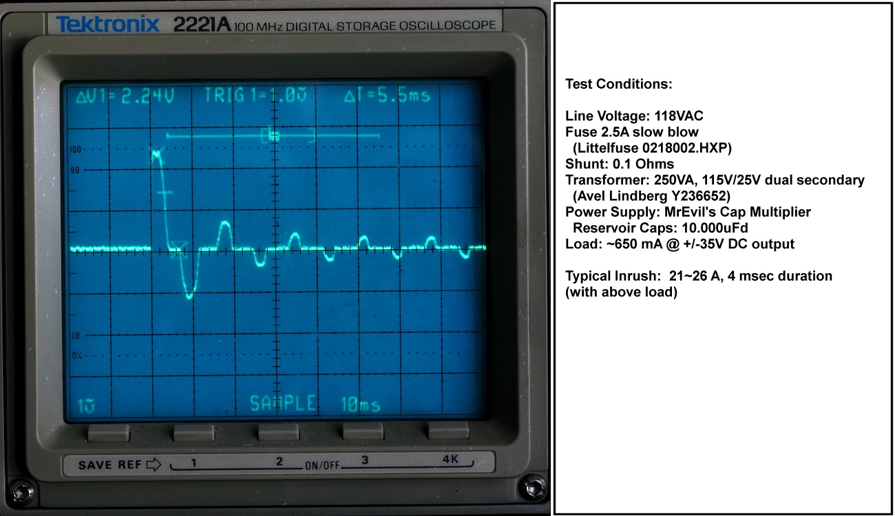

I repeated some of my earlier tests with what I hope are better test conditions, this time with only one transformer size, one fuse, and paying more attention to the scope trigger... 🙄
I plan to do a few more tests with other transformers, but it may take a few days. In the meantime, most of the second PCB order is likely to arrive in the hands of people who are building power supplies... So, I would appreciate it if someone could do a sanity check on my assumptions and first test results, and perhaps pick up where we left off.
The first test was run with a transformer size and fuse rating which roughly corresponds to 60W per channel. Results still seem to indicate no requirement for an external soft start, at least not with the Cap Multiplier at the loads and with the size of reservoir caps I expect for a class A-B amp up to 100W, even if a "closely rated" fuse is used.
This assumes a slow-blow chassis fuse. If you like using fast-blow line fuses, your mileage (and number of charred fuses) will definitely vary... tested 😀

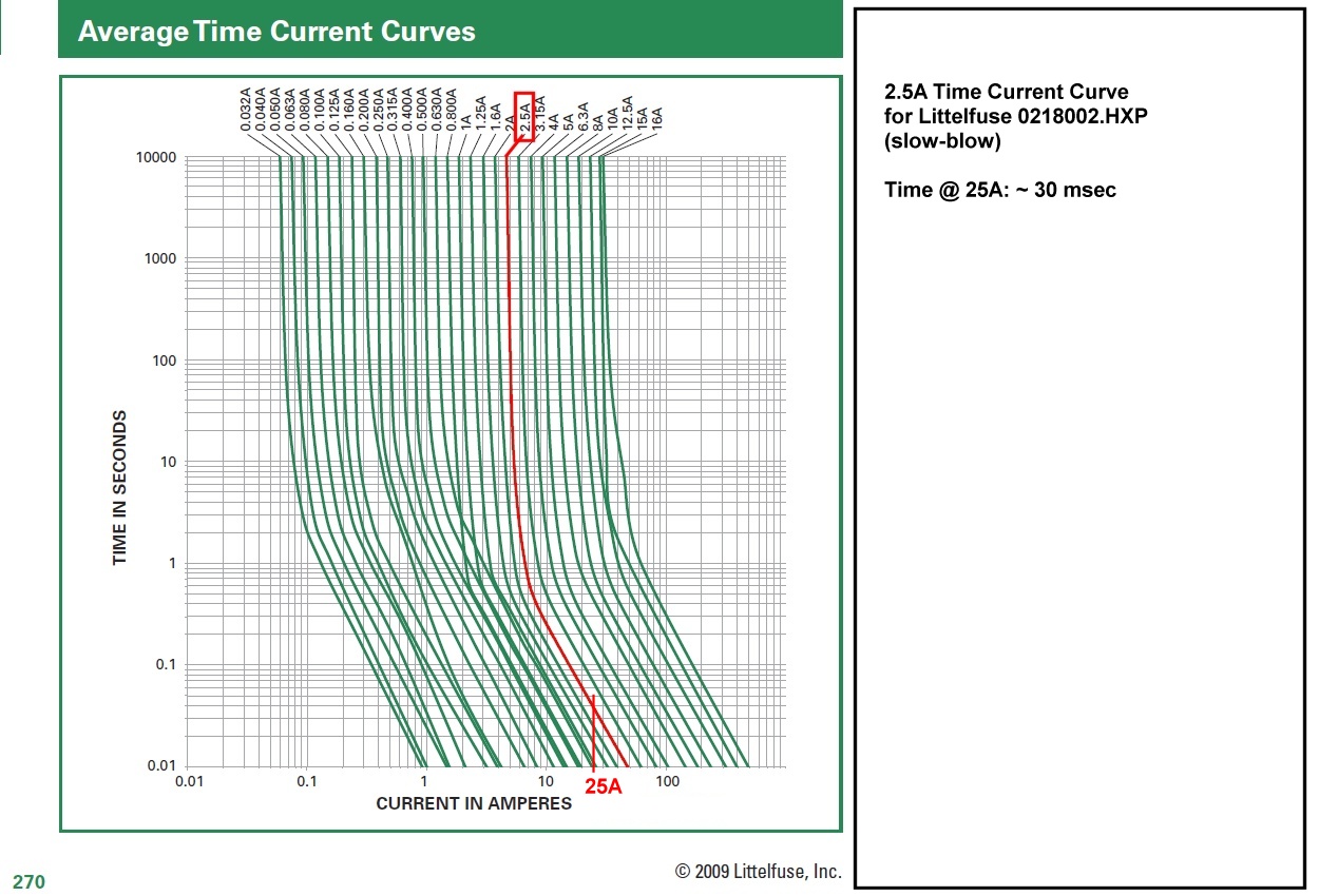

The results seem to indicate that the peak inrush is around 25A for 4 milliseconds, and diminishes quickly after that. The limit for the slow-blow fuse I am using for the test is about 50A for 10 milliseconds, and at 25A about 30 milliseconds.
Another way to look at this is that it would take 8 "shots" at this inrush current to activate a closely rated slow-blow fuse. I am not very good at doing integration off an oscilloscope screen shot, but it looks to me like we have only between 15 and 25% of fuse activation before the current settles.

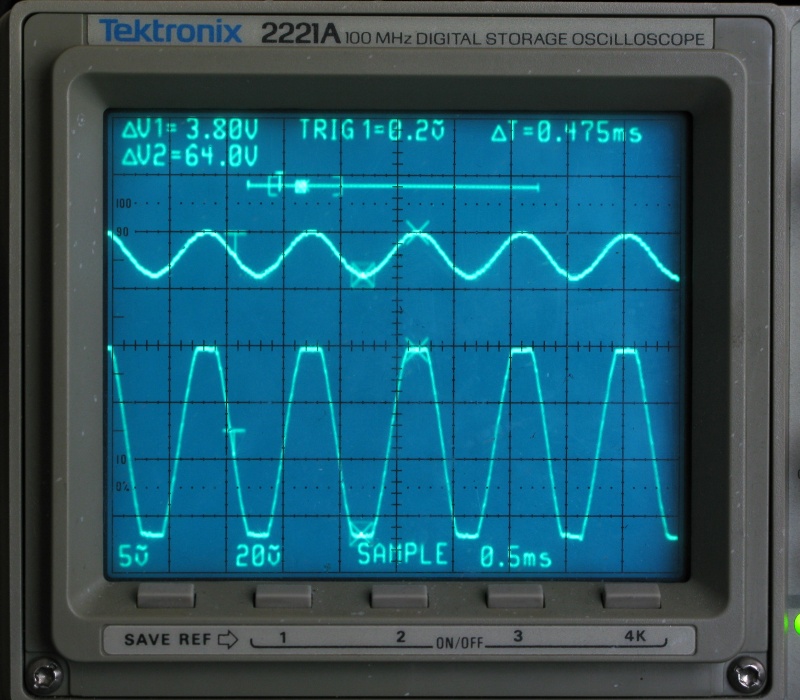

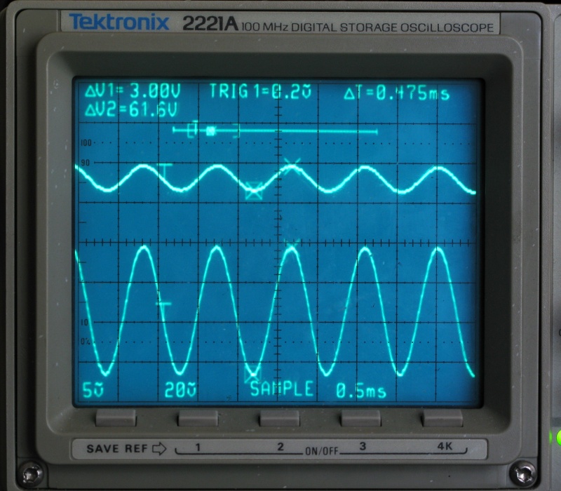

Channel 1 of the oscilloscope and delta v1 is the input signal, directly from the signal generator. (The scope is old, and when using the digital memory setting, the signal does not look perfectly smooth). The rail voltage was adjusted to 35V for this test, and from my notes, it was actually 35.2V for this particular test, because it can vary a bit with line and load variation.
Channel 2 is the output of the amplifier.
In the first picture I adjusted the input to get the highest output that I would consider to be un-distorted. This is a bit less than actual clipping. (As far as I am concerned this is a good thing, because the transition from a clean signal to a clipped signal is extremely good for such a simple circuit). The ratio between v1 and v2 gives you the approximate gain of the circuit (exact gain measurement can't be done on this scale with my equipment, so the number is off a few %)).
In the second picture, you see the actual clipping, and delta v2 shows the maximum peak-to-peak output of the amplifier (with the Renesas Latfets), at +/-35.2V. The difference between the rail voltage and the clipped output is:
35.2 - (64/2) ~ 3.2V (I measured 3.5 in other tests)
The difference between the rail voltage and max undistorted output is:
35.2 - (61.6/2) ~ 4.4V
So, max power at 35V rail voltage is ~64W, or ~60W depending on your definition. It can be more, or less, depending on the line and load regulation of the power supply.
