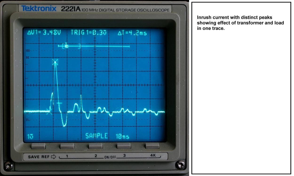

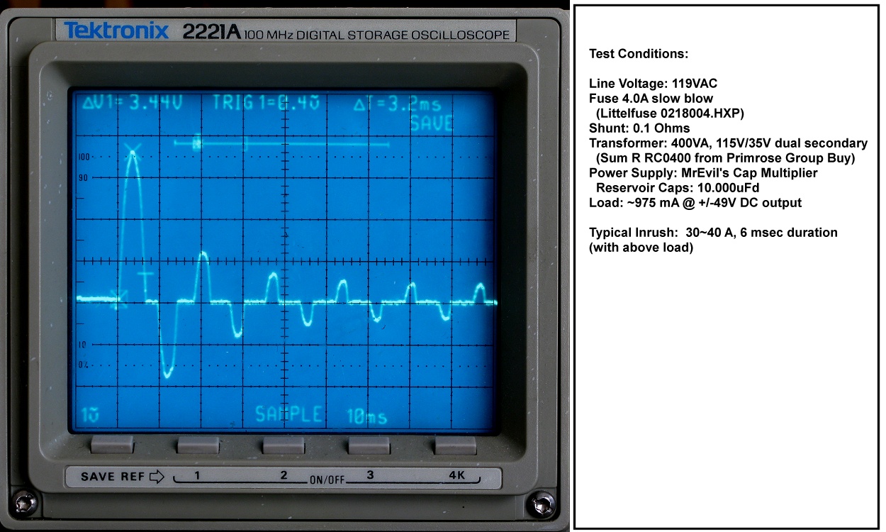

Inrush Current Tests, 400VA transformer
(Continued from HERE)
This is a repeat of the earlier tests, this time with a 400VA transformer, 35V secondary, Cap Multiplier PSU w. 10.000 uFd capacitors, 50V DC output, 1A constant load per rail. One of the pics shows a Time-Current diagram for a typical slow-blow fuse. In all tests the inrush seems well below the typical fuse rating.
The first picture is probably the most important, because it shows the worst case inrush, in terms of peak current, combined with worst-case duration. The magnitude of the inrush depends on the reservoir cap value and the load.

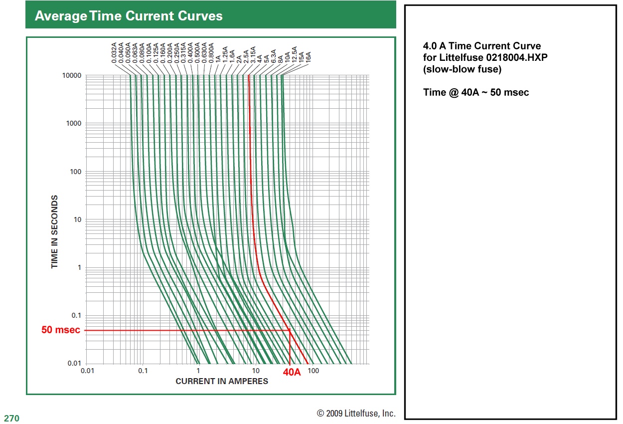

The second pic shows the time-current curve for the selected fuse.

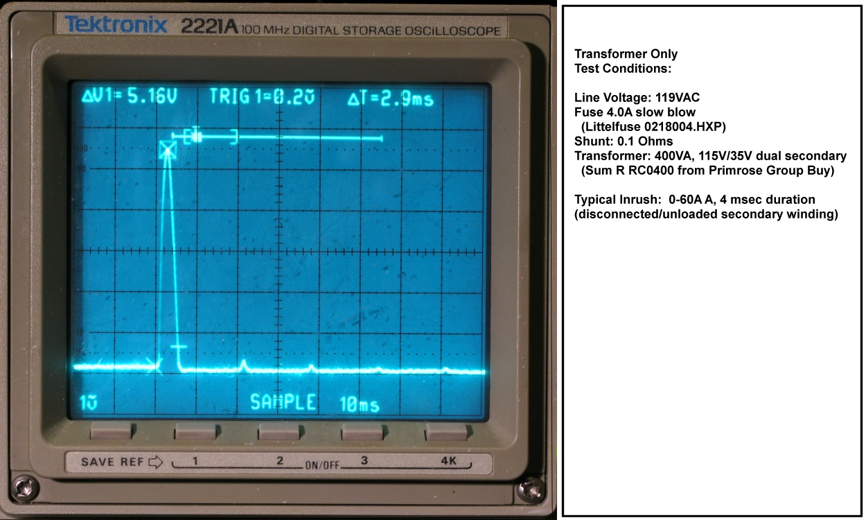

The 3rd and 4th pics show another aspect of the current inrush, which results from the transformer alone.
The 3rd pic was taken with the transformer secondary winding disconnected from the power supply, so none of the inrush is due to reservoir caps charging in this case. The magnitude of the inrush depends on when power is switched on, relative to the zero-cross of the power line.
The 4th pic shows a combination of the two possible events, for illustration.

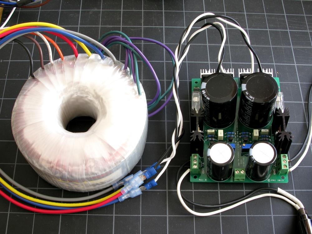

The last picture shows the transformer and power supply board used for the tests.
Comments are welcome, but I do not have any new insights from the tests, they show pretty much the same thing as the first set, with more detail.

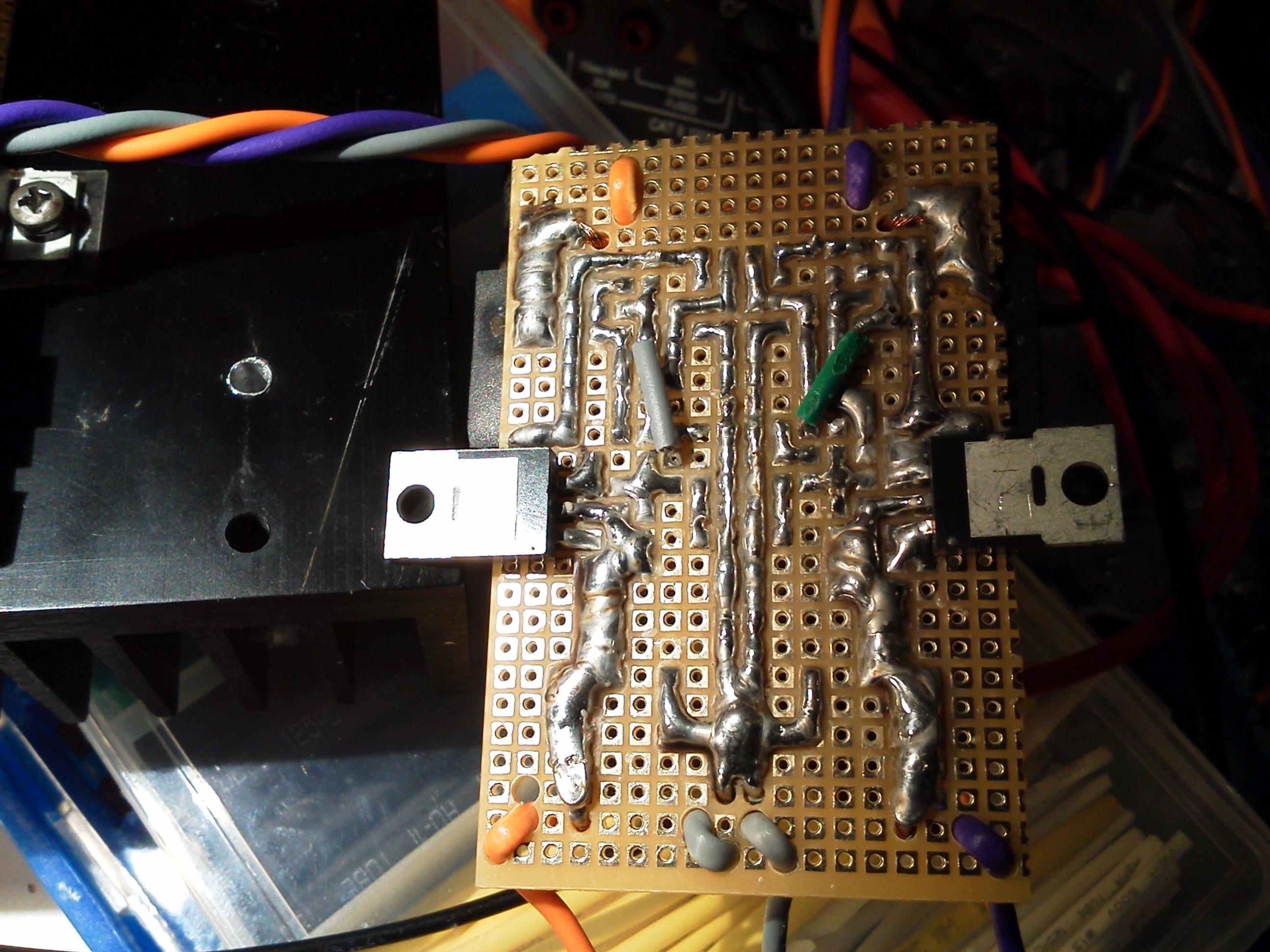

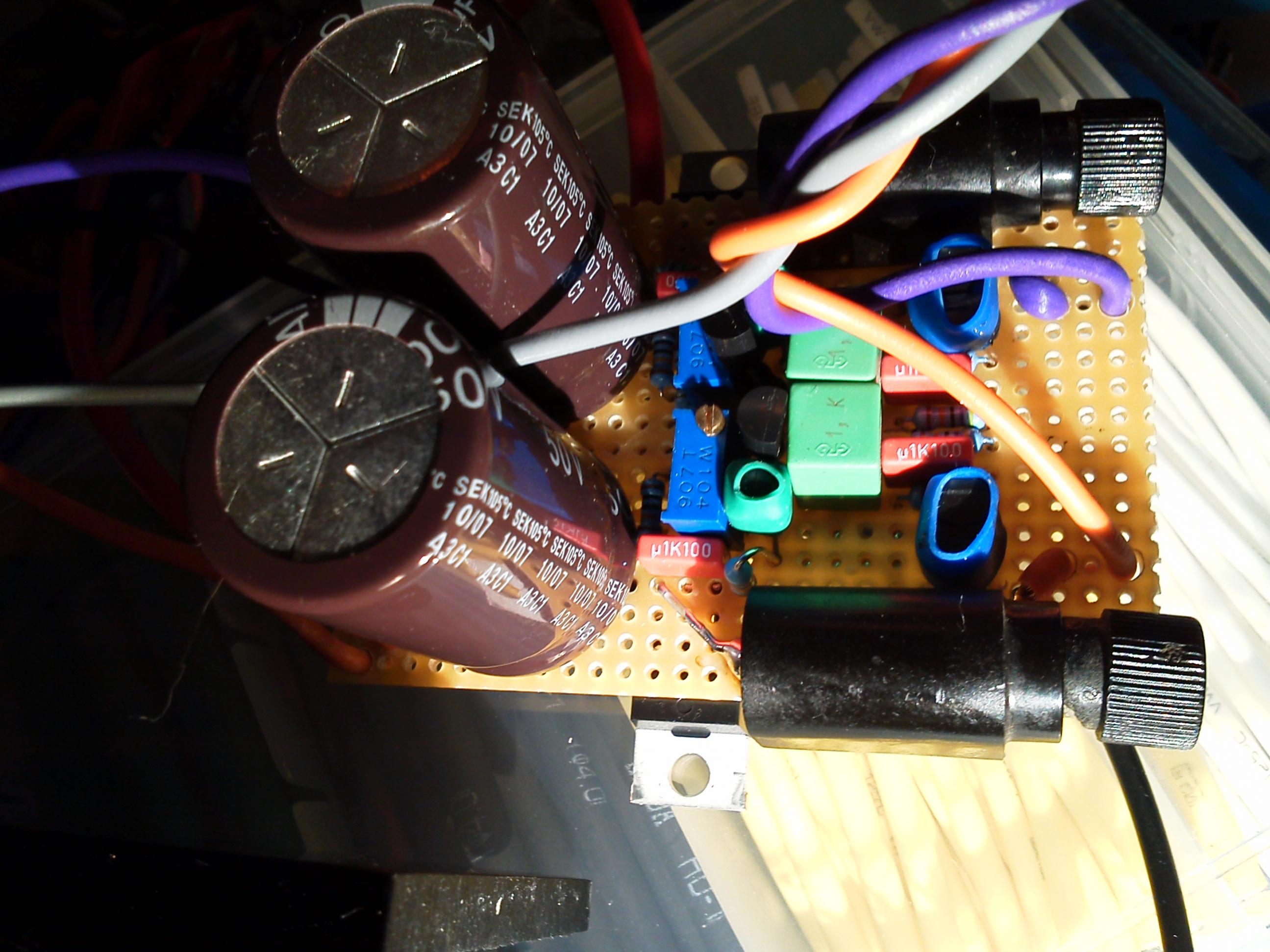

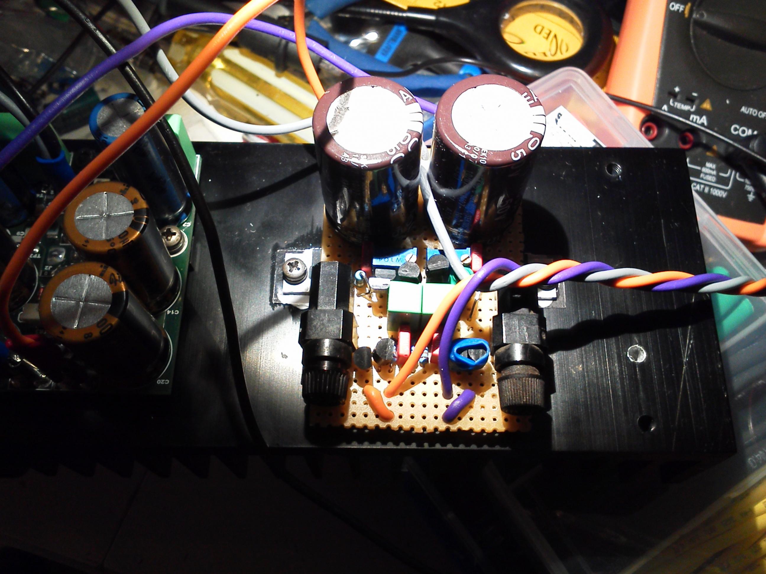

Just finished my P2P Cap Multipliers (one for each channel of the simple VSSA). One worked right away, on the other one I had troubles with some reversed lines between the amplifier MOSFETs and current mirrors (the fun of P2P). I picked this solution instead of using your nice PCB as I intend to mount them close to the modules and I have the main caps and speaker protection boards already. One step closer to VSSA experience 🙂
Cheers!
Pictures
Hi Pete,
Not the greatest quality of the photos, but they might show the idea. It works perfect with my raw power supply (one trafo, one bridge and two caps (5600uF each) fed by a variac and a switchable bulb in series. The voltage drop over the series MOSFETs is around 700mV.
Cheers!

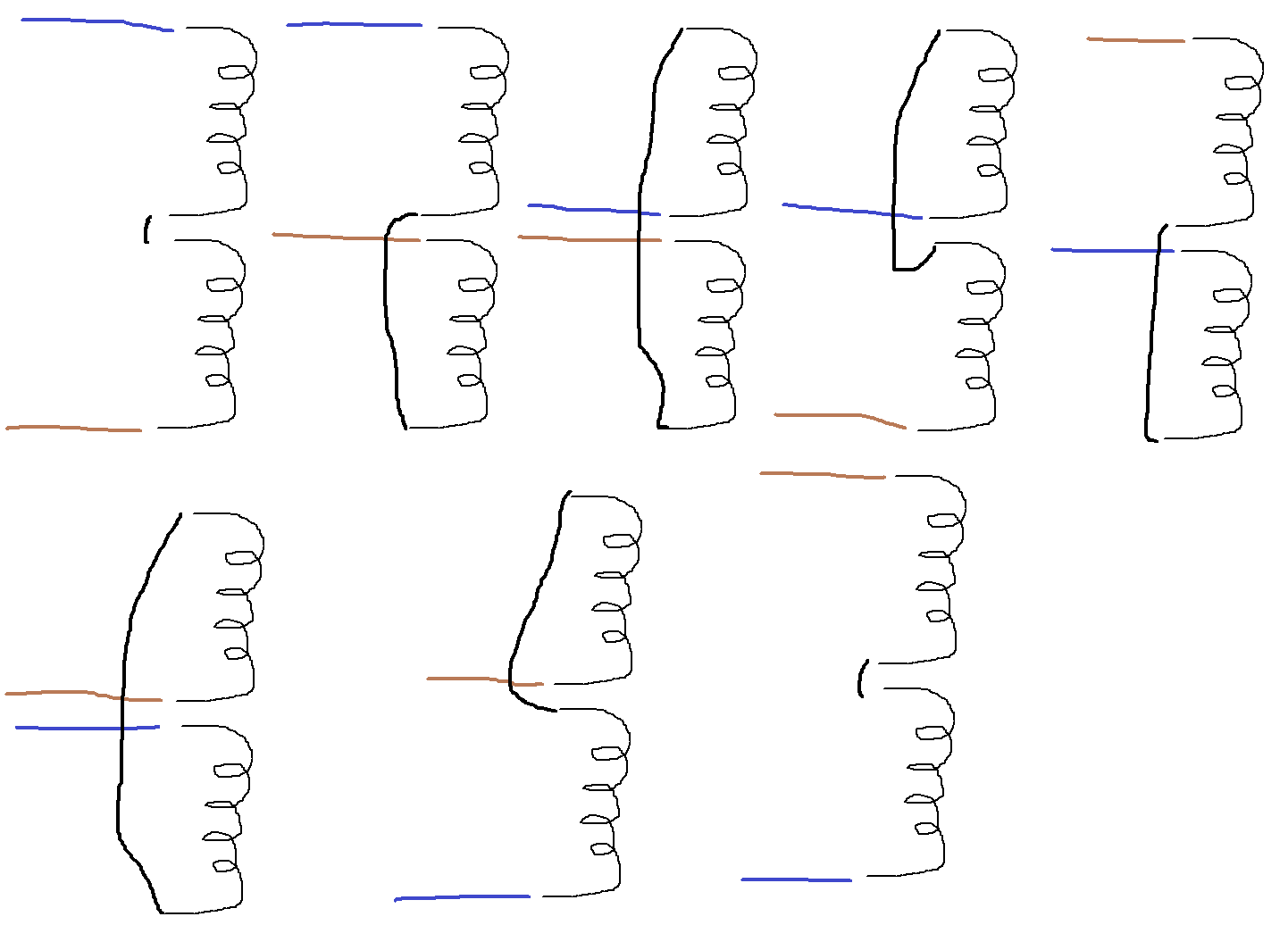

Don't think so, but there's lot of wiring setups possible, some won't probably work, can it be wrong wiring setup that is choosen and takes fuse away ? See quick paintbrush drawing.
pics 1, 3, 6 & 8 are correct.
Pics 2, 4, 5 & 7 are wrong.
The bulb tester will show this.
The wrong wiring of pics 2, 4, 5 & 7 will at the very least blow the mains fuse. At worst these will blow up the transformer.
Even with the transformer not connected to the Rectifier, you must always ensure the correct phasing of the primary windings. This applies when wiring in series for 220/240Vac, or wiring in parallel for 110/120Vac.
Hi Pete,
Cheers!
I like it, and the board is about the right size to mount on the heatsink next to VSSA.
Are you using the ground scheme recommended in the VSSA thread? In other words, do you have the VSSA boards grounded to the heatsinks, or isolated at the three mounting screws? (Mine is isolated now, except at the conventional single-point chassis connection.)
With this particular cap multiplier, the line sag at bass frequency will still show up at the first (main reservoir) cap. At the second (output cap), the line sag is filtered as a function of the RC constant in the cap multiplier. It is still there, but much smaller in amplitude. More important for me (personal preference only), the rail disturbance is pushed down in frequency to sub-sonic level (tested).

Thanks for decoding, the few times i tried use old unmarked transformers, i used variac watched current consume at meter and listened for buzzing from trafo, and by that got a connection wiring that could Work.
That bulb tester you mention, is there a link to see schematic for that setup.
Thanks! Indeed they are already mounted on the 300mm length x 80mm height heatsink side by side near VSSA modules. So each channel takes one heatsink, one VSSA and one cap multiplier.
I will not ground the modules via the screws on VSSA. I have isolated two of them. (Actually the ALF hole in the VSSA PCB has no GND connection)
As a matter of fact I will not connect the chassis directly on any of the ground lines, but using a *DDRC connection from each ground to the chassis, taking the ground point from the middle point of the main filter caps.

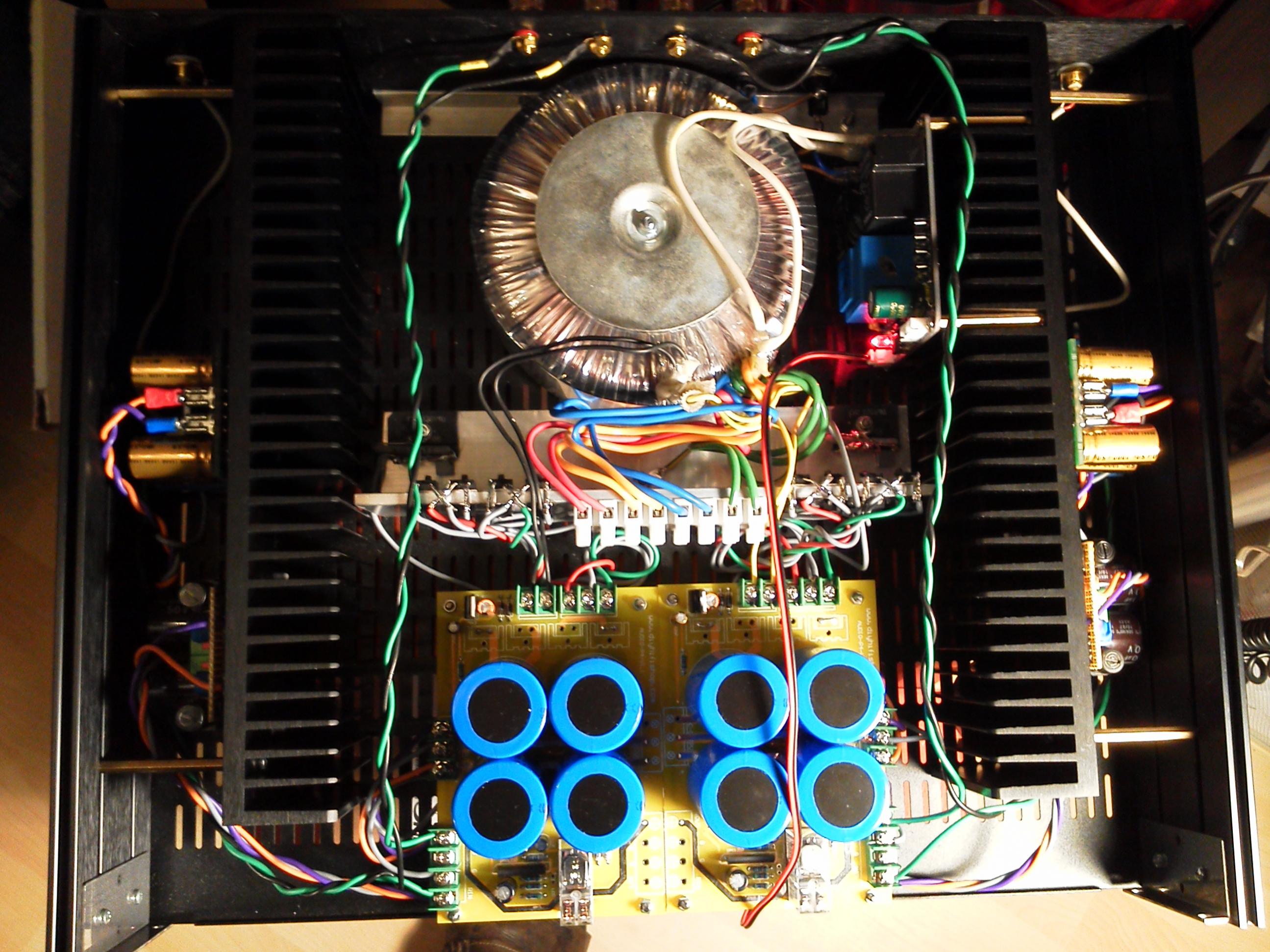

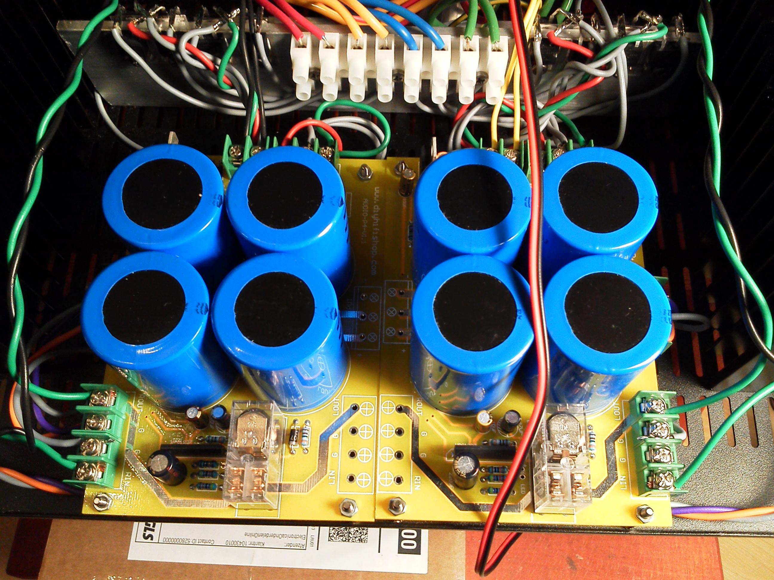

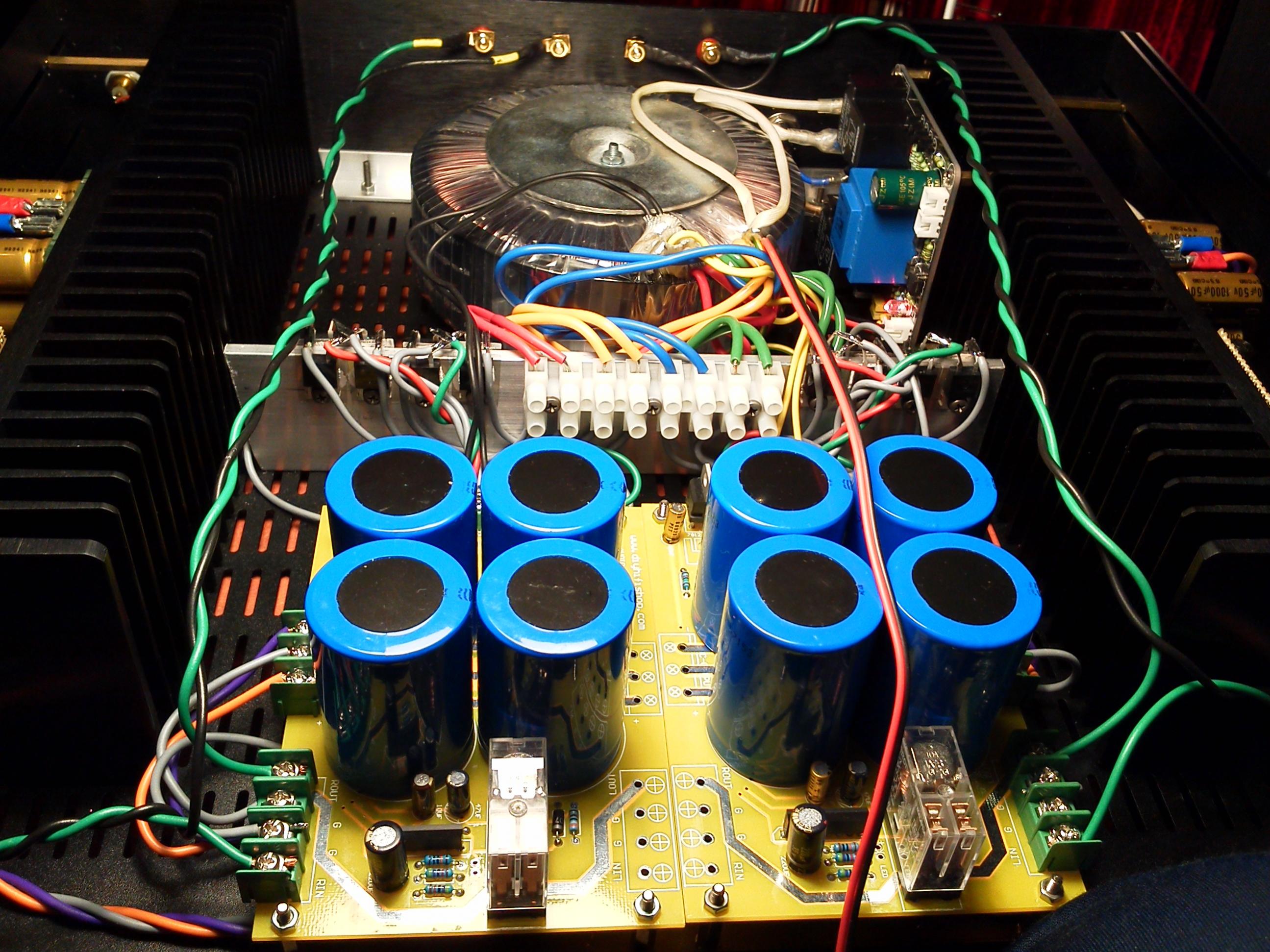

Some details of my build: I use a custom 500VA toroidal trafo from TOROIDY (a Polish company well known in Europe) that gives four separate main 28V and two independent 12V. The trafo is using more windings/Volt than a usual one, reducing the radiated field (so called oversized). The inner side (the support) is filled with a resin that prevents any kind of buzzing. I consider it a great trafo for this project.
Each of the 28V AC feeds a discrete bridge of soft recovery 12Amp diodes so no wire comes from the trafo directly in none of the L and R GND. Especially when using toroidal trafo's I like to avoid that, because they are known to be more transparent for parasites that can ingress from the mains.
Main reservoir caps are 8 Vishay 15,000uF/40V, so that is 30,000uF on each rail that supplies ~39V to each side of the cap multiplier. My pocket size scope shows no ripple at the output of the Cap multiplier even when decreasing the voltage drop to approximate 600mV so that is good news 🙂
Almost dual mono, but with a common Iron (the core of the trafo) 🙂
Until now I successfully adjusted one VSSA channel and I am working on the second one. After I am sure everything works properly on the bench for a few days (that will allow the CAPs to form too) I will try the sound as well.
Cheers!
*DDRC is known to me from Rod Elliot articles and it means two diodes mounted in anti-parallel and to this I paralleled a 10R/3W inductive resistor and a 0,1uF/100V cap. The diodes are part of the 25A bridge, the way of using it is quite intuitive, also shown on his site

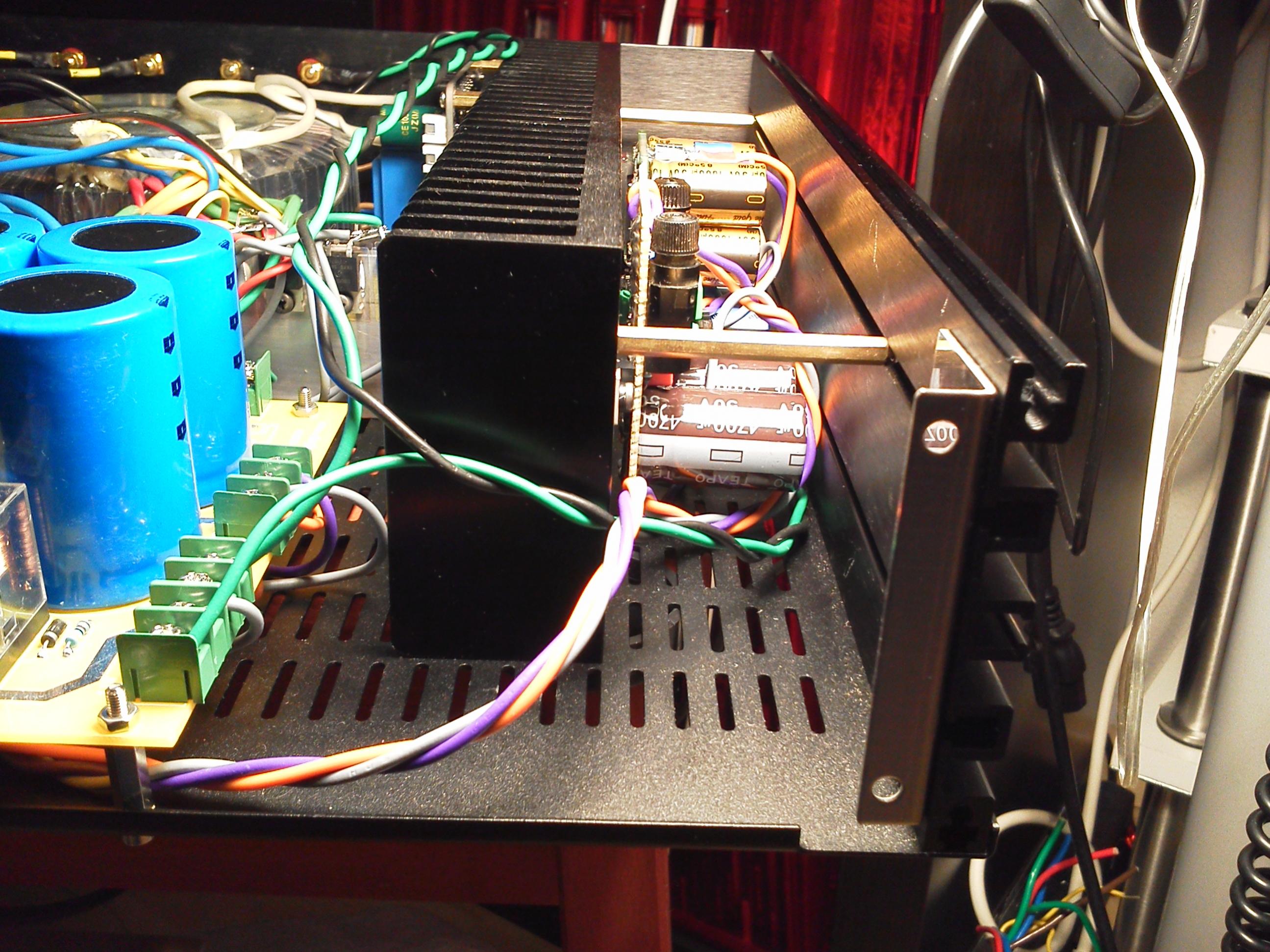

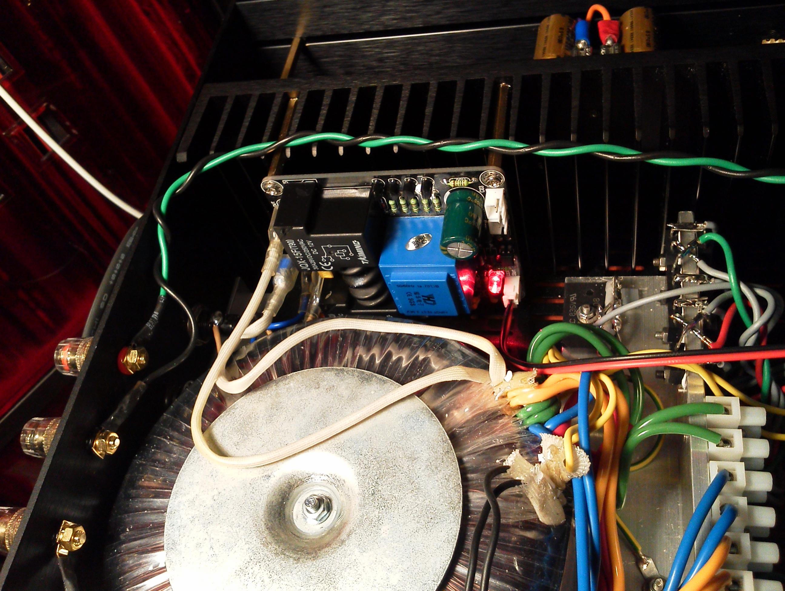

I finished both channels and left the big caps forming while thinking of the front panel. I need a momentary switch to stop-start the power supply and I don't have it in my inventory.
I have attached a few pictures to show the whole concept. I use ventilated covers, that is why I mounted the heatsinks inside, with amplifier modules and cap multipliers mounted between the walls and heatsinks. Of course, I will need to form all the cables to avoid that messy look.
The feet of the case are fixed with bolts in the heatsinks through the bottom cover.
The heatsinks are just slightly warm, with 180mA flowing through each VSSA module.
Will wait a few days till the sound check, and will start to think of an arrangement for a stereo balanced VSSA. Will definitely use there these cap multipliers.
Cheers!

Wao... thanks for teaser with those pictures. Lot of care is taken in your build in DC concern before it reach VSSA modules, it must pay back i really hope, and very good listening.
