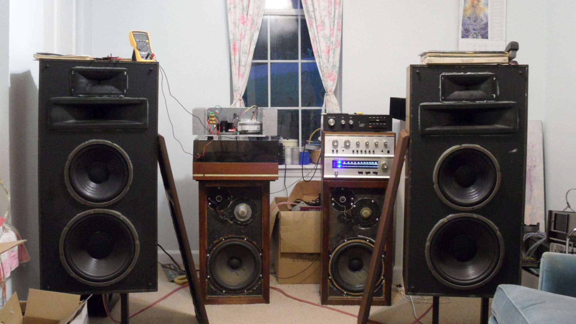

So far we have seen PMI's masterpiece and one other completed project (albeit slathered in lead ;-)
So has anyone else got pics to share?
Here is 1 VSSA on PMI Masterpiece, Pushing those Speakerlab S7WA's with no Problem.Excellent Bass! 😀
Well, mostly thanks to Mr Evil's clever ideas, which he gave me kind permission to copy for my various versions of VSSA and PeeCeeBee... 😀
(Very happy to see it working!)
Line and load regulation at work... 😀Yea, me to.! That Traffo 30VAC secondaries is giving me +/- 42.8 After 1v pass drop!😱
Take a transformer rated at 115V line voltage and 30V secondary voltage at full load, and at high-line voltage and low load, you might get 33V AC.
The Schottky diodes have a low forward voltage drop, and with Class AB, you do not need a big voltage drop across the pass transistor to get a clean supply...
( just enjoy the sound for a while before you play any test tones! 😉 )
Ya, i hear you. Did you ever give a listen.? i can shake this old house with the bottom end of that sweep, but make sure your Woofer Surrounds are in good shape.!

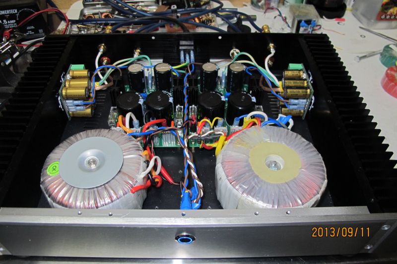

Capacitor multiplfier
Hi Ranchu, I got it from eBay. The case was reasonably cheap the shipping was a bit expensive.
Quan
Quan
What size transformers and supply voltage are you using?My VSSA up and running with 2+ CM . Sound beautiful. No soft start needed. Yeah.

Hi Peter, I am using two 300VA transformers with dual 30V secondaries.What size transformers and supply voltage are you using?
I ask mainly because I've had a couple questions about soft start, and in reference to what I have posted about the gradual ramp up of the supply voltage (which was one of my goals for this supply).
In my case at least, the slow startup essentially eliminates any turn-on noises, thumps, etc. However, I typically use smaller transformers than most people, and I am on 120V AC mains... so, I can't really present evidence for a 100% convincing argument. If you (or anyone else) would comment, I think it might help convince some other people, especially those with 220VAC mains voltage.
Thanks.
Quan
