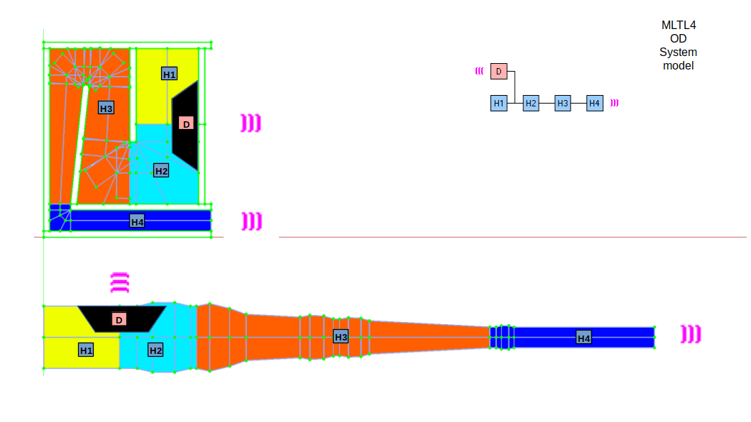

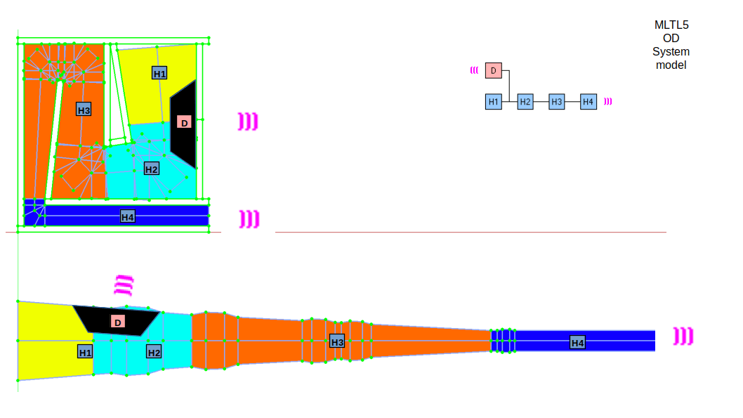

Here are two models.
MLTL4 - Has the panels as you asked but as you will see the segment H1 and H2 can't be flared.
MLTL5 - To flare H1 and H2 , it was needed to add two more panels witch create some empty volume inside the box. You have one flare control for H1+H2 and a second flare control for H3.
You can compare both in terms of performance and see what you like most. Let me know this was what you were looking for.

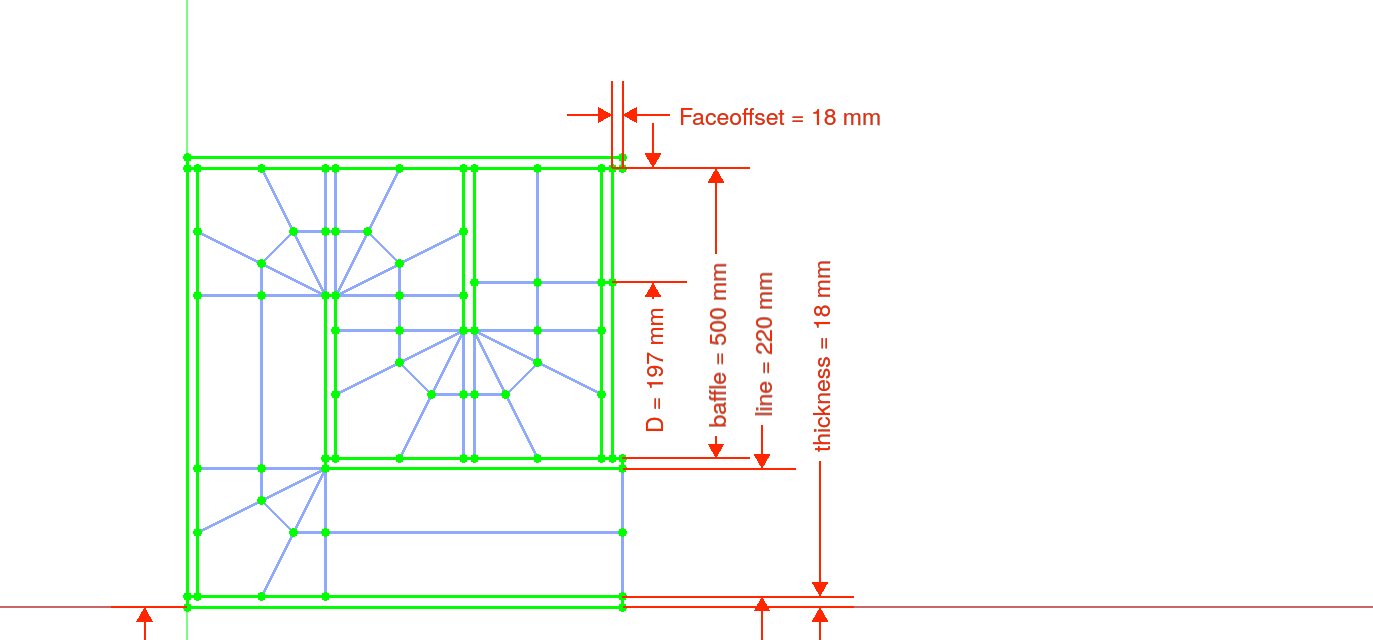

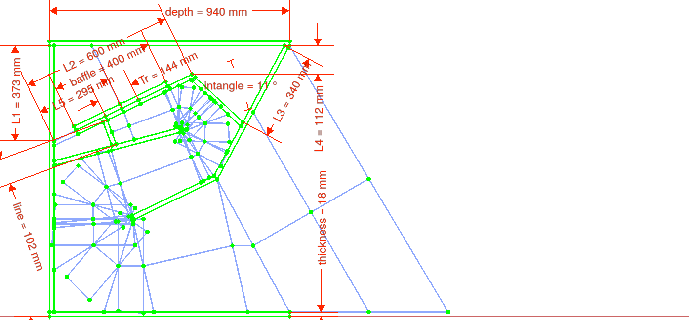

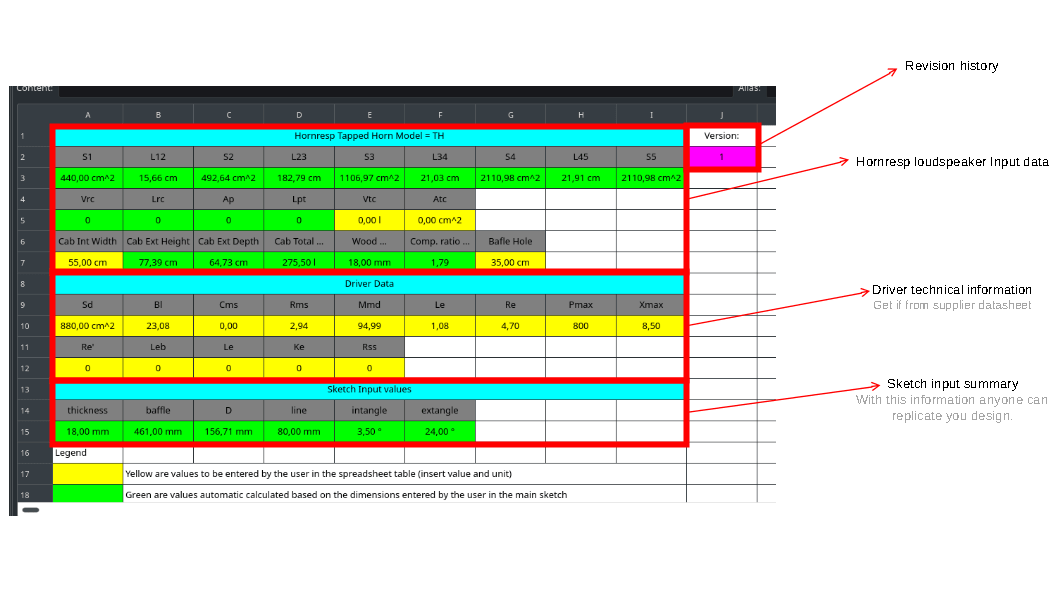

Nice, it's very challenging to fold a flared horn, this is where the CAD really shiny and just few people can guarantee a price progression and automated process during this folds. The major part of CAD I saw the folded values were manually defined, so it will work just for that particular design, if you change one dimension the model will not work anymore, or to work it will requires you to manually adjust the folds again. To avoid this behavior, with FreeCAD I fully automated the process so you can modify the box to fit a 8" driver or 21". See attachment #1

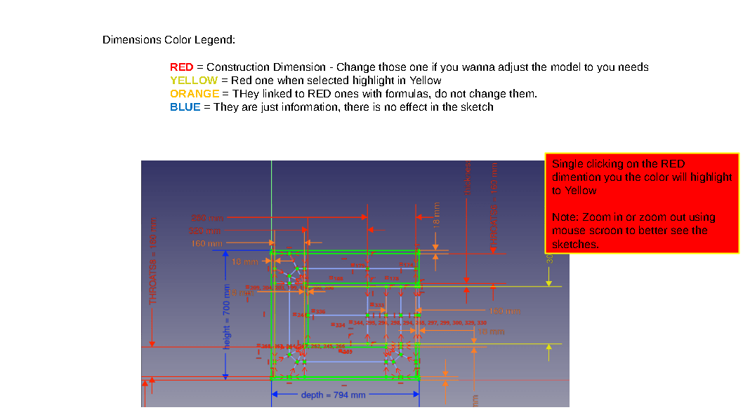

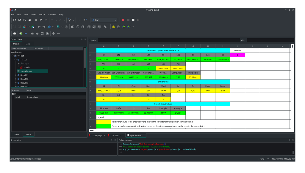

While using FreeCAD, in the spreadsheet part the cells are colored, the ones indicated in green user should not change them unless you want to customize your file, they are automatically calculated from an expression. Just the yellow ones the user needs to input a value like the box width, drivers assembly hole, and driver T/S parameters, there is a legend there. See attachment #2
The most important inputs come from the sketch dimensions colored in RED as you can see in the attachment #2 from the TL1 design as an example. See attachment #3

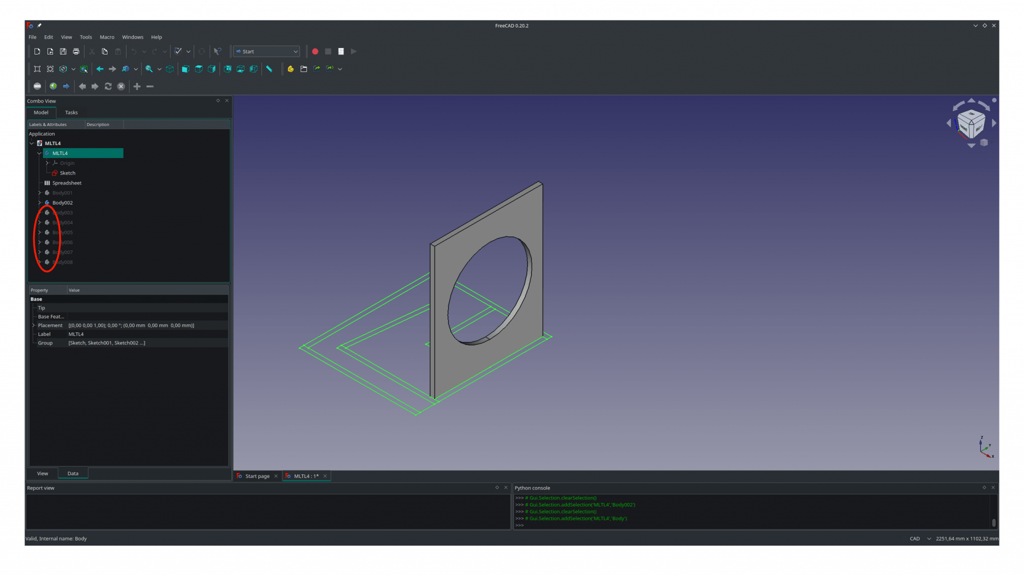

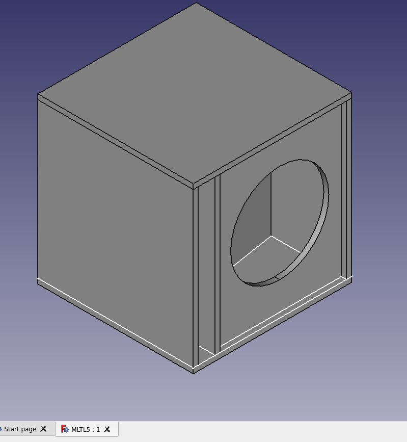

Thanks for the models - they look close to what I need.
I installed Freecad, loaded your data files, but all I see in Freecad is a baffle with a circular opening.
I tried running the macros, but nothing happened.
I don't want to derail this thread with Freecad tutorial, but unable to experience your models.

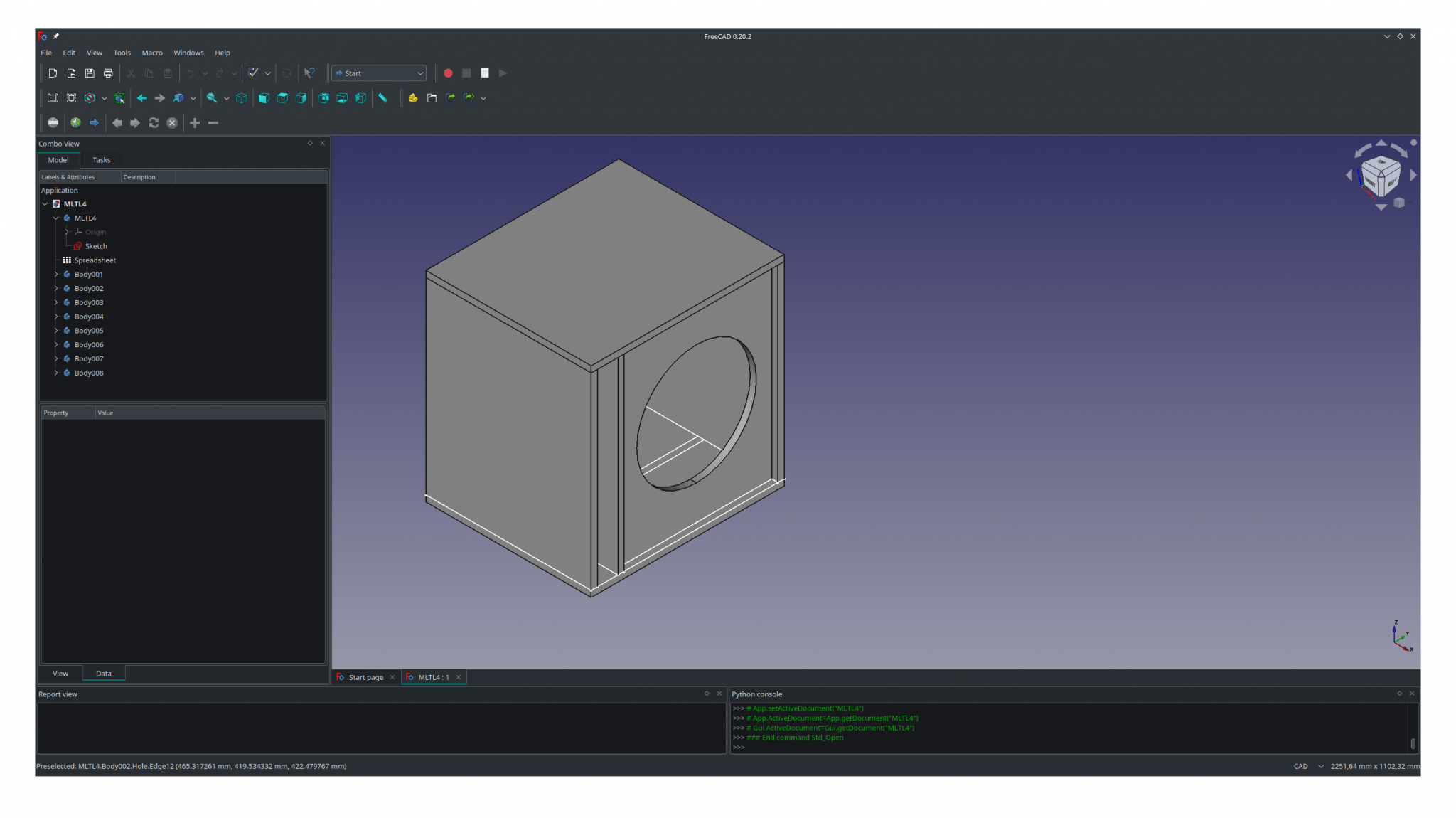

Hello joetekubi,
When opening the 3D model (*.FCStd) for the first time you should see them as indicated in the attachment #1 taking MTL4 version as example.
Sometimes, people type in the keyboard without noticing or click here and there trying to learn the program witch can creating some issues. From what you describe, it looks like some panels was hidden, this happen if you select a body and press "SPACE", when an element is colored in the three view it will be displayed, if its gray its hidden (not displayed) see attachment #2, please, check if this is your case.
I'm using FreeCAD versions 0.20.2 check if you are using the most updated version available.
To clarify, you have to change the red lines (redlining🤔) in order for the green Excel cells to populate correctly?
Yes
The "redlining" are the constrains that define dimensions, the bluelining are just information and the orange ones are linked or they have expressions inside them.
You can find the list of inputs for each model opened the picture provided in the zip file called MODELNAME-inputs.png
The third place you could check the inputs are in the spreadsheet in the group called Sketch input value.
So in summary, if you open the sketch, and double click in a redlining dimensions and change the value the magic will happen, everything will be updated automatically for you 🙂
