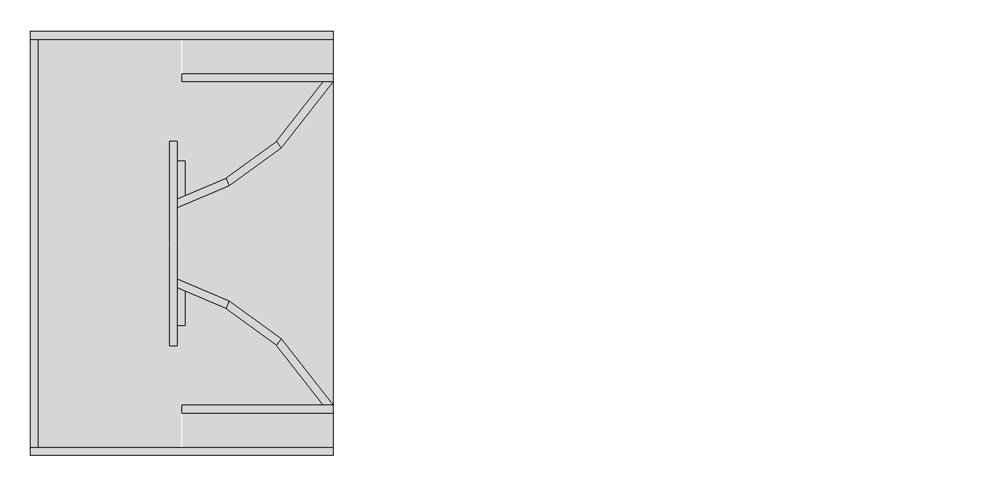

The model I'm sharing with people are generic, and the idea is to giver user freedom to adjust the models to any driver size like from 6" to 21", so the user just need to adjust the dimensions.
Almost all current available models use parabolic as horn flare so they are straight panel, see below a post from @David McBean when I was asking him about non parabolic flares.
"Any rectangular cross-section horn can have two parallel sides, it's just that with a parabolic flare horn the other two non-parallel sides will be straight panels because the overall area expansion rate of a parabolic horn is linear. For all other horn types, if two sides are parallel then the other two non-parallel sides will be curved rather than straight, to maintain the required area expansion rate of the horn in question."
https://www.diyaudio.com/community/threads/hornresp.119854/page-659#post-7155609
From my side, I kind of polynomial equation would need to be defined to better fit curved horns, but I don't know if it would be reliable. Currently there are two models available that could benefit from this approach, the Altec816, but rather then use curved flare I user 3 parabolic flare in alternative to the original project and the ModernDualVB2 witch is currently using exponential flare.

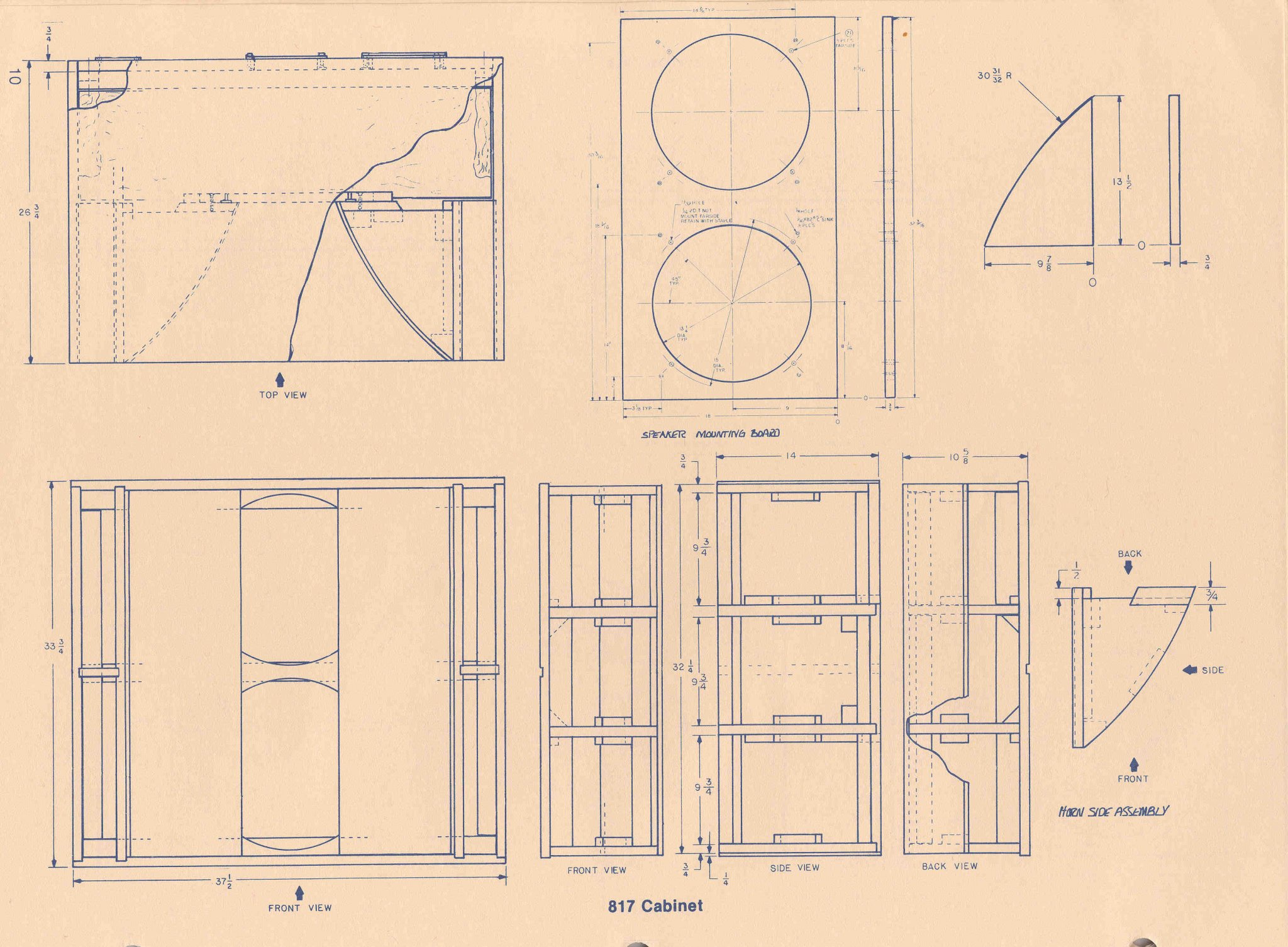

If I may suggest another design for your collection then the Altec 817. It is the Voice of the Theater horn.
I would not say the models are mine, they were made using opensource tool and they are freely available, people can use, share, modify, publish. The only think I ask is if people build the box, share the data with others, so everybody won.
I found the attached plan for the Altec 817, is it OK to use it as reference with the JBL 2226 driver?
Do you prefer to have a single driver model or as the original design with 2-drivers model?

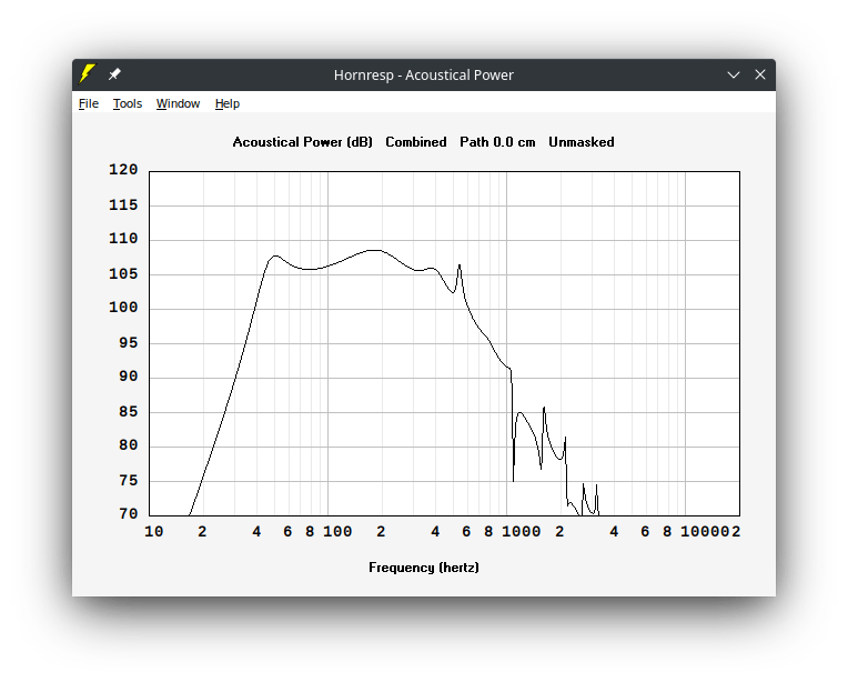

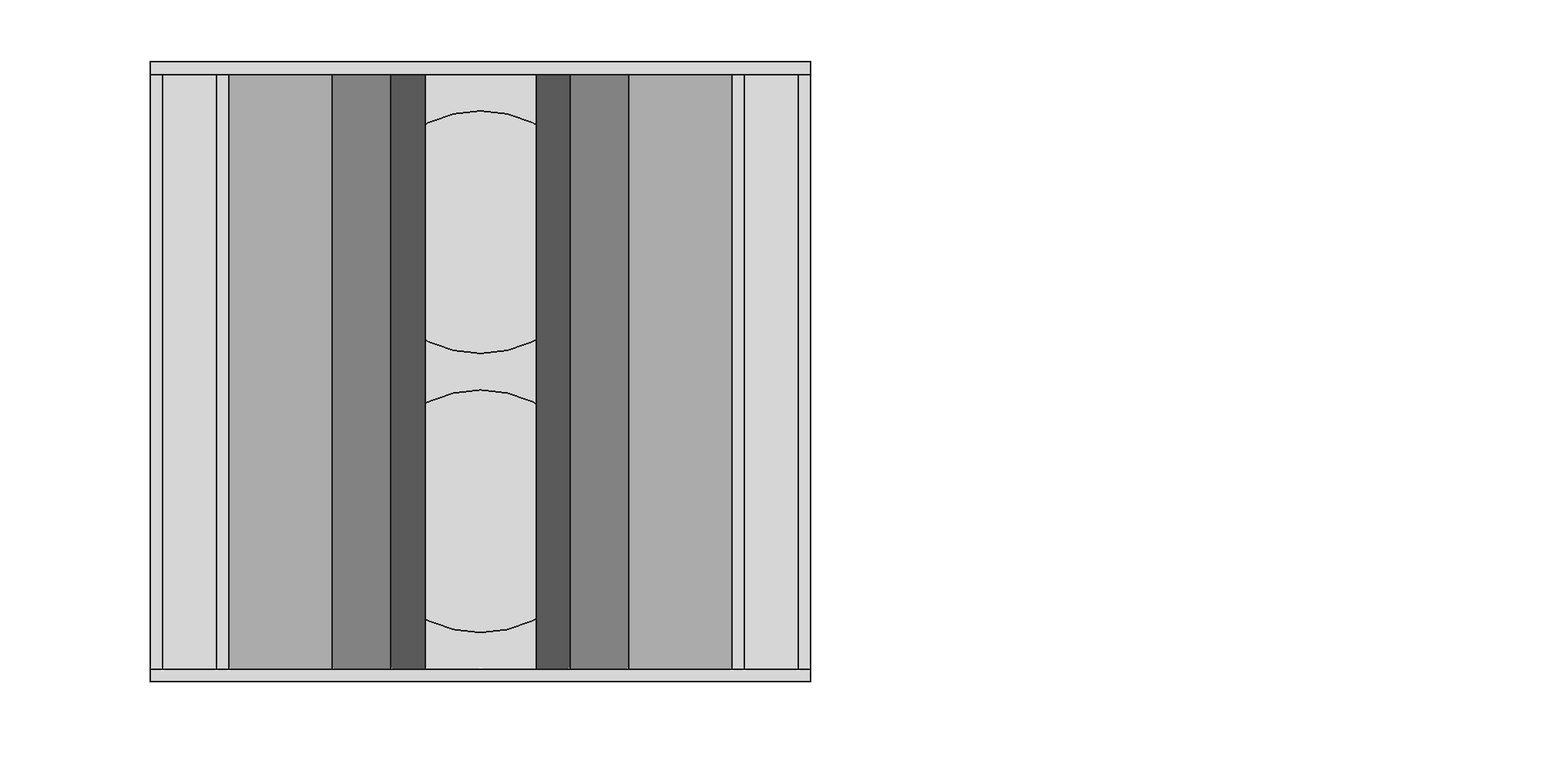

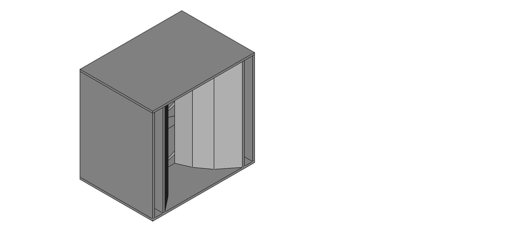

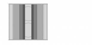

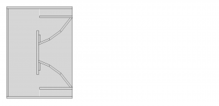

Nice, you are going to be able to do it, see attached the model request. Due to the lacking information for Altec817 it was needed to guess some dimensions, also for the JBL2226H driver some of the T/S parameter I used was from datasheet and others were estimated from hornresp. Attached you can also find the SPL curve I achieve, I didn't tried any otimization. The model is dual driver as the original one, but the horn is made using tree parabolic segments instead of curved profile, in this way hornresp model is more accurate, the same as I did for altec816.
To use smaller driver you need to adjust dimensions accordingly, in your case you need reduce them, they don't need to keep the aspect ratio of the original design once you are going to use different driver, so tune the rear chamber the vent and the horn as you prefer.
To be perfectly honest, the tool may be beyond my competency to use
It's not, you just double click dimensions and change the value, nothing special. The hard-work was already made so anyone with any knowledge are able to use them.
Let me know if it worked for you so I can publish or fix any issue you find. Attached there is also a hornresp input *.txt that you can use importing from hornresp to start playing around.

This position was chosen just because I set up the sketch in the X-Y plane and when the mouth is in the right side, when you switch to 3D environment, activating the standard isometric view you can the see the mouth, if you swap the mouth position to left side, the isometric view will show you the back of the box.
