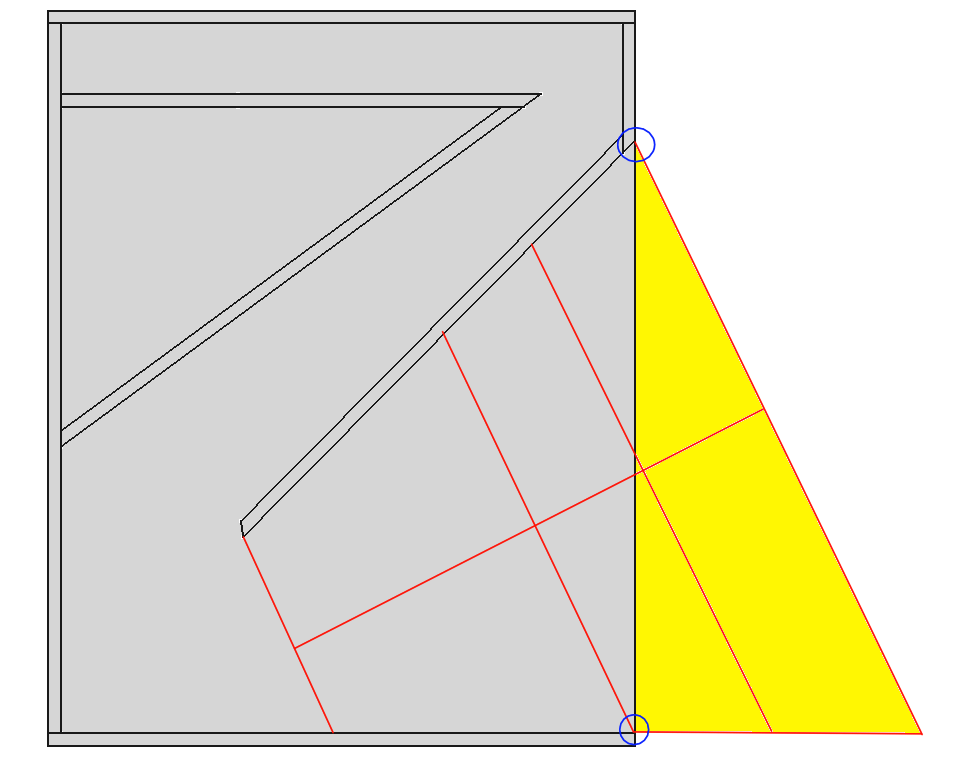

CAD is a nice tool and for me it's very fast to release new layout, sometimes I evaluate new layout but they don't became a full model because the results are not interesting. See the attached evaluation for instance. The models X4b and X5b are interesting I may keep working on them in a future.
If you have an idea in mind, try to make a sketch using image editor or powerpoint and post here so I can try to create at least and sketch model for you to run simulations in a easy way, if it work well I could finish all 3D model.

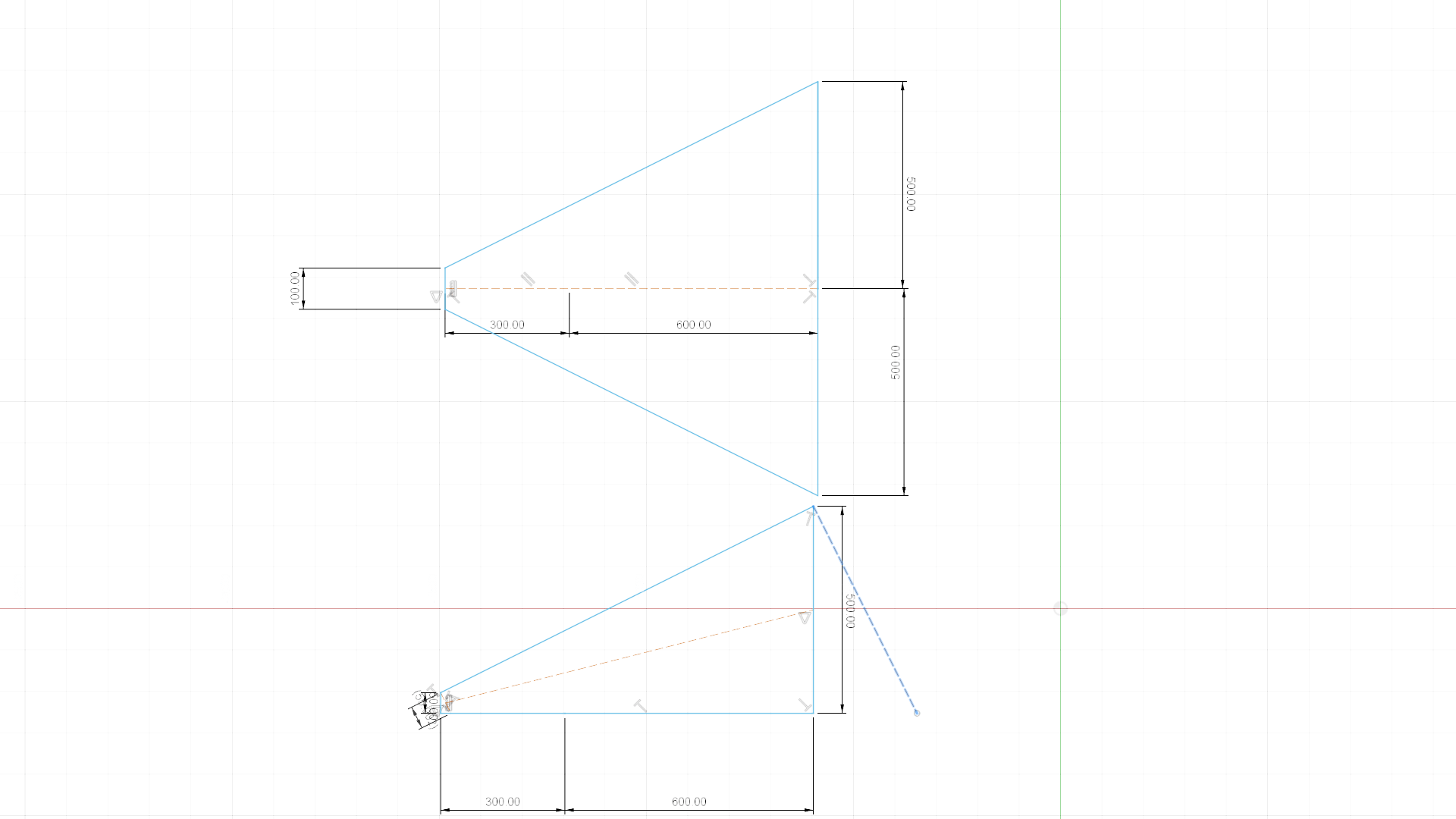

Freecad is crashing on me relentlessly and is most frustrating, any chance you could roll out some of these layouts into other free tools such as fusion 360?
Secondly while I think I kind of understand the advanced centerline methodology it appears what I draw is in absolute conflict when converting this information into cad designs. Right off the bat converting from a dual sub enclosure to half or a single enclosure the line length shifts technically speaking.
A simple example would be S1 value 1000, L12 30cm & S3 being 5000 with L23 being 60cm on a simple dual enclosure making S2 2289, now halving the enclosure halves the above values but the center line also changes in both length and position. I have attached an image which shows half the original enclosure S1 being 500 in this example S1 is 10cmx50cm but with the new angle which is or should represent the 50cm, I would perceive the new angle should be 50cm ( 55.902) is the length of the new angle?
Secondly S3 is it projected against the dashed line or the original line to 50cm, again I would assume to the dashed line vs the original dual loaded enclosure being the 3rd reference image.

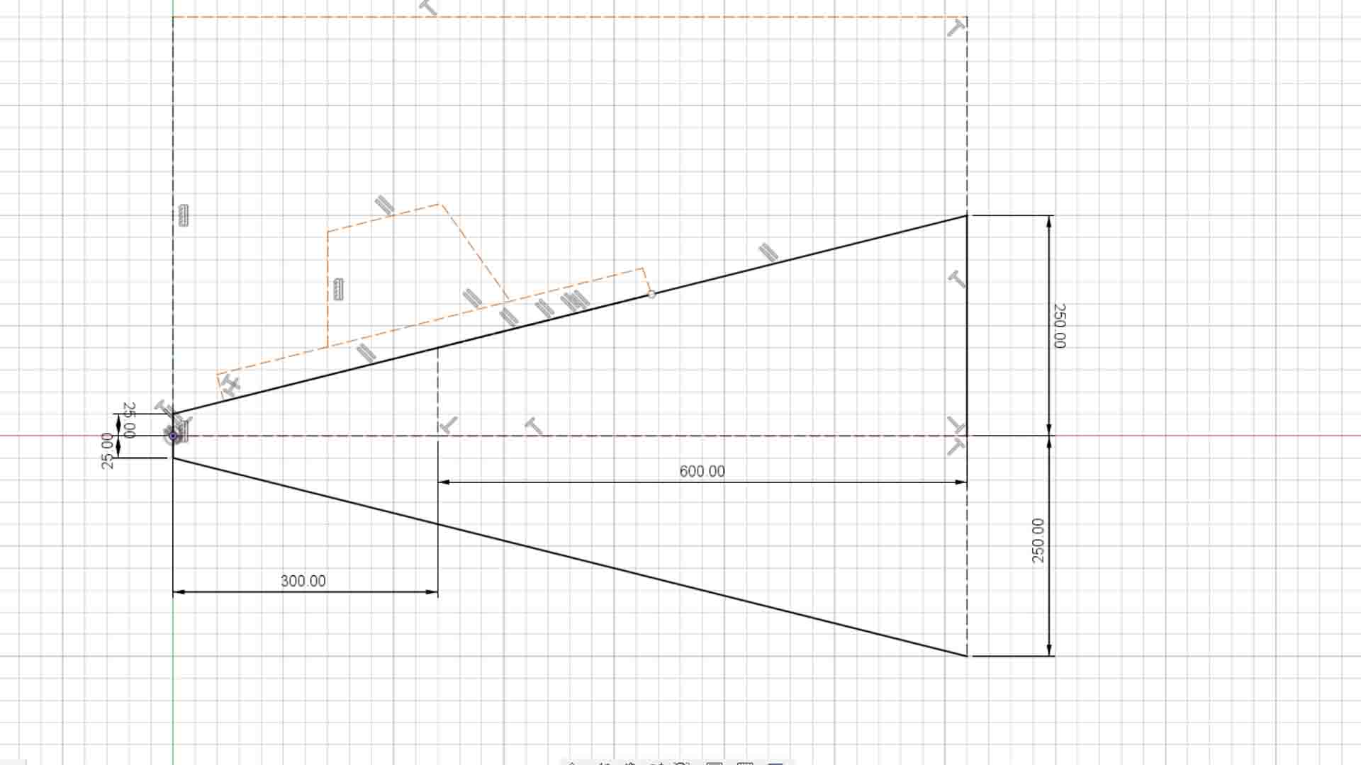

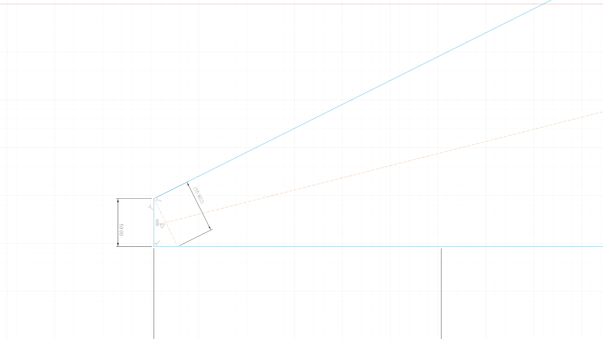

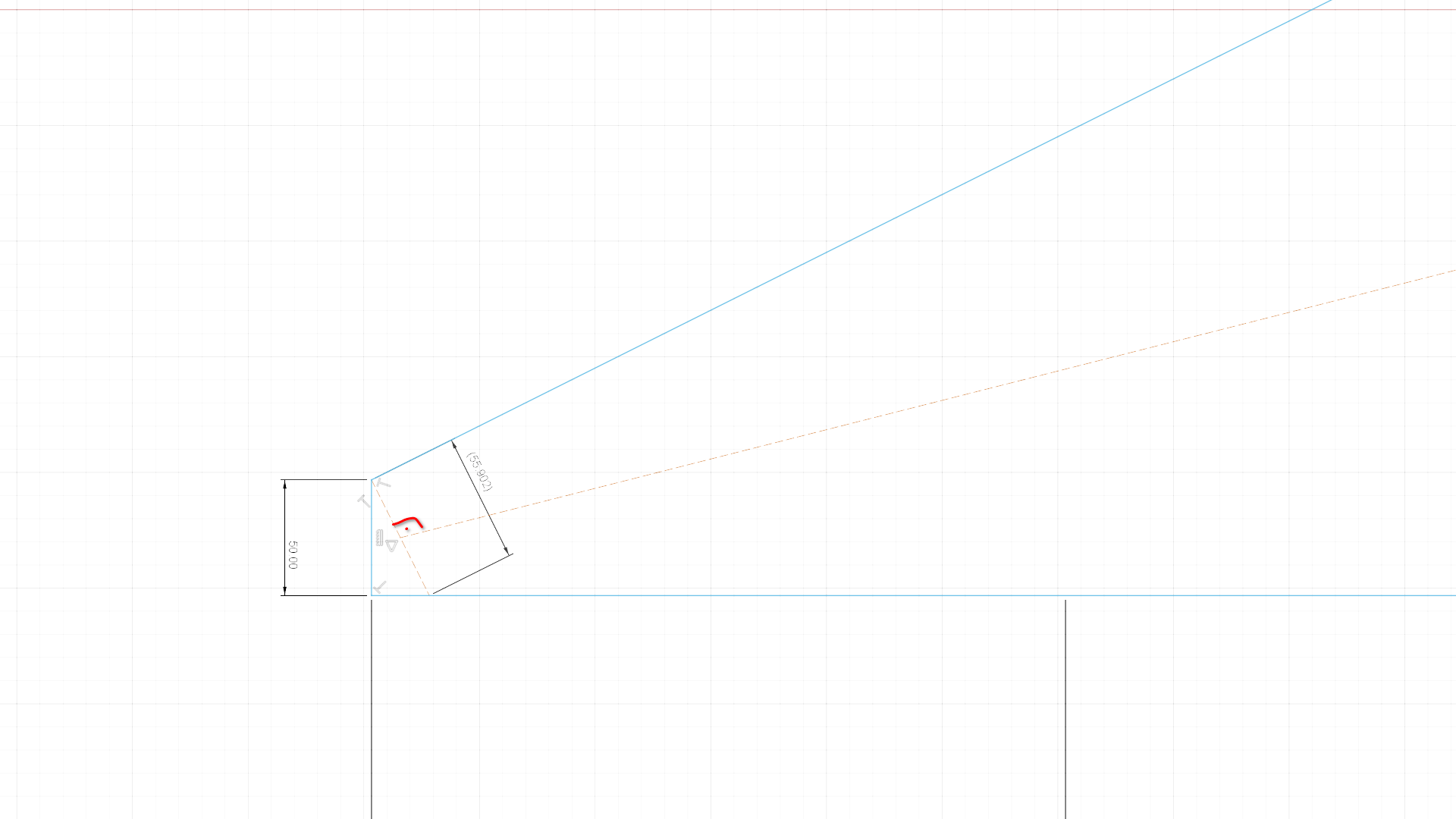

There is one small issue in your advanced centerline, you need to make the middle line orthogonal as you can see in the attachment.
There will be Horn length different between single box design compared to dual one.
In general the single driver box will present little longer horn length because the mouth is "incomplete". Take a look in the attachment#2, if you consider (blue circles) the upper corner of the mouth the horn is longer, if you consider the lower corner, the horn is shorter, so this is the reason I'm calling the mouth incomplete, the yellow area does not exit in the box in terms of panels to restrict the sound waves. So, if you sit the box in the ground, the floor might work as and extension making the mouth more complete, so the pioneer guys of box design, while cross checking data to compare model with real world saw this behavior like the horn length ending outside the box. While for subwoofer it might be fully trustful, maybe for top box there could be some small differences once there might no be the ground effect, considering this case I took the conservative side of thinks and simulate with middle ground length between upper and lower corners, safer place.
Dual driver horn design has complete mouth, as you already demonstrate in your pictures, so, even if it might be shorter, the driver will couple and improve the low end frequencies response.
Having two single boxes or dual box might be tricky and we need to think about advantages/disadvantages of them, maybe they are not exactly the same in terms of response but they will not be the same in terms of material needed to build them. There will always be a trade-off in same way or another.

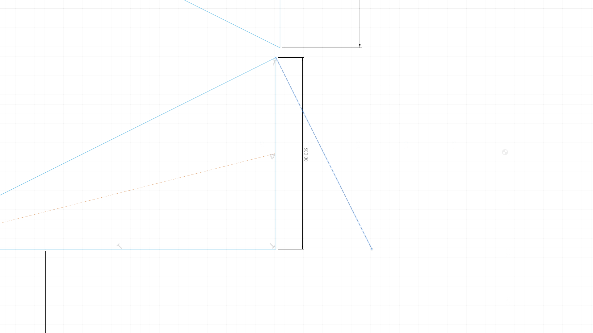

Hi Sansui & thank you kindly for the response!

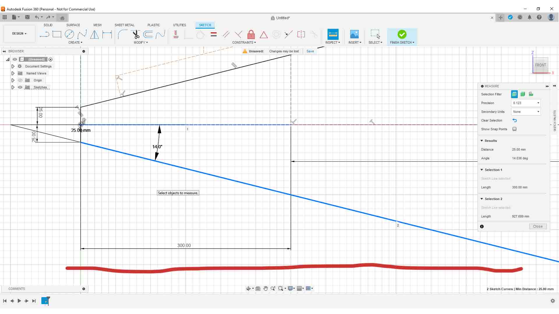

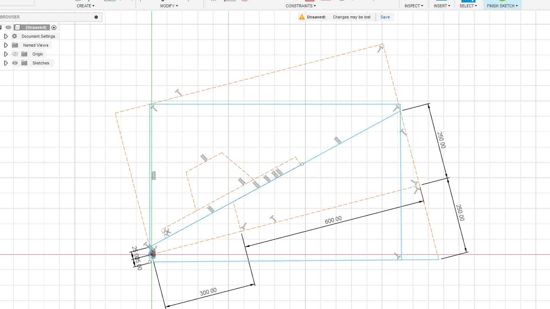

It appears the folding and unfolding of horns are completely eluding me however I am tenacious on getting this right, so in advance thank you for the patience and the time on the subject.
From my primitive example attached I need to orientate the base and the rear to 90 degree or orthogonal as you mentioned.
So If I understand correctly I'm rotating this whole horn by I think in this instance by around 14 degree +- to have the bottom of the horn flat on the floor like image 2 & keeping to a traditional box shape would look like image 3 (dotted lines is the change angle) thus keeping the center of the horn line 90 degree from to back?
Which makes great sense if this is the correct method to look at the horn, it would also explain why I have some small difference in segment volumes!!

The image 3 looks like correctly representing that horn path. Remember to consider it as Parabolic Flare inside Hornresp.
