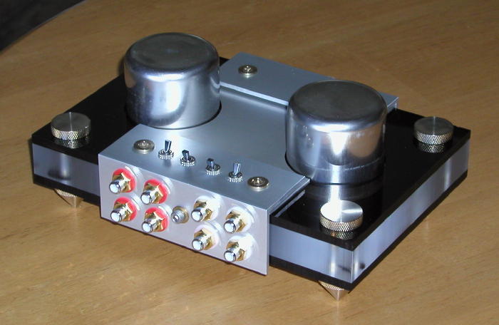

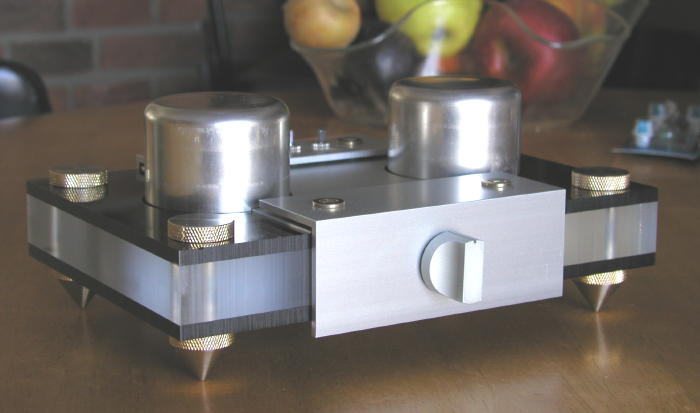

Peter Daniel said:Of course the current version has still some rough edges...
I addressed most of the weak spots of previous design and here how the improved preamp looks. This is by no means a commercial version, but something I built yesterday for myself.😉
Three layers of acrylic are used here and no more gold plated hardware, but polished brass: looks much better this way. I also added 0.5" to the width and this improved final appearance.
Nice!!! Too bad that it just have been christmas, would have been a nice present for me under the tree 😀

Lets see the back!
Wow btw, that looks AMAZING!!! I like the addition of the 2 layers of acrylic, kind of completes the look 🙂
Send one my way 😛

That's too much. I have to say that it looks better than 99.9% of any diy projects, or any commercial products. Actually, I can't think of something that really looks this good. A work of art I say!.
