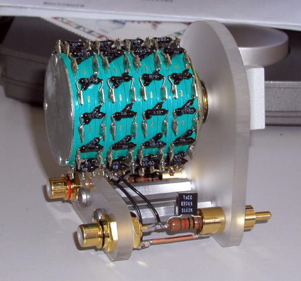

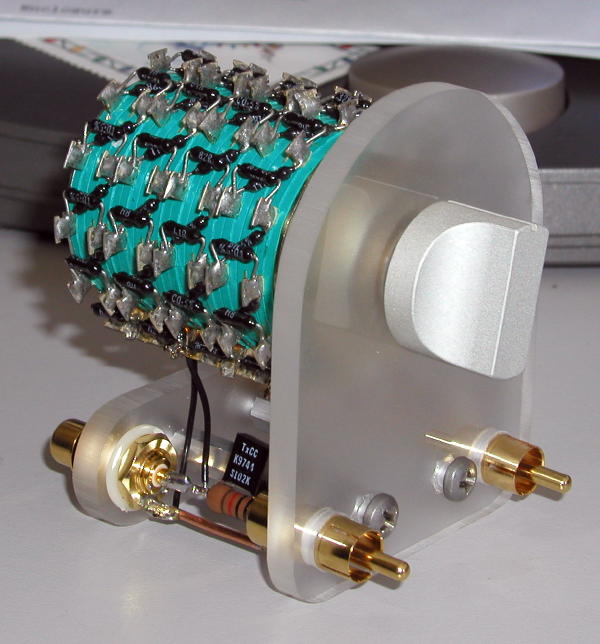

Here's another approach to passive preamp. It can be used as separate unit or plugged directly to inputs on Patek amp.
Although I used Sonic Frontieers attenuator here, any other switching unit can be used as well. That thing works pretty well and is better than a regular pot. I used combination of tantalum/Vishay for fixed series resistance (5k total) and switching Holcos to ground. The signal path is as short as it can possibly be
Those are Holcos (1/8W, old production). I had those attenuators on sale http://www.diyaudio.com/forums/showthread.php?s=&threadid=3279&highlight= but since nobody showed any interest, I decided to try them in this application. Work surprisingly good, and of course 2 decks are not used at all
One might use them in parallel for 22.5K impedance, which could be perfect for GC input. I use them as 50K version, as I have additional 22k Vishay at amp's input anyway.

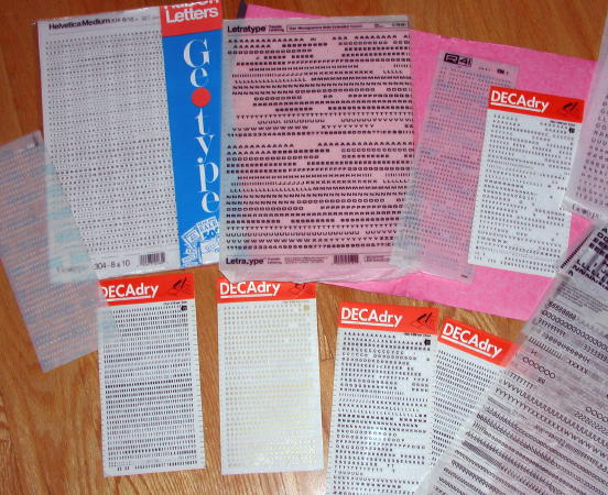

And the question - what do you use to do labeling on the aluminum?
http://www.diyaudio.com/forums/showthread.php?postid=253185#post253185 in that post, you have the inputs/outputs and the switches labelled - i'd like to know how you got them looking nice like that
Do you have a high resolution pic of the front of the amp? I'd like to use it as my desktop wallpaper if you don't mind (yes, i like it that much .. and i'm getting bored of the same old car-nature-abstract wallpaper routine).
If it's a prototype, I'm using dry transfer method. You can get that stuff in graphis supplies stores and the ones I'm using are from Letratype. It is pretty durable and I have equipment which is 20 years old and the lettering is still in perfect condition.
In production I use silk screening. We tried laser etching as well, but some burning of anodising occured. We will be testing it on next batch of panels.

The picture explains it the best. Whenever I was traveling, I was always looking for nice lettering that could be used on equipment. It was pretty hard to find small characters that present proffesional look. Most of that stuff comes from Europe. Of course it was 15 years ago, when computers were not a s popular and useful as today. Still, I find it sometimes much more convenient and fast to use that technique than anything else. I don't like using laquer, as it takes away the natural look of brushed aluminum. My olderr equipment wasn't even anodozed and still looks good.
