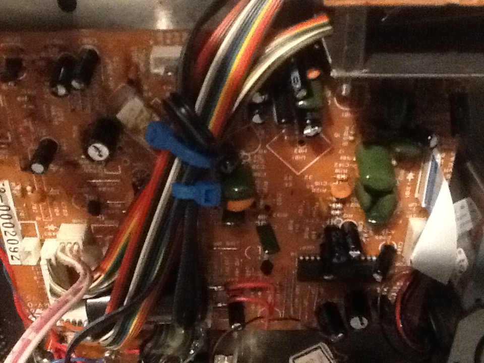

Sanyo SF-101 cd mechanism issues
Although I have not actually built a Shigaclone construcction I have been following this thread because I use a 47 Lab Shigaraki CD transport, which was the inspiration for this project.
So, maybe can help me here. Lately I have been having issues -skipping and distorting- with the mechanism reading some CD's. Basically I have some CD's which are read completely by my Oppo 93 without any issues and these same CD's have problems with various tracks when played in the Shigaraki. One of them is practically new.. I cleaned it and got a little better...
I replaced the mechanism and also the ribbon connector but it keeps doing the same. I have examined the CD's in question and there are no major scratches in them, at least visible with the naked eye..
This mechanism is the 15 p one, not the 16 p you guys use in the Shigaclone..
So my question is: is this laser or mechanism that sensitive reading CD's or is there something else wrong?

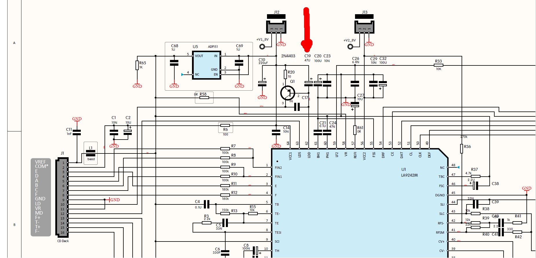

I suggest you to replace laser CCS capacitor to a high quality tantalum one, as we use in Shigaclone.
This should clear your reading issues.
In Shiga MKII this is marked C19 and is 47uF/6V - see attachment arrow.
You need to find equivalent capacitor in Shigaraki.
Tibi

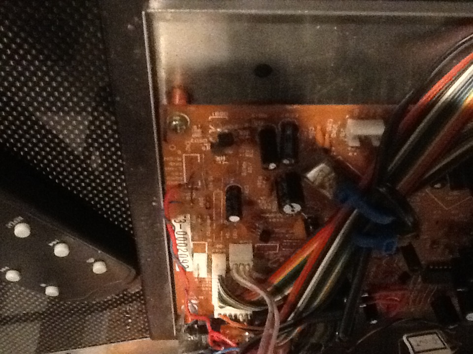

Thanks. I looked into the board and the chip is the same as you show above, but I could not identify the cap you refer to. There are no regulators around that chip. The only ones are at the input of the AC, one for 8v and another for 5v. There are a bunch of electrolytic caps around the chip area and ribbon input -and some green film ones. One of these has a value of 15K written on it-. I will post a photo of the area.
Follow the trace from LA9242M pin 62. The cap should be between 33uF to 100uF and is near to a 2SA608N transistor (in my schematic Q1 - 2N4403)
Tibi

Manolo47,
If you want to get help, you need to provide more than a blurry image.
Remove the board and make macro pictures at high quality, in order to see traces and parts values. Details matter.
