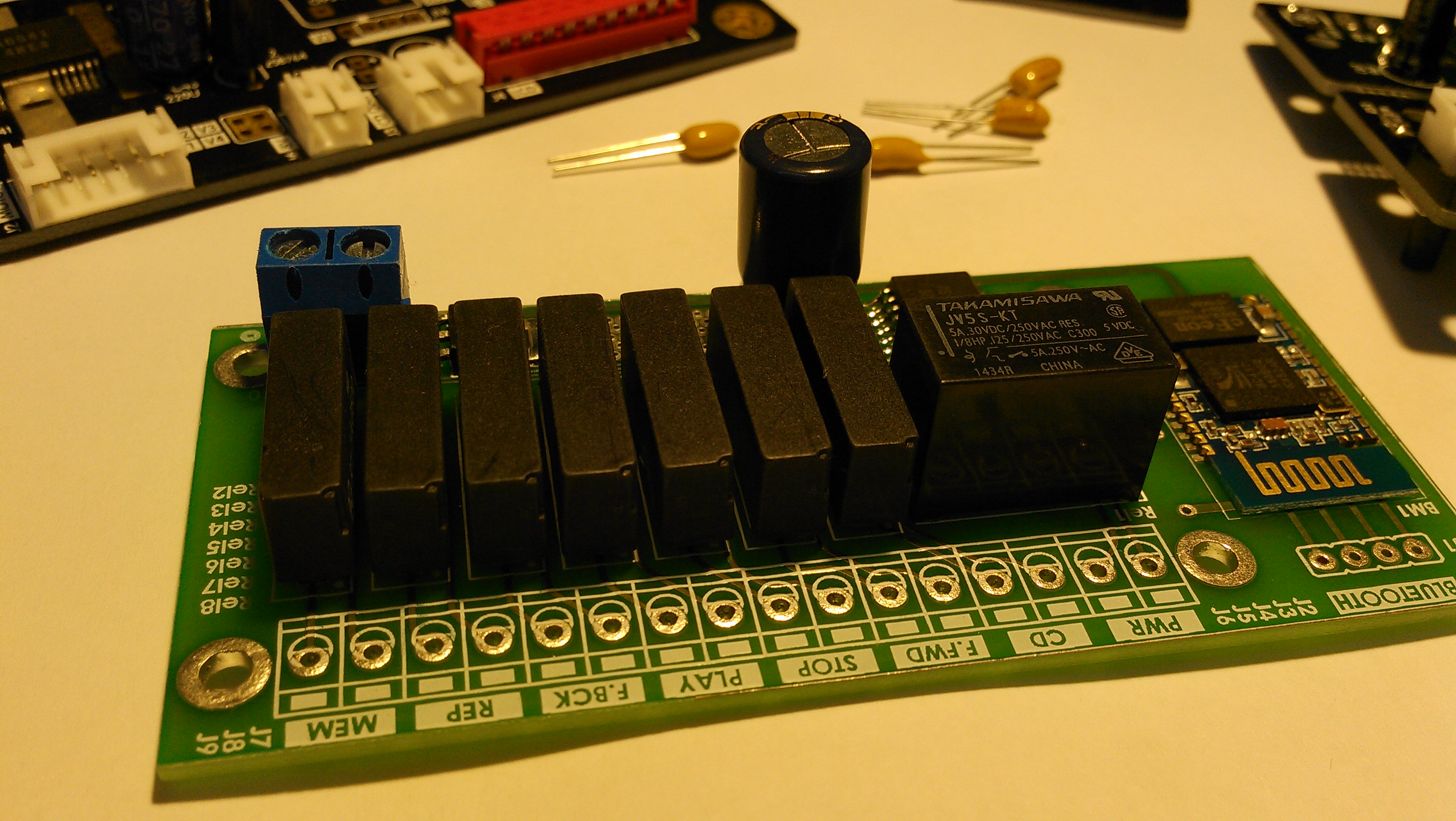

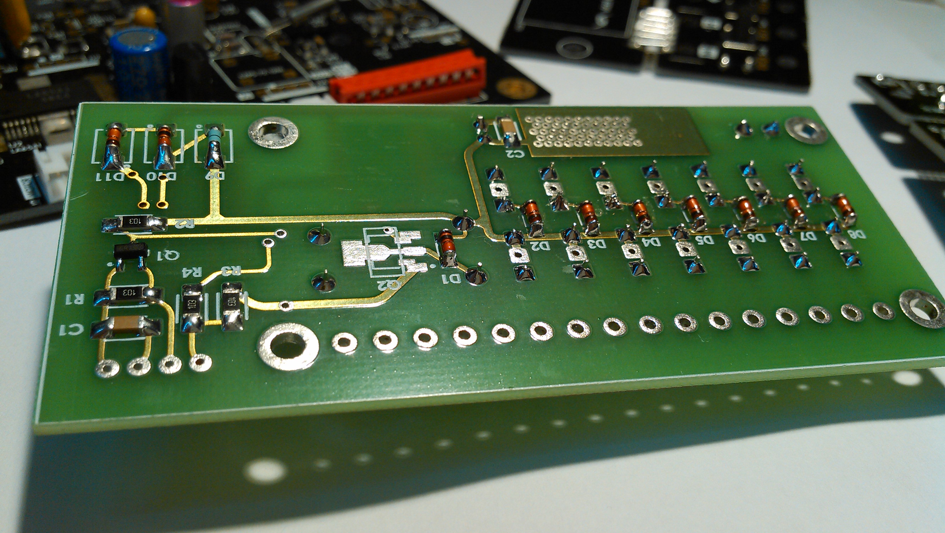

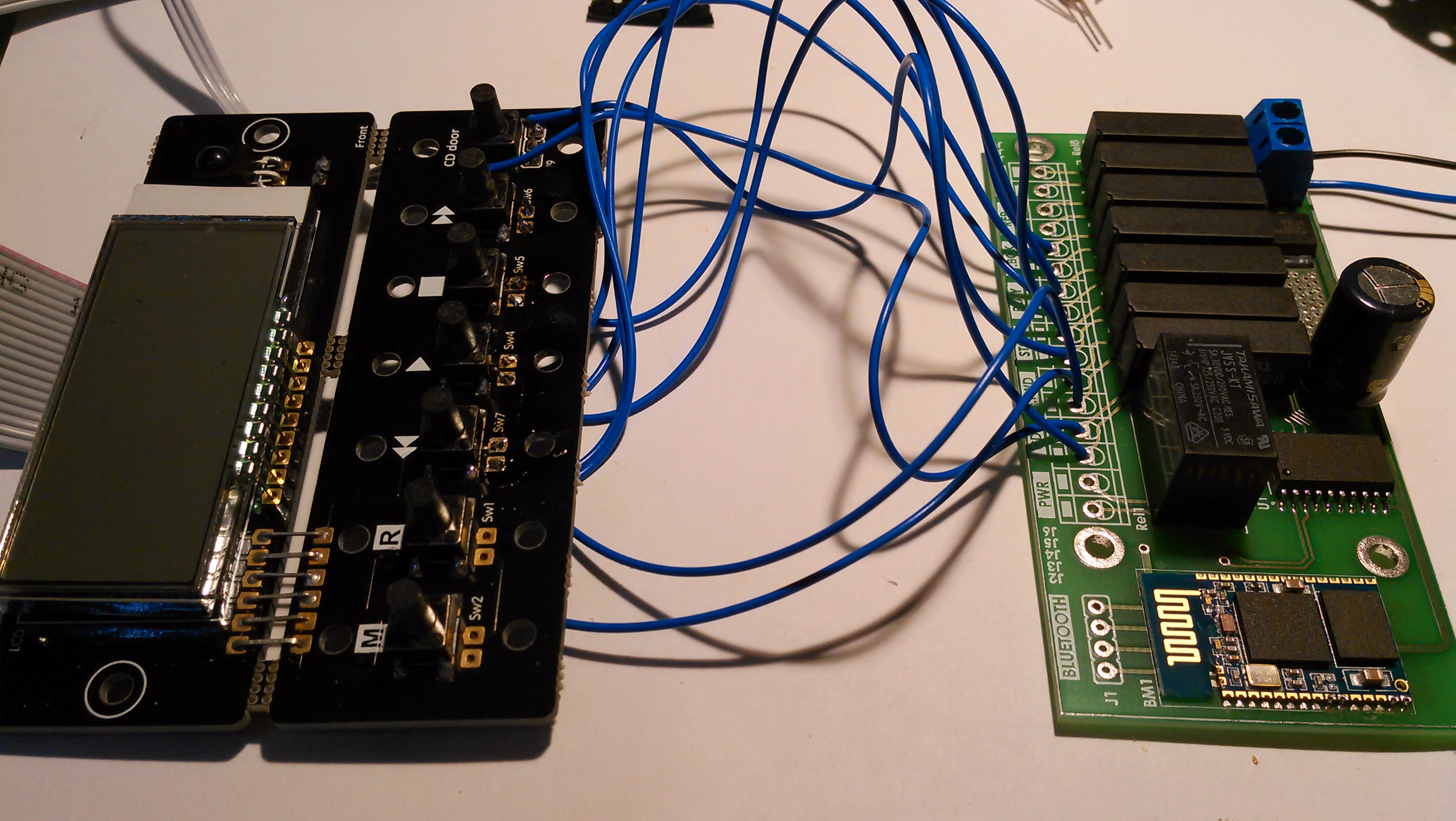

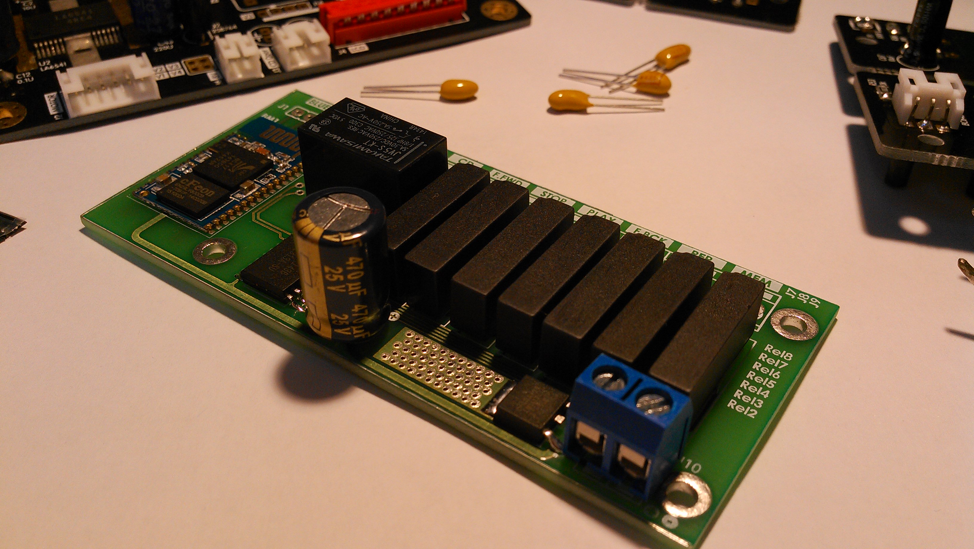

After lot of soldering and codding, bluetooth remote control is here.
A short video. 😀

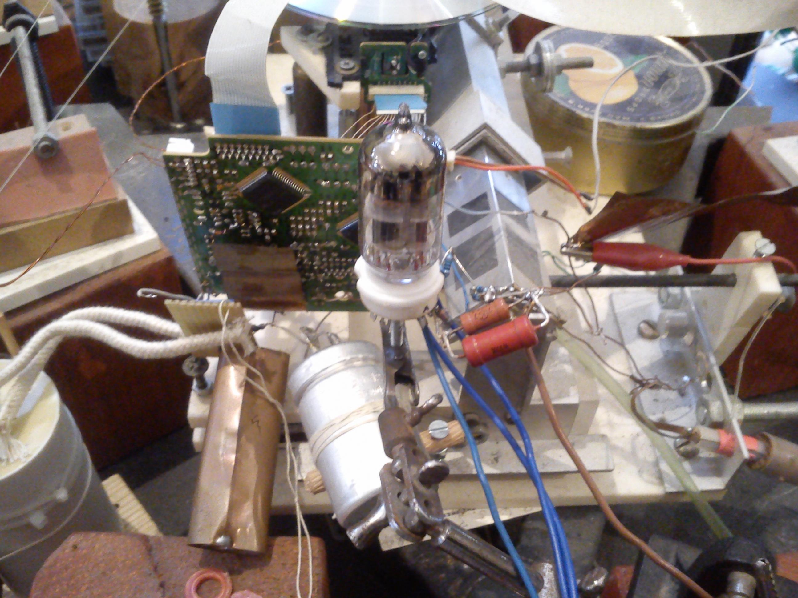

Tubed Lukasz Fikus Digilampizator
Hello everybody ,
Many years ago I made the valve digilampizator and lately the mosfet version too.
The semiconductor version was something non appealing sound wise but just technically correct missing the guts and the soul of the music.
Contrary to SS ,the valve version I recall as something special and yesterday I had to resume once again my impressions from past years.
The resulting musical feeling with the tube on s/pdif is something so special that I wonder why I didn't made it once again much earlier but there is always a problem having the time for only few projects chosen from the endless list in your head 😉
The valve circuit make the music more intimate ,alive and credible.
The technical aspects of the sound (instrument placement ,separation ,3D etc.) is pretty much the same as with 300+90ohm resistor divider on digital out.
The digilampizator show you that the music that you listened through years ,have something more in it.It is hard to describe it because at the same time it allows the fine details to expose them self ,coming to your ears but those details don't grab your attention.
Instead the DL leave you to swim in between all that details and emerge in the music as a whole 🙂

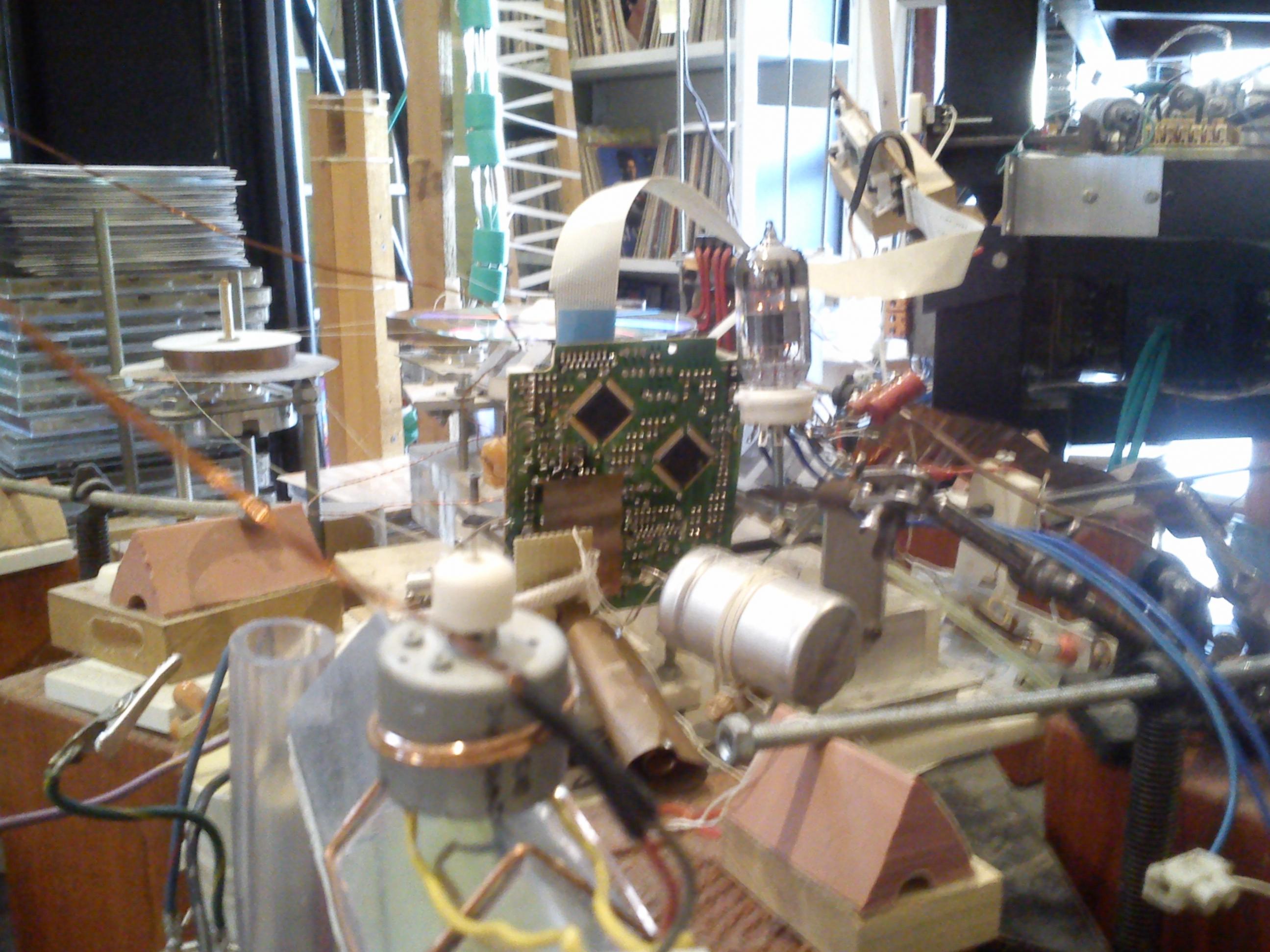

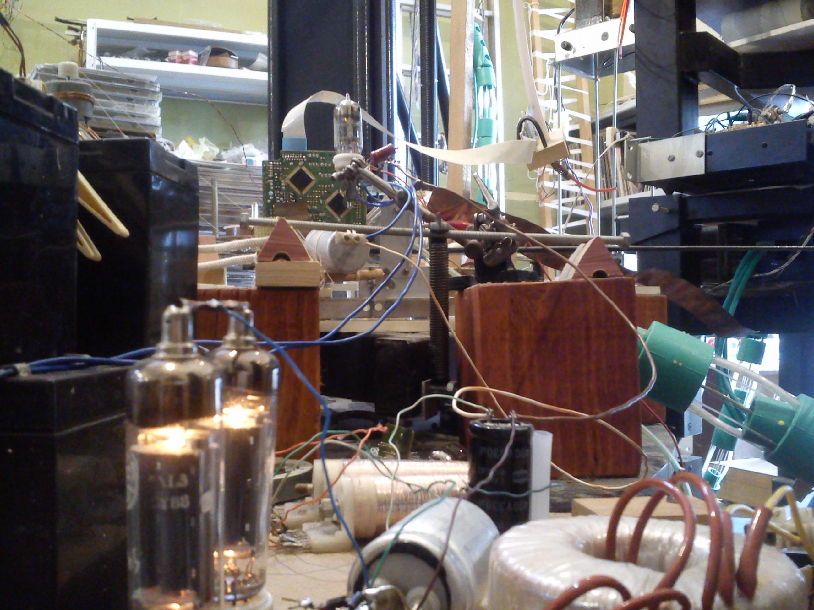

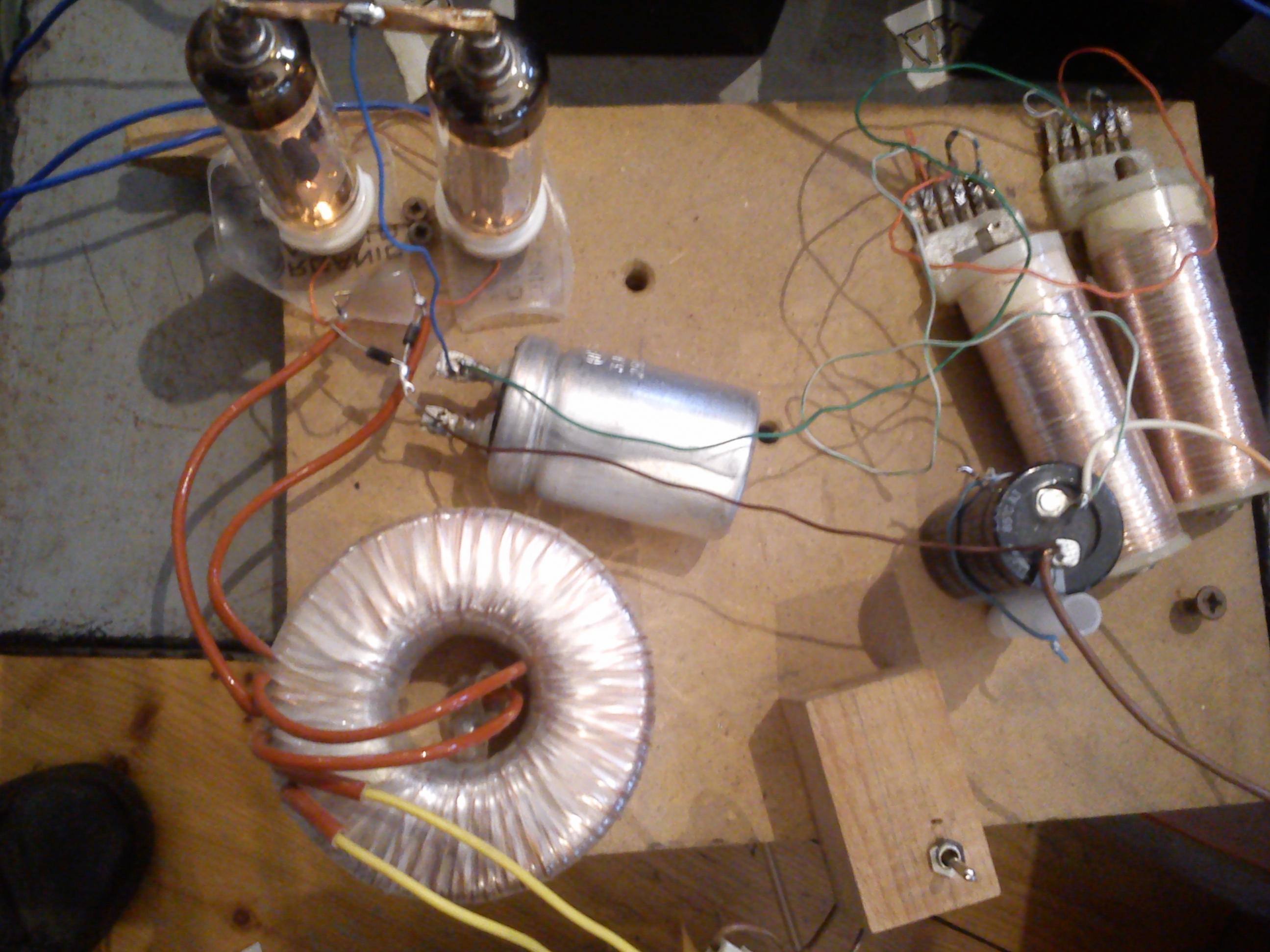

The PSU consist of 79V toroid transformer connected on ey88 rectifier tubes in hybrid combination with the SS diodes ,connected as a ground part of the bridge.
The CLC filter is made of 4microF PIO through the 1000ohm choke (I am not quite sure about the inductance ,maybe 3-5 H ?) and the electrolytic after it.
The signal tube is 6n23p which sounds much better than 6n14p but you can test many tubes in this position.
In my experience the circuit is sensible to grid to ground 15kOhm resistor choice and currently the Russian mlt-2 plays it's role in my DL.It have more drive through the whole frequency range than other metal film resistors.
The 75 ohm resistors I didn't tested jet.
The heating is DC.
There is very little written about digilampization sound impressions and unfortunately a lot about DL circuit being a total nonsense (I suppose from people that didn't tried to build and listen to one hehe) .
Well, I don't care anymore about these words because the DL does much to my musical experience completeness and I encourage everyone to try it if the way the MUSIC is expressed to you ,count more than just a plain hi-fi ....
