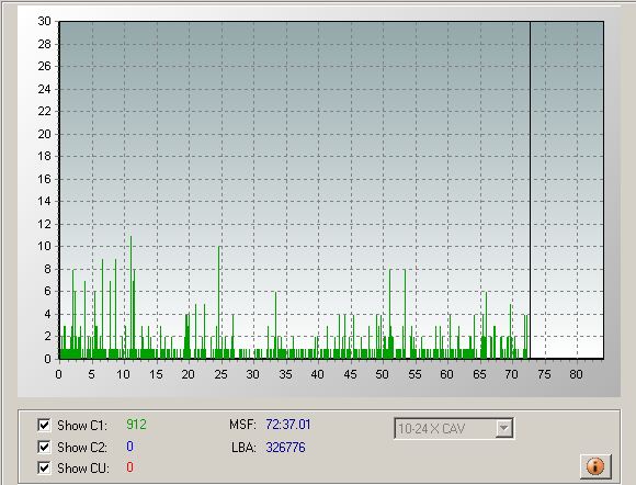

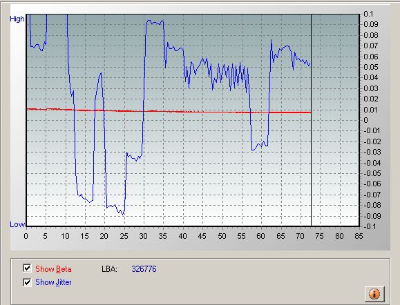

Tibi, I created the CD. I'm attaching an analysis of the track quality. The C1/C2 scan looks amazing (it's about as good as you can get - although I've had one or two better 😀 ). The beta looks good too, but the jitter spectrum looks very odd. I've never seen anything like this. Is this an artifact of the type of tracks which are on the disk? I've never made a disc that's had such an odd jitter spectrum.
