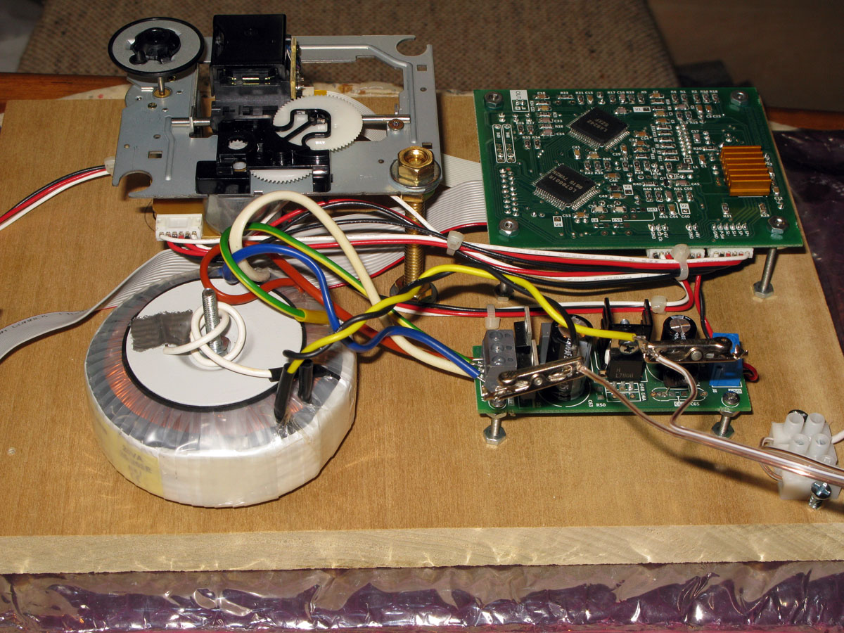

When laying out the components for permanent arrangement, would it be better to locate the toroidal transformer near the PCB, or near the transport mechanism? The xfrmr would be within 1" of one or the other.

What sort of field is given off by a toroid, I wonder? I was thinking that maybe I don't want whatever field emissions it gives off being too close to the digital PCB. OTOH, do I wan't it to be otherwise near the transport, potentially affecting its reading/error quality?

I decided to put the toroid up by the transport mechanism. I might build a copper shield around it, but for the moment I think this is a better place than right by the PCB.

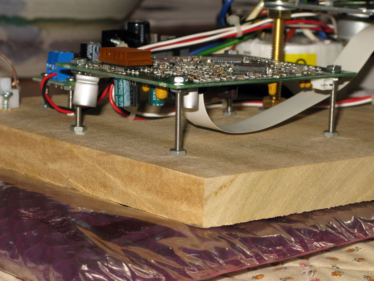

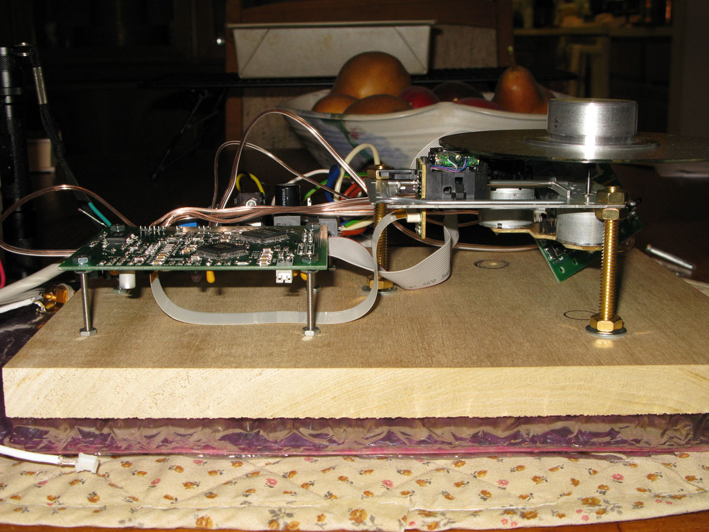

The next question is whether there is going to be too much pressure on the digital cable when it is at the end of a CD. I have two pics attached - you can see that when the read head is at the end of a CD the cable bottoms out on the hardwood base. Will this put too much counter pressure on the head, leading to a higher incidence of read errors as it progress across to the end of a CD?
I seem to remember (but can't find) a discussion about twisting the wires going from the PCB to the mechanism. Did we decide if individually twisting each of the three pairs of wires made any difference to the sound?
In my experience the sled motor circuit does not like added inductance.When I have used ribbon cable everything was fine.When I made longer cable ,until I twisted the poles together I got strange jittery sound coming from loudspeakers.If you use any ribbon cable where individual poles are not separated it will be OK since by given construction the inductance is low.I am using around 0.5m of magnet wire so by twisting them together I get pretty capacitive cable so the length isn't problem regarding inductance and everything sound like there is no three times longer motor cable than usual.I never twisted the short run of cable ,just used short ribbon two poles.

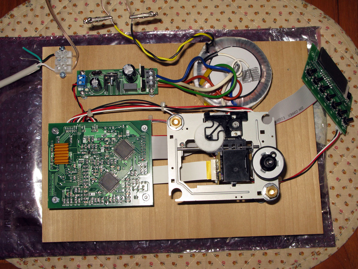

My "stock" Shiga so far

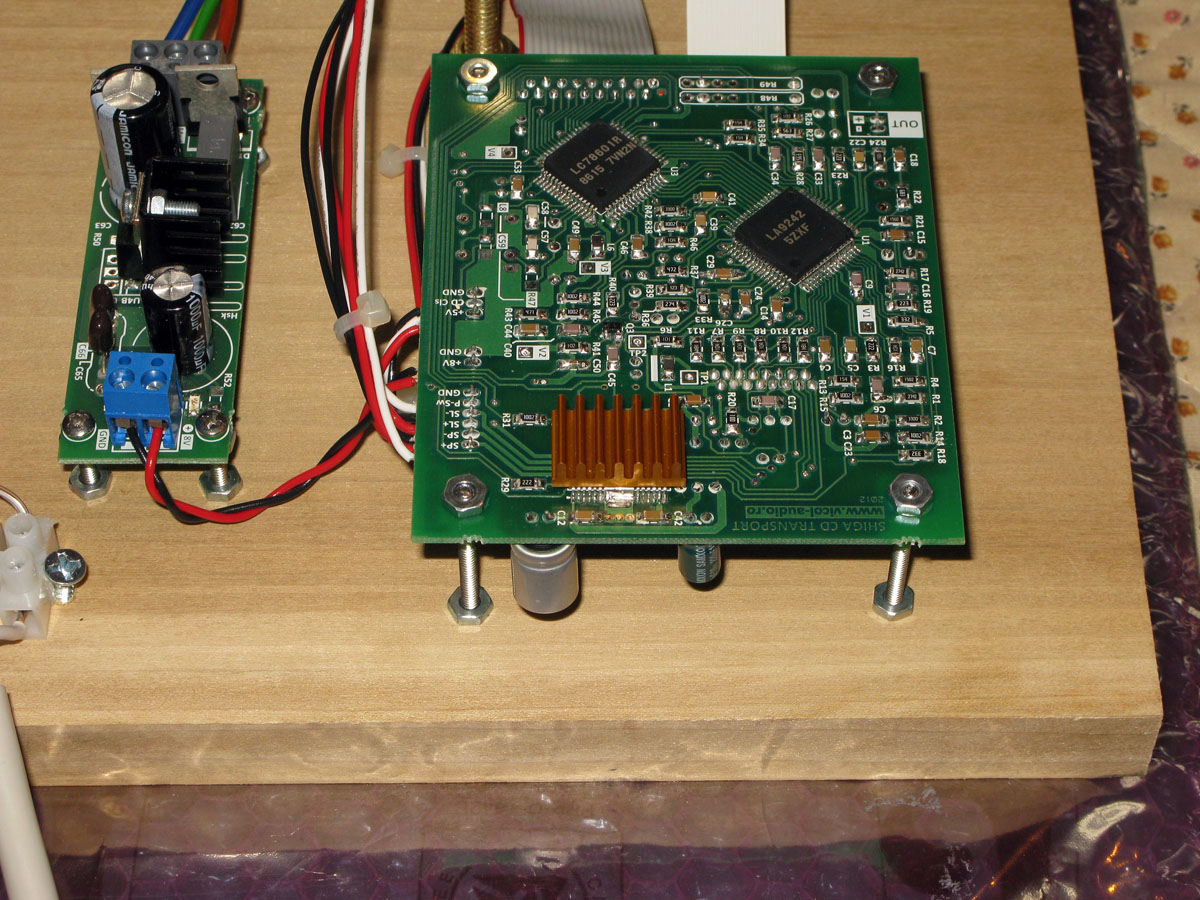

Okay. I decided to post some pictures of what I'm calling my "stock" Shiga. This is the ready-made set of parts I got from Tibi. I completed the layout and the wiring and decided to take a few images before starting on the enclosure.
The enclosure will be made of 1/4" red oak for the sides and the back, and 1/4" poplar for the top with braces on the underside to minimize resonance in a sheet this size. You can see in the last couple of pictures the heat sink I got for the LA6541. It's from Masscool; a bit too big for the chip but it has an adhesive back and it works (convenient). Ignore the temporary terminal strip to bring in the AC power. That will be replaced with an IEC inlet, fuse, and switch when the panels are in place. The digital out will be RG187 going to an Amphenol BNC.
I intend this version to be my stock reference, and the second one to be my custom hot-rodded job. I'm going to live with this a bit as I slowly build up the second version.

Hmm, what should be gorunded to what? Should the PS board, the digital PCB, and transport frame all be grounded together? Should just the frame and digital PCB (at the mounting hole contact pad) be grounded to the green wire of the 120 VAC input?
Nice and Tidy work.
The way you want to go ahead with a second one is the way to go.
Mind you if you modify succesfull you should actually imply it in your stock transport as well (one mod at a time) in order to always have an optimal sounding reference...anyway that is how I build it brings me much info....just a tip 😉

Yes ,this is good.You can also use twisted pair wires from UTP or take any solid wire cable and twist it much tighter than stranded cable.

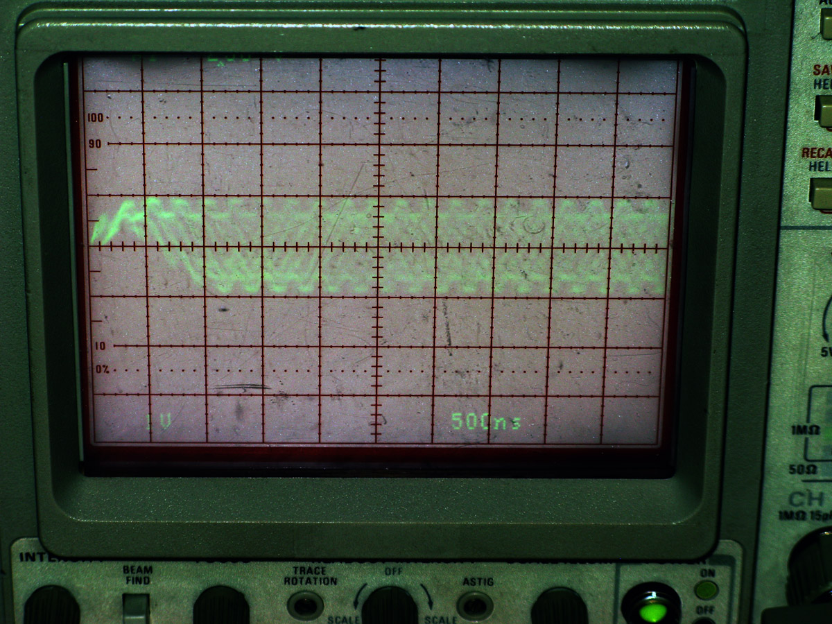

If you have a scope, write a disk with my test cd vicol audio : support, play trak 13 in loop and have a look on LA9242M pin 41. Post a picture here.
Tibi
Tibi, this was difficult to do, but I think I have a picture of what happens when Track 13 palys. I had to hit the "Auto" button on my Tek 2465A in hopes that it got what you need. I also had to really play with the levels and contrast on the image to get it to show up (it's fine on the 'scope display but I had to use flash to get the image, so it's a bit washed out). I placed the probe on the chip side of C41 and the ground on the digital out "-" terminal.
