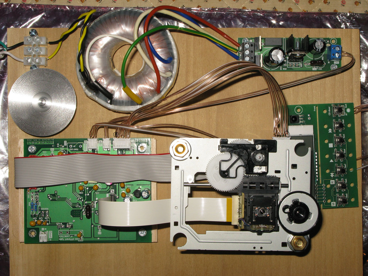

Well, I'm not quite sure what to make of this. I finished making all the cables and started checking things one by one after plugging in each cable. The PCB test points seem okay. I powered down and then plugged in the three pin cable for the front panel. The display seems to do what it's supposed to do. Then powered down again and plugged in the 6 pin motor drive cable. As soon as I powered back up the mechanics of the sled started slamming against the stop closest to the hub. I pulled the power immediately.
The sled has had its shorting blob removed and the laser cover is off.
I made that cable by laying out the six wires in parallel, between the connectors which were back to back, both showing their guide bars pointing up.
I'm attaching a photo of the setup. Right now I have it built on a slab of hardboard so I can get it up and running quickly for testing and evaluation.
If you expand the image to full size you can see that on both ends of the 6 pin cable, at the connectors, I circled the same wire at each end so you can see the orientation. It's a black circle in each case so it may be a little hard to see.
I tried both of the mechanisms I got from Tibi and they are both slamming at the stops.

It sounds like you have got the motorpolarization wrong...check that...it is the only thing I can think straight of..... right now (after a nice meal ...bottle of white vino just finished 😀)
Yep... I had the same prob a couple of weeks ago. You can fidn the relevant post if you re not bored...
You got the 6pin cable the wrong way. Just flip one side
Yes, yours is wired the reverse of mine, Fred. I wish someone would have corrected w_f's direction in that range of posts. Could I have now damaged anything?
Does that also mean the three pin CD Door cable needs to be wired in this same reverse orientation?
Tibi, please update the documentation to show the correct orientation of the connectors for wiring, and also add a warning about which pin is the positive side of the 8 VDC when looking at the top of the PCB.
Fred, dimkasta, and Eric, thank you all for the correction. I rewired the 6-pin and the 3-pin and finally got things to work.

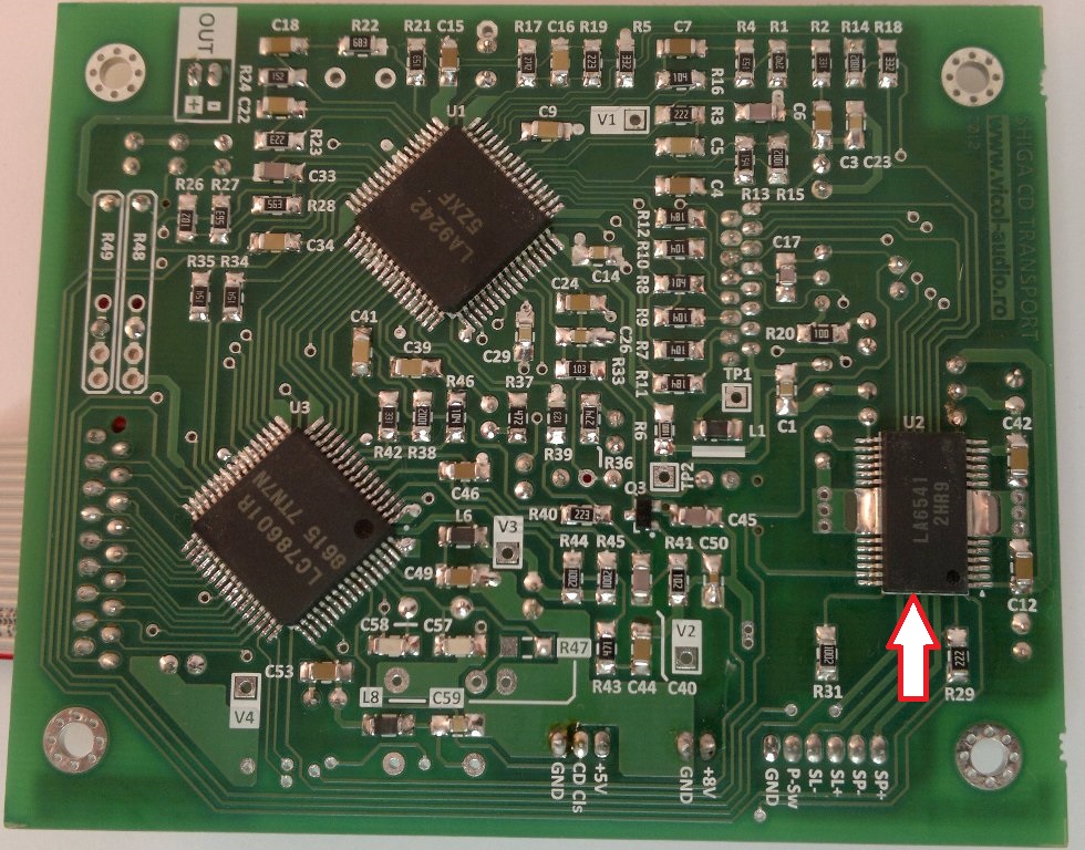

Rudy, look at Tibi's instructions for Shiga assembly (the PDF file found on his website). He recommends a heatsink which you should be able to get from Farnell. I think it has an adhesive thermal layer, so it will stick to the chip. No mounting hardware should be needed.
