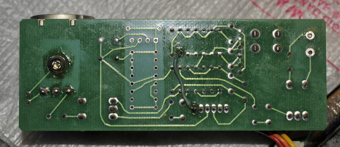

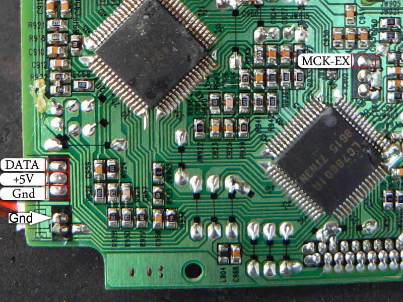

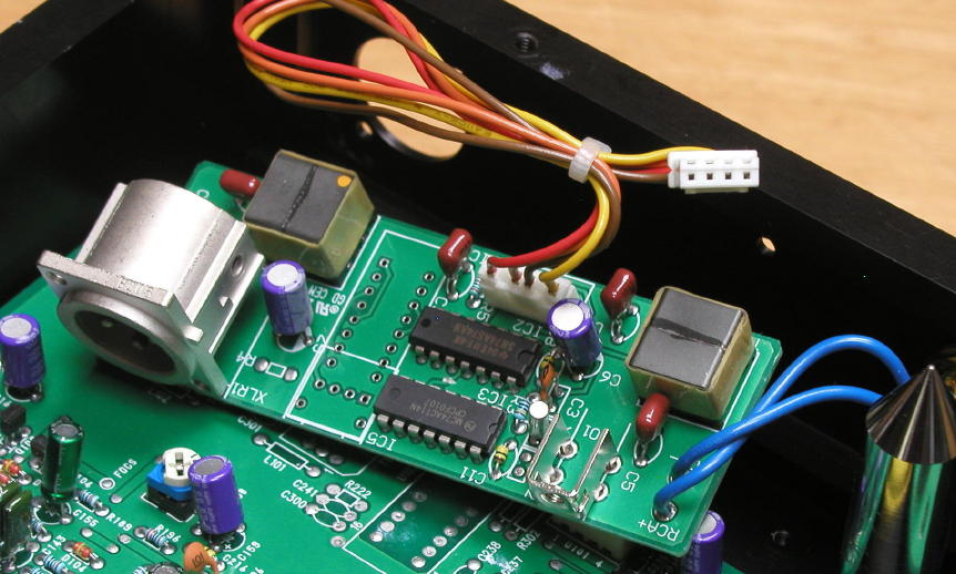

Hi Uncle Leon
Peter Daniels compared shiga with CEC TL-0 and Mark Levinson 37 Mods
used Hammond, BGF 1000uf 35v, BG Std 1000uf 50v and BGN 47uf 50v.
Then a new invention output modul and new + 5v module reported has
increase performance of the shigaclone but never compared with other
The output modul take from CEC TL-0 output and citizen crystal mods
came from Romy The Cats website about the CEC TL0 - citizen crystal
picture output modul taken from
http://www.diyaudio.com/forums/audio-sector/160373-cd-transport.html
http://www.diyaudio.com/forums/digi...rdable-cd-transport-shigaclone-story-387.html

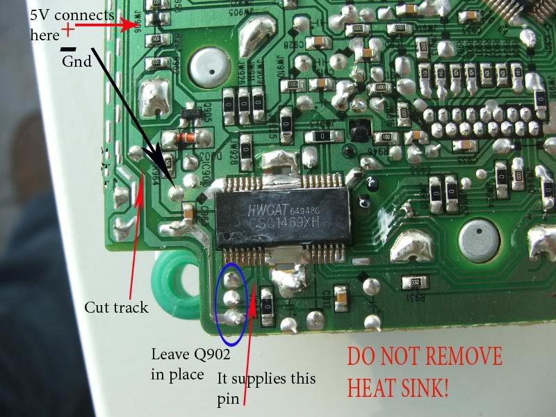

picture +5v regulator taken from
http://www.diyaudio.com/forums/digi...rdable-cd-transport-shigaclone-story-470.html
