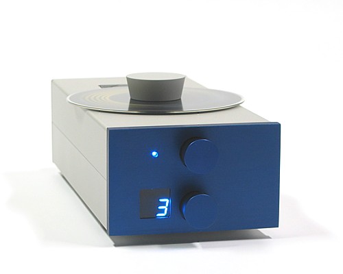

Few pictures with Shiga prototype chassis.

Front display.

Top plate is inox made and laser cutted.

Top and bottom are acryl.

All works are laser made.
Materials used are Forex, Acryl and Inox.
More pictures will come with filnal versions.

Good work! Very nice chassis !
I would add a cover against the dust.
Thanks, I´ll take in consideration your advice.
Tibi
Just supply it with a clear/blank CD which the owner can put in place when not in use.
Many thanks for this excellent solution. 🙂

Tibi - I see from your pics you are using a tinted black or blue acrylic for the display cover - how does the display work out with it?

I´ll make few more pictures.
