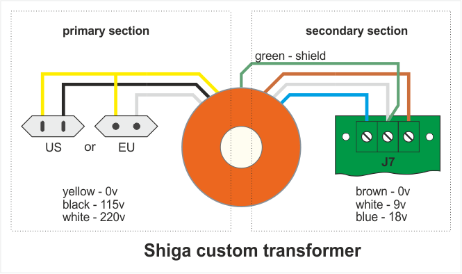

Transformer Secondary to J7 Connector
Tibi or anyone else...
Referencing the User Manual, I just want to make sure I am wiring the transformer to the Power Supply Module correctly.
Viewing the actual Power Supply Module in that SAME orientation as the Diagram, the silk screening marking AC2 is to the left of J7 and the the Blue wire is connected to the J7 input nearest the AC2 marking and the Brown wire goes to the input nearest AC1 to the right of J7...is this correct?
I have the Green/Yellow and White wires going to the center input on J7.

Hello Sean,
As per https://docs.google.com/document/d/1vlabZc_1If3x12ox2A5ECZxC0HLGnuOWdM-j9X4b7Q0/edit
Page 12 you have a primary and a secondary.
For 110-120V on the primary you may use yellow with black or black with white. It is symetric.
On the secondary you need to have grey and green connected together on the center point. Brown and blue does no matter how to connect them.
