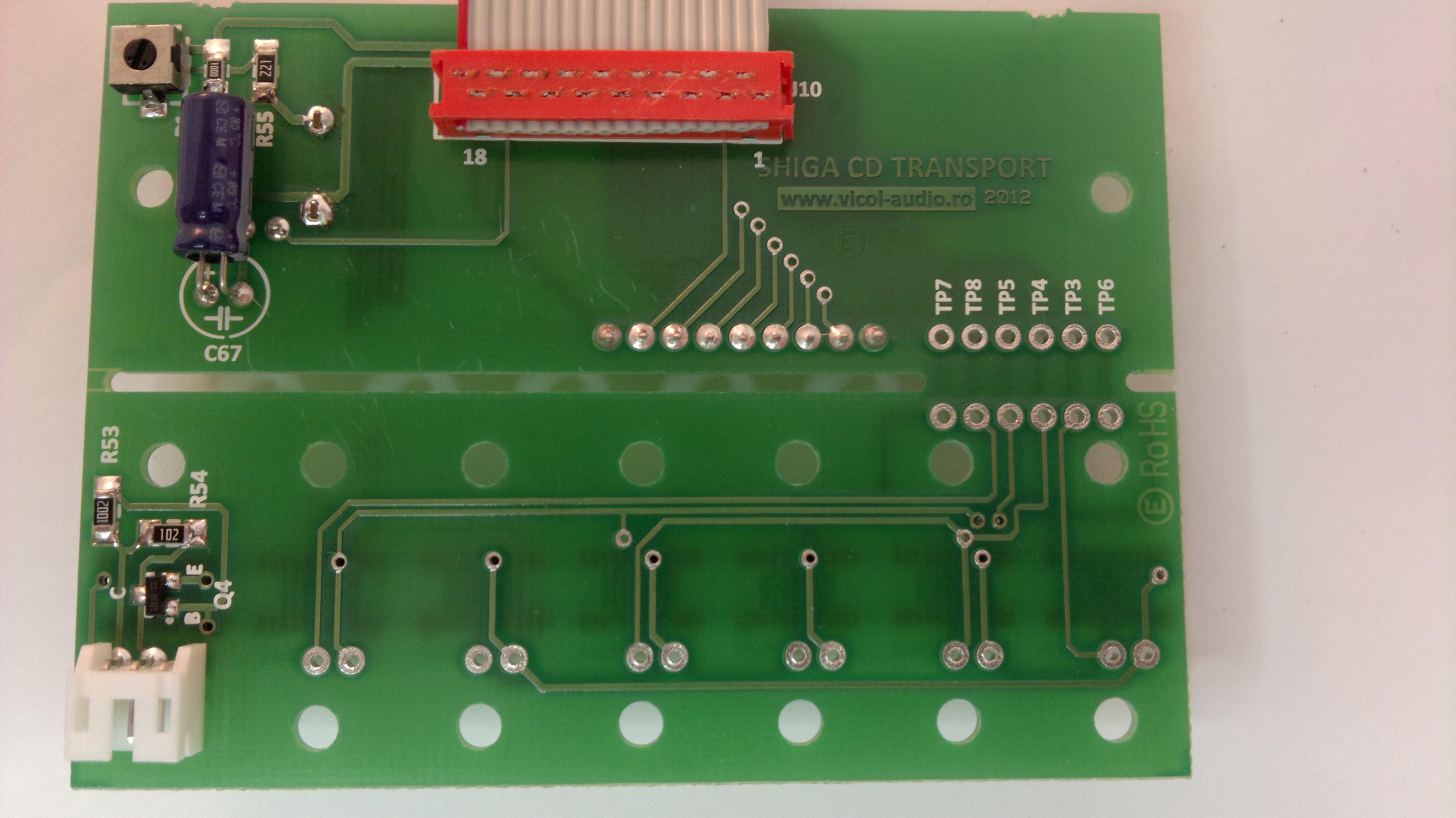

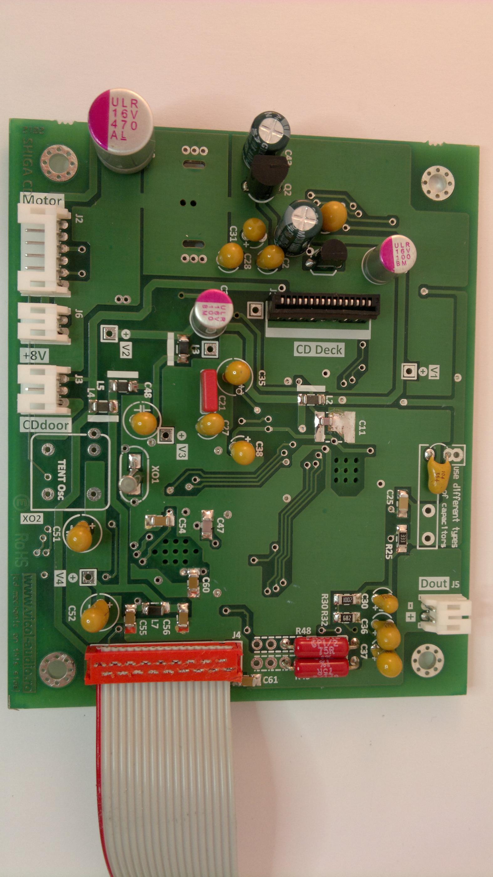

I have made few pictures of a finished ready mounted and tested kit.
Please use them as comparition.
Please also note the lased is not visible with direct eye. See movie Ready mounted and tested Shiga kit - YouTube

Hi Blueworm,
Before further tests, could you please check your solderings.
tibi
HI Tibi, I've just inspected all solder joints with a magnifing glass and all seem ok. The laser can be seen in the camera if you get it a little closer. Bad news, I broke a leg off Q1 (2SA608NF). Any Chance I can buy a replacement from you? as they are very hard to find, or can you suggest a replacement. My trouble shooting is now on hold until this is replaced. Thank you for your help so far.
If I where in you place , I will do solder again the legs of the 2 IC LA and LC and all resistors and capacitor on that board , regardless they look ok on a looking glass.
And i say that after many years of servicing SMD boards ....
Ok I can re-flow the passives but I really dont want to apply more heat than neccessary to the IC's.
I'll probe IC's to nearest pad or via.

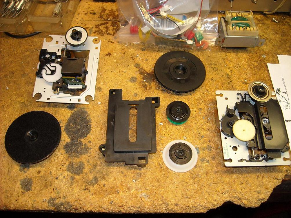

I tore apart a couple of CD-rom drives, and two junk boom boxes (one free the other $5 ad a thrift store).
Here is a pix of the pucks. The CD-Rom drives all used small diameter pucks with magnets that measured less than 1cm in diameter. Despite the size, they were quite strong and able to lift the counterpart from as much as 1cm distance. Regrettably, the shaft diameter on teh CD-Rom drives is larger than the diameter on our transports so the complete puck assembly will not transfer.
The boom boxes used much larger pucks. One boombox used a 15 pin version of the transport which is almost identical to the one we are using. It is so close, I am able to use the puck (leftmost in pix) and the plastic laser shield from it's transport on the transport I got with my complete kit.
This chuck has a pad on the bottom to help prevent the CD from slipping.
The boom box also provided several connectors, a split bobbin shielded power transformer, rubber shock mounts for the transport and other useful components.
