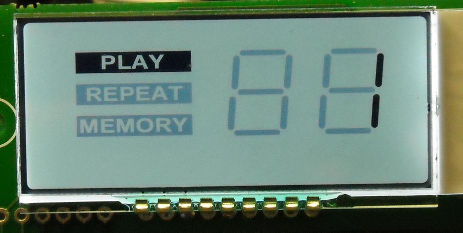

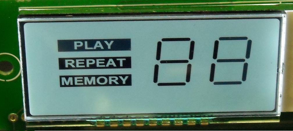

On a slightly more technical note, is there any way to adjust the contrast of the LCD display.
The first image is taken perpendicular to the screen, the second off at about a 15 degree angle.
When looking directly at the screen, the segments which are not active are still quite visible. It does not take being very far off perpendicular to the screen for the image to lose contrast completely.
The datasheet is not very helpful here.
Thanks.

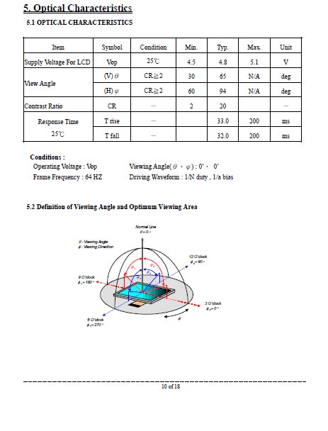

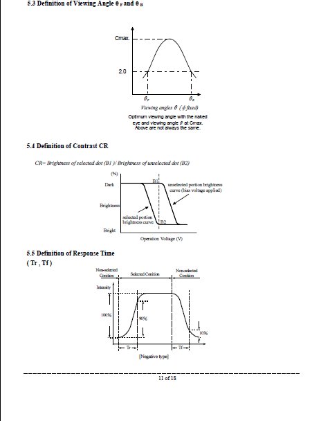

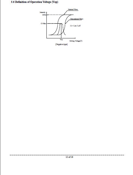

Steven,
Have attached few more screen shots from LCD datasheet.
As you can see from the first image, the operating voltage is between 4,5 and 5,1 V. That means we are running the LCD near to maximum. This is one reason for saturation. Yes, I know it´s my fault and it may considered as a design flaw.
The workaround:
- you may adjust the contrast by placing a resistor at LC78601 pin 40.Use a value between 500ohm and 2K2 or a pot.
- you may adjust the backlight by placing a 500ohm pot in P1 position.
Tibi

Thank you for the information on the LCD.
Cut trace carrying V4 to Pin 40 (at pin 40). Insert a resistor (or 500R plus 2K pot in series) from V4 to Pin 40.
Because the resistor is in series with the voltage source it drops the voltage. Best to insure the bypass cap is located on the pin 40 side of the resistor.
Tibi,
That works great. Even in the third shot at over 45degrees it is still better than it was.
It actually looks best slightly off center.
Top image straight on.
Middle image at about a15 degree angle.
Bottom image at about a 45 degree angle.
I'll measure the value tomorrow and post it. I need to take it back to the solder station to fix it properly.

Tibi,
This LCD was designed in mind with a film filter in front by the color the user want (hence the white color for backlight) , but this little mod is the way to to be done for all Shiga 2012 from Vicol audio , in fact is the only way to set the contrast to the LCD.
@ The Gimp : best is to measure pot+resistor value and replace with a smd resistor on board , but I think you already intended to do so.
Best regards.
Yes danzup, thanks.
I changed it to a 1.3K smd resistor today with a 0.1uF cap from pin 40 to pin 39 (gnd), and will retest tonight.
I will also use the pot in my other board when I have it finished (waiting on parts ) and see if I get about the same value.
Fortunately there is a via close to the pad and it is a simple fix to cut the trace from via to pad and insert a 0603 resistor (0805 works but is large).

I just tried a piece of red filter material both with the original setting and with the 1.3K resistor added.
The 1.3K resistor is necessary, as the filter does not help enough with the contrast to get by without the resistor.

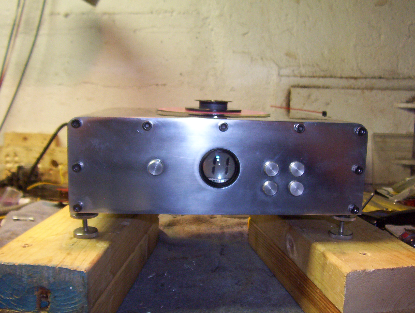

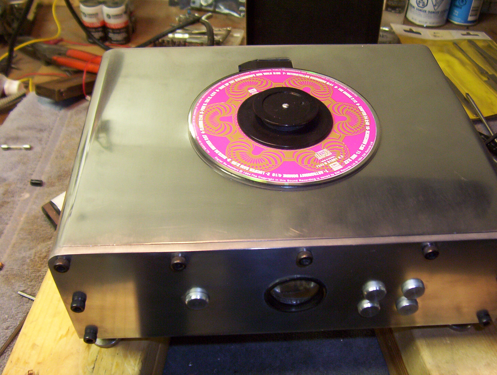

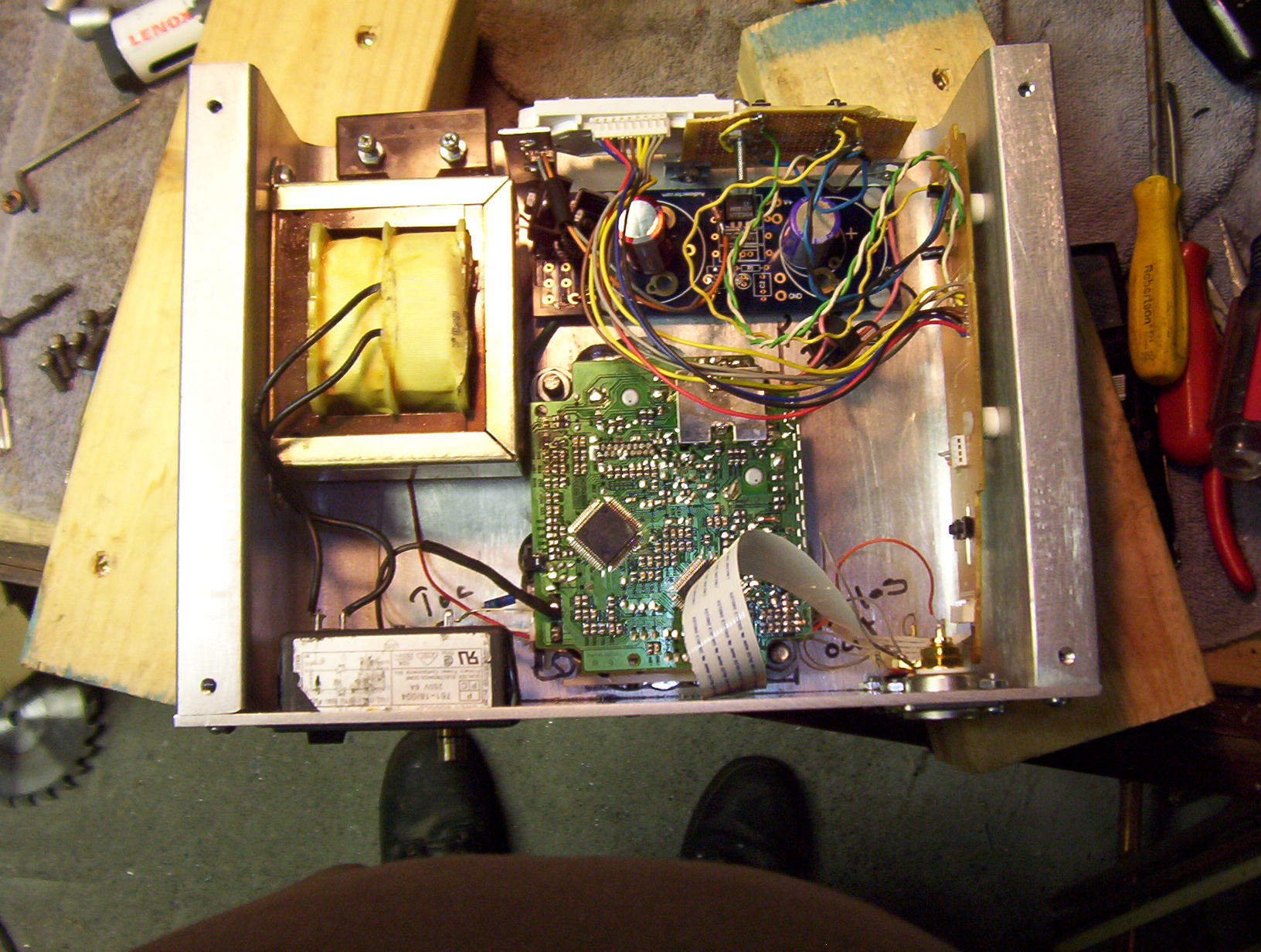

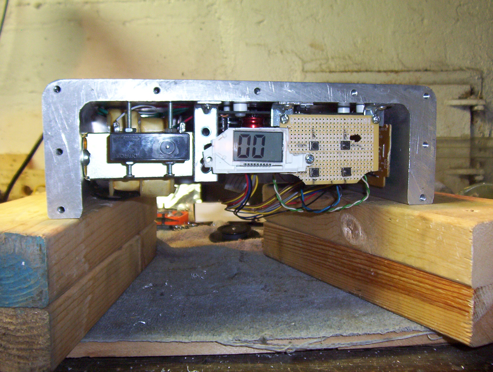

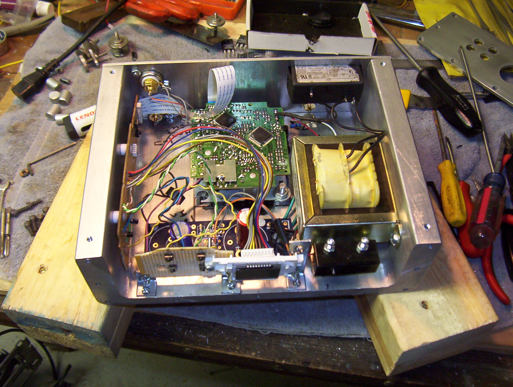

Finally got my Shiga boxed up. Used Starget and Oscon combo for the caps. I went with the minimal upgrades to keep things simple. Case is made from some 3/4 inch aluminum channel. The feet are temporary until I can find something that looks better.
Thanks Gimp. I have three more chunks to make a matching set. One for preamp and two for monoblocks. I did all the machining the hard way, by hand. The cutout for the cd mechanism was done with a hole saw, a hacksaw and hand files. Then I recessed the bottom by drilling a hundred holes and using a drill press with a 3/4 inch milling bit. I clamped the chunk to the table and cleaned out one spot at a time. Tedious but it worked great. The finish was done by belt sanding with 120 grit and then using a palm sander with decreasing grits up to 600. I finally wet sanded using 1000 and then 1500 and then polished with mothers mag wheel compound. It is almost mirror finish in person but I thing there would be another couple of hours of 1500 grit or higher wet sanding to get it there. The buttons were made from 1/2 inch aluminum dowel that I cut to length and then put in the drill press and dropped lightly onto emery cloth to get a nice finish on the end. The results are fairly stunning but fingerprints are a huge problem. ( :
dillmeister,
Do you think you have enough heatsink. Man.
How much does the case weigh? It look like about 20 pounds.
Seriously, its beautiful and I am also impressed with all of the hand work. Keep going.
Nice Chassis Work!
dillmeister,
Nice work! This is impressive doing this mostly by hand. Post pictures as you modify this!
