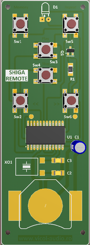

This is how the remote may look.
A single side PCB with all components on the copper side.
Tibi
