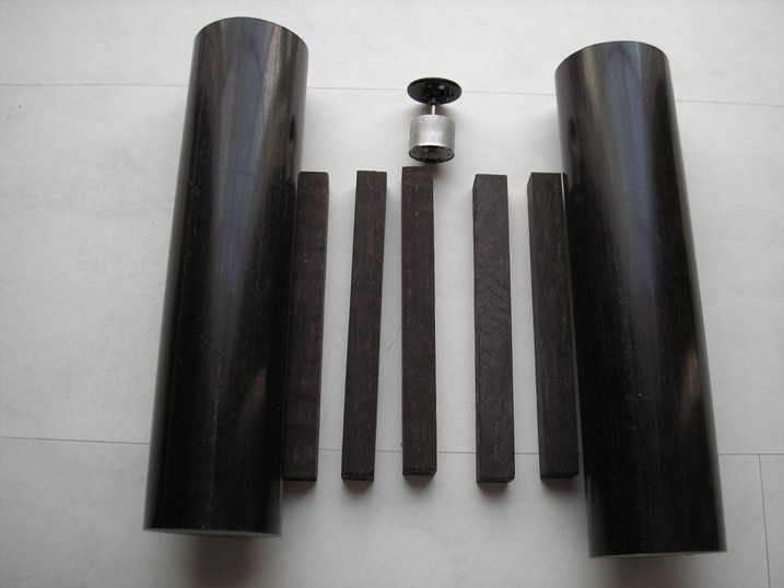

First, create or buy a round long rod of Delrin 6cm diameter and drill a hole exactly in the middle.
Create the delrin so thick that he not go skidding on the CD.
Forget the magnet that sounds not good, listen to classical music then you know what I mean.

Hi Rudy,
Many thanks for your suggestion. I agree with you, any magnet puck will affect focus and tracking performance when paying fist ~5-6 min.
I wonder where I'll get Delrin in Romania.
Till we finish our first magnetic puck, I'll stay open to any CD puck project, which is reproductible, easy to make, use cheap materials and is magnetless.
Tibi

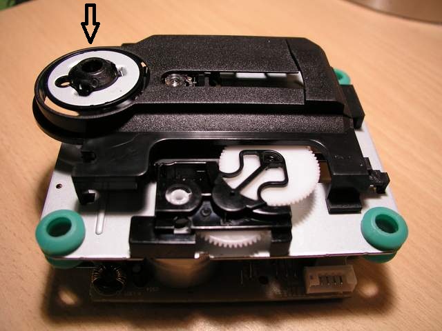

You can create the same form on the lathe as of the original puck.
You see on the picture that there is a hole in the CD Platform.
There than the puck be placed in the hole.
That's more stable also the shiga is placed in horizontale position.
Rudy
Rudy

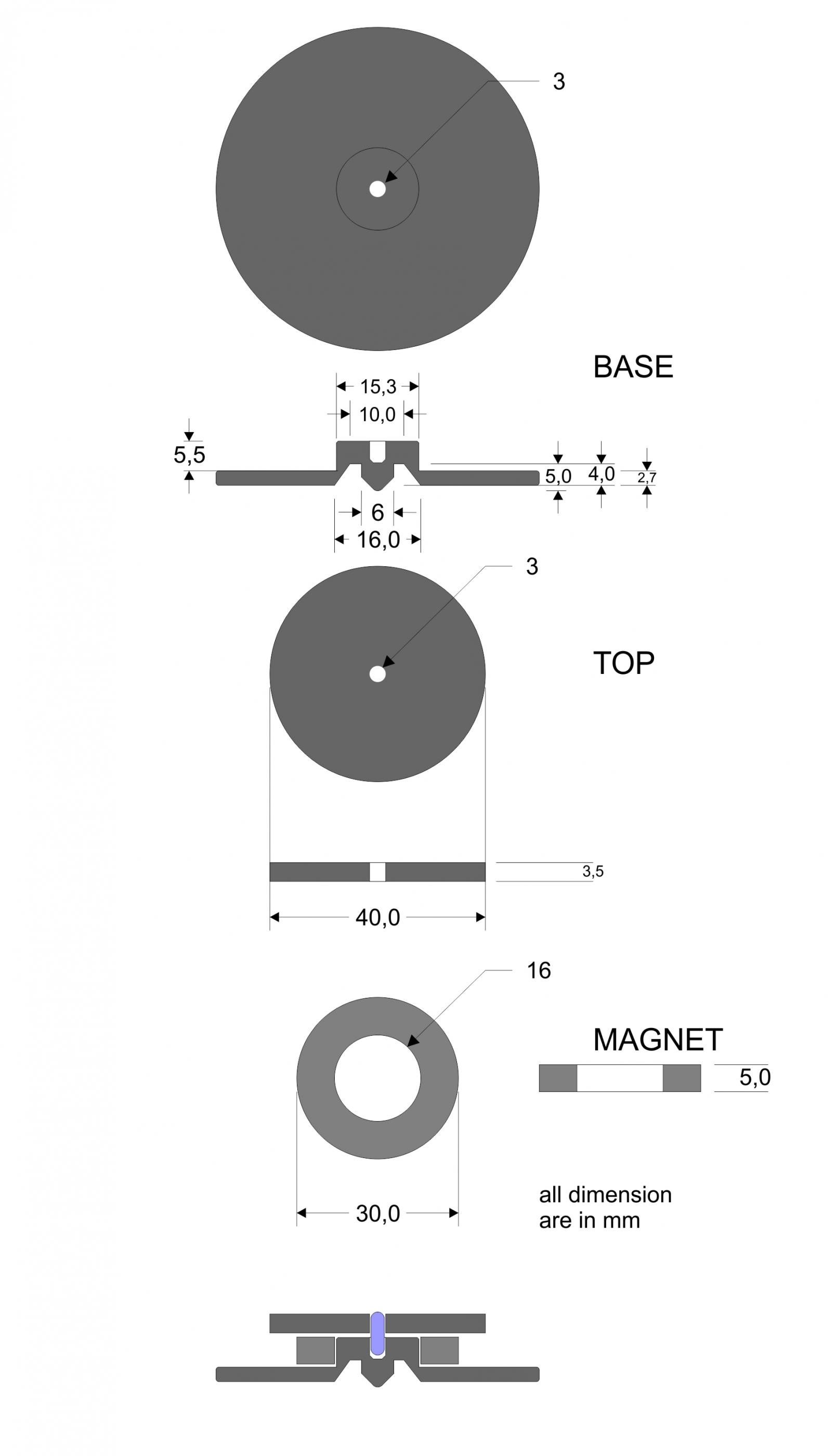

Someone requested me to measure original JVC puck. His message was trough forum pm and I lost his name. However, here is a drawing which could be used to make such puck.
Tibi

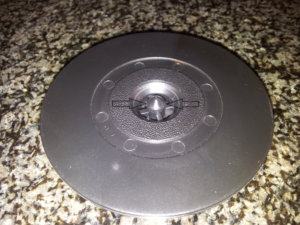

Interesting pictures. Thank you. I can't wait to see the mechanic in person.
Do I understand correctly that someone has threaded the center hole and uses a puck that screws into the mechanic? When not turned on, doesn't the motor spin easily? I guess that means they use the friction of the CD on the mechanic to hold the base while screwing in the puck.
That's probably me, and no, it works fine, although not quite as easy as just dropping the puck on.
