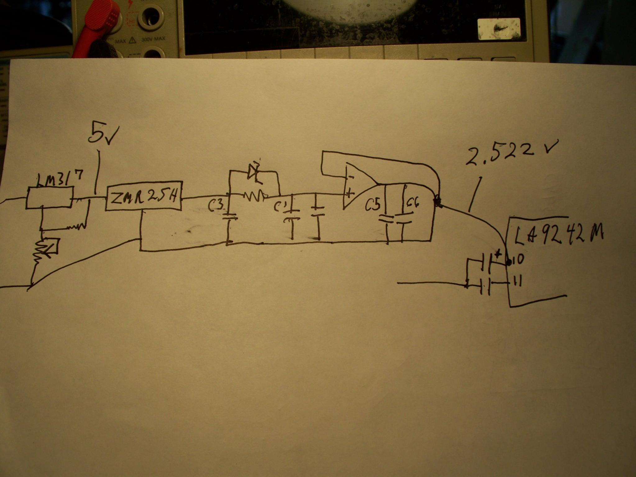

Thanks for explaining. ZAR25H is a 2.5V regulator right
Is possible to use LM336-2.5 as regulator or Vref?
What is the value of the zener shown in your schematics?

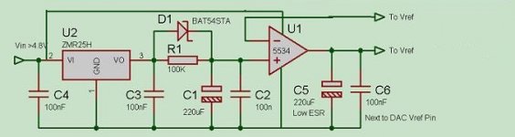

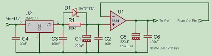

Hi Dr.H,
There seems to be a typo in the RCEZ31 document. There are 2 C906, one with 330P and the other one is 0.1U. So the the From Vref and To Vref should connect to the C906;s positive leg which is connected directly to the pin 10 (TH) of the IC901 LA9242M. Is it correct?

Hi Syklab, those schematics look correct and the right C906 is the electrolytic one

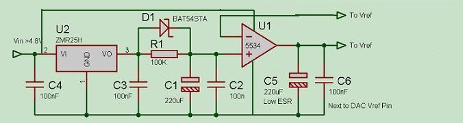

so Is this the one being used?
Is this the vref being used in the shing a clone,
How are you adjusting it with a LM317?
Is the drawn schematic not the right location to pin 10 or 906 .1 cap
and vref in and out connect to the same place + 906 .1 cap? ,
where is the best place to supply the vref from?

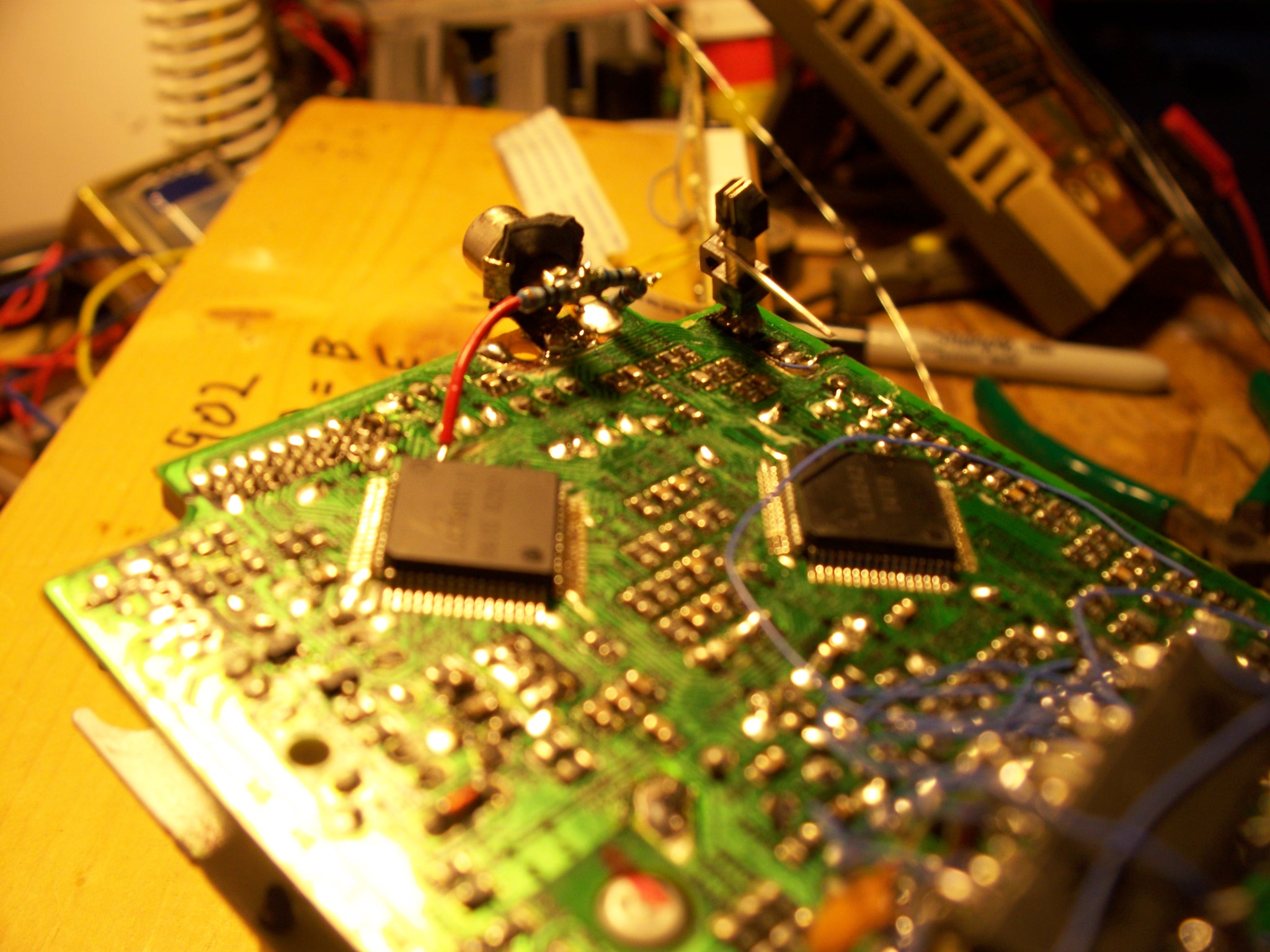

help, broke cd door trace
hmm, I broke the CD door close trace on the board. 🙁
I removed the little connector and tried soldering up the wires directly to the board (I lost the cable with plug)...
Any suggestions?

you need to get a switch
hi,
Get a regular switch(on/off )ON is normal and 2 wires and solder it on the traces,just turn it off and back to on and your in business!
I hooked up a switch directly to the board, picture enclosed,a cherry or any small switch will work.

I've got a no/nc switch that I was going to use with the shigaclone.
But one of the pinhole traces fell off when I tried soldering up a wire to it.
I might be able to follow the trace a bit further down, or exposing part of the trace, but I'm worried I might really mess it up.

I do have the manual. Ok, that's the trace (pin hole trace) that I broke off the board.
I might be able to use some thin (wire wrap) to attach to the trace.
Any other suggestions?

This picture may be clearer where to add 5V, (point 5A). The switch is only needed if you wish to compare between original supply and a new, separate 5V supply.
I read from Peter that the 5V can be added by tap into the L901 after removing it.
Peter,
After you removed the choke L901, do you have to put 2 jumper wire there to reconnect the trace line?
