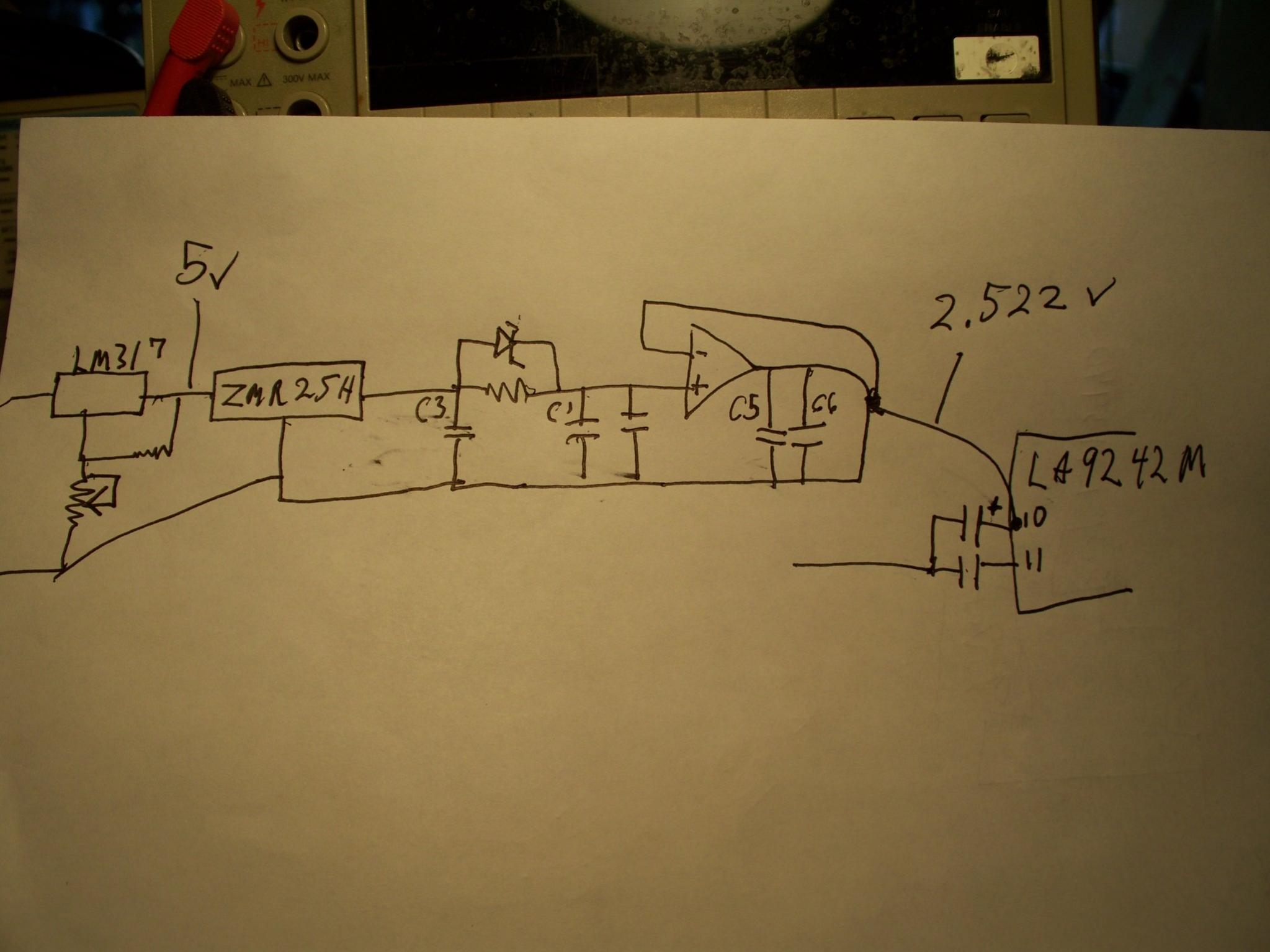

Hi syklab, the connection does not replace C906, but is attached to it. I'll try to remove C906 and see if that brings further benefit.
NO. The "TO VREF" reg connects to the positive leg and the "FROM VREF" connects to the positive leg. The reg is based on a feedback loop.
Type of cap-JohnW gives specific guidance on the caps required-he suggests a low imedance cap on the output of the reg and a good quality decoupling cap close to the load (probably a ceramic).
One last thing: Make sure that the reg Vout is as close in value to the voltage on C906. I used an LM317 with a potentiometer to set it at 2.522V
Then it connects at the same point ? IT doesn't go inline?
I was thinking to open that line and insert?
So
To be clear: "TO VREF" and "FROM VREF " are connected to exactly the SAME point. The regulator supplies AND monitors the VREF and this contributes to its stability

NOT to the 9242 chip!
The reg VREF goes to the 6541 chip or to the C906 cap.
Also note that the feedback from the 2.5 pt being supplied should be taken from the same pt. This means that the output of the opamp (pin 6) is connected to the pos leg of C906. The same leg is connected to the - input of the op-amp.
Please check and repost the correct schematic; a dead shigaclone cannot be brought to life. Be careful.
According to the schematic for the RC-EZ31, there is no 6541 chip, the IC901 is a CSC1469XH and the C906 is a 330P non-polar cap. I am really confuse now.

Syklab, are you sure you're looking at the correct circuit? Have a look at one of my posts about 6 weeks ago- I mentioned the different IC's involved. You have the RCEZ31 schematic?
Hope this is the right one.
Hi Dr.H,
There seems to be a typo in the RCEZ31 document. There are 2 C906, one with 330P and the other one is 0.1U. So the the From Vref and To Vref should connect to the C906;s positive leg which is connected directly to the pin 10 (TH) of the IC901 LA9242M. Is it correct?
