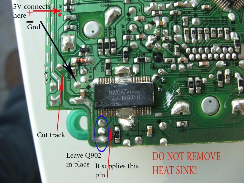

hello all,
first, Peter Daniel, thank you very much for starting this thread. I have fun a lot.
In this trhead on page 128, #1273, Slawney make a few statements, he wrote " One word of caution to those pursuing a
multiple reg approach, however, the timing of the start up of different regs must be properly adjusted to avoid latch up because of an absent clock signal or such. Sympton will be no toc or a servo spinning out of control upon start up."
So, is there anybody that can explain whats this mean, and how to solve this problem?

Latch-up in a chip basically means that it "freezes" in a certain state, waiting for a signal input that never came.
If all the chips do not receive the +5V AT THE SAME TIME, some chips could be on and end up waiting/freezing for an input while others are still turning on.
This could permanently damage the transport.
And the solution is simple: Feed the chips off the same 5V reg.

Yes, it is possible ti use separate regulators and if you connect them as in a picture here: http://www.diyaudio.com/forums/atta...ble-cd-transport-shigaclone-story-track5v.jpg everything should work fine.

It makes lots of sense to feed the driver and digital chips with separate regs
as the motor drivers inject loads of noise back towards the DSPs.
The only way this baby can latch up, is if there is no clock present.
eg: 8v supply to driver chip (supplying 4 motors,Focus,Tracking,Spindle and Sled) And 5V supplying the digital side.
The driver chip as most of you know, has an on chip 5V reg which supplies the whole board. YUK!

FWIW, I am using a separate 8V supply and 5V supply (ALW reg) connected as suggested by Peter's recent pic
http://www.diyaudio.com/forums/attac...ry-track5v.jpg
Sounds cleaner than simply using just the 8V supply.
I guess the question remains as to whether there is a sonic benefit in splitting the 5V supply even further and giving each DSP chip that needs 5V a seperate 5V reg. Possibly the benefit will be minimal.

Hello
Peter Daniel, Hotiron, Dr, H, The picture have I see before. I'am some careful, because I have 2 jvc pcb destroyed, You know,
connect and disconnect, solder and desolder, tracks release from the bord, some can repair with a wire jumper, but not all the mistakes. Still I have some confusion about transistor Q902.
I have read some let him stay, some delete. I believe delete Q902,
because the 5v reg in the driver chip is not a good one. But what to do wiht the reg output if I delete Q902?
