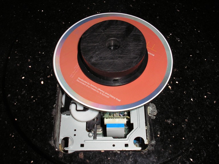

It is strange he does it with multiple CDs and CDs are scratch free, including the CDs not wobble on the cd platform.
It is difficult to get right in to on the inside because the ribbon cable is very short, I wait until my CD platform with puck is ready, I had hoped for a simple solution😉

If I skip the cd to the next song is going well until I passed number 5 then turns the cd much too fast and then goose the laser to the outer side.

Now I must open my CD Transport earlier, because the laser does not read any CDs anymore 😕
Rudy
Hi Rudy,
Did this happen suddenly or as a result of a modification/change/repair etc., I guess you probably did check the laser switch as well ???
Try to remember the last time you touched it and what you did...even when I am still busy with a second one at the moment I still do one (small) thing at the time to try to stay in control of it...
Hi Erik,
I have nothing changed to this CD transport, I have the last few days regularly problems sometimes it seems that the CD Transport goes in the mute on the CD tracks, the last tracks of the cd he can't read and the CD quickly rotate.
I have the transport now open and I will take another CD unit, where the laser switch already in is confirmed.
Rudy
Rudy
I forgot to mention, 1 time during switching on the CD transport I experienced that the led lights blinked for a few seconds.
I hope that this has nothing to do with 1 softstart circuit for 3 transformers? (Trichord clock; 5 volt CD board; 8 volt for 2 cd motor.

The CD transport plays again as it should be, I'm a happy man
I have now placed a new unit.
