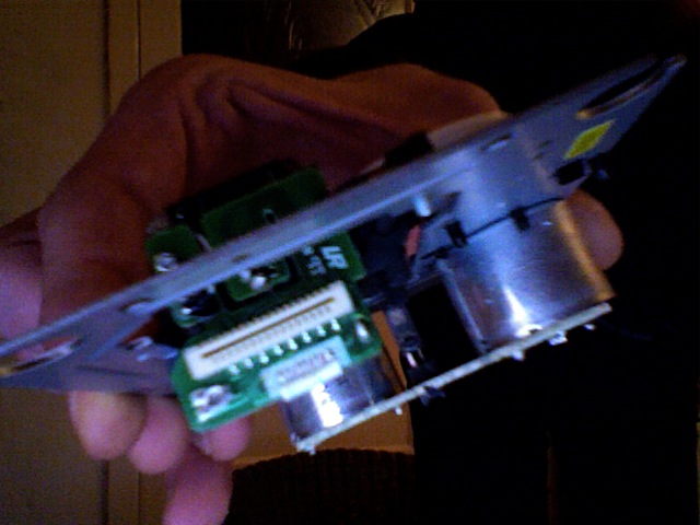

Hello Kevin & Fran,
Thanks for your suggestions, I will look into them. The stop switch comes from a replacement mechanism. These replacements come with a small pcb containing the switch and the connections to the motor. Strangely enough, while the mechanism looks exactly the same and uses the same ribbon (same number of strands) as the original, when I connected it, it would not read the TOC on any cd, it would just spin up.
In the end I just desoldered this small PCB and mounted it to my old transport. I guess both the height of the platter and the switch could be to blame, but the switch is the most probable culprit (stupidly, I do not remember if I ended up using the old motor or the new one. Note to self: make notes.).
Has anybody else had problems with replacement mechanisms?

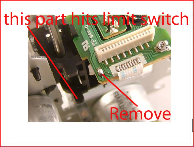

No, whats going there, is that there is a little blob of solder on that PCB for static protection. You have to wick that off for the new mechanism to work.
Also, the stop switch I mean is mounted on the bottom board and there is a part of the sled that hits off it to limit travel. Have a look at the bottom board again and gently push the sled towards the main motor. You should see where the sled hits this switch. I'll have a search around for a pic of the solder blob.
Fran

The new mechanism comes with this stop. I desoldered the one on the bottom board, and used some spare wires with both connectors from the boom-box to make a small detachable wiring loom connecting the motors and the switch that are part of the replacement mechanism to the main board.
I guess the solder blob is somewhere on the laser sled? If I can just connect the whole replacement mechanism, I would not have to check for tolerances on the switch and platter height. I'll rummage through the parts collection and have a look.

See this pic - thats the blob you need to remove on the replacement mechanisms.

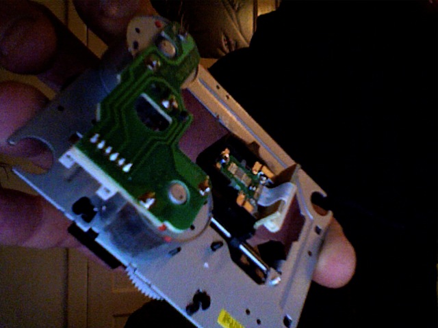

I thought a few pictures might be good. I had to take them with the webcam, and they are kind of dark, but they'' maybe clarify things.
First off, the mechanism with its own small pcb for motors and end-switch.
Second: is the solder blob to the right below the ribbon connector the blob you mean?
Jeroen
PS: the extra mechanism has as part no.: SF-P101N 16 Pin.
