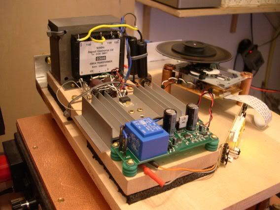

Hi nosmoking, I've done the following:
300/100R spdif mod
1. Mains filter
2. Removed choke, C916 and C952 and bypass caps
3. C916 replaced by a OSCON 47uF, 25V cap
4. 300/100 on digital output to 75R BNC connector
5. LM317 based 8V supply with around 2200uF pre and post regulator filtration
6. It is "naked" and sits on a bit of bubble wrap at the moment. No fancy mech isolation etc.
7. Supply 5V off ALW reg
I want to try:
SPDIF attenuator
300VA transformer
Snubbers on power supply diodes
Low resistance Inductors to replace wire links
Tantalum caps to replace some electrolytics (those for PS decoupling)
Possibly a second ALW reg dedicated to one of the chips

Some observations, more questions
Hi guys,
have looked at the data sheets for the chips used in the shigaclone and a few things pop out:
1. 78601e, the dsp that generates the reference clock, amongst many other things, has THREE separate 5V pins (p6=internal vco supply, p22=digital system power supply and p62 crystal oscillator power supply). The data sheet emphasises that the three pins must be at the same voltage (say 5V) or the chip will latch-up. this is decoupled by c934, 935 and after a 100R resistor by c953 nad 960.
2. As things stand at the moment, this same supply is connected to pin64 (RF system VCC) of 9242, the RF amplifier, amongst other things. There is also a pin56 VCC (servo system and digital system power).
I'd say that there would probably be some merit in supplying some of these pins (for example RF and internal VCO) from a seperate clean supply.
Also, any views out there on VREF at pin58 and the bypass cap at p57? currently, c930 and C928 decouples it. May be worth placing a good quality decoupling cap here (oscon etc).

something else to add is that the chip la6541 has an internal 5V regulator that generates the 5V for the other chips on board
Today I found some time to implement the Trichord 4 with (this time) its own Never Connected Power Supply.
This was also a good moment to have a spare transport up and running.
I made on the mini-PiTbull the supply while using the clock on the spare...
All went as smooth as could be and was working (only showing 5PPM on the Lens....before 189PPM) fine as expected.
So after that taking the original apart....... and....... PLAYING-TIME....😀
