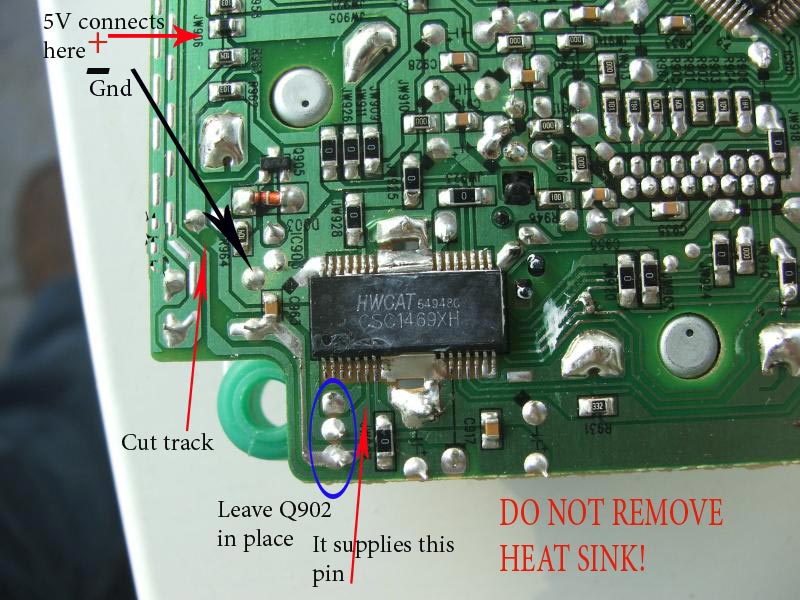

can someone tell me what chip IC 903 is ?
I have that number but schematic doesn't tell me anymore and alot of links in the first part of this thread are gone, I fried this chip and found out metal shavings ,microsize had found thier way to the magnet in the lazer,must have caused it to bind and locked it in place, I file sometimes on my bench so I figured that's where they came from,,,,Any way I need a controller board,or that chip,ANY suggestions,I found some jvc rc31 boxes but they won't ship to usa from canada, THANKS ALOT!

It is LA6541. All those chips are really hard to find.Hi,

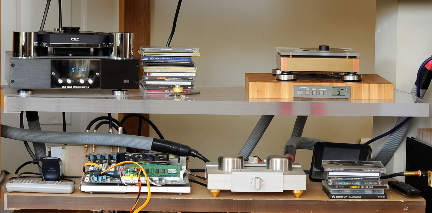

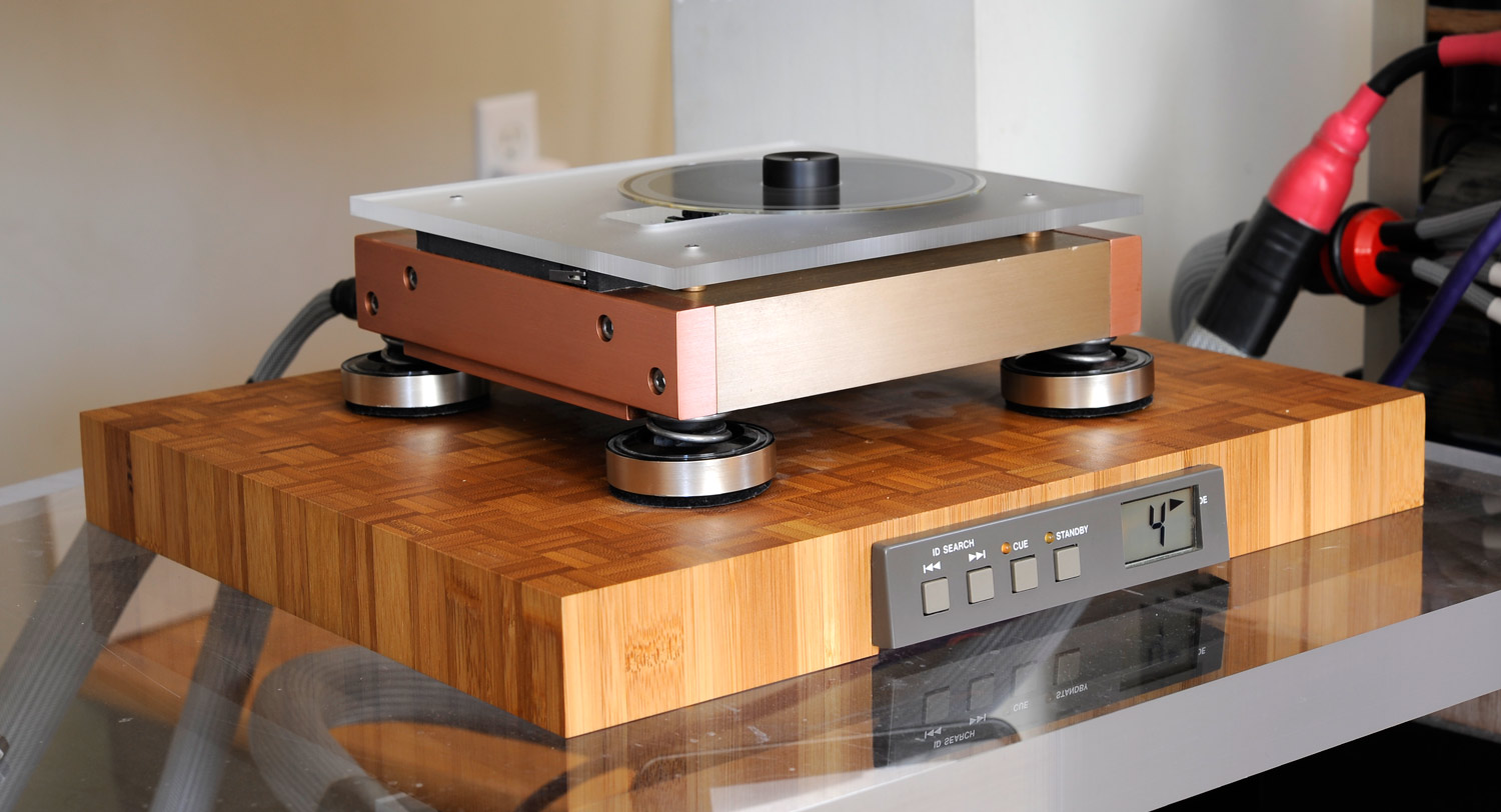

On the 2 latest pics you show a standard spindle against a Delrin with an Ebony Fran Puck.....do you use the latter as your own transport nowadays to judge mods or is it just an older photo...
A pity (for me😀) that you did a few mods in one go but I do hope that if you are in a situation to hear the original cap 906 against the V-cap that you are willing to post your findings....😉

hi would some post or point me to a detailed manual for rcez31! Just need controler board,
Thanks for the chip number PD

In my reference Shiga transport I had always Delrin disk table, it's just that I didn't use that chassis recently and just put it back into use last week. So yes, that's what I'm using now for listening.

Link to manual was posted here: http://www.diyaudio.com/forums/digi...transport-shigaclone-story-4.html#post1471494
Got a 404 error here
