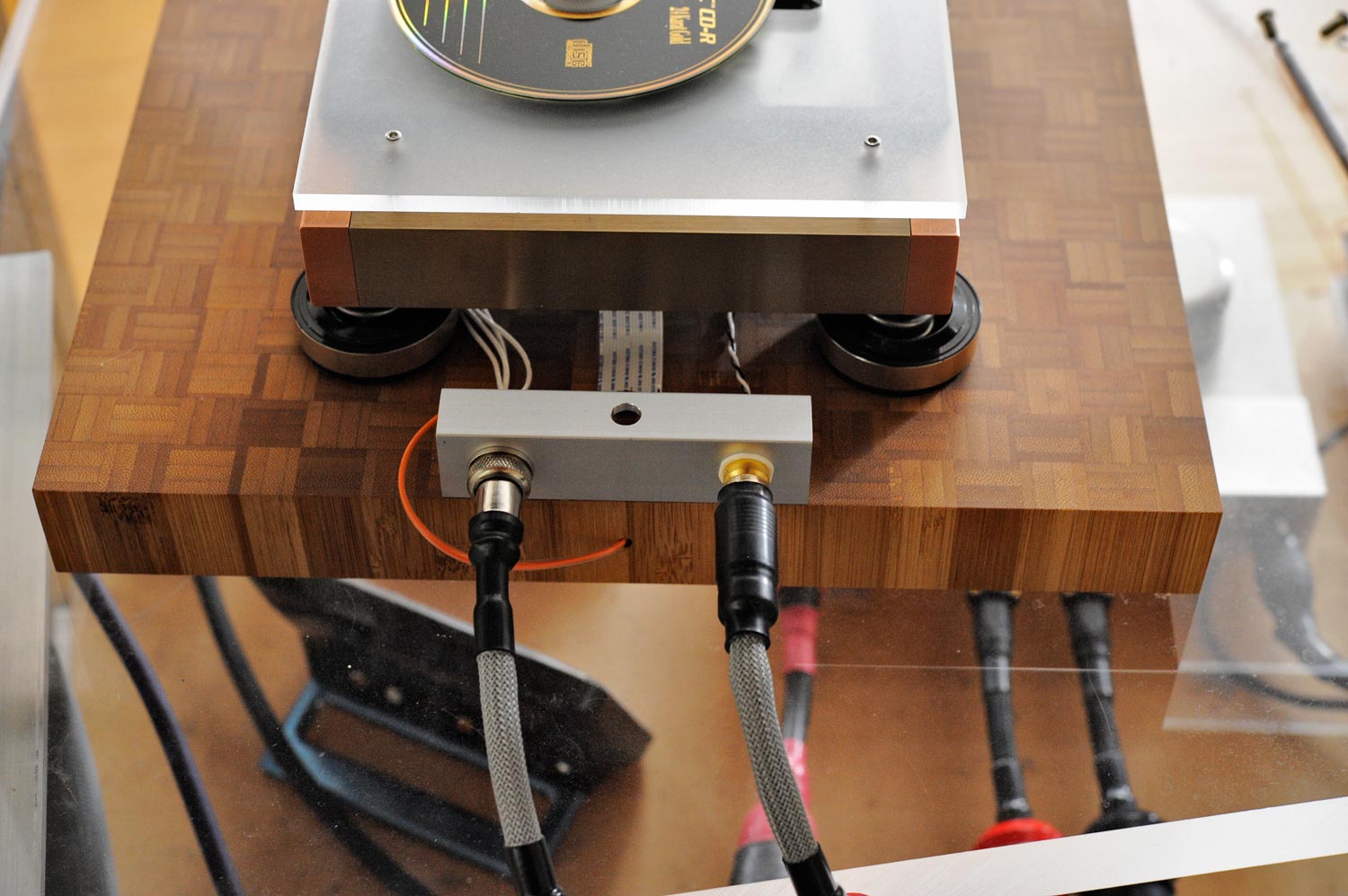

There is also a thin clear plastic membane in front of the display which has one black wire going to LED-.
Whats this wire for?

Because of the way the display is integrated into wooden platform, I did it with a set of single wires: Finally, an affordable CD Transport: the Shigaclone story - Page 23 - diyAudio

it was mentioned somewhere that it is for ESD protection. i removed it.

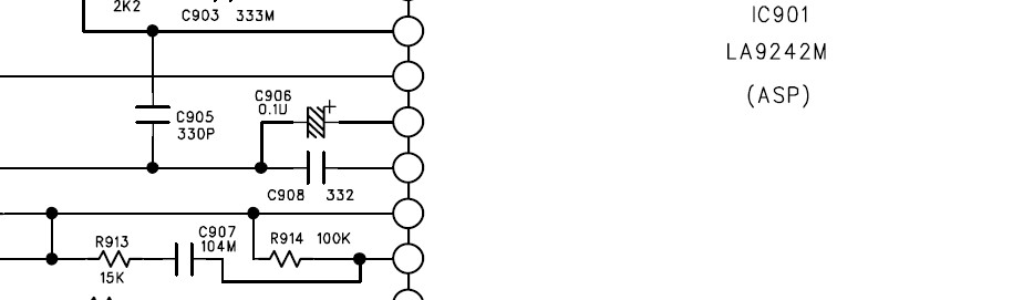

I was actually meaning to post the results of my capacitor tests, but somehow never got round to it... hope they will be useful to someone:
C906
This capacitor (the original C906) should be labelled: “Here be Shigaclone magic”. It is insanely difficult to find anything that could even come close to it.
I first tried substituting it with a 0.1uF Black Gate NX Hi-Q (as we all know, possibly be the best electrolytic capacitor ever made), and while I liked its natural, relaxed tonality, there was no question that it had less of the original C906 “magic”- this ability to tell you who’s playing where and capture those minute reverberations and “live performance” feel.
I also tried a few film capacitors in 0.01uF value, as suggested by some in the original (Polish) Shigaclone thread - none of them worked well though. Even Vishay MKP-1837, a decent film cap by any standards, fell a long way short of the original C906 electrolytic, giving a flat, un-engaging sonic presentation.
The only cap that came close, and even surpassed the original in some ways was a 0.01uF/400V Multicap RTX. It actually gave slightly more resolution, although the presentation was a bit “in your face”, and it didn’t sound all that natural to me either, so I reverted to the original C906, and that’s what I’m still using.

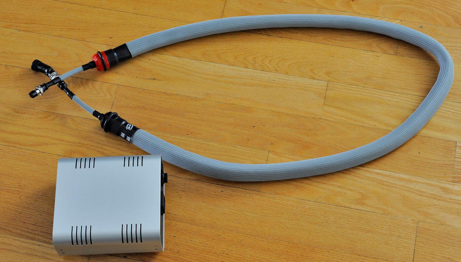

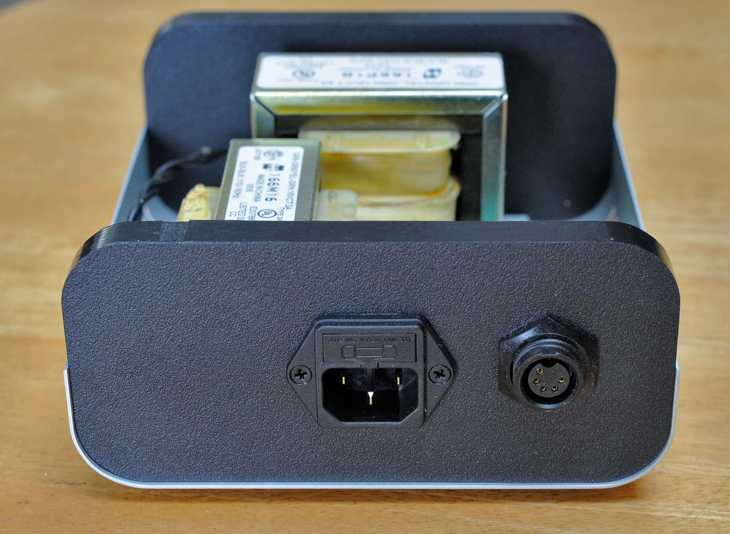

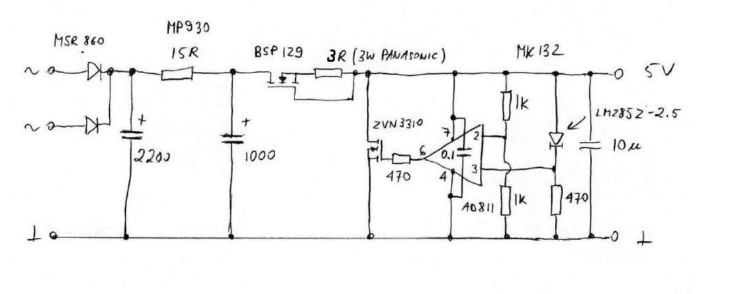

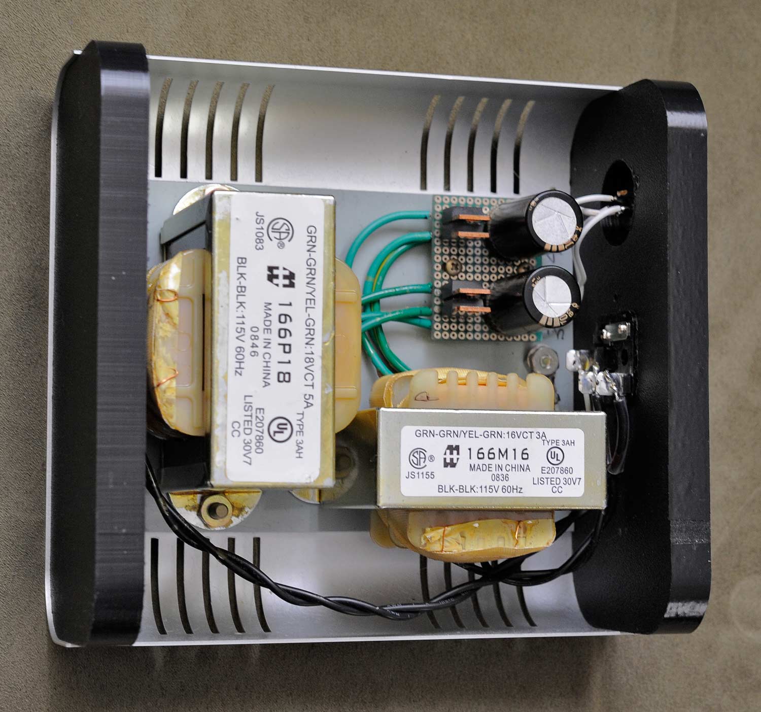

Both the regulator and external PS was taken from my recent DAC upgrade.
The external PS consists of two Hammond transformers (smaller for 5V, the bigger for motors). Both transformers are CT with 2 x MSR860 and BG FK 2200/35 per circuit.
I also use custom built umbilical cable. That cable has similar effect as interconnects, and the better it's made, the more it enhances the 'sound' of the the supply.
The shunt type regulator was developed by Bobken, specifically for TDA1543 DAC, however, it should work well with other digital circuits.

Hi Peter,
so do i understand you right, that you use in the latest nonos-DAC Version
external PSU?
Could you shortly tell us whats so special with your umbilical custom cable?
Greetings Ulf
external PSU?
Greetings Ulf
Yes, I use external PS now for a DAC. The umbilical cable is built like an analog interconnect cable: special wires, special cable geometry. It's not done by me, and the design is proprietary, it does improve the sound though. I get them from here: BLUEBERRY HILL AUDIO-Manufacturer of high-end cables

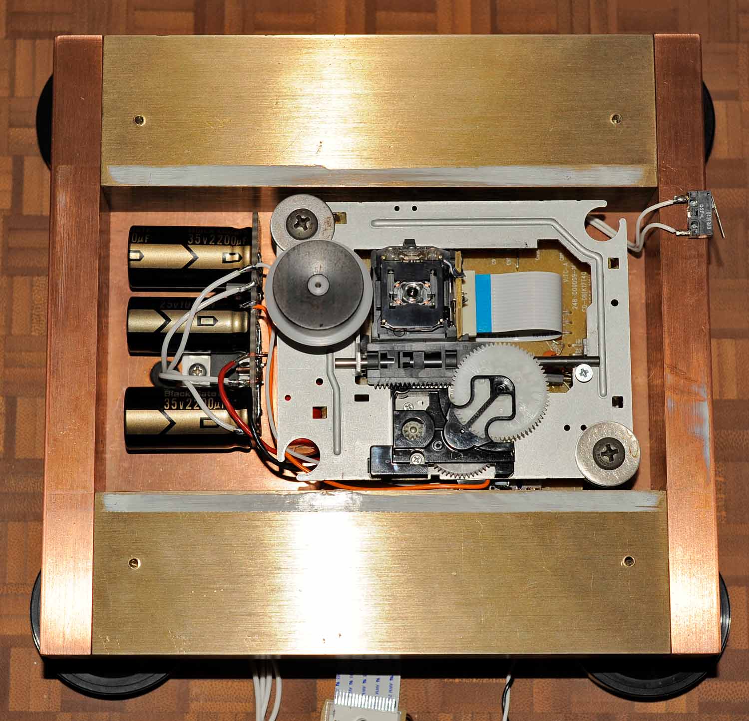

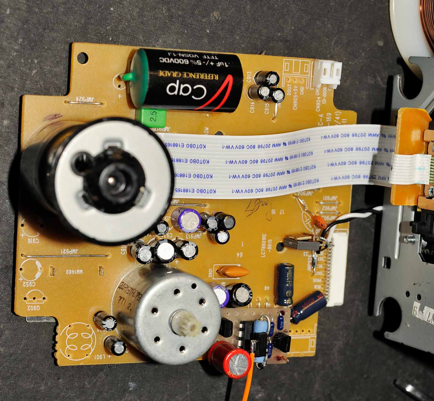

Previously, I had reservations with regards to some veiling when mods were done according to pdf prepared by Okapi.
However, recently I took this board again, and did few changes: C906 is replaced by 0.1/600 V-Cap TFTF, C908 by 3n3 Wima FKP2 and two electrolytics (C929 and C939) were replaced by 10uF and 15uF Oscons. Everything else exactly as in Okapi pdf. There is of course discreet 5V regulator and now everything seems to sound fine, very close to TL0. I will do more critical listening tests in a week or two, in other system.
The attached board pic is slightly different, as it does not show Okapi pdf file mods, which I'm still using presently. It shows new caps though and 5V regulator.

That's my present setup. I recently installed some foam material around the inside edges of copper/bronze frame to prevent dust collection from underneath the acrylic top. The TOC switch is elegantly installed on a side. The output cable (6ft Belkin Synapse) is soldered directly to resistor divider (300R Vishay/100R Caddock)
