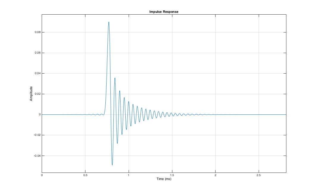

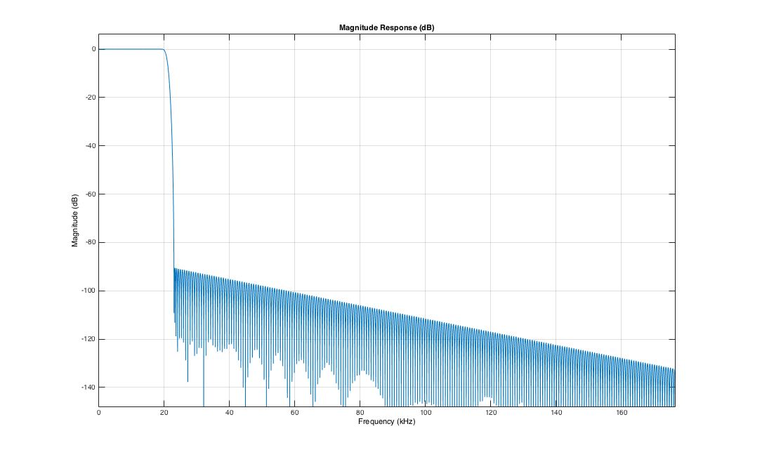

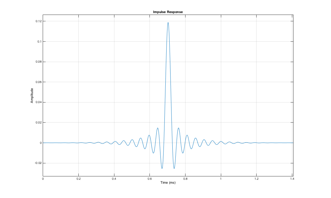

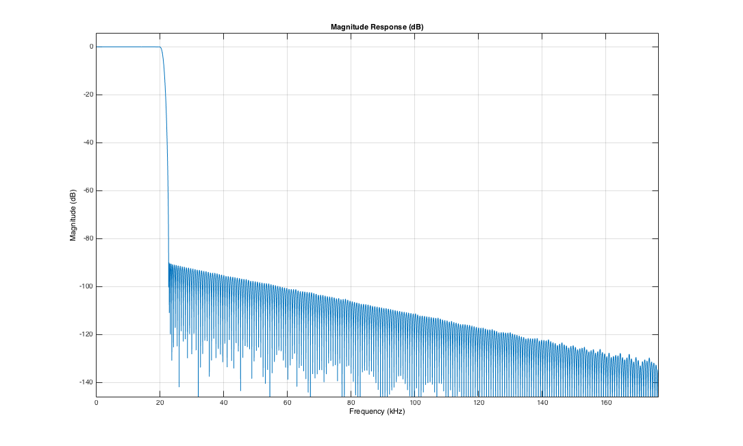

It finally clicked that I could apply the idea used in rePhase of blending linear and minimum phase filter to create a intermediate phase filter in MATLAB.
The method is to make two filters that fit within the constraints of 1016 taps. So 2 x 508 tap filters, or a filter order of 507.
Make the specification the same for both, and set the stop band attenuation to half what is required in the final filter.
Create linear and minimum phase versions of this filter
Convolve the two filters together.
It's a bit to do painful but provides a very usable result with no windowing.
Attached is an example...

Hardcore. What's a filter like this look like in the frequency domain and impulse response? You're good at making pretty graphs so thought I'd ask 🙂
Indeed...

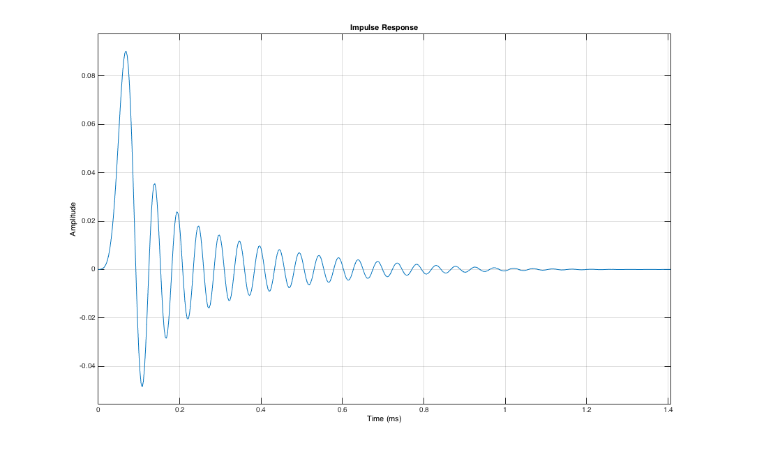

combined filter impulse:
combined frequency response:
Both of the "parent" filters have roll-off in the stop band. I could probably cut back on the attenuation slightly and get steeper roll-off but it's not too bad as is. There is a small step in the transition band response at -150dB. Izotope has a similar step so I'm not going to fret about it too much..

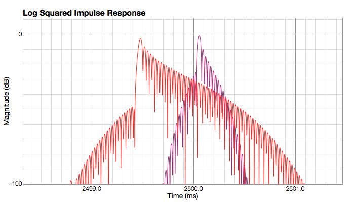

LSIR n017 vs SoX IP35

Base Minimum Phase filter response
Base Minimum Phase impulse
Thanks. Forgot to request phase shift too lol guess that's the most important with incorporating minimum phase filtering...
Importantly how's it sound to your ears?
Edit: oh and when you say "unwindowed" does that mean just rectangular window applied?
No windowing at all. These are not designed using a windowed sinc method. They are made with Remez/Parks McCelland algorithm which designs optimised filters using an approximation method.
Parks?McClellan filter design algorithm - Wikipedia, the free encyclopedia
I'm using the fdesign.lowpass function from MATLAB, with the equiripple design method.
Lowpass filter specification - MATLAB fdesign.lowpass - MathWorks Australia

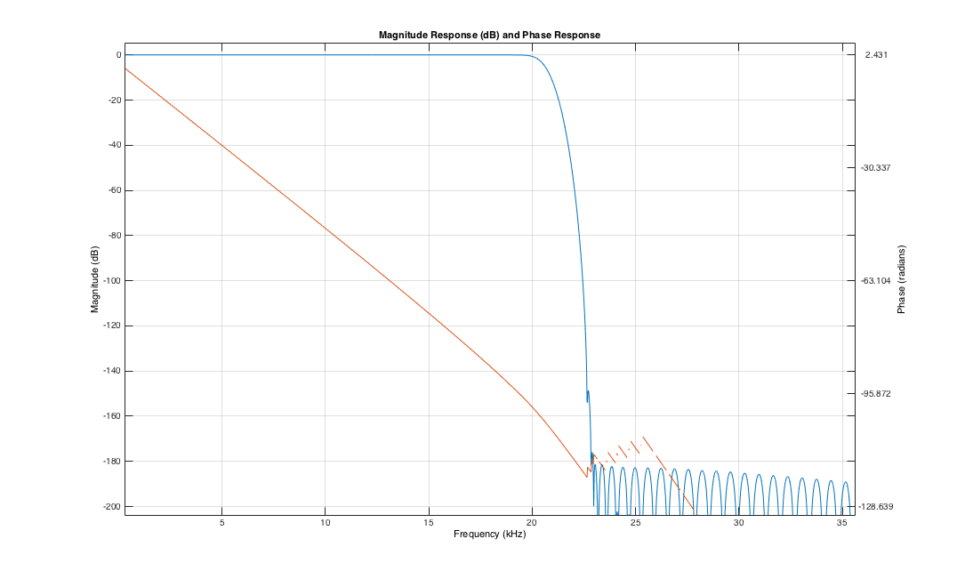

Phase/Response...

Thanks spzzzzkt. Font of knowledge as always.
Considering its an intermediate filter I was expecting a flat 0 phase shift for a region of the phase graph. Is this possible? I was reading in the Mod86 amp thread and someone there posted that humans can't really detect phase shifts > ~3 KHz. Is it possible to create filter with zero phase shift from DC to certain frequency and have min. phase from then on?
I would love to try and run some sims myself but don't have access to Matlab for a few weeks :/
Nvm, looking at your graph again I think you have actually achieved this and I'm talking out my a$$. Your phase response is linear to ~22 kHz! Duh!

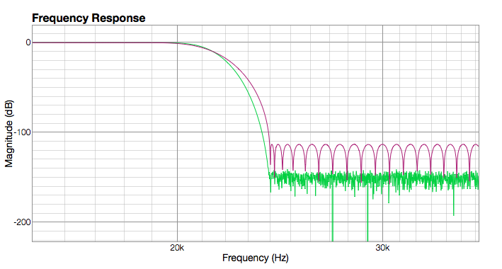

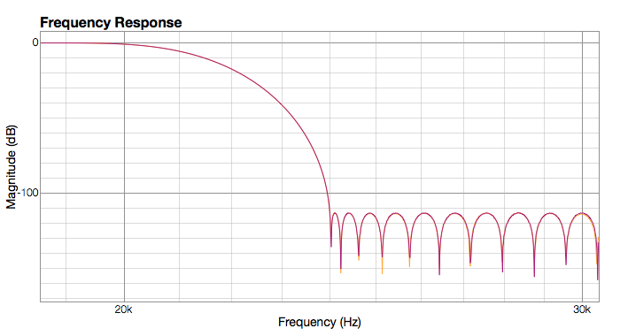

The 'kkkkatz gone mad...
You know your in trouble when you spend time trying to clone the default Soekris filter 😱
I think I did a pretty good job... Tap length came out the same and the passband and rolloff overlay perfectly. Stop band ripple is slightly different frequency. Oh well. The best thing is the clone sounds identical to the stock 44.1 filter. 😀
The orange trace is the original filter, the burgundy is the "klone" filter.
So not much difference...

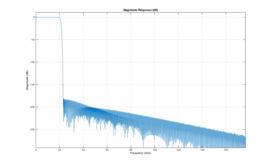

The reason I've done this is so I can test the theory that much of the harshness in the stock filter comes from the 113dB stop band attenuation. To do this I wanted to get a base filter which was as close as possible to the stock 44.1/48.1kHz.
From that starting point, with identical pass band and stop band frequencies to the original I could modify the passband ripple and stop band attenuation specs to something more alone the lines of the recent filters.
This has blown out the filter taps significantly, and the roll-off is now steeper, and more ringing etc...
The green trace is the HiAtt Klone.
The clone of the stock 44.1 filter is SK441_orig_klone.skr.
The high attenuation, reduced pass band ripple, version is SK441klone.skr
So this is mainly an "out of interest" filter to see how much difference the added attenuation makes. In theory if the harshness is related to imaging around nyquist the two filters should sound equally harsh.
One of my test tracks looses a harsh "spitty" edge to the sibilance on the vocals with the HiAtt Klone. I guess -0.4dB at 20kHz might make some difference...
The other thing that is the faint haze around instruments in the Stock filter is gone on the hi attenuation version, which improves the sense of space in the recording. Who says -113dB is below the threshold of audibility?
Yes, harshness was gone when you started producing high attenuation filters ☺
Yes, but that was done in combination with moving to close to nyquist full attenuation.
The issue with doing two things simultaneously is that its difficult to be clear about what influence each aspect is having. Just trying to clarify exactly what the variables are...
There are clear implications for what you do with the filters if for example your friend Mr. Pflaumer is correct in his claims that it is transition band distortion and imaging that creates mid-range harshness. It would be nice to actually test that theory methodically, rather than just accepting it as fact without verification. The tests of the BADA seem to suggest he's not especially strict about nyquist these days.
