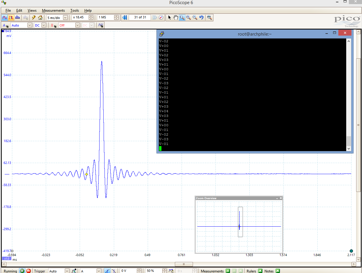

My mind was not right 🙂
Here are both channels.
1 non-inverted sample pulse.
Channels not in "sync" and inverted.
BTW: I read here that my measurements are "not" correct according til Søren.
http://www.diyaudio.com/forums/vend...magnitude-24-bit-384-khz-272.html#post4332606
I will check my other equipment. Running RPI2 via USB to a gustard U12 (usb-i2s) lvds mode to the dam.
Will test with spdif also.
I'd hazard a guess that the time delay between channels is due to your picoscope, not the DAM.

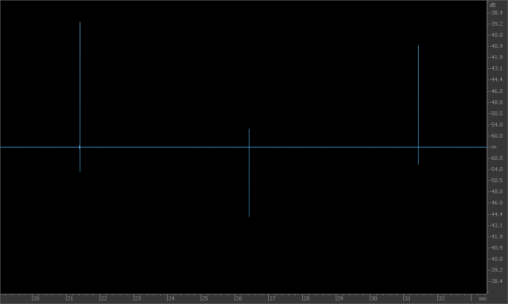

This shows V-40, V-41, V-42. V-41 is clearly inverted and is also at a distinctly lower amplitude.
The capture is about 1.5dB hotter than than it should be, due to running out of attenuation on the ADC:
V-40 = -38.79dB true peak level
V-41 = -41.75dB true peak level <<<< should be approx. 39.80dB
V-42 = -40.82dB true peak level

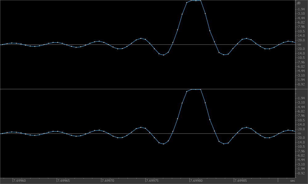

BTW I don't see any timing difference between impulses here. Attached is a clipped impulse at 0dBFS, overloading my soundcard - but no timing difference evident.

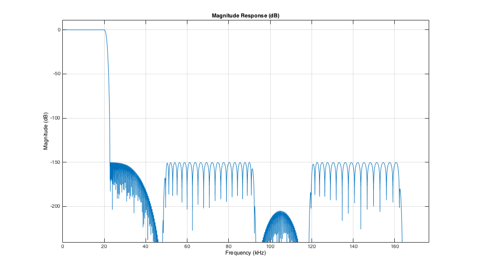

Thought I might take a look at the interpolated FIR tool in MATLAB to see if it did anything worthwhile seeing zfe mentioned IFIR's earlier....
Not sure if the "hole" in the response around 44.1kHz is doing anything useful. Would need to check the outputs to see, and that won't happen today.
I get the feeling with this filter that it needs a bit of extra gain vs the brick wall filters. It may just be a little bit quieter.
This is a second iteration and I've juggled the settings a little to get decent stop band attenuation, reasonable passband ripple and keep the filter short enough to fit into 1016 taps.
No claims it sounds better than anything else, it might even be worse 😀

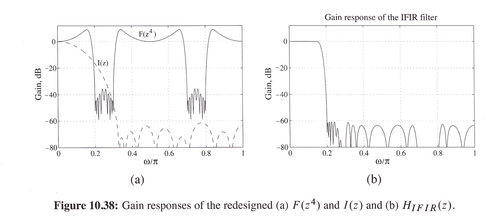

Did you use the "advanced" setting from Matlab? it allows matched Filters like that:
(Taken from P. 582 Digital Signal Processing, S.K. Mkitra)
Theoretically all what you did up to now is a subset of IFIR, but of cause you have for the ususal FIRs a greater variaty of design tools than just that Matlab thing for IFIR.

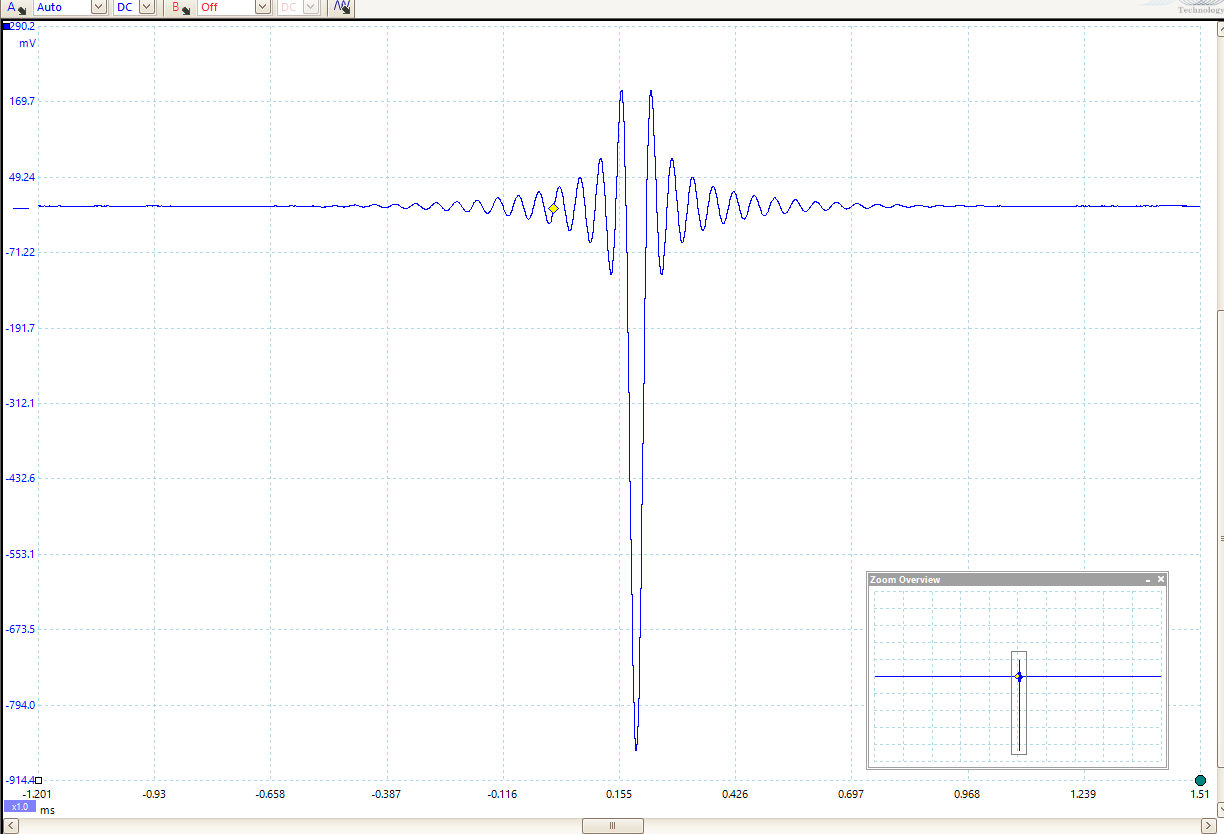

This is the measured impulse from your latest filter.
Pulse 1 sample.
1. V=00
2. V=-01
Since my Gustard probably invert phase (I read something about it) my measurements are the opposite of what is normal 🙄
BTW: The reason why I posted this impulse measurements in this thread was initially because of measuring the filters themself...
