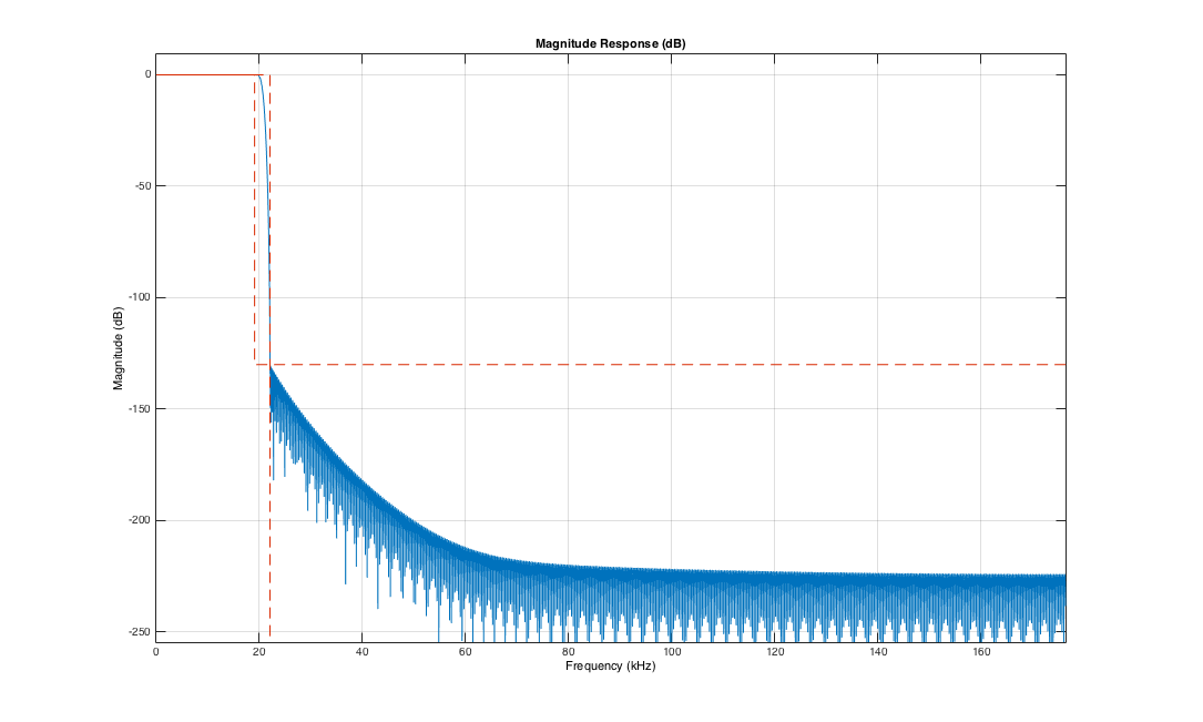

I have the impression that the un-windowed filters actually sound quite different to those with kaiser/chebyshev/taylor/etc windowing.
After listening to the IFIR based filter I posted earlier and now some equiripple filters I've been playing around with to see how different they are in tap length, I'm noticing these "un-windowed" filters have a slightly more airy, open presentation.
The impression I get from listening is the windowed filters for ex. the SoX HiAtt and similar variants is they sound slightly softened/rounded when compared with the algorithm generated filters.
I'm finding that I'm getting shorter and steeper filters using the equiripple algorithm vs the IFIR designs converted to single stage, or the kaiserwindow method. For the same filter spec kaiserwindow is about 25% longer than the other two. I guess it isn't that surprising as the algorithms are designed to produce optimised filters that meet a given specification, whereas windowing is a "brute force" method.
I've attached an example, with the filter spec from matlab, .txt, and .skr...
Anyway I've just been doing some leisurely listening to this, and I think sounds fairly good, its very clean sounding, and as noted above makes the SoX HiAtt style filters sound a bit warm/soft/hazy, so could be verging on analytic for some tastes...
Anyway this is a bit of an experiment so would be interested in thoughts on how this sounds cf the other benchmark filters...

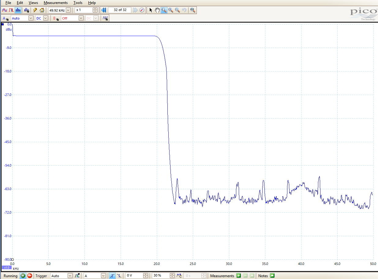

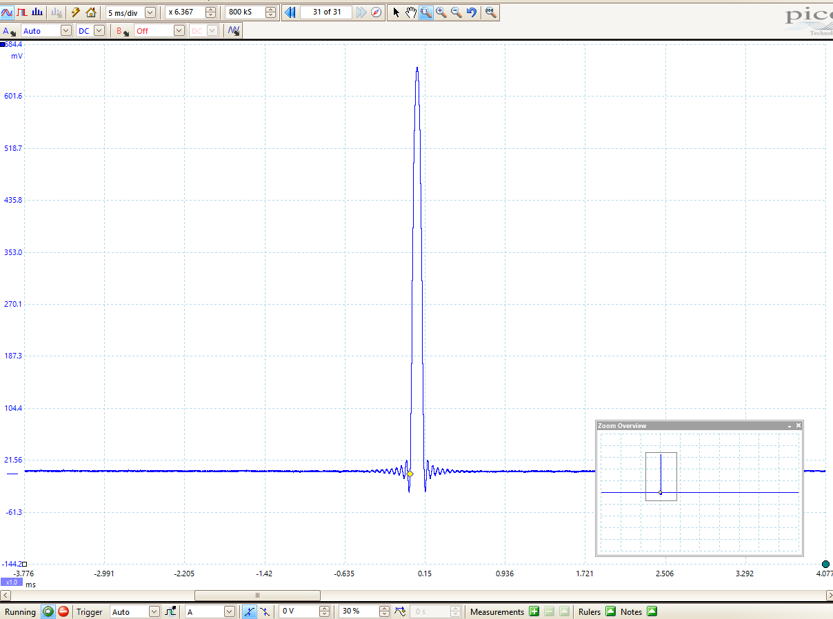

I dont have the all knowledge and resources that spzzzzkt has but have messed around with rephase for a while trying to brew some filters of my own. Been back and forth alot..
Linear Phase filters, minimum filters, mixed filters, trying more "advanced" filters, different windowings, centerings and so on
Today I settled an a very simple linear filter. Easy setup in rephase with 448dB/okt low-pass@20900hz. Nothing more and blackman-nuttall windowing.
To my surprise I really liked it. Seems in my setup quite dynamic and natural sounding.
Feel free to try.
Here are the measured (with scope) 5sample-sine impulse, 1sample-sqr impulse and doing a 20-22050hz swipe with flat-top windowing and "peak hold" setting so I can have a shot of bandwith measurement. (0-50khz)This is of course 16bit material.
The y-axis is not correct because limited resolution of the scope...

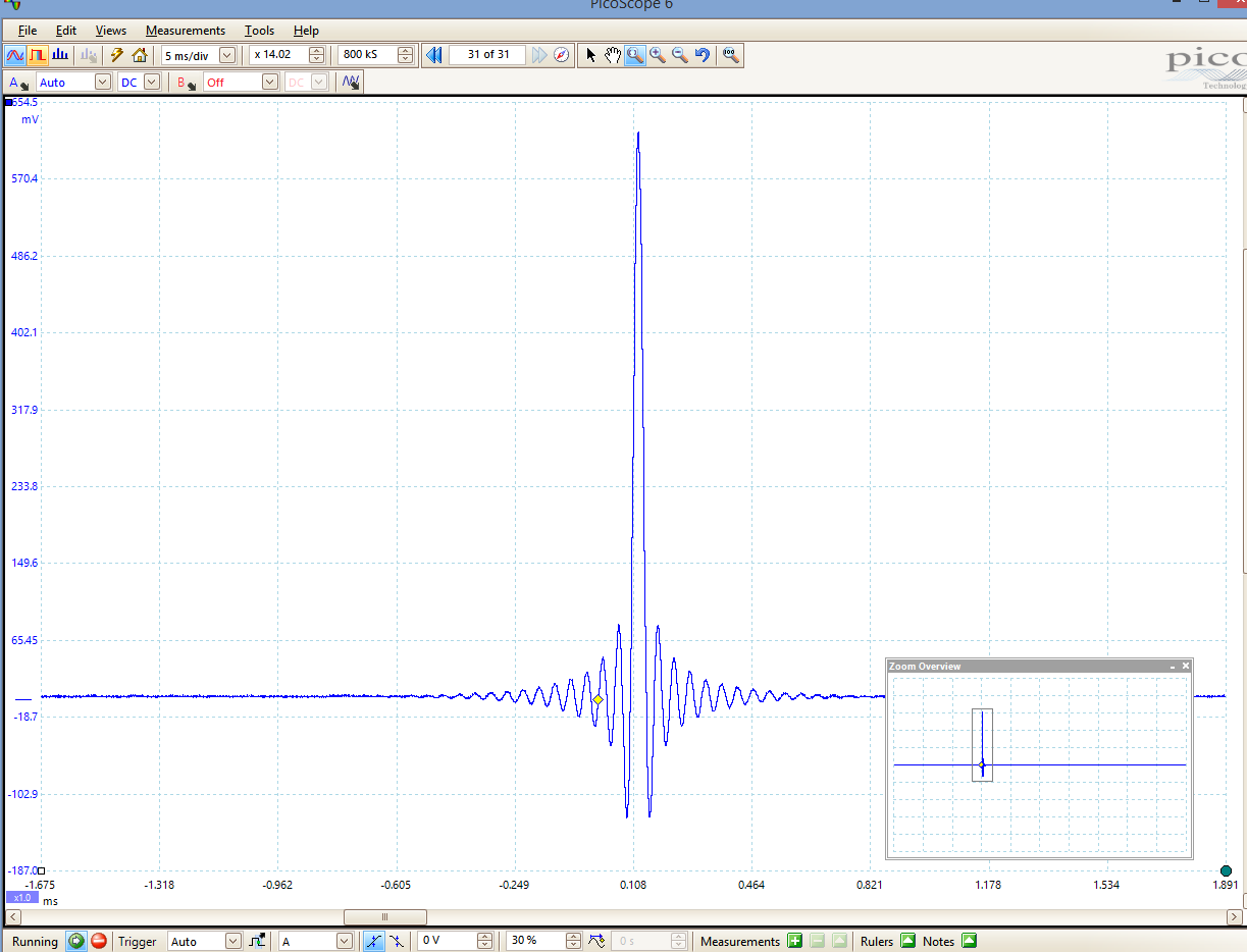

If you measure the response you'll find the bass is same in all the filters
It might not sound that way, however, because the MP in particular moves all the ringing energy after the main impulse. It has the effect of extending the decay of the impulse making the music sound "fatter". It's like turning up the reverb effect to add a bit of fatness and body to a recording. I don't think it's a particularly accurate reflection of the recorded audio, and it sounds a bit over done to my ears.
Well, the ringing only occurs around the corner frequency of the filter, so that is a 20kHz+ reverbIt might not sound that way, however, because the MP in particular moves all the ringing energy after the main impulse. It has the effect of extending the decay of the impulse making the music sound "fatter". It's like turning up the reverb effect to add a bit of fatness and body to a recording. I don't think it's a particularly accurate reflection of the recorded audio, and it sounds a bit over done to my ears.
