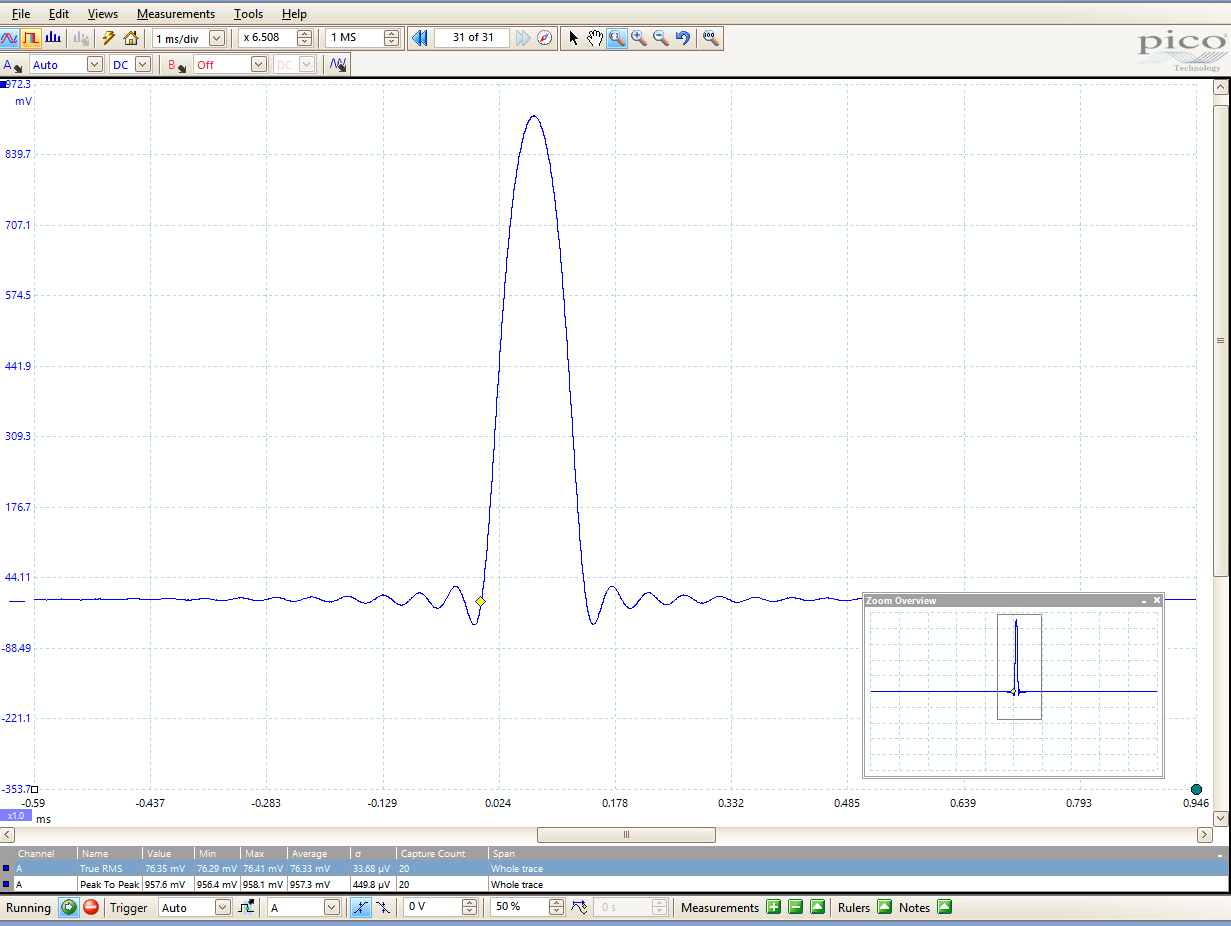

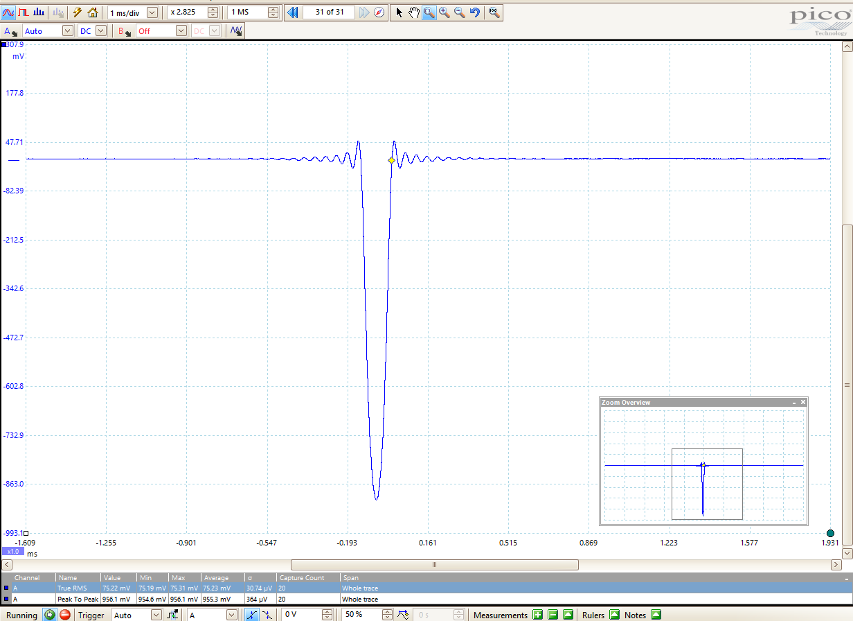

Doing some more measurements.
From this website
Professional Online Audio Frequency Signal Generator
I downloaded a couple of 5sample sine pulse files. On ordinary and one with phase inverted.
Using filter 1021filt_1015_Kb16_BW this is captured from the scope with
1. pulse - normal phase
2. pulse - inverted phase.
The dam - unbuffered outputs into a 10k load (amplifier).
Yes - the dam is inverting phase
If this can be switched easily this is a REALLY BIG DEAL!
Unfortunately it's not a DAM feature as far as I can see. I'm using the balanced outs, and may have swapped polarity when I was putting the DAC in a different box and changed to using off-board XLR's.

No, you can't do that with SE.
In SE "-" is ground, it has no signal.
But you can do it in most players.
For foobar there's a plugin Simple Polarity Inverter.
It would be easy to change the polarity (globaly), you just need to multiply with -1 somewhere (e.g. the FIR2 coefficients).
