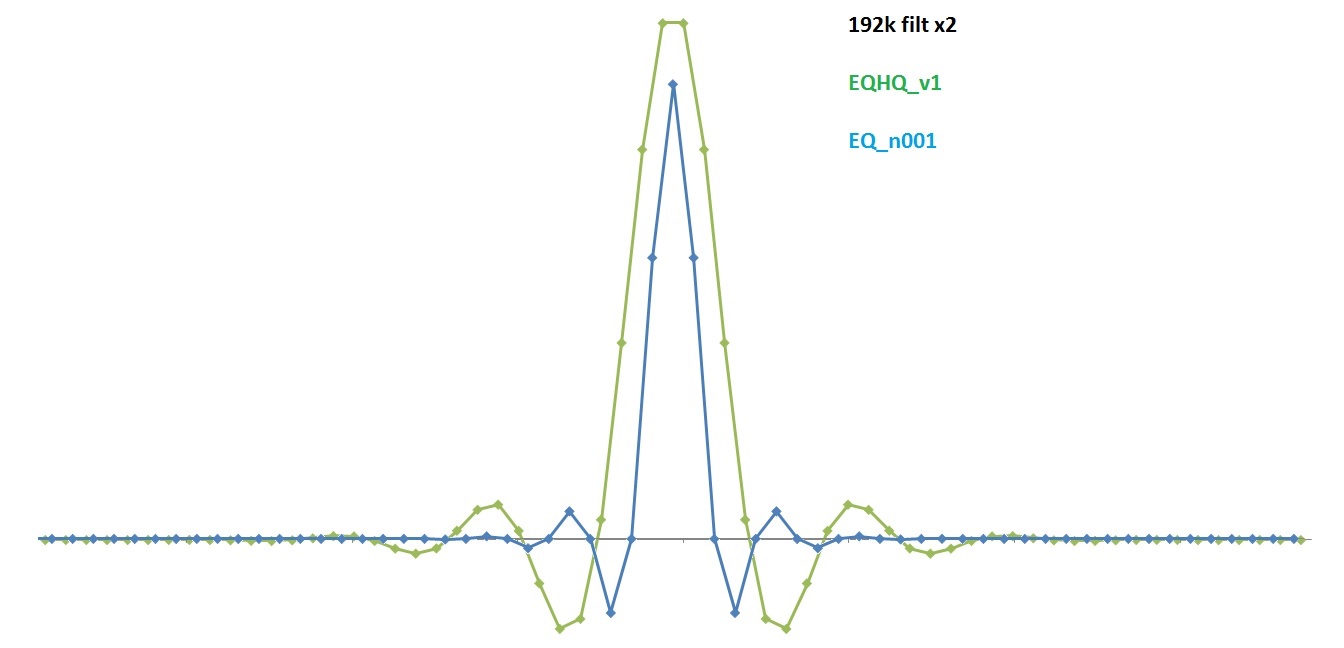

Curious how this filter EQHQ_v1 is made.
More curious in 176k and 192k filters. Rather than expected typical X2 interpolation :
0,..
0,..
-0,..
-0,..
0,..
0,..
-0,..
-0,..
etc.
They are:

Sometimes x3, x4 others, even x5.
Is this correct?

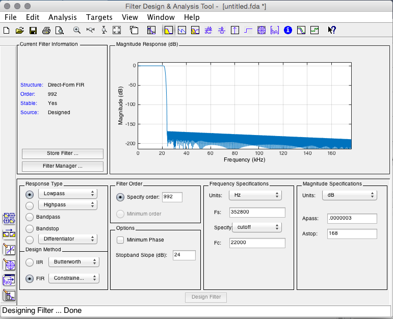

I think the EQHQ and especially the quasiapo filter really shows the potential of the DAM. The 44.1 apo/quasiapo filters aren't anything particularly special in terms of how they are built. The main thing is that they target potential noise/distortion from imaging above nyquist and noise energy from the stop band. It's simply a conventional filter pushed as close to the limits allowed by the firmware as possible.
The reason I went this way is primarily because I felt we really needed to understand what the DAM sounded like with a strictly correct filter before we started to try to make "improvements". With extra taps the filter can be tweaked a lot closer to an ideal brick wall filter, and that should bring some improvements. But comparing with Audirvana Plus upsampling there doesn't seem like there is a whole lot more improvement to be gained - unless of course the DAM has more potential SQ in reserve than software upsampling suggests....
I'm going bird watching ( 😱 ) for a few days over the weekend so I'm definitely going to have some down time.... Currently trying to work out if the boss has totally killed the battery in his car. The joys...

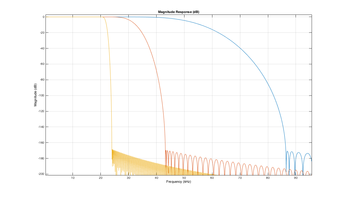

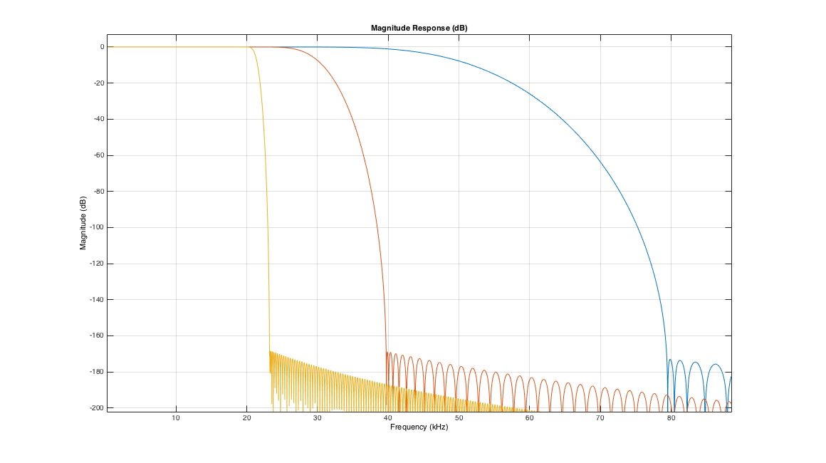

With MATLAB/Octave you have to juggle settings if the design won't converge.
Try using tap lengths that are multiples of 8 or 16. You might need to hunt up and down a bit to find something that converges on a solution.
here an example:
attachment.php
