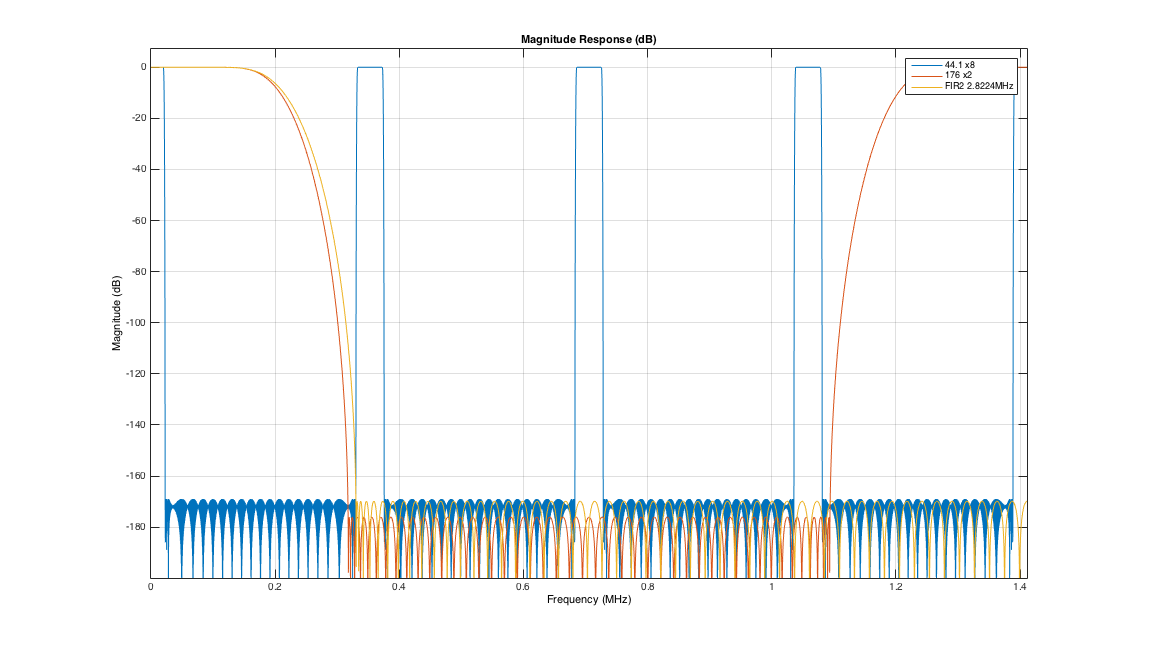

FIR2 constraints
Seems that I need to explain what is going on with the FIR2 filters...
FIR2 is used primarily to eliminate images around Nyquist of FIR1. Obviously you can ignore this but assuming you want FIR2 to perform it's intended task effectively you have constraints.
The first constrain is that highest stop band frequency for FIR2 is limited by the point where the x1 sample rate filters mirror. I take this to be the stop band edge of the FIR1 filter, so:
lower edge of first mirror image = 352800-22750
= 330050Hz
For all the other sampling rates the lower edge of the first mirror image is significantly higher.
The second constraint I put on FIR2 is that it should not interfere with the filter curve of the highest non bypass filter, so in this case 176.4KHz.
This is more a case of juggling with the pass band edge and plotting the response curves of the filters to ensure there is minimal interaction.
The third limitation is the constraints of number of taps, pass band ripple and stop band attenuation, which all place a limit on FIR2 filter steepness, and therefore limit how steep you can make the 176.4KHz FIR1 without FIR2 becoming the dominant filter.
In the current filter FIR2 for x44.1 based rates is at 115 out of a possible 120 taps. There is limited scope to increase the edge of the pass band and therefore increase the steepness of the filter without reducing attenuation or increasing pass band ripple, so this becomes the ultimate limit on behaviour of the filter at 176.4KHz.

To FIR2:
An easy to implement improvement of the situation (for Soren) would be to load filters as matched FIR1-FIR2 pairs. Then e.g. you would not need to think about the 178 FIR1 when designing the FIR2 for 44.1.
Moreover that would make sense in case you want to use different types of filters for different frequencies, e.g. a NOS FIR1 for the higher frequencies would call for a NOS FIR2, but if you use Non-NOS for low frequencies this would be a FIR2 mismatch.
To FIR2:
It's a small improvement on one level, but a huge step up in complexity of authoring and managing filter components once we get the 4x user selectable filters. I'm not that convinced it's necessary, and current setup is easy enough to work with a bit of thought and planning.
I am sure it can be done such that if only one FIR2 is given, it would be used for everything (would also ensure backward comparability).
The matched FIR pair loading feature would be necessary as soon real IFIR filters (i.e. only FIR1 together with FIR 2 give a flat passband) would be used, unless you want to download the fillers for every sample rate change manually.
I'm talking about filter creators managing the production of .skr filters not handling it the DAC. I'm not that excited by the prospect of dealing with incremental updates to txt files with 40 different filter sections, let alone 60.
