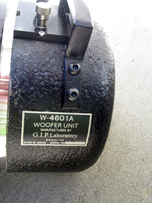

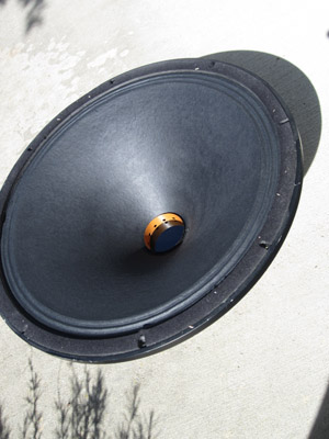

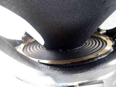

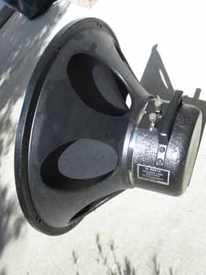

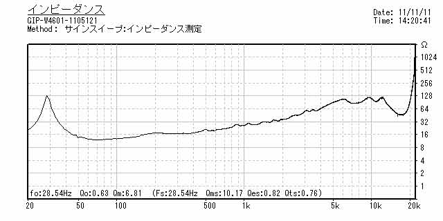

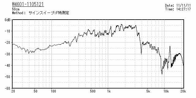

I am interested in making fc compression drivers because I just returned home from visiting a sick relative to find the speakers in the pictures waiting at my door... GIP W-4601A field coil 18"s!! These use a TA-4181 spec cone, which weighs something like 24 grams!
Feast your sighted belief systems on these babies!!
I worked with these speakers before. The performance of the GIP 18" does not require A-B tests to verify whether I am hearing any difference between this and a Dayton or Eminence. I mean come on..get real.
Hope all you fanatic empiricists will join me in some empirical activity.
