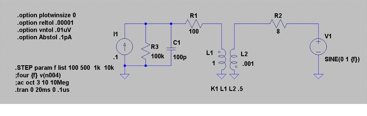

Whipped up a FC supply sim. Guessing at inductances and field coil resistance, real numbers would help, but still interesting.

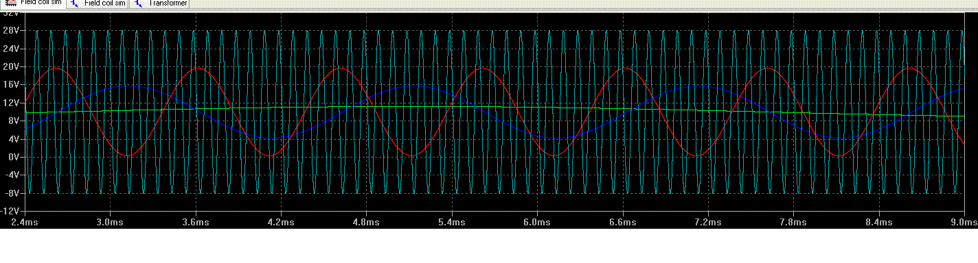

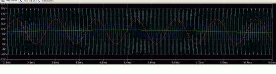

Heres the voltage of the current source at a .1 amp DC bias. The current in the coil is pretty constant (+/- 1%) and that depends on the source impedance, the 100k r. The voltage swing varies a lot with the DC bias, inductance ratio, mutual imductance, and will go negative sometimes, depending on a few factors and the DC bias voltage. Some sims the voltage swing was 200 volts! I could see this as being a problem with some designs. Any one have any idea what kinda mutual inductance these will have?

I think the notion of resisting the AC change to the DC (operating point) flux conditions is correct, but I don't think you can achieve it. Constant current helps with slow variation, such as FC DCR changing as it warms up, I don't think it combats the AC variation.
The way I would look at it is that your AC signal is added on top of the fixed flux (which is proportional to ampere turns). I think you want a low impedance to resist the externaly applied (through the voice coil, not through the field coil supply) flux variation. Unfortunatly, the high impedance of the field coil means you can't short out that applied AC, even with a stiff external supply.
