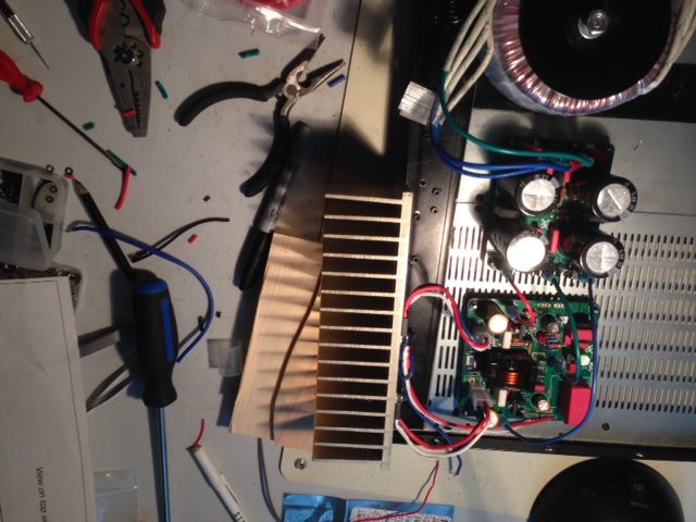

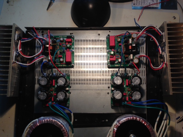

Progress pics
While waiting for some parts, here are some progress pics. Please comment if you see something weird. Full view, right and left channels. Sorry about my poor lighting.
X, I noticed that your PE connection on the amp board is doubled wired. Is one of the wires from some other component and you are joining there, before continuing to your ground block.
MM
MM
Thanks X, for my knowledge, can you briefly explain why decreasing the impedance of the PE ground wire is a good idea. Looking backwards, is it easier on the amp or the PSU.
MM
MM
In case there is a fault in the amp, you want as free of path back to mains earth ground to reduce electrical shock, fire, etc. Probably a single 16ga line is fine. I am just being extra careful. It also provides a lower impedance path for the RF filtering on the board to pass to earth ground (the 22nF cap between analog zero and PE).
