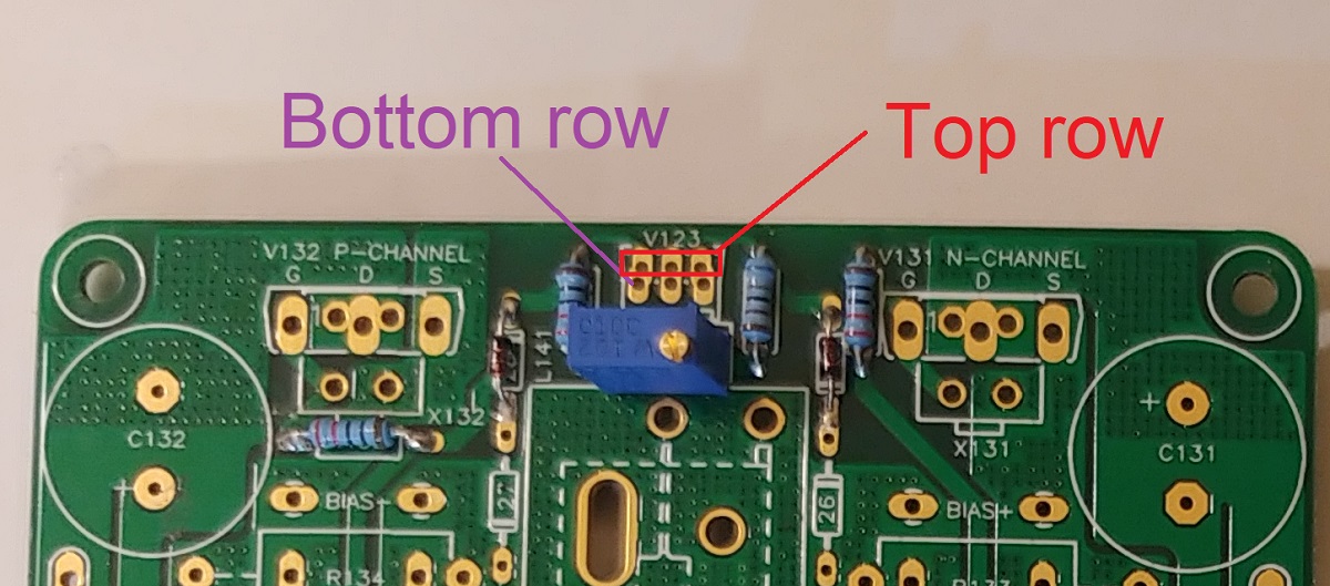

Myles,
Is your question the following?
"Does the BD139 component get inserted in the top row or bottom row of PCB position V123?"
Image attached.
From looking at the two sets of holes, it looks like the holes in the top row are spaced at ~2.0 mm center to center, and for the holes in the bottom row the spacing is 2.54mm.
If I understand correctly, if you are using the JST connector specified in the bill of materials that Vunce has developed, the pins of the JST connector would fit in the 2.54 spaced holes.
If you are soldering the BD139 directly on to the PCB, then the pins will probably fit in the top row of PCB position V123.
Maybe X can confirm.
Also, Myles can you confirm if you are using the JST connector and cable for the BD139 and flying leads for the MOSFETs? Please note that all the 3 devices will need to be attached to the heat-sink within proximity of one another.

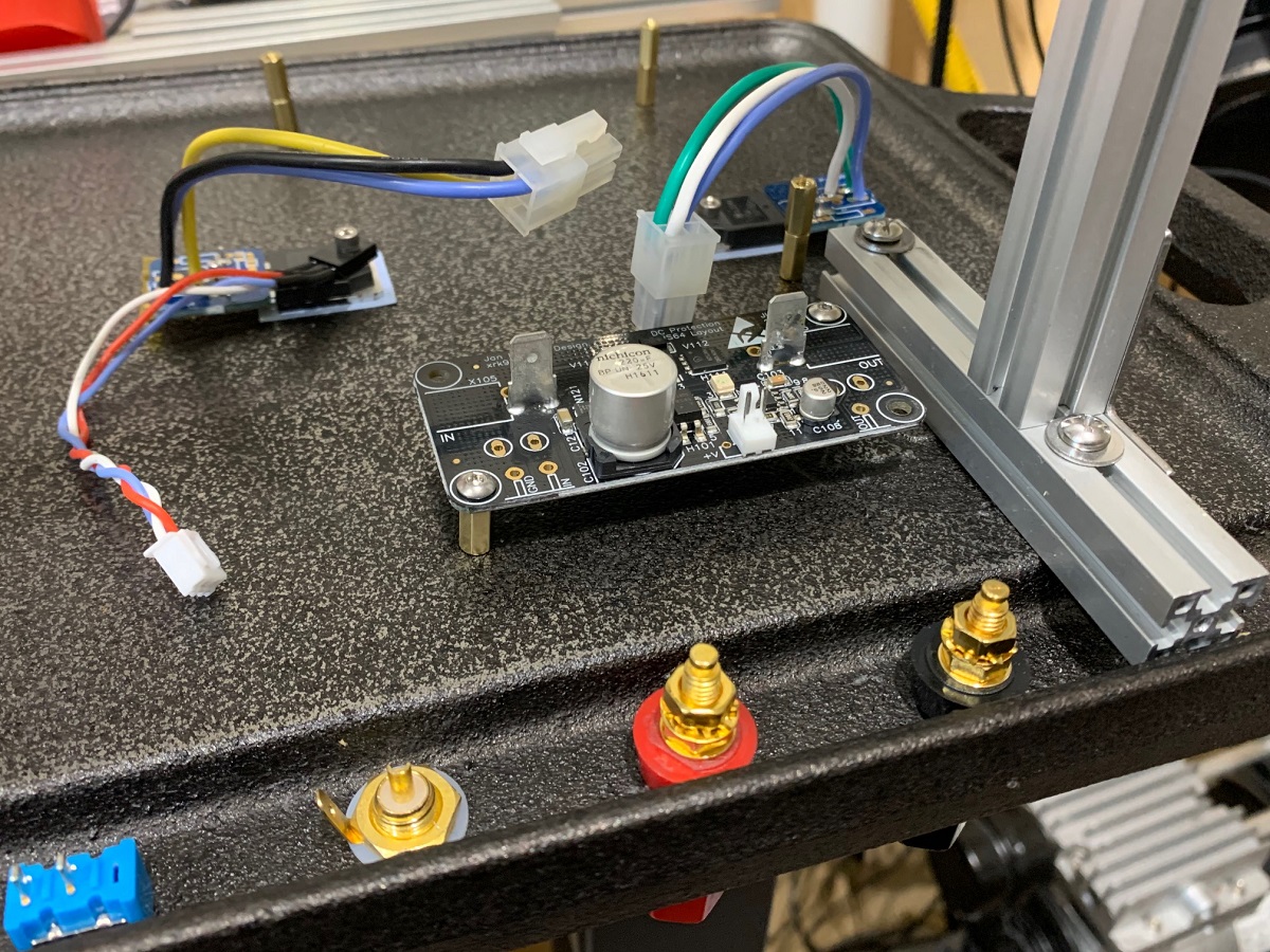

Zman01 has it correct. The very top row is for direct mounting of BD139 temperature sensor (the so called “Vbe multiplier”). It needs to be in thermal contact with heatsink or preferable piggy back on one of the MOSFETs. I use the top Nchannel typically.
The griddle amp thread has lots of good closeup photos.

X and Zman01,
1. I will be using the flying leads, BD139 piggy backed on MFET on heat sink. as you both have in your builds.
2. The JST actually fits in top or the bottom row. Bottom row is sloppy fit, top row is slightly snugger fit, but not forcing.
3. If I am not mistaken the pads on the top row and bottom row are connected.
4. Given info in questions 1, 2, 3, where do you recommend I solder the JST module, top row or bottom row?

Myles,
As you have correctly stated, the pins on the top row and bottom row are connected - so soldering to any of the rows will work. Just make sure that the 3 pins stay separate and that there are no solder bridges shorting any of then pins.

Technically, it is the bottom row but as they are connected, it doesn't matter. My JST 3-pin jack won't fit into the top row without bending the pins. Loose fit is fine as the solder holds it in place.
Thank you all, now I can proceed, bottom row it is.
