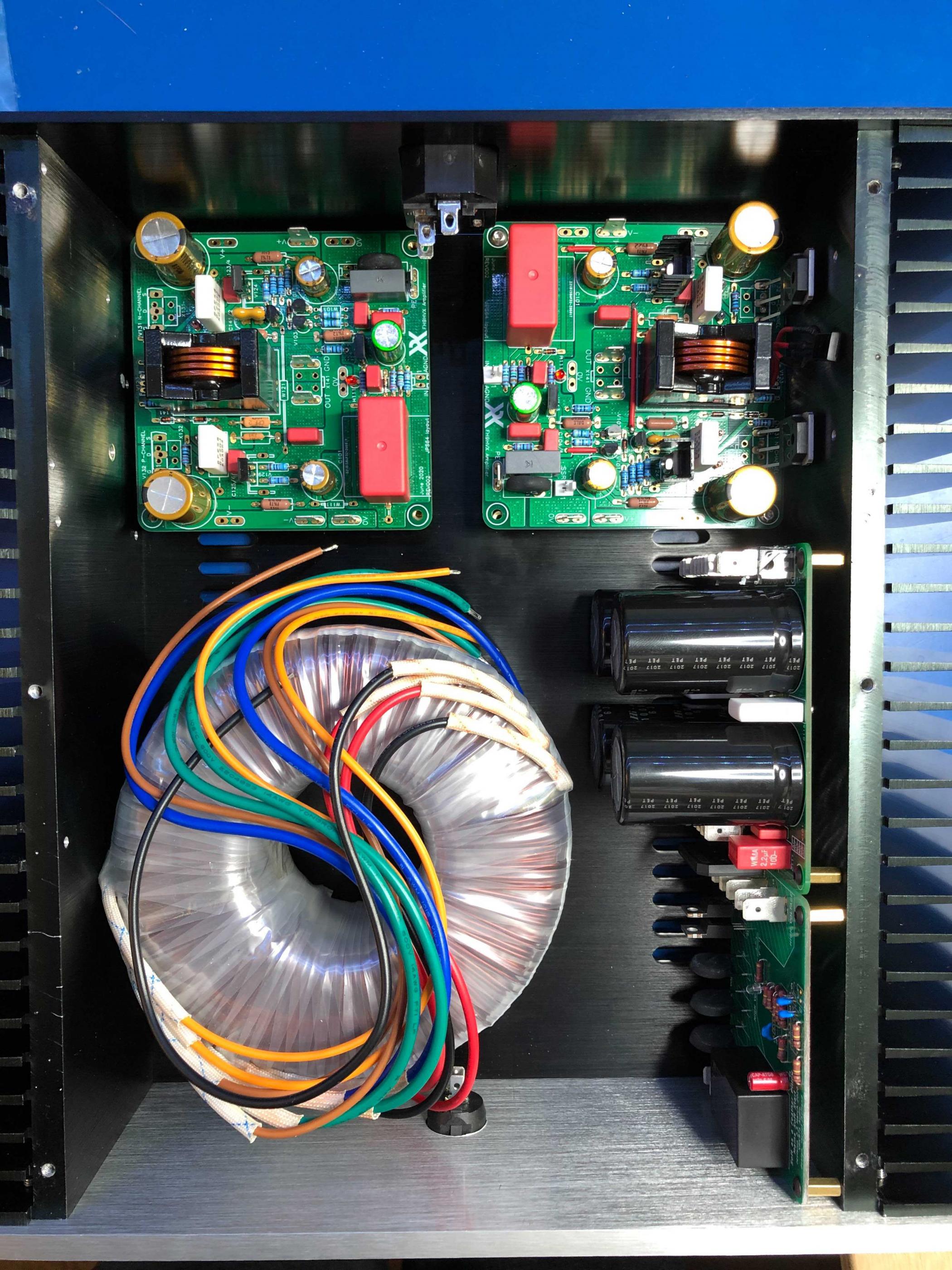

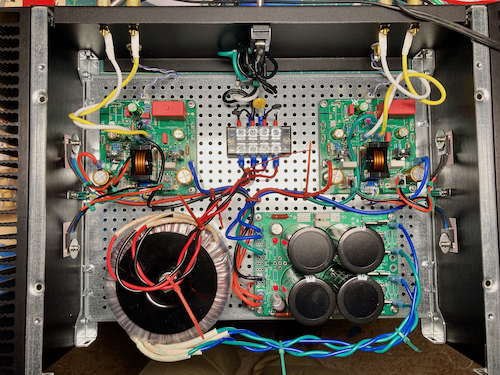

Finally!
Just fired up my FH9HVX - everything looking good and playing music.
I need to tidy up the wiring before buttoning it up.
Before you ask - I deviated from my usual obsession with symmetrical chassis layouts, but I wanted to try Prasi's LT4320 CRC filter board and ran out of real estate in the 3U box. I could have mounted the amp boards on the heatsinks to make more room, but got impatient and did not feel like doing the extra hole tapping. 🙂
Anyway - sounds great. Thanks to X, JPS64, and Vunce for a fun project!

Hi Wtnh,
Wow! Very nice work - actually it is very neat and tidy as is. You are going all out with the Prasi premium CRC PSU with LT4320's - very good choice for this amp. Is that a standard 300mm deep Modushop 3U Dissipante chassis? You might consider a speaker DC protection board.

Yes - standard 300mm 3U Dissipante. Prasi's LT 4320 board worked perfectly. With an Antek 36 Volt 300 VA dual winding transformer, I get +/- 48 Volts. I used 4x 22,000 uFD 63 Volt caps. Obviously going this route drove the PSU price up a bit, but I was anxious to try it out.
I do notice a bit of downward bias drift as it warms up. This is because at idle the heatsinks are not even lukewarm. If I set it to 33mV cold, it will drop to about 28mV once it warms up. Of course, this is preferable to the opposite condition, which might lead to thermal runaway!

Your FH9HVX Looks sweet Wtnh!! Congratulations on a smooth power up. I wanted to use an LT4320 based rectifier also with Prasi’s PSU, but the trafo I’m using is center tapped. If I remember correctly, Bias is about 140mA. The sinks are barely warm!

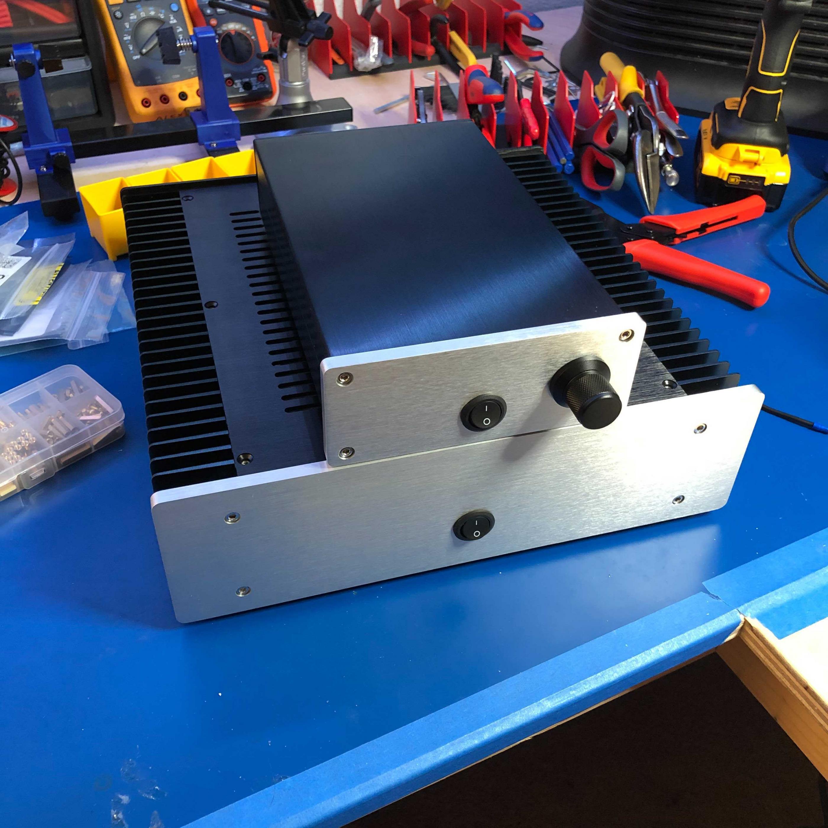

Bit of progress, what are your thoughts on the mosfet/heatsink location here? I know it's not ideal but wondered if it'll just run warm or be detrimental - I was going to look at it under a Fluke FLIR when assembled to confirm. Mounting is 2/3rds the way up a 2U x 2in x 12in radiator, but all the way to one end.
